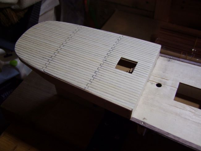

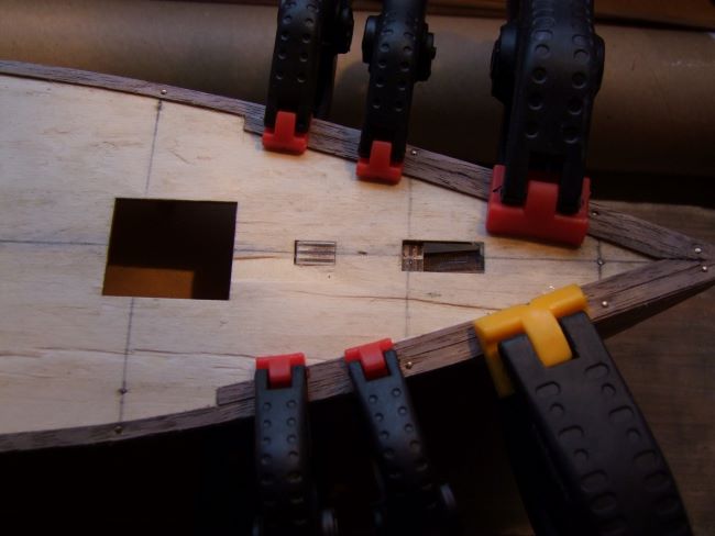

Hi Everyone. I have at last started again, I cleared all the decking that I did and started again have done the stern bulkhead and put the waterways on. I have opted to put them onto the edge of the deck and later I am going to add a piece of 2x2mm batten rounded off along both sides at deck level.Martin

sorry missed the stern bulkhead out.Martin

#53 Posted : 25 January 2020 12:15:39
Very nicely done Martin.

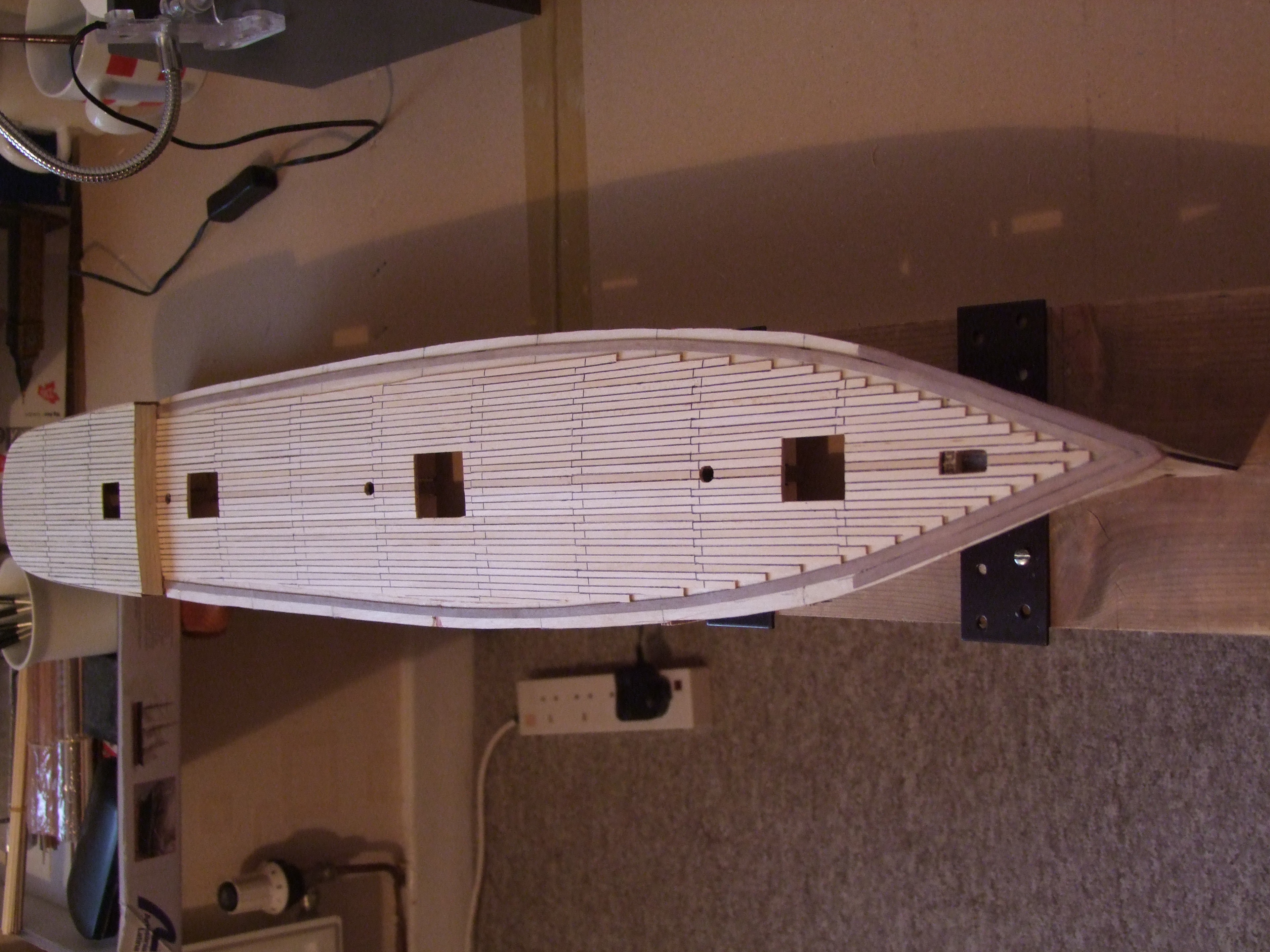

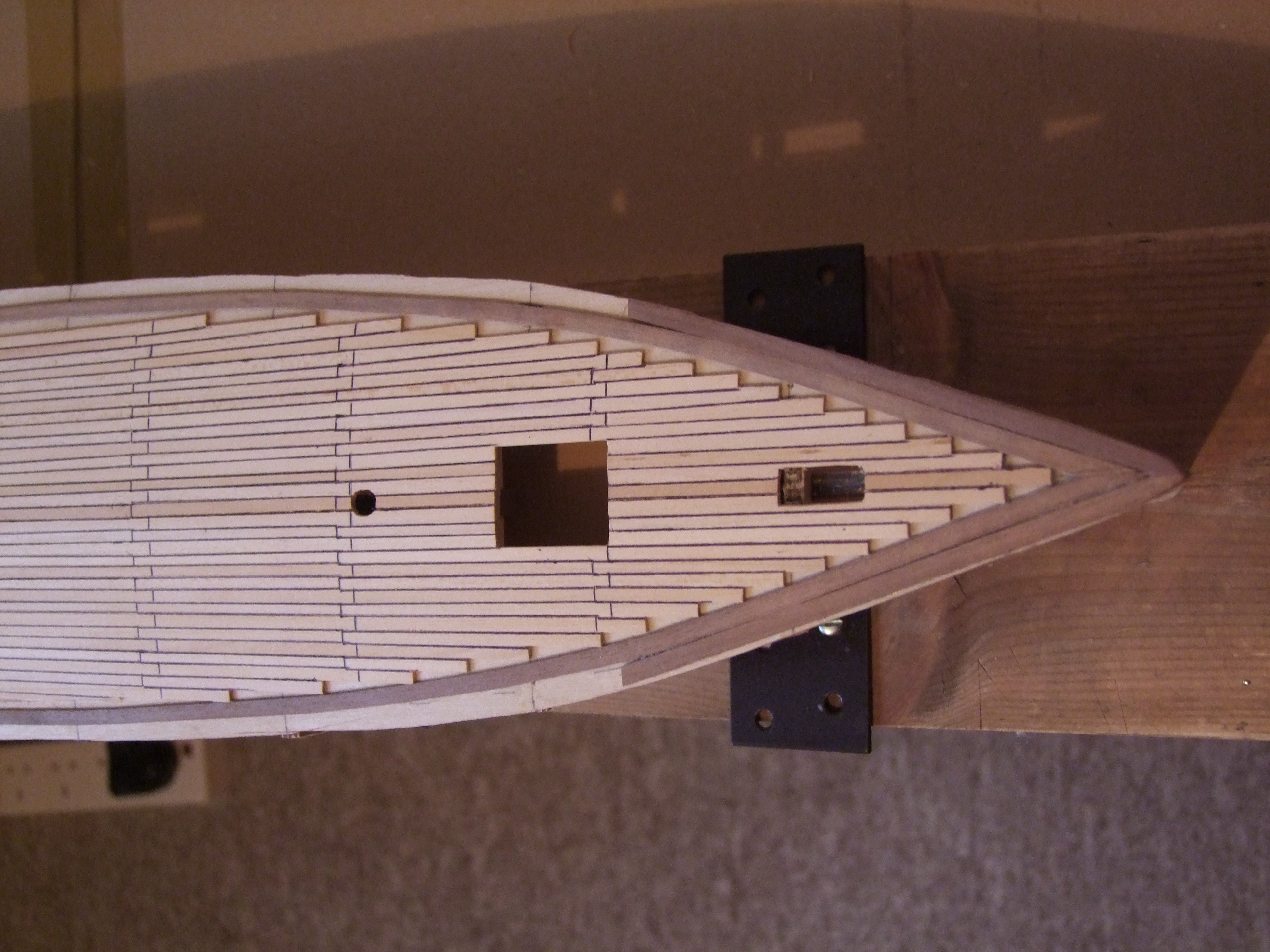

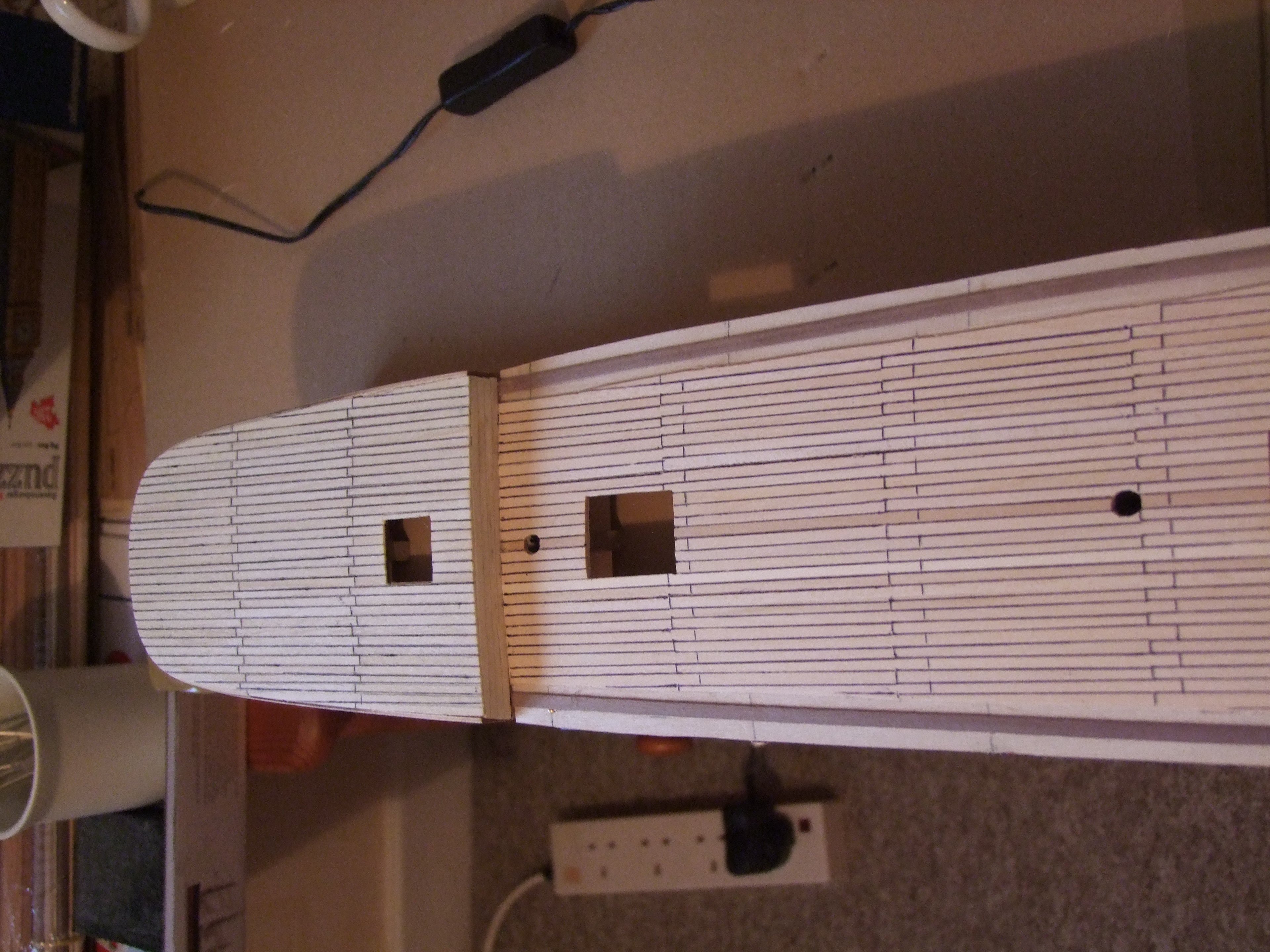

Right. deck finally done hope it looks ok with you guys? I can finally get on with the hull, hope that doesn't take me as long.

sorry I don't know what has gone wrong with the photos? I did resize them Martin
#59 Posted : 09 February 2020 12:26:48
Your picture data is showing they are 2880 pixels width and they need to be 650 max.
OldMart
#60 Posted : 09 February 2020 12:30:05
Rank: Amateur level 2
Joined: 06/12/2019
Posts: 49
Points: 164
Location: Macclesfield UK
hope this is better?
