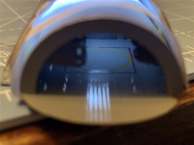

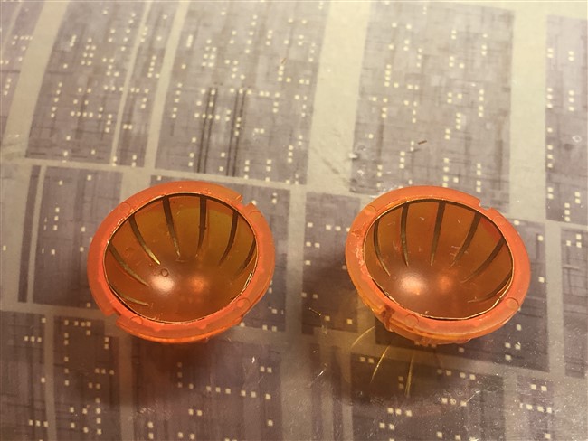

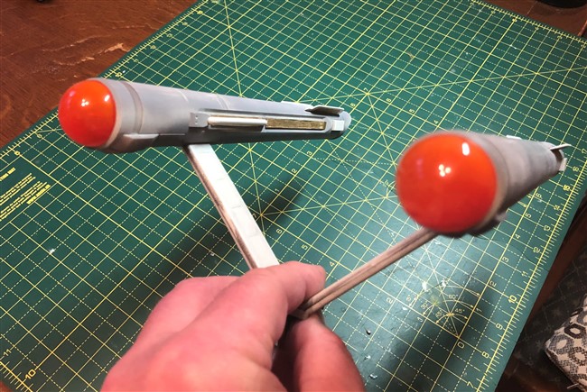

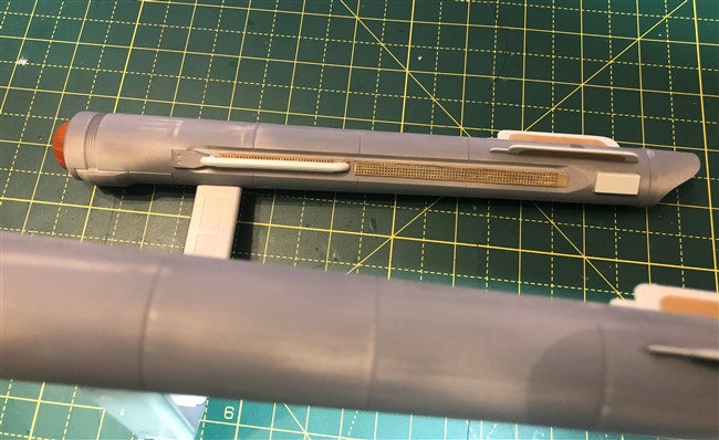

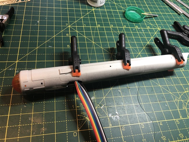

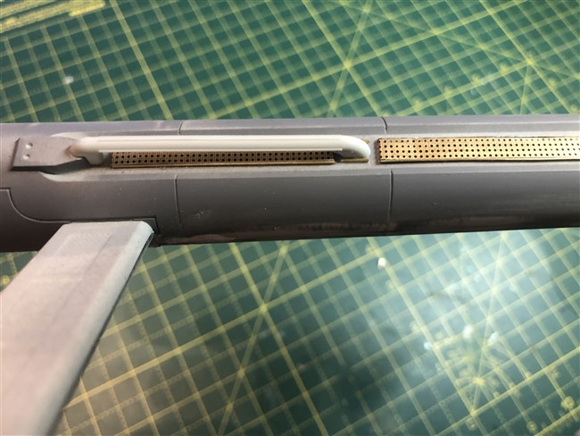

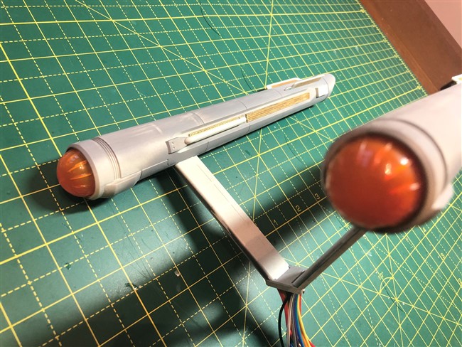

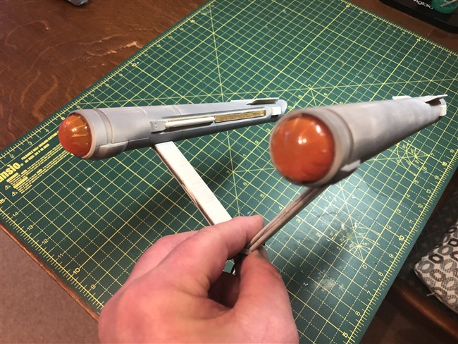

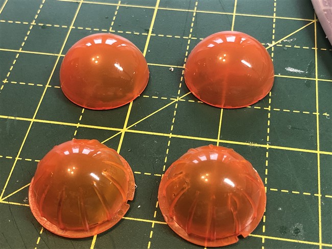

This next stage was to assemble the nacelles. The first thing was to paint the interiors of the dome front with a translucent orange. This was made up of 5 parts orange, 1-part red. The main front dome was frosted on the inside before painting. Very light coats of paint were applied to give an even finish. Then some etch brass inserts were place in the inner dome. This will highlight them better than just the original part provided.

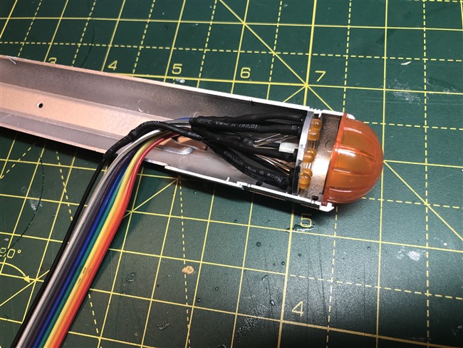

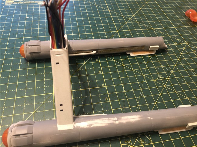

Next, I made up the nacelles by placing the lighting in first, a quick test on the lighting was done with a 9v battery, although it just lit up the LED’s without the lighting effect. Before attaching the etched brass components, I sanded down the seams, adding some filler in places where necessary. The final part was to add the main structure placing the cables through them carefully. The last two pictures show the inner dome and the final one is the outer dome in place.
Lastly, I hooked up the cables to the mother board I made earlier to test the lighting effect. There is also a button on the board to give variants of the lighting effect, this will be programmed in its final stages.

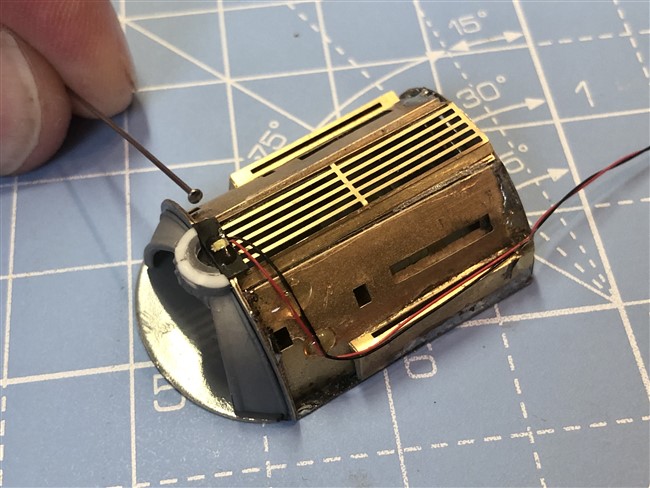

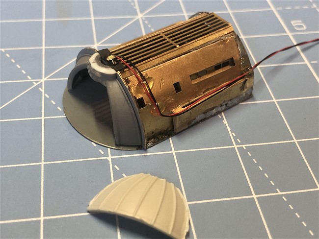

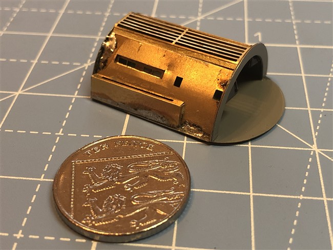

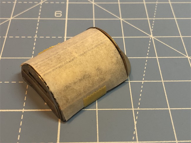

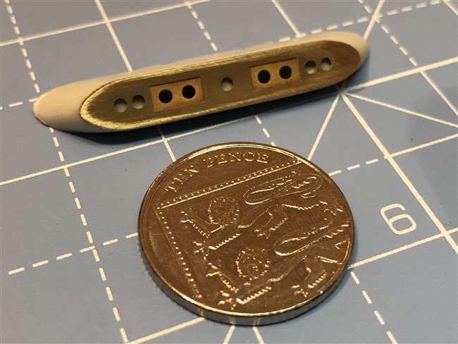

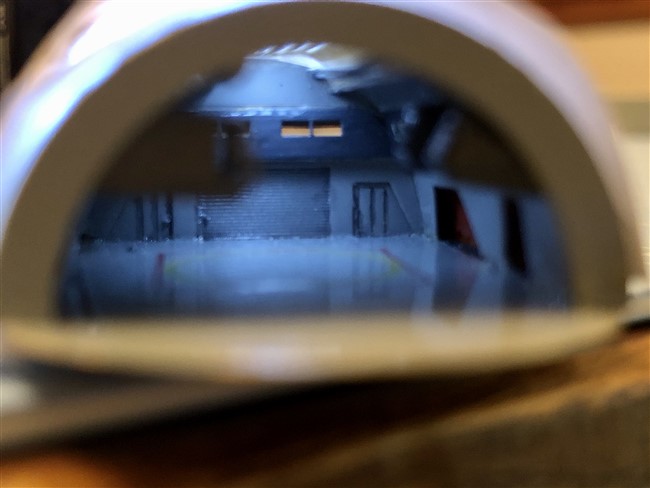

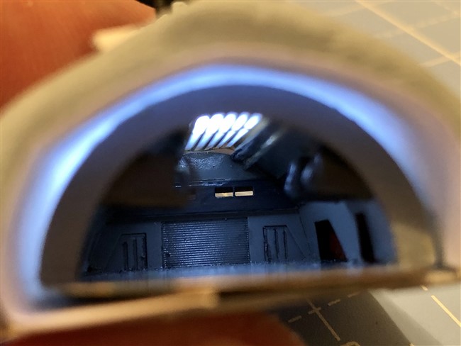

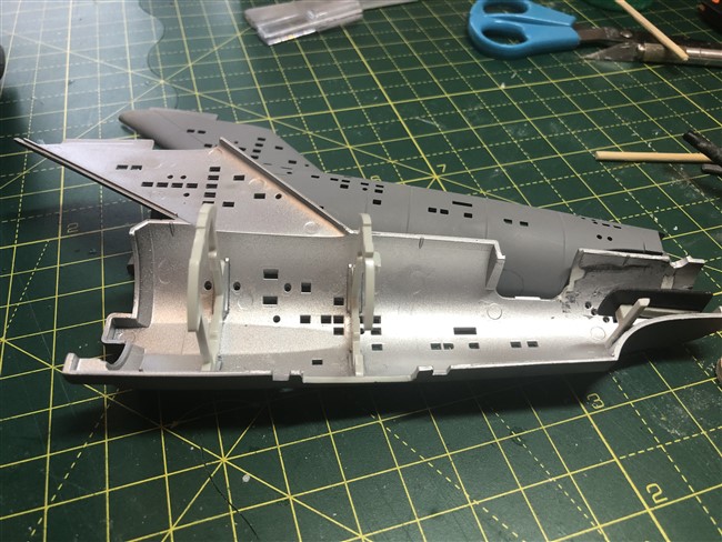

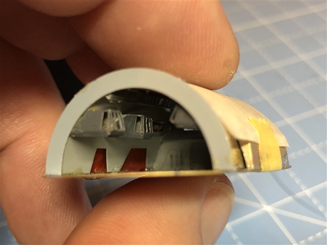

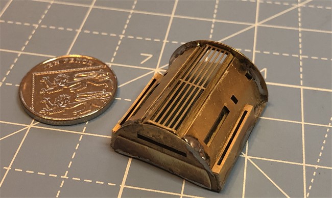

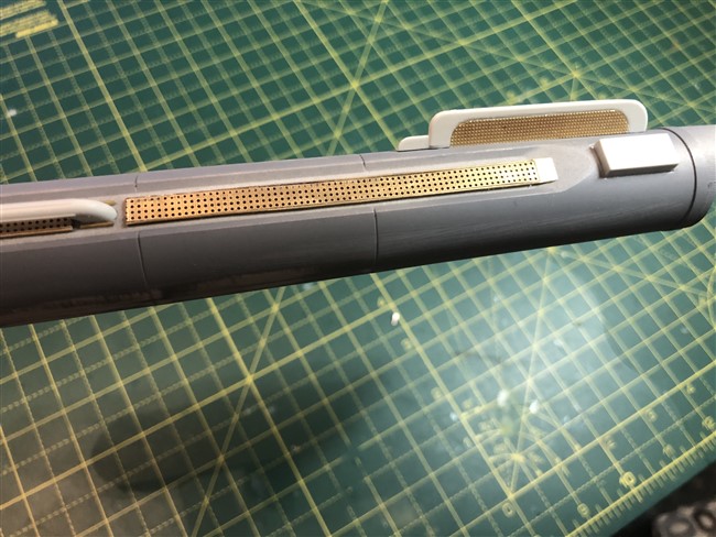

The next stage of the build was to finish attaching some of the etch brass to the main hull areas. The impulse engine grill gets better detailing than the supplied part. I also cut away two areas on the inside where the lighting will be. The next stage was the shuttle bay hanger. This was not easy and lots of tiny parts to piece together as well as painting before most of the construction was done. The main outer parts were soldered to give a strong bond holding the whole thing together. The main hull where this will be placed had to be altered, cutting away sections to accommodate the hanger. Further structure will need to be made and inserted to hold this in place but allowing all cables and lighting effects to move freely when the final assembly is done. Not panicking really.Crying
The paper covering the hanger in the picture is what came with the decal sheet. This is great to use for defusing the light internally giving an even light all round.
Oh, and I will have a scaled shuttle craft leaving the hanger in flight when all done. I like a challenge.BigGrin

#51 Posted : 04 February 2020 00:07:40

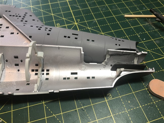

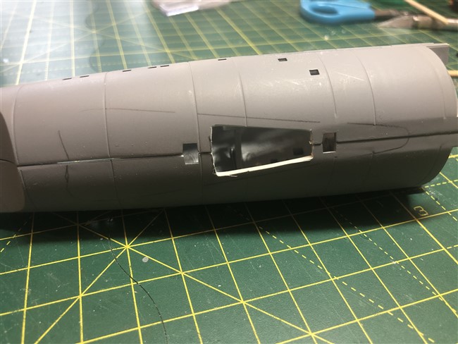

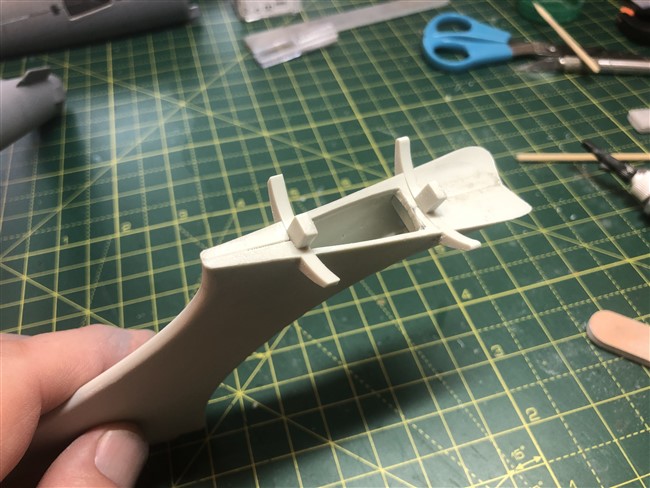

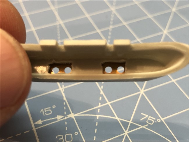

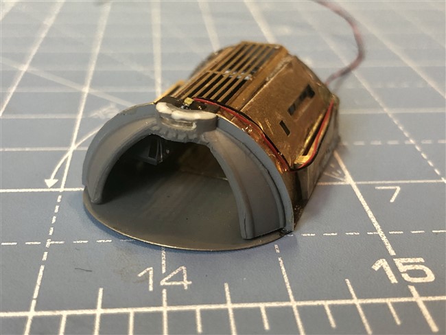

This time around I have cut away section of the hull, which will accommodate the wiring and shuttle bay. The frame has also been cut as well as the support, which holds the Enterprise on the base. Strip lighting will be installed inside the main hull interior, along with the main power, Bussard lighting cables and cables between the hull and the saucer section that attach to the flash and fade circuit boards.
The other issue I have had, is the rear flashing lights which are over the top of the shuttle bay. These would normally take a 5mm LED, however, once the shuttle bay is in position, there is no room as all. In fact, there is barely half a millimetre to play with and once I have added the paper to defuse the lighting it will be a tight fit.
So out came the SMD’s. I experimented using these and wired one up to the flash unit and all worked perfectly. The last pictures show the SMD in place where it fits directly under the light panel on the hull. I have placed a pin by the side of the SMD to show just how small these are and how difficult they are to solder. You’ll be pleased to know my eyes have gone back to their normal position. LOL I have also cut the rear door part to show it in the opening position.
