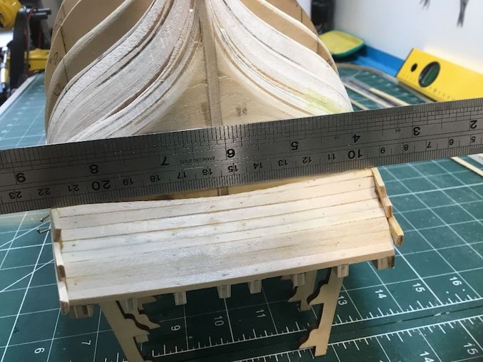

Thank you for the comment about the stern/gallery relationship.
I think it must be an optical illusion as the rear plates have been sanded back flush with the keel section.
The reason (I think) that mine looks different is that the gallery supports are on an arc and it makes it appear that the rear plate is curved instead of flat.
Having said that, the last plank adjacent to the stern is a lot straighter than mine in the pic you have attached.
Just been looking at mine again and I can't see anything amiss.
As you say, it probably won't make much difference but should anyone think differently, then perhaps they could let me know. I have fitted the first three rows of planking and don't want to have the task of taking off any more than I need to.
Thanks again, John, for pointing this out.

From your photo, it look like you had to taper the 1st plank almost to nothing in the middle but as you say, that could be an illusion.
I am way past this point now and I can't see anything that would send it awry. Perhaps some of the experts here could chip in with their thoughts.

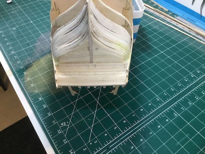

On the contrary John, you are correct that I have taken too much out of the stern plank.
I have attached a couple of photos that I just took to confirm flatness of the stern plates but the plank is all wrong.
I will be taking that out again tonight and getting it a little closer to the recommended shape.
Looking at the first picture again it looks as if the planking is not square to the stern? I'll have another check.

Not absolutely as per official build, but as good as I can get I think.
Any comments appreciated.

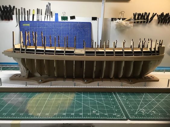

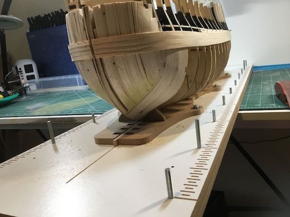

Over the last two days, I have fitted the first four rows of planks. The results are below.
I then took some random measurements from the top of the last row of planks to the top of the bulkhead legs
and compared like with like on each side. All looking nice and even at the moment. A little bit of clinkering here and there but hopefully, the sanding process should eliminate most of it.

How do they look when you run your eye down the length? If there are any bumps or dips, now is the time to fix them.

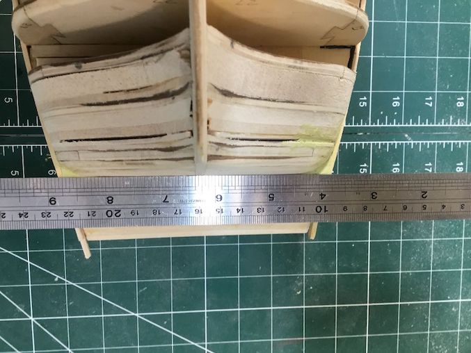

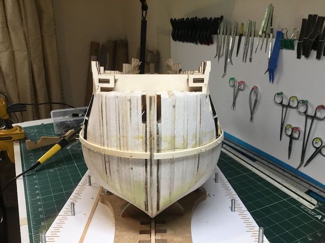

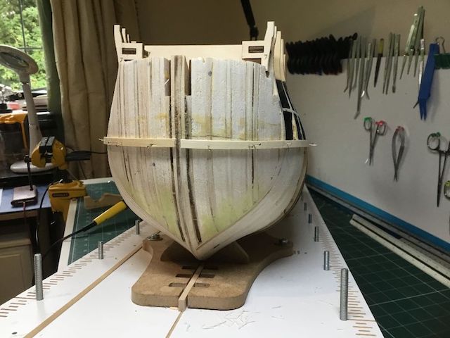

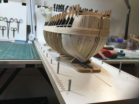

I've been looking at adding row 5 today and on reading the mag it says that tapering of rows 5 and 6 is not necessary. When I try to lay the bow plank, it is obvious that I am going to need to taper. I have attached some of pics up to layer 4 at the bow and although it appears there is a bit of clinkering there, I think I can sand that out. Any comments would be appreciated. If I need to take of all the bow planks and start again, I will.
#53 Posted : 14 August 2019 18:27:37
Hi Goddo, looking at your pictures it looks that it you taper to fit you will end up with splinters after sanding and this will result in over crowding, in a normal hull more then likely a drop plank would be needed rather than sanding which will result in the clinker effect.
Trev.
#54 Posted : 14 August 2019 19:29:13
Hi Goddo as Trev says you definitely need at least one drop plank so the planks start to sweep up the bow so they keep in contact with the bulkheads. Hope this helps
Martyn
#55 Posted : 14 August 2019 23:47:05
Hi Goddo, one of the good things about this build is you plank the upper part of the hull first, this gives a good amount of practice in planking before you start to tackle the lower hull. The fitting of dropper planks is only necessary when you come to plank the lower hull and the instructions give clear guidance on how this is to be achieved.
Looking at your pics, can you confirm you are chamfering the lower edge of the planks going round the bow, if you haven't chamfered then that could account for the clinkering. If you need to taper the bow planks slightly for rows 5 and 6 then that shouldn't cause you any problems as long as you don't have to taper too much, just make sure you chamfer the adjoining edges too.
Also, you pics are not showing as they are 'jpeg', they need to be 'jpg'. Size of your pics is fine......

Thanks to everyone regarding my dilemma with the bow planking.
As it happens, I was not happy with the way it was going so I removed all the bow planks and have started again.
I am also making sure that the edges are chamfered. Once I get the first four rows done I will post another pic with my progress. Thank you Alan for your tip regarding how the photos should be named. I'll do my best to get them correct.

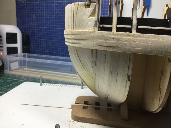

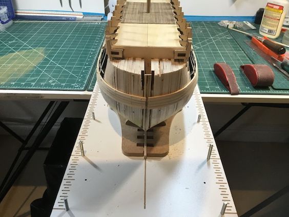

Thanks for the advice Alan. I have placed the first plank again letting the curve take it's natural line along the underside of the lower gun deck and around to the keel. Planks are just pinned at the moment. Your comments would be appreciated.
goddo attached the following image(s):
#60 Posted : 16 August 2019 19:05:11
Hi Goddo, from what I can see I'd say everything is looking good. Would ask you to post up one pic looking along the hull so I can see the flow of the planks. Think you can now go ahead a glue that first row in place ensuring as the glue dries that the planks sit flat against the whole width of each rib. Once the glue dries then you can set about applying the next row of planks in the same way. If you need to chamfer to ensure the planks sit flat against each other then chamfer the lower edge of the new plank only. Cool Cool
Look forward to seeing how get on...
