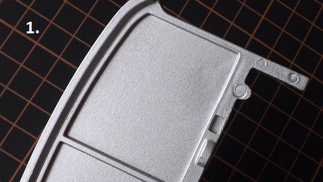

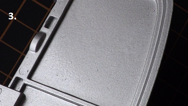

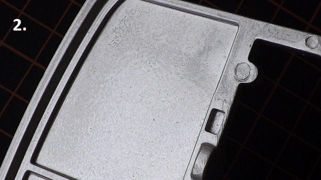

BULLET PROOF SHIELD
PICTURES 1 – 4
The rear facing part of the (i.e. what a car following would see) is on the whole 100% better than before.
There is still a ridge of varnish bit this time along the top section that would be exposed when this shield is pressed down.
The rear of the shield still suffers an inconsistent varnish finish and again there are some “inclusions” in the varnish itself.

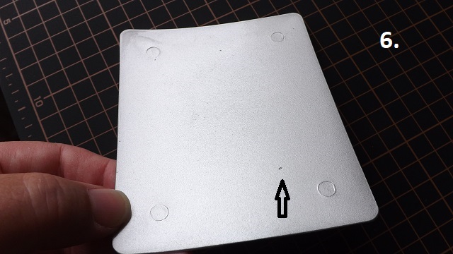

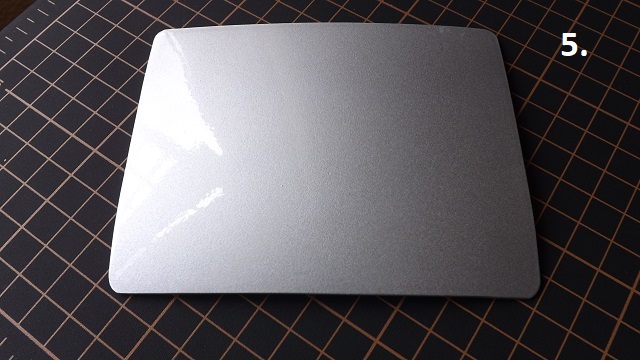

LIFT OUT ROOF PANEL
PICTURES 5 & 6
While the top section is acceptable. There are just 2 minor dust marks that could easily be polished out.
The underside again is not as bad as in the first pack but as arrowed there is a scratch in the finish and again it suffers someone from varnish runoff were the part has been “propped up” to dry and the varnish has pooled into one corner.

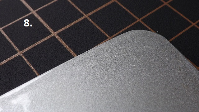

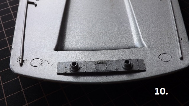

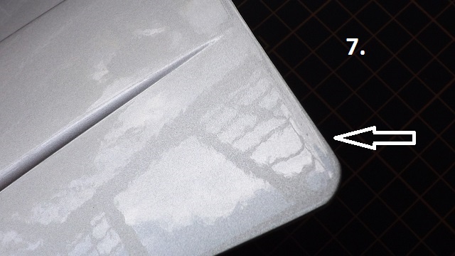

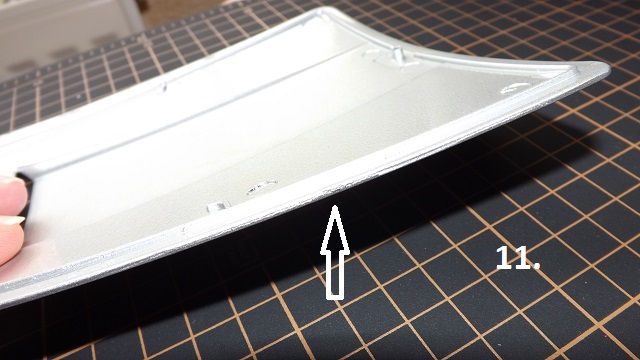

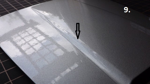

BONNET
PICTURES 7 – 12
The top surface f the bonnet only has one noticeable dust mark as arrowed in picture 9.
However, what it does suffer from again is varnish pooling along one edge (pictures 7 & 8).
I mentioned at the outset the strong smell of paint and this varnish pooling is still soft and you can indent it with a finger nail without having to exert any pressure to do so.
Very noticeable this time (picture 11) is an extremely rough edge as arrowed in this picture. This runs for ¾ the length of this side but were the arrow is shown there is the remains of what looks like the casting tab.
Depending of the bonnet to chassis fit this could stop the bonnet fully seating unless corrective action is taken.
Again, the underside of the bonnet is far from ideal. In no way as bad as the previous part but still some very evident rough finish.
To me it looks like they have painted the part THEN run the sander over it to remove some of the rough spots. This is mostly around what looks like the spot the bonnet hinge will be fitted so at the end of the day this may not be visible once that bracket is in place.

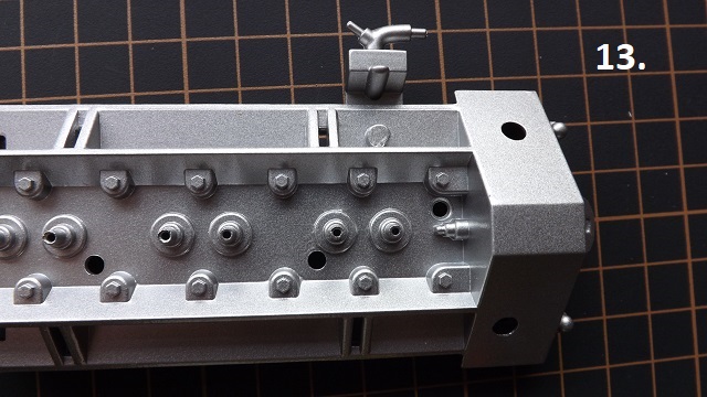

ENGINE BLOCK HALF
PICTURE 13.
No issue at all with this part.

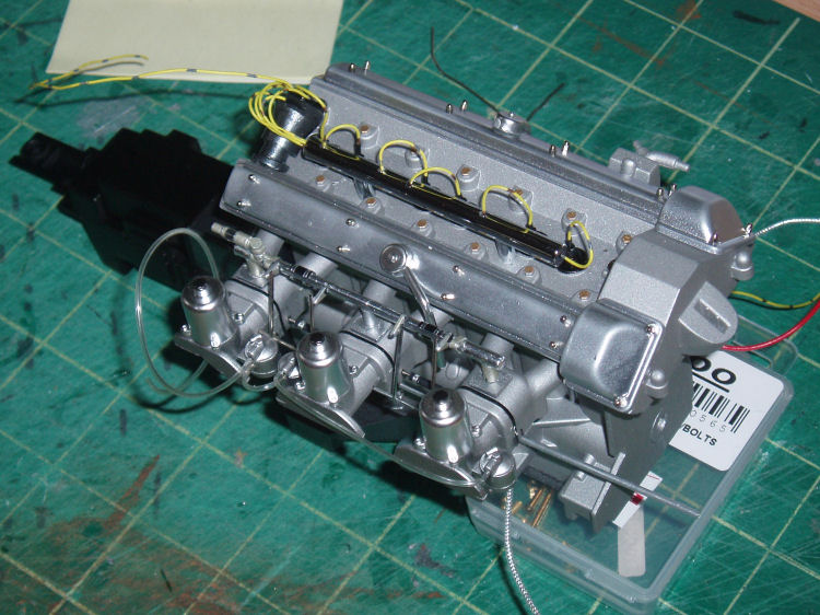

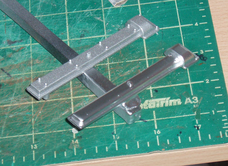

Also bear in mind the engine is actually very wrong in all kinds of areas.
Most notably the cam covers which are nothing like the real thing.
It can all be altered though as I did with my build some years ago, and the one I recently rebuilt/trimmed/carpeted and detailed for someone.

ooh.Roy can you post some pictures of your modifications? Would love to see what you did with the engine
#55 Posted : 04 August 2019 16:55:39
Points: 15,326
Hello Carl.
Here's a link to my post regarding the DB5 I detailed for someone else.
It arrived to me as a complete car so I had to dismantle it and then rebuild it again...
https://forum.model-spac...spx?g=posts&t=31196
