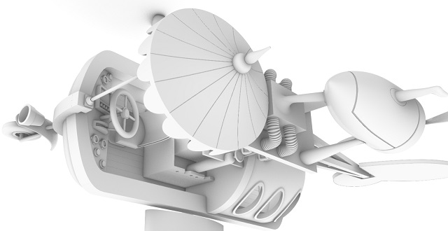

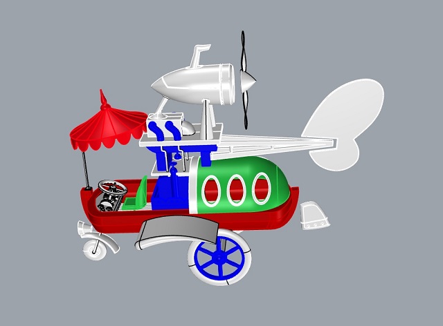

So the main design is finished. The next step is to break this down into parts for printing. Many of the parts are printable as they are, but I will need to put some alignment plugs on the parts to make it easier to assemble the parts.
I am also going to 3d print a rough version.I have found sometimes when you actually print the 3d design it doesnt look right.I found that with the scooter and had to change the dimensions.

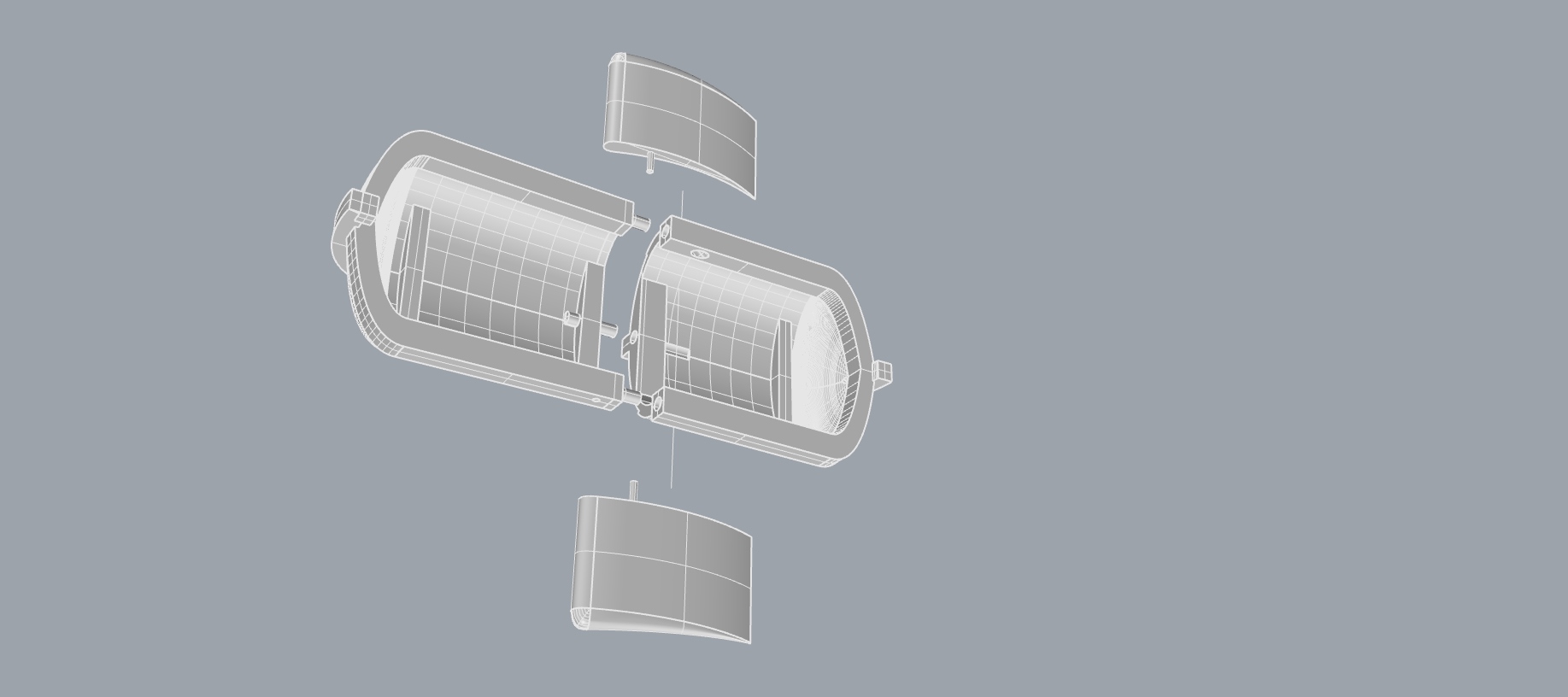

So the next step is splitting up the car into separate parts for printing and making attachment point and plugs so once the parts are printed I can put them back together.If this were a styrene kit this would be the part where the separate parts are put on sprues and the alignment pins are added.
I started with the hull.It is too big to fit in the printer so I split it into 2 parts and added some alignment plugs.The resin printer has problems with holes .The resin collects in the holes so you need to make sure the holes have a way for the resin to escape during the print process.
I will repeat this process for the rest of the parts and will end up will multiple parts to print. The hull alone will take 30 hours to print.

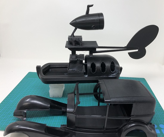

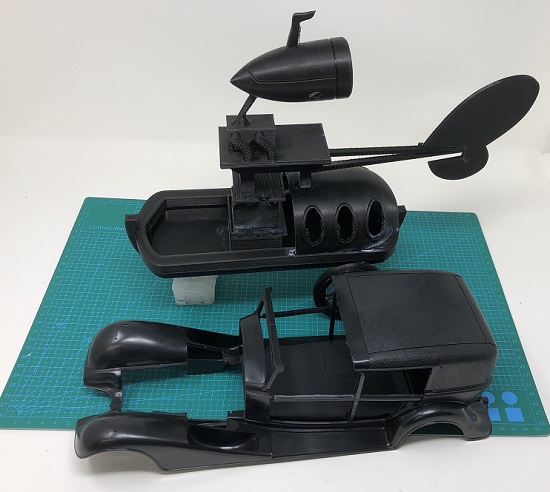

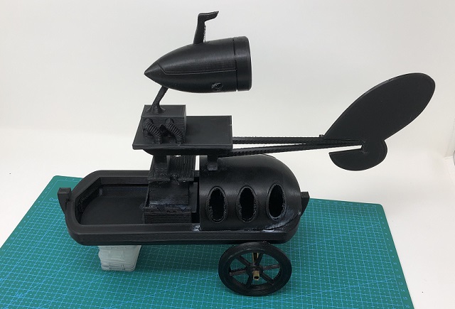

I did a test print with my FDM printer.This was a very rough print to see if the proportions of the car looked OK.I found a 1/16 cadillac kit that I can convert into the Ant Hill mobs car from Wacky races and I put the body shell next to the convert a car for scale.i think it looks good so I will keep it the size it is and continue splitting up the 3d model into printable parts.
