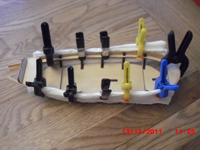

ISSUE ONE PLANKING

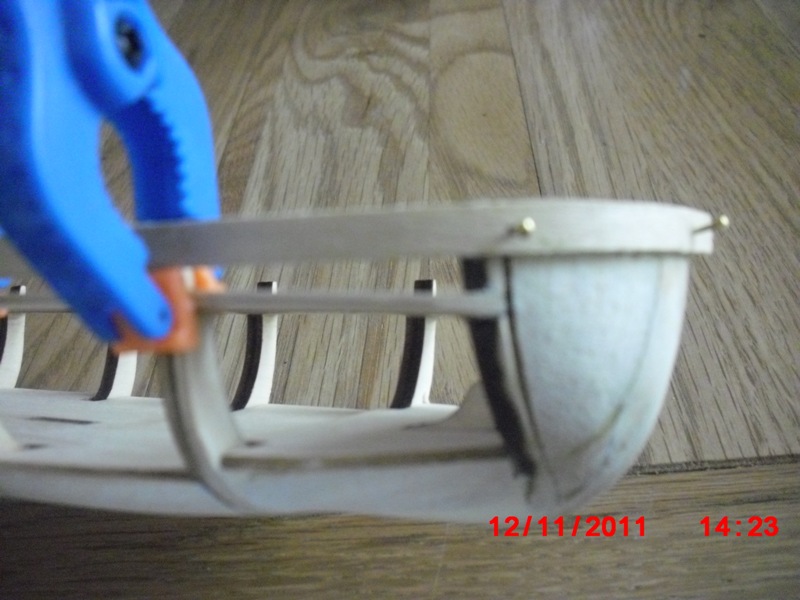

Hi Team the next thing to do is fit the planks, Port and Starboard (left and Right)
I have used pins at the Bow and Stern, but I will take them out when the glue is dry, I do not like to use permanent trenails in any hull that I plank, if the planks are bent naturely then adhesive is sufficient in my opinion, whether the ship be the Victory or this small Longboat.:-

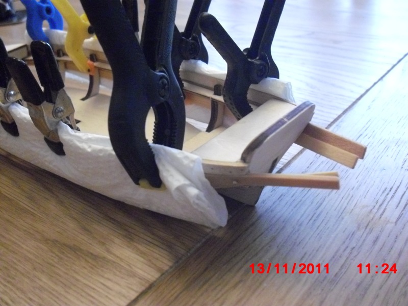

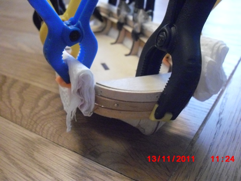

#45 Posted : 13 November 2011 11:52:48
ISSUE ONE PLANKING

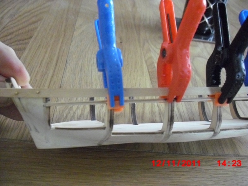

I have now soaked 4 planks 2 for Port 2 Starboard It is important to plank both sides equally so that the Hull does not twist.
When I naturelly bend more than one plank at a time I fit kitchen towel between the clamps and the wet planks, this soaks up moisture and protects the wood from clamp marks.
I will now leave these planks about 12 hours to dry, then I will shape and fit them and glue in place. (AT THE MOMENT THE PLANKS ARE NOT PERMANENTLY FITTED)

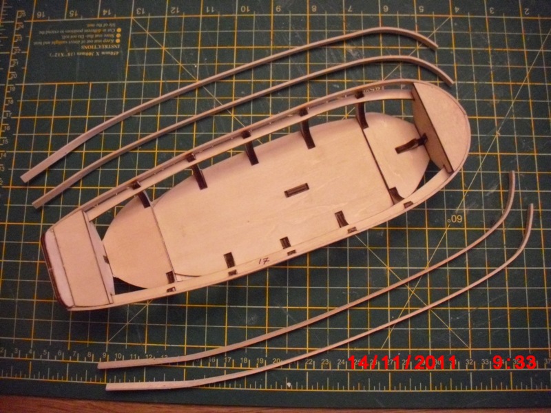

#47 Posted : 14 November 2011 10:42:41
ISSUE ONE PLANKING
Now the Planks are dry, you can see they are perfectly formed to the shape of the Hull ready for trimming and fitting.This way of bending planks takes longer, but in my opinion is more rewarding.
Comments welcomeBigGrin Cool

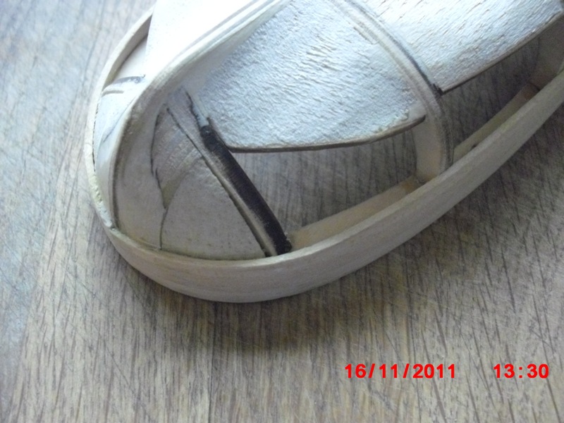

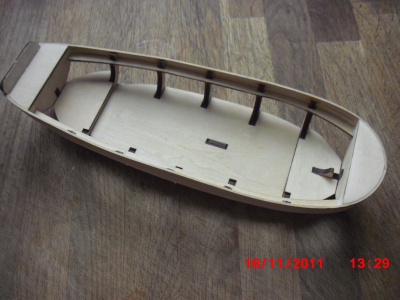

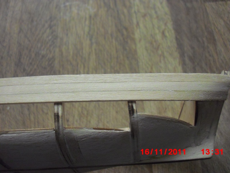

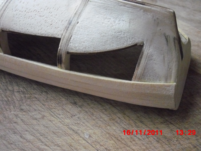

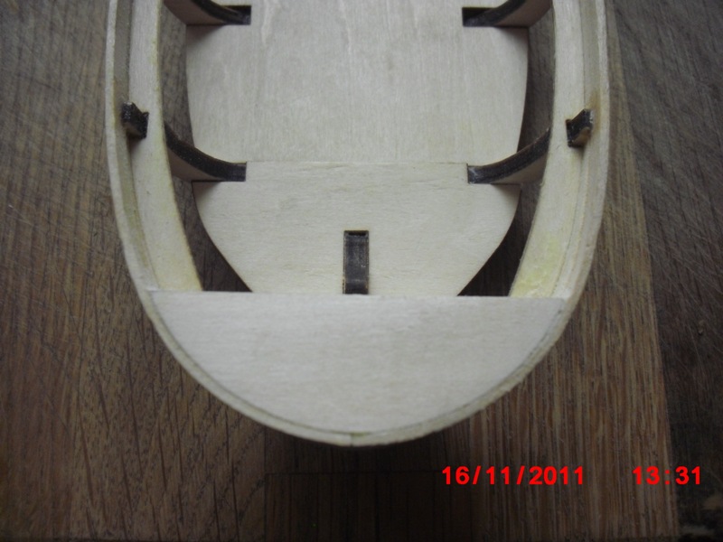

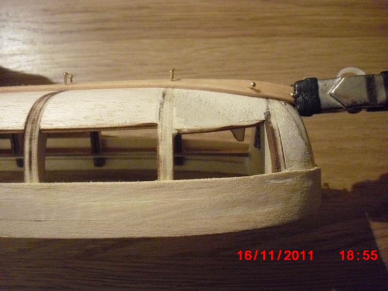

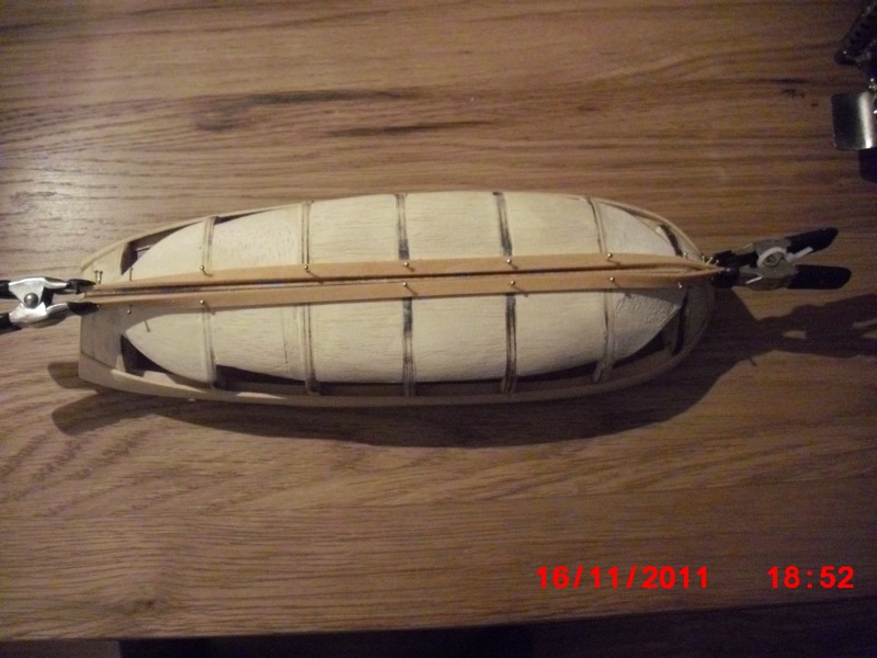

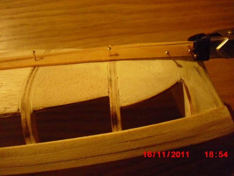

Hi team this is the latest update to the build, I have now fitted 3 planks on each side of the longboat,these are the photos of that build:-

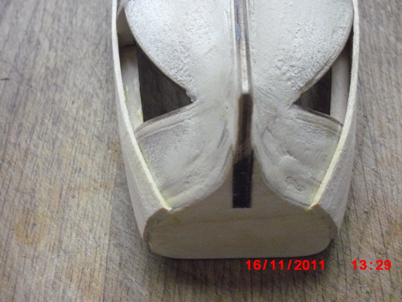

I have now soaked and fitted wet the gardboard planks (exactly the same procedure we all used on the Victory build)I have used pins to hold them in place untill the planks are dry, then I will trim and fit them tomorrow:-
#51 Posted : 16 November 2011 19:29:00
ISSUE ONE PLANKING
I have left a 4mm space between the planks to take the Keel, stem and stern post, thats all for now comments as usual are welcomeBigGrin Cool

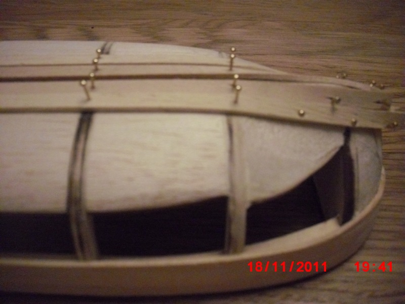

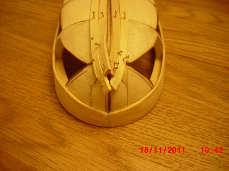

#52 Posted : 18 November 2011 20:03:02
ISSUE ONE PLANKING

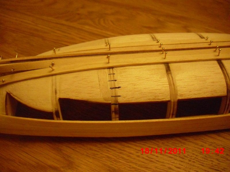

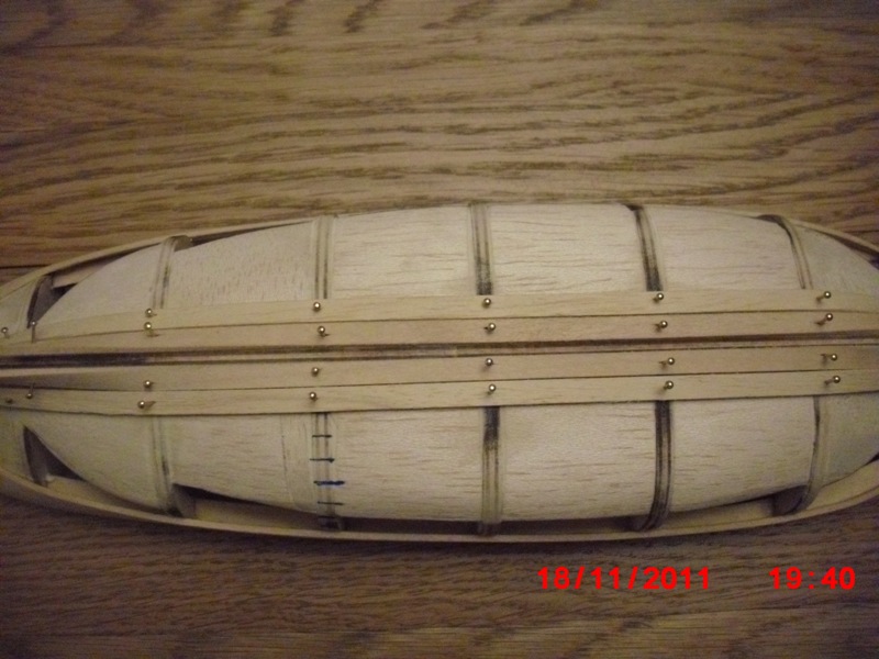

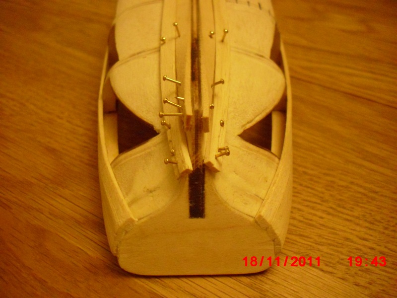

I decided to soak another 2 planks and while wet place and shape them along side the Gardboard planks.
All 4 planks in this area have not been fitted permanently this will be done when they are dried to shape:-

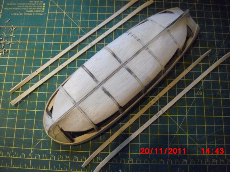

#60 Posted : 20 November 2011 17:24:13
ISSUE ONE PLANKING
Well the planks are dry and well formed here they are:-
