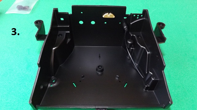

STAGE 25 – THE FRONT COMPARTMENT 2

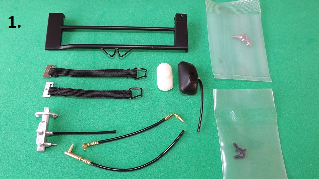

PICTURE 1
The parts included this time are
Upper Cage
Brake Servo
Brake Master Cylinder
Spare Wheel Belts x 2
A/C Dehumidifier hose
A/C Condenser Hose
Brake Fluid Reservoir
Screws
PICTURES 2 & 3

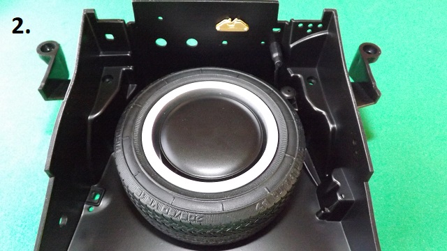

We take the front compartment assemble from an earlier stage and lift out the spare wheel.
Also needed are the 2 x Belt Stopper Brackets that came in the last section.

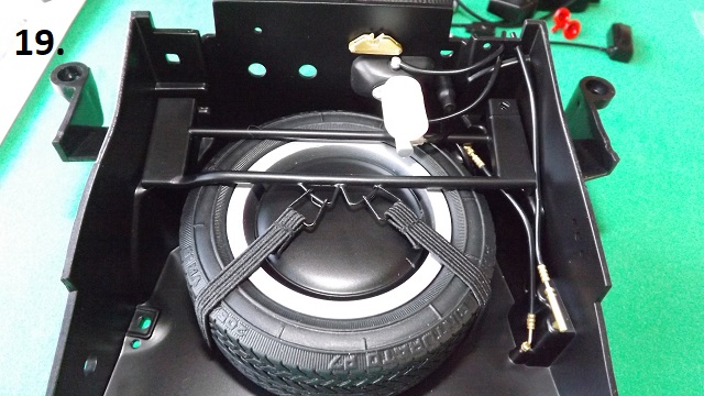

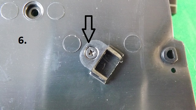

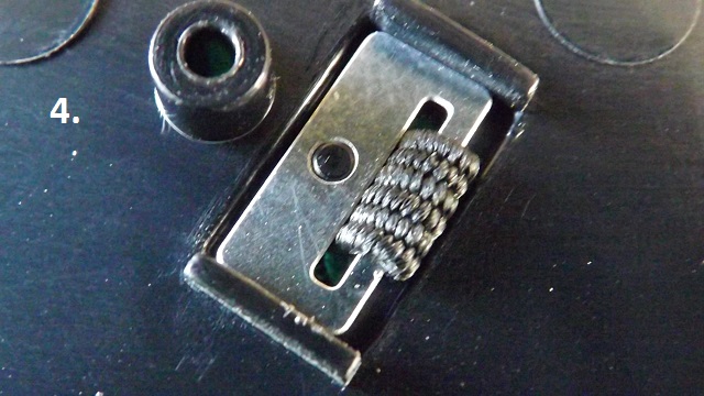

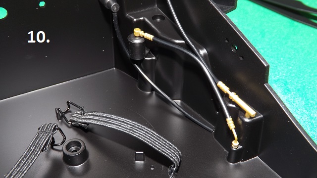

PICTURES 4, 5, 6 & 7

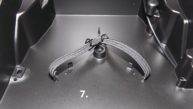

We feed the metal tab from the spare wheel straps through the slots in the front compartment base.
You need to angle these in the get them through.
The hole in each metal tab is placed over the pin as can be seen in
Picture 4.

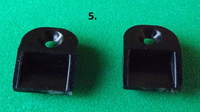

These metal tabs are then retained in place using the Belt stopper brackets (Picture 5 & 6)
Picture 7 shows how the straps look once in place.
PICTURES 8 & 9

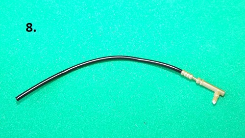

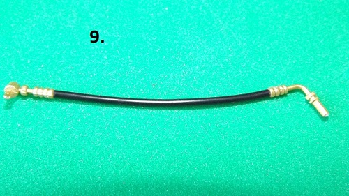

We now take the supplied A/C Condenser hose and the A/C Dehumidifier hose and using tweezers press fit these into place in the front compartment.
PICTURE 10
And this is how things look once the 2 hoses are in place.

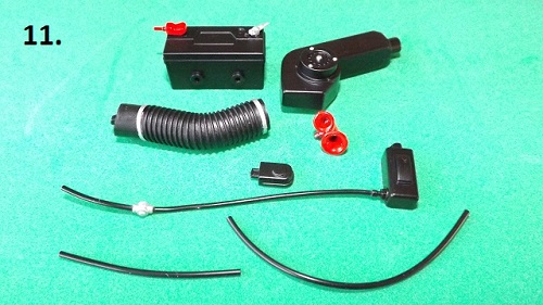

The parts included this time are:
Windscreen Washer Tank
Battery
Clutch Fluid Reservoir
Battery Cable +
Battery Cable –
Heater Blower
Heater Hose
Horn
Screws

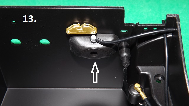

We take the brake servo from the previous stage and ensuring it’s the correct way around (a large and a small pin ensure this cannot be confused) and then press fit this into the bulkhead in the from compartment.
We can see this part in place in Picture 13 indicated by the arrow.

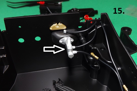

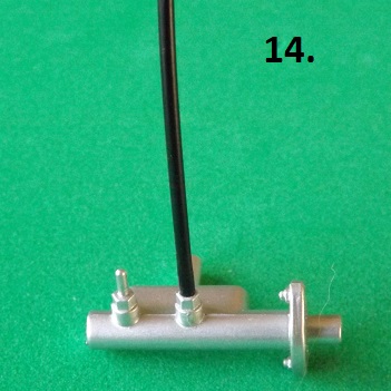

The next part to fit in place is the Brake Master Cylinder. This again press fits into place in the rear bulk head and the lead is fed through a hole in the bulk head.

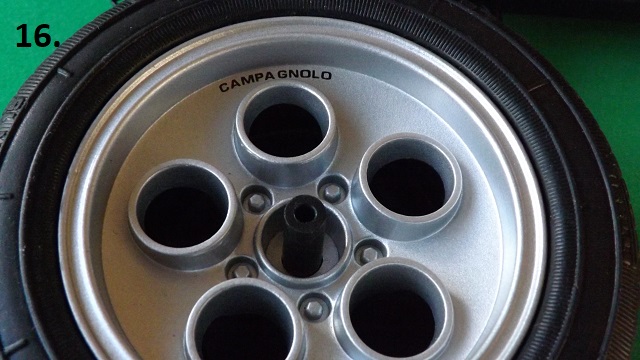

We “say goodbye” to the lovely detail on the spare wheel as this will now be screwed into the front compartment

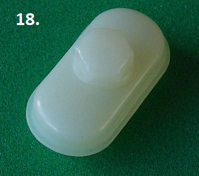

We now take the Brake Fluid Reservoir onto the top of the Brake Master Cylinder. This again is just a press fit and does not require glue.

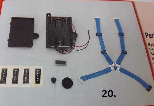

In this stage we get the following parts:
Battery Box and Cover
Seat Belt
Seat Belt Decals (2 are spare)
Ashtray
Gearstick
Gearstick Base
As none of these parts are required at this stage, I have not opened them to ensure nothing gets lost while in storage.

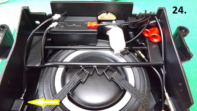

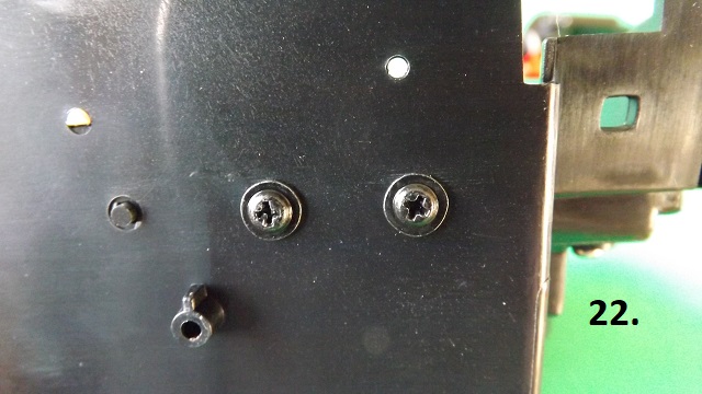

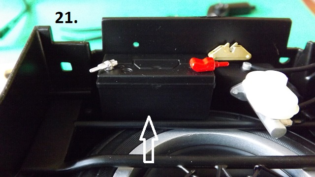

From the previous stage we take the battery and fit this to the rear bulkhead securing it from behind using 2 x M2.3 x 5mm washer screws.
PICTURE 23 & 24

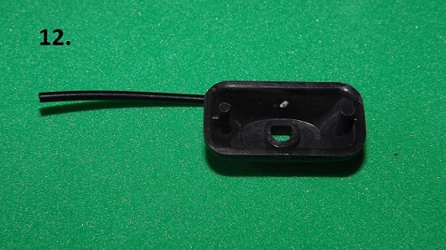

We now take the Windscreen Washer Tank and while the instructions ask you to shape the hose on mine it never retained the shape it is supposed to take on so need to do that again and apply some gentle hairdryer heat to set in to the required shape.
You could also remove the hose an insert a small diameter piece of wire into the hose as this would allow the shape to be retained.
Picture 24 shows this part in place with its hose running out through a hold in the rear bulk head.

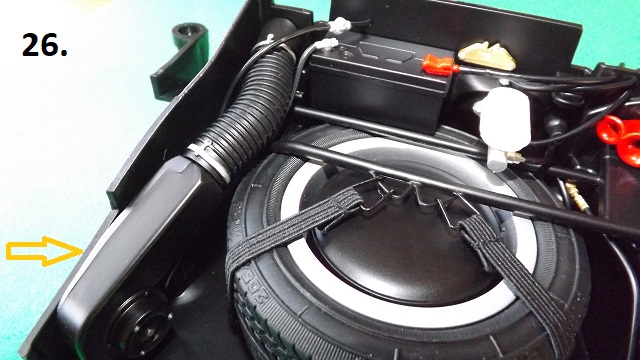

PICTURES 25 & 26

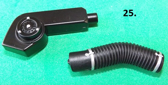

We now press fit together the Heater Blower and Heater Hose.
This is put into place and secured in position with a M2.3 x 5mm washer screw.
Picture 26 shows the Front Compartment with the battery leads, Horn (Red part) and hear parts in place.

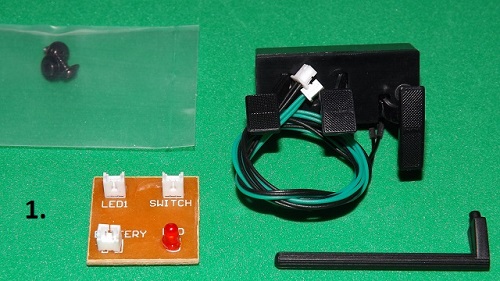

Passenger Foot Rest
LED Test Board
Pedal Switch Plate
M2.3mm x 5mm Washers screws x 3

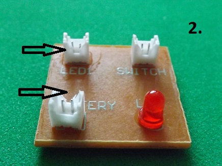

PICTURES 2 & 3

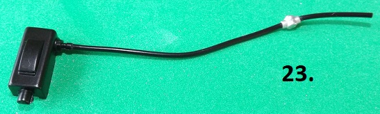

We need to make a small modification to the test board – namely removing a small section from each of the white sockets so we can remove the plugs without issue when the tests are complete.

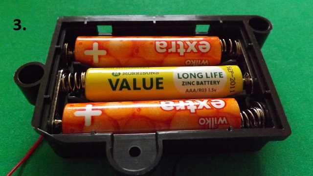

We also need to use 3 AAA type batteries in the battery box that was supplied in Stage 27 (Not to self – get yourself some decent batteries Tony 😊)

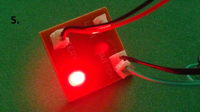

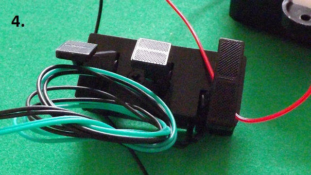

PICTURES 4 & 5
At this stage we are told to plug Red/Black lead into the socket marked “SWITCH”. Press the corresponding foot pedal and we should see the Red lead on the test board light – success.
We then carry out the same exercise with the Brake cable (lead with 2 green leads)
The foot pedal unit is no longer required until later in the build so for now we remove the batteries from the battery box and store these parts away until called for again.

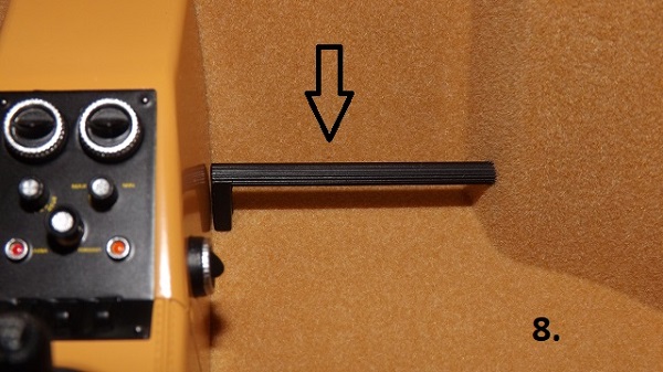

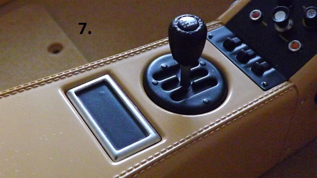

Final part of this build stage is all press fit. First the gear shift quadrant is press fitted into place followed by the gear lever (this is keyed with a “D” shape profile so you can only fit this one way – the correct way)
The ashtray is then press fitted into the centre console and we finish off this section by fitting the passenger foot rest.

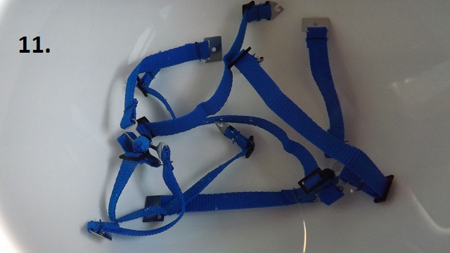

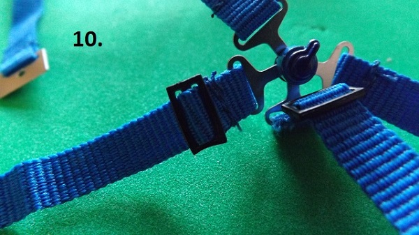

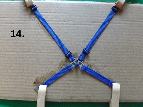

The first thing we are asked to do is move the seat belt adjusters to the ends of each strap.
In order to try and remove some of the creases in the belts we are asked to soak them in some warm water for “several minutes”.
PICTURE 14
Having soaked the belts in water we are then asked to stretch them across a piece of cardboard and allow to dry out.

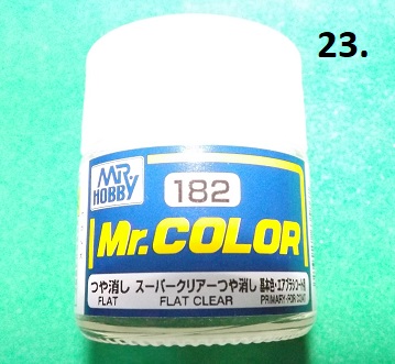

The instructions go into some detail on how we can make the seatbelt decals look more “Natural”. As supplied the self-adhesive decals are a high gloss finish.
They recommend spraying the decals with Mr Color Metal Primer. When that is dry, they then suggest spraying with Mr Color Matt Varnish.
While I had the primer, I did not have the Matt Spray (and for a one-off task like this I think the cost excessive) so I used Mr Colour Flat Clear from a Jar.

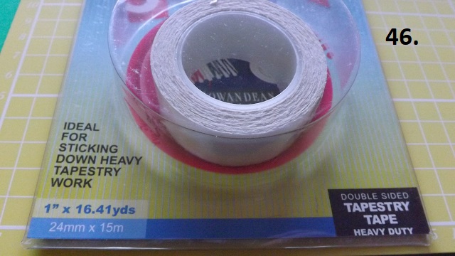

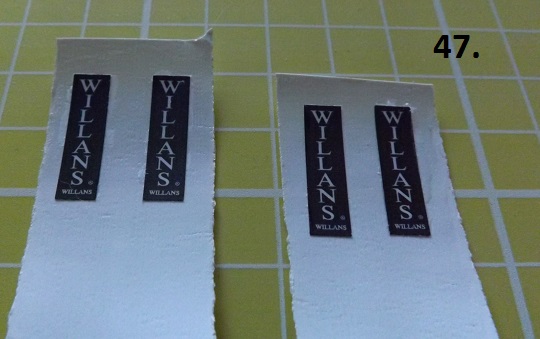

PICTURES 46 & 47
Once the decals have been varnished and are nice and dry, we are then asked to fix these onto some double-sided tape.
Now I thought about this and standard double-sided tape can discolour, or become “gooey” over time. So, I opted to use a tape designed for securing tapestry and cross stich canvases.
Picture 47 shows the 4 decals in place on the double-sided tape. We then need to use a very sharp craft knife to cut around the edges.

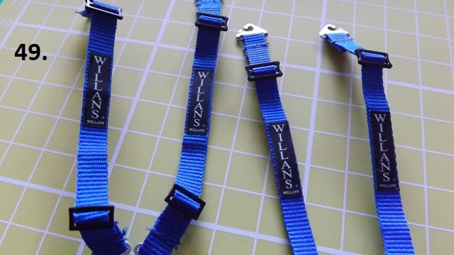

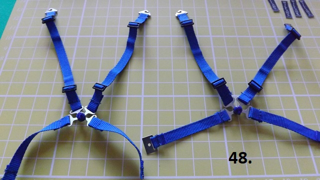

PICTURES 48 & 49
Having dried out the previously soaked seatbelts we are ready to add the decals. I never managed to get all of the creasing out of my belts but I am happy enough with how they look.

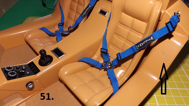

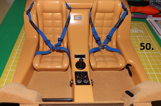

The lower ends of each seat belt fit into a matching slot under each of the seats. The seats are then lined up with the holes in the cockpit floor and are secured in place with 2 x M2.3mm x 6mm ST screws.
The upper seat belt parts are secured over the pins in the cockpit tub.

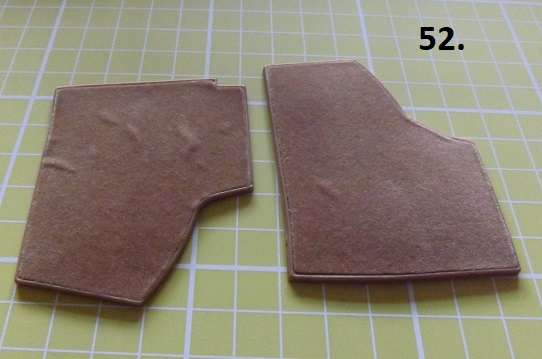

PICTURES 52, 53 & 54

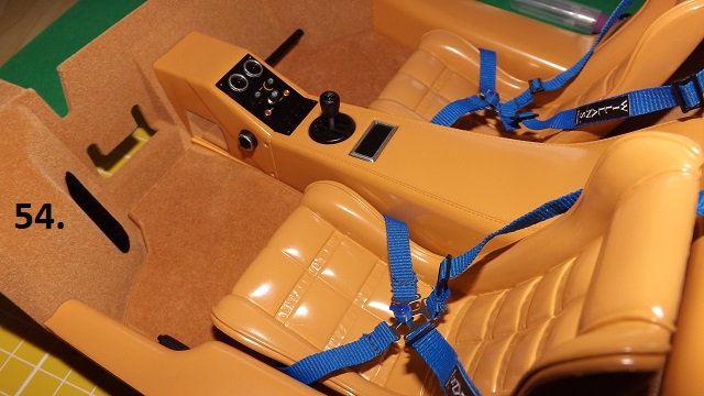

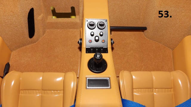

The last part of this stage is to add the 2 foot mats. Unfortunately, mine appear to have some wrinkles in them but I am not going to worry too much about this and have put both into their respective places as can be seen in pictures 53 and 54.

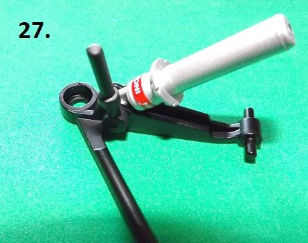

STAGE 30 – ATTACHING THE REAR SHOCK ABSORBERS

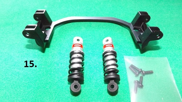

PICTURE 15
The Parts included this time are:
Rear Shock Absorber Bracket
Rear Shock Absorbers
M2.6 x 8.5mm screws x 5

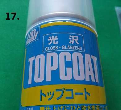

PICTURE 17

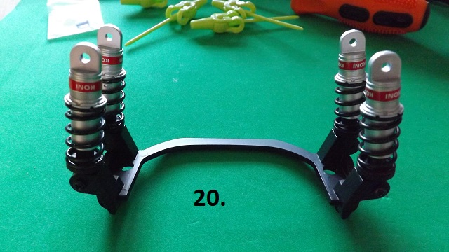

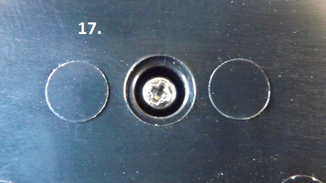

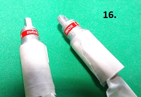

In this and some of the following stages we are asked to gloss coat certain areas of the shock absorbers.
PICTURE 16
We mask off the areas indicated in the instructions to just leave the top sections of the shock absorbers ready for a gloss coat.

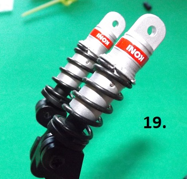

PICTURE 19
When dry we fix these 2 shock absorbers in place in the support frame using 2 of the M2.3 x 8.5mm screws.
You just need to ensure you leave the shock absorbers able to move once in position.

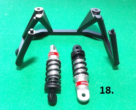

PACK 10
STAGE 31 – FITTING THE SECOND SET OF REAR SHOCK ABSORBERS
PICTURE 18
Rear Shock Absorber Bracket (Lower)
We follow exactly the same sequence as before and mask up both shock absorbers ready for a selective gloss coat.
PICTURE 20
When dry these 2 remaining absorbers are fixed in place on the shock absorber bracket.
#59 Posted : 31 December 2019 22:59:03

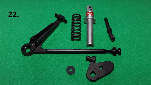

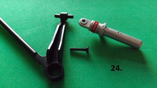

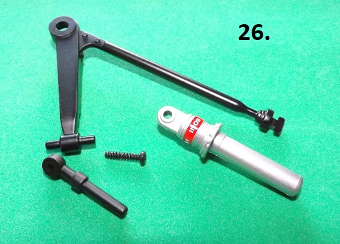

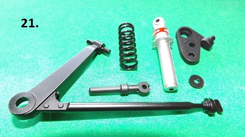

STAGE 32 – THE LEFT FRONT SUSPENSION ARM
PICTURE 21
Left Lower Front Suspension Arm
Anti-Roll Bar Link Rod
Front Shock Absorber
Front Shock Spring
Left Upper Front arm Pivot
Washer A
M2.6mm x 12mm Self Tapping Screw x 3

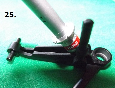

PICTURES 24 & 25
Having again gloss coated the top section of the shock absorber we are asked to screw this into place along with the anti-roll bar using one of the M2.6mm x 12mm screws.
#60 Posted : 31 December 2019 23:01:23
STAGE 33 – THE RIGHT LOWER FRONT SUSPENSION ARM
PICTURE 22
The Parts Supplied this time are:
Washer A
Front Shock Spring
Right Upper Front Arm Pivot
Right Lower Front Suspension Arm
PICTURES 26 & 27
Again, very much of a repeat part of the build with the upper part of the shock absorber being gloss coated.
We then screw all 3 parts together as shown in picture 27.
