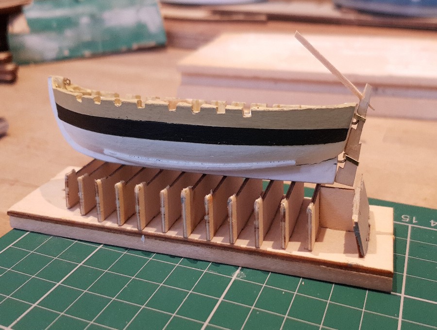

Another side pic of the launch with tiller....
The arm on the tiler is a tad high but as a first attempt im happy....

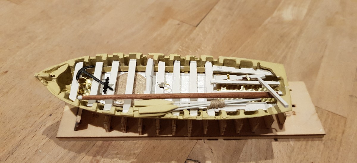

Happy to announce that the launch is completed.
Rope coiled.
Anchor painted.
Oars painted.
Mast tappered trimmed and the tip painted...
Tiller put into the launch....
Only issue is have is that the oars seem short and of various lengthsMellow

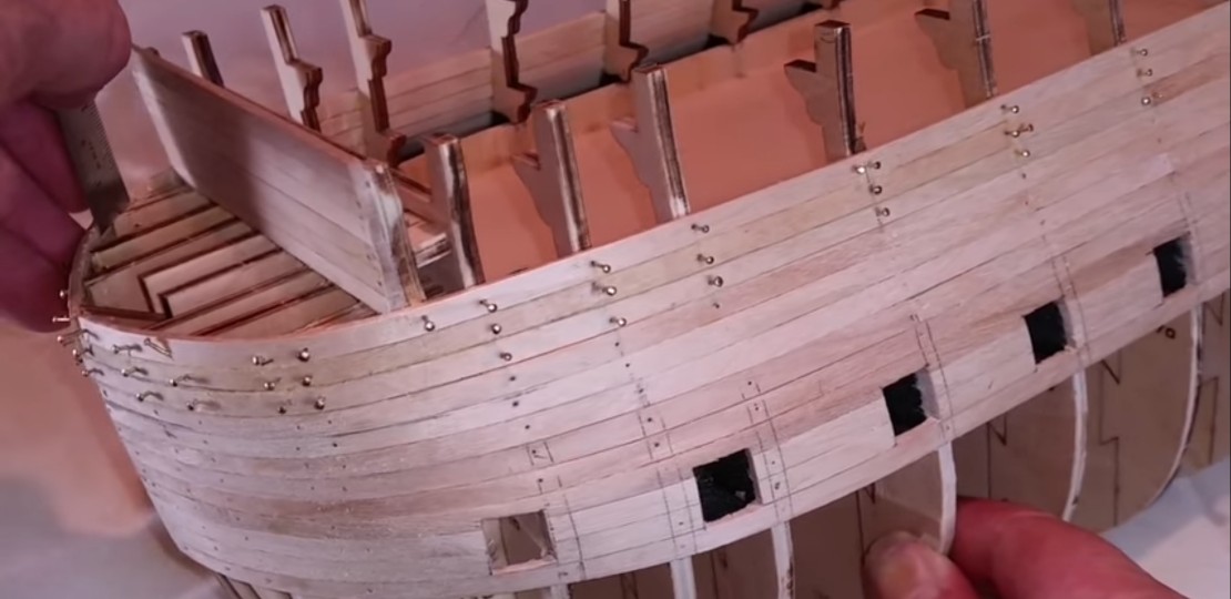

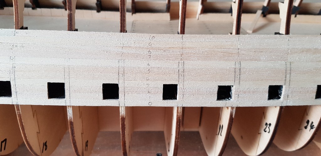

Ive been quite busy on the build and managed to plank upto the bowformers and this where ive hit a problem perhaps im wrong....
On the offical build video which i have followed shows 11 planks up from the bottom of the lower deck to the bowformer this is the first picture...
The one below the i call 0(zero as it is below the deck)
The second picture shows my victory but from the lower deck upto the bowformers its only 10 planks...
The one below the lower deck i call 0(zero as it is below the deck)..
Help is appreciated to where i have gone wrong....
TBH i didnt see it as an issue until looked again at the video...
Planking as gone better than i expected...
If i have to remove the planks and start again i will do but it jave to be so carefully as not to damage any of the deck edges and the ribs..

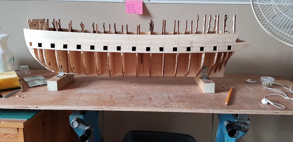

Here is a full picture of what i have achieved so far...

This looks all very neat!
In my opinion there is no problem - every build is slightly different and you don`t have to stick to the words or in this case the number of planks every time.
As long as there are no gaps and the planks run in a natural curve - as is the case here - everything`s fine!
Keep up the good work!
#57 Posted : 03 May 2019 09:33:25
I think it all looks very good and very neat work throughout... You would be surprised at the variances you will find in the width of planks, they are at least 5mm wide and some can be as wide as 5.2mm and these small variances can add up as you lay more rows, this is part of the reason why all builds are slightly different. Important thing here is ensuring the first row of planks you lay is exactly where the instructions say and from there all of your markings are set correctly. With what I see I would carry on as you're doing but would suggest you post pics a little more often, this gives us the chance to spot anything that may cause you problems later in the build.... Looking good, very well done....Cool Cool
