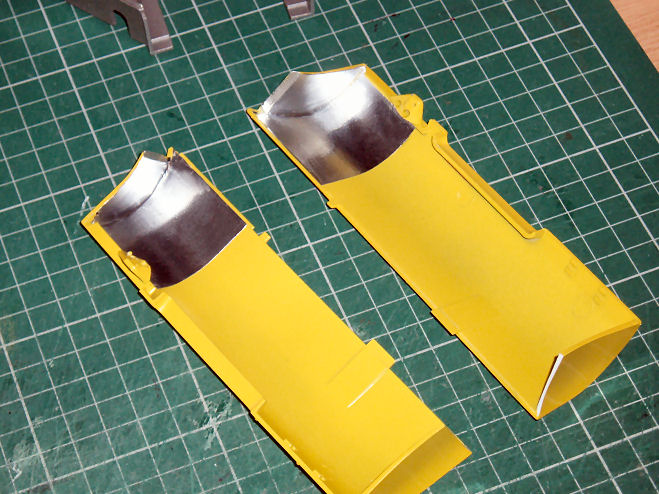

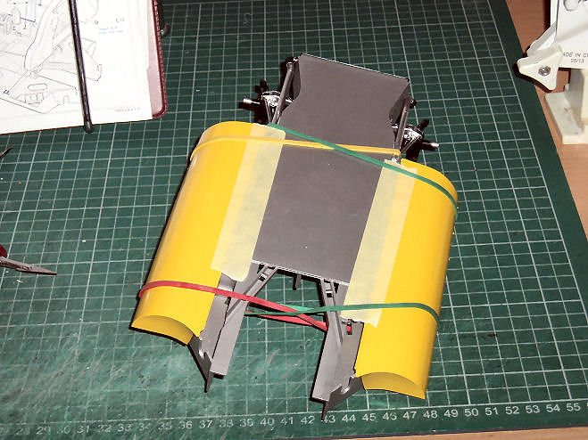

Side tanks have been foiled at the ends on the inside as this area shows with the panels in place.
Onward and upwards...

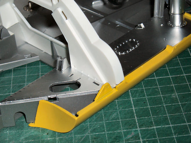

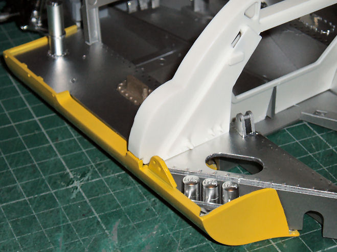

An update again on this one.
It's an old Tamiya kit which is becoming more apparent as I move on.
There is quite a lot of flash, seam lines and ejector pin marks. All unusual for Tamiya these days.
Also, I'm finding quite a lot of parts that don't actually fit together very well.

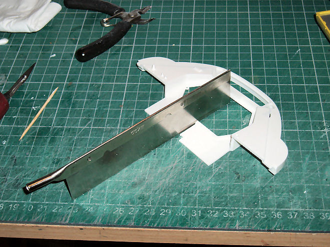

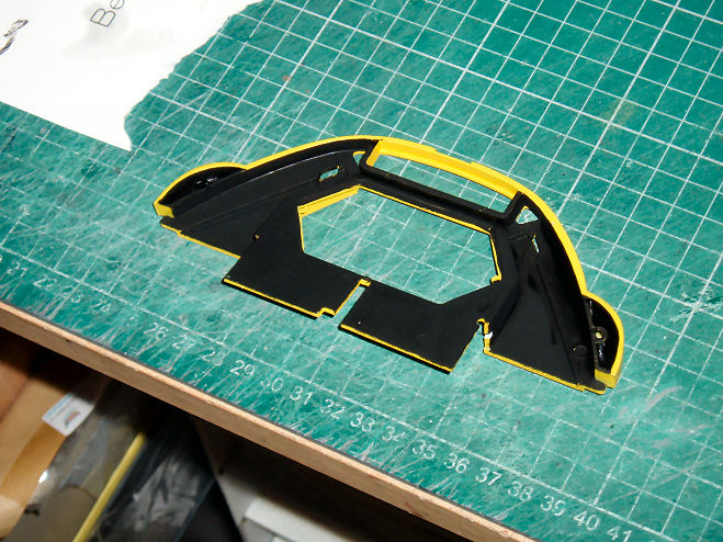

The latest is the rear bulkhead wall.
The floor tub is a one-piece moulding and the side fuel tanks go straight onto it.
When you put the rear wall in place, it's about 2mm narrower than the base which creates a step in the side of the body where they join.
My fix was to cut through the thin spar in the middle of the lower firewall, and add a piece of plastic strip.
It flexes the rear part wider at the bottom without deforming anything.
Still not quite enough though to take up the total space.
I also added very thin plastic strip to the outer surface of the firewall body.
Result - the parts now line up.
Ready for paint and fitting.

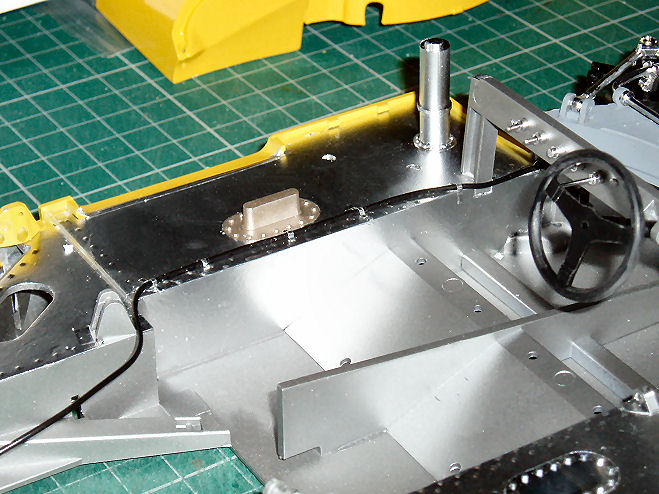

The front of the cockpit was also cleaned up of flash, pin marks and seams, then painted.
It's only sitting on the floor at present. Lots more to do before fitting.

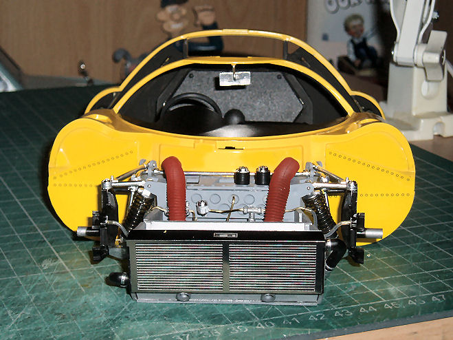

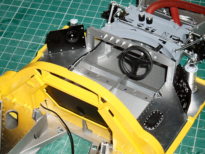

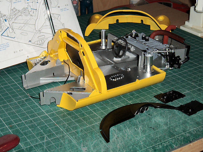

The rear wall is now painted and just placed for test fit.
I'm fairly pleased that the join is neat where it meats the side tanks.
Nothing 'stuck together' with the upper body parts just yet.
I have added a fairly prominent piece of wiring to the passenger side pontoon, that is in the actual car.

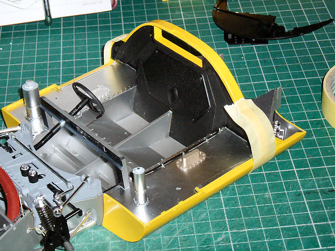

Still proving to be a fun build...

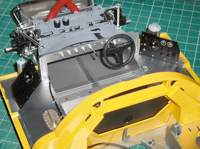

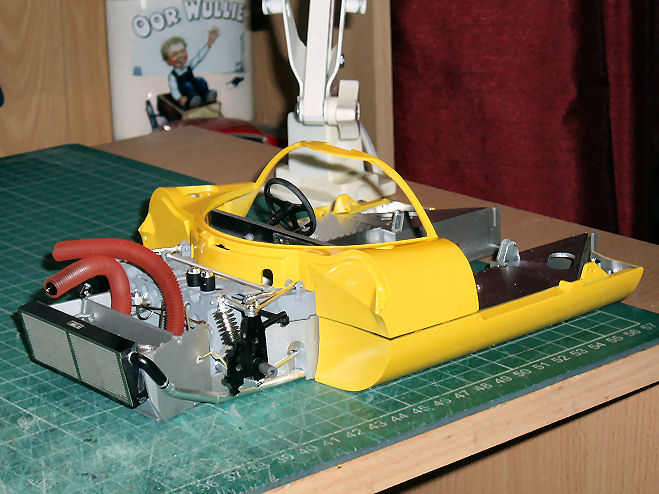

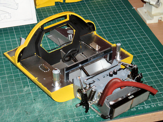

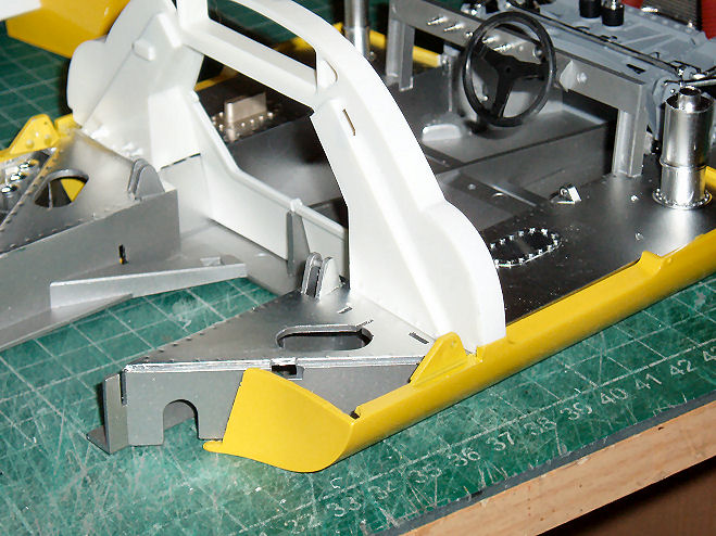

The rear firewall is now installed.
It took quite a lot of trimming and fettling at the lower edges to get a good flat fit.
Once again - an old kit...
Inner dash panels painted with a bit of detail painting done.
A touch of artistic licence - I know, the gauges shouldn't have chrome bezels but just leaving it all black looked dull.

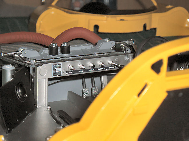

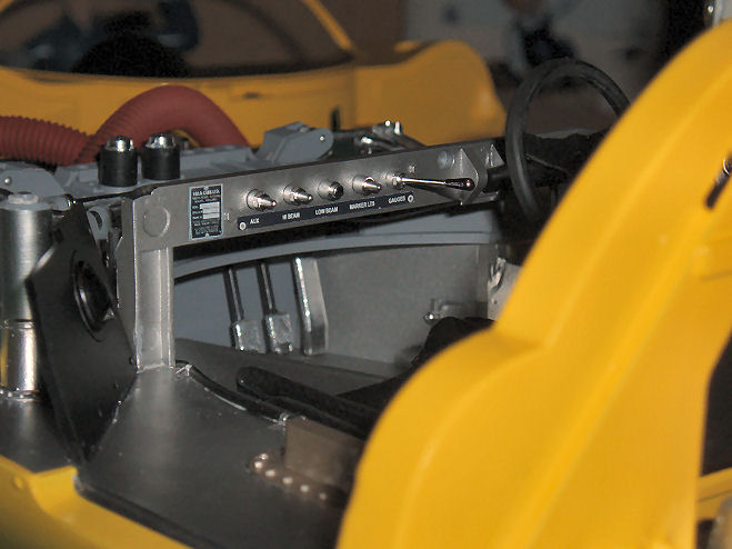

Side dash panels decalled and added.
The rest of the car decals have been made and now printed.
On we go...

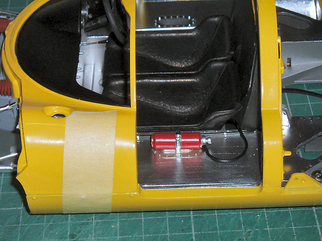

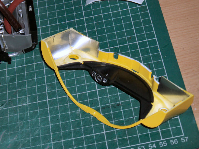

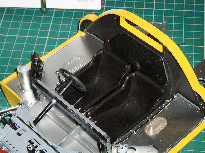

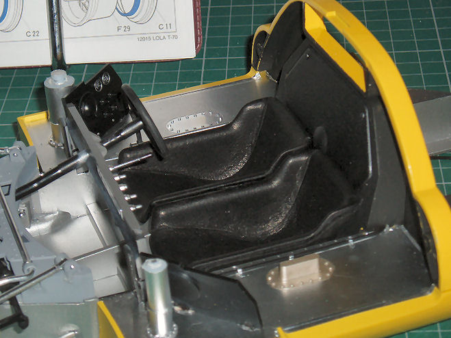

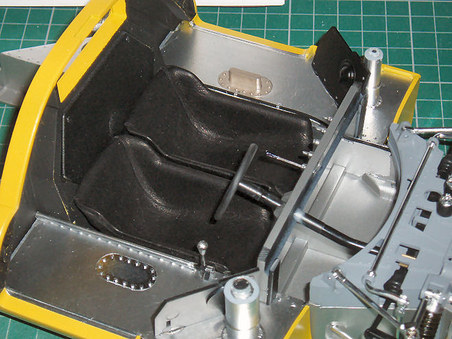

I foiled inside the front body section as part of it can be seen under the dash if you open the doors.

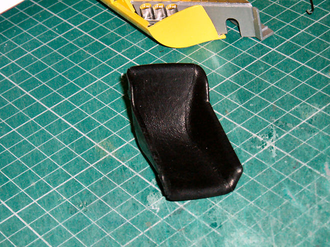

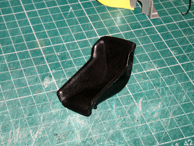

Also, I leather covered the seats.
Well - I couldn't just leave them plastic...

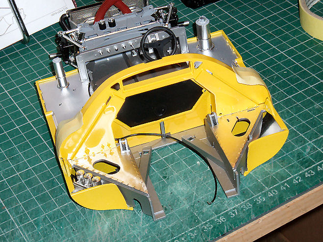

Regarding the decals - switch panel now added as well as the Lola chassis plate.
The images were taken from photo's from the actual car.

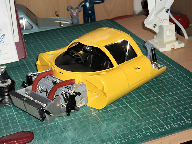

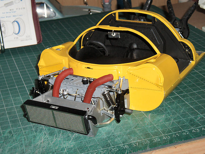

The front upper body is now also permanently in place, as well as the fire extinguisher.
Again, some rivet decals added along the front edges of the body...

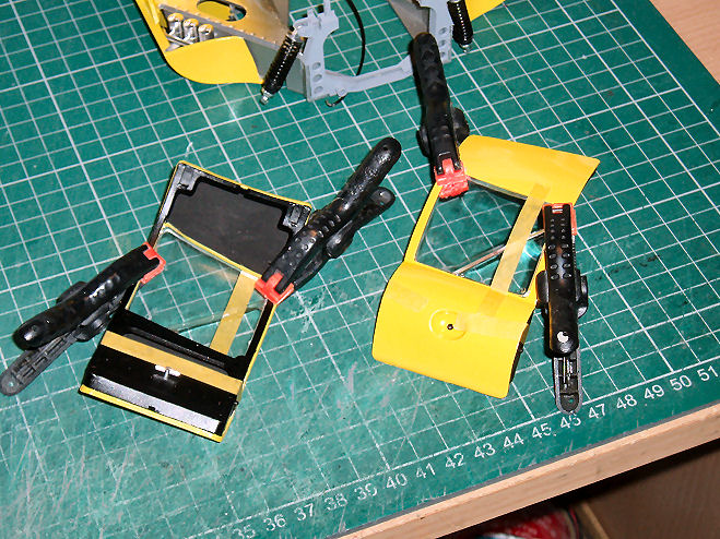

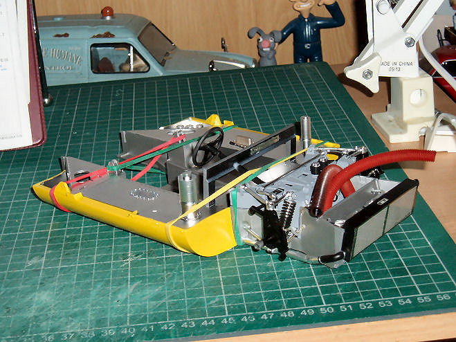

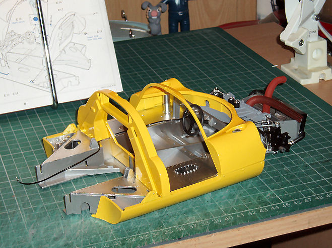

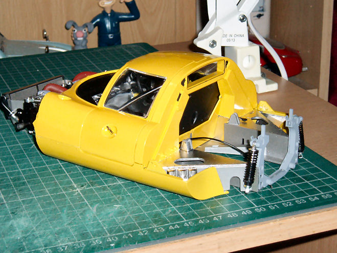

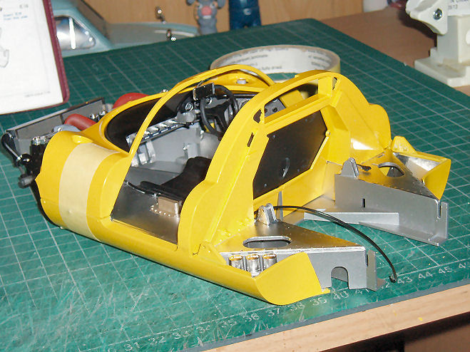

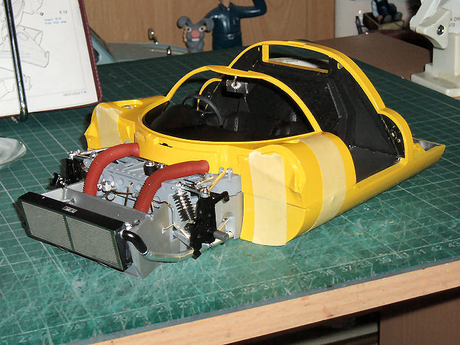

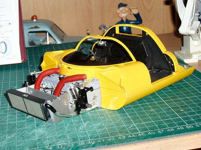

I've now assembled the doors and roof support section but as yet it's all only test-fitted.
More to do with the doors still unattached to the main tub.

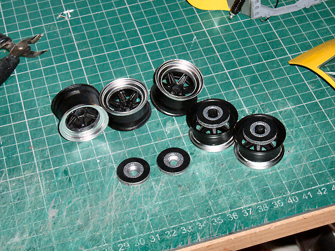

Wheels now also put together, with some really nice (but almost pointless) etch parts for the brake discs.
Funnily enough, the rear tyres seem almost a bit too wide to fit the rims.
Too bulbous on the sides and quite difficult to fit.
Anyway - no we go.
