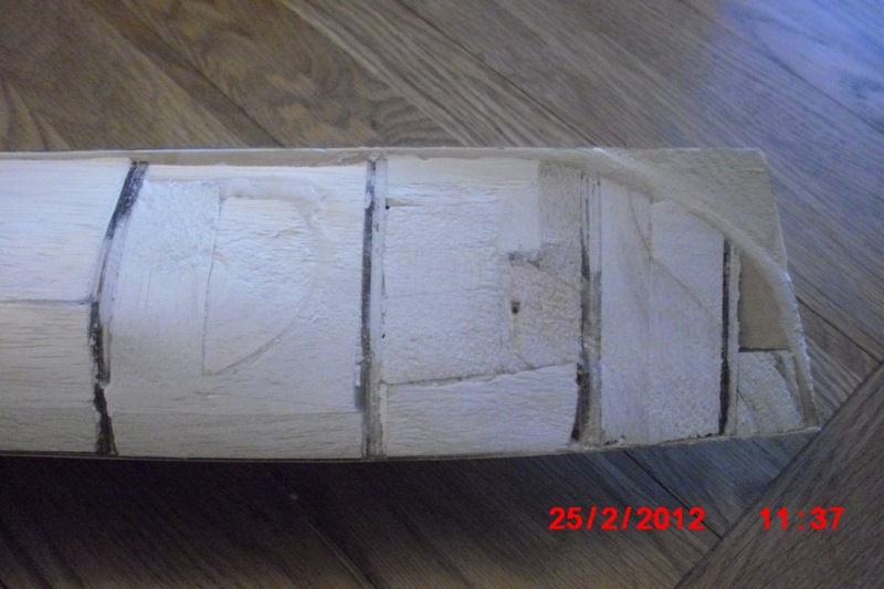

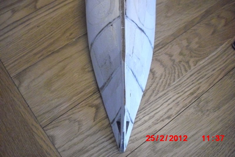

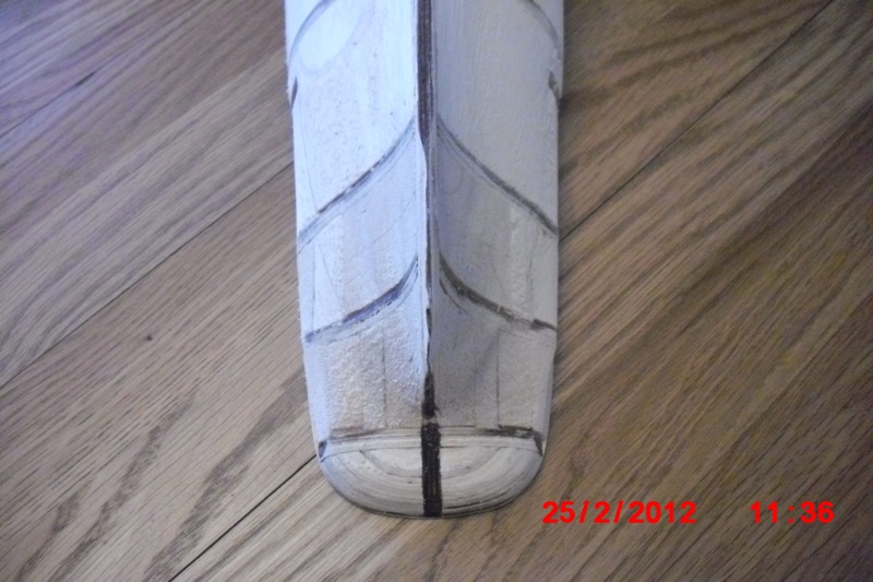

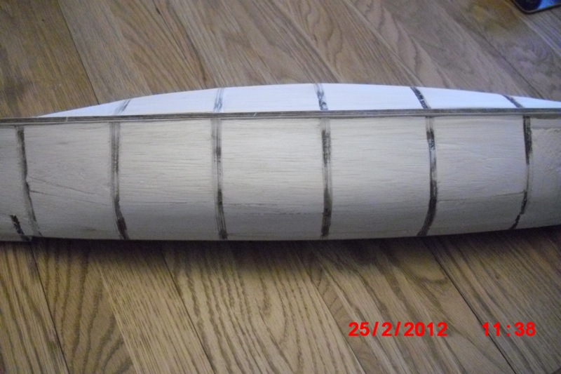

HULL WITH BALSA FILLETS
Hi Team the Balsa has now been sanded,faired and formedBigGrin all I have to do now is a little more medium sanding,the shape at the stern is great fof fitting the planks,see what you think:-
Questions and comments welcomeBigGrin Regards MikeBigGrin

#48 Posted : 09 March 2012 00:37:46
hi mike.
Very tidy filliting, looking forward to seeing your mahogany palanking Ian Cool

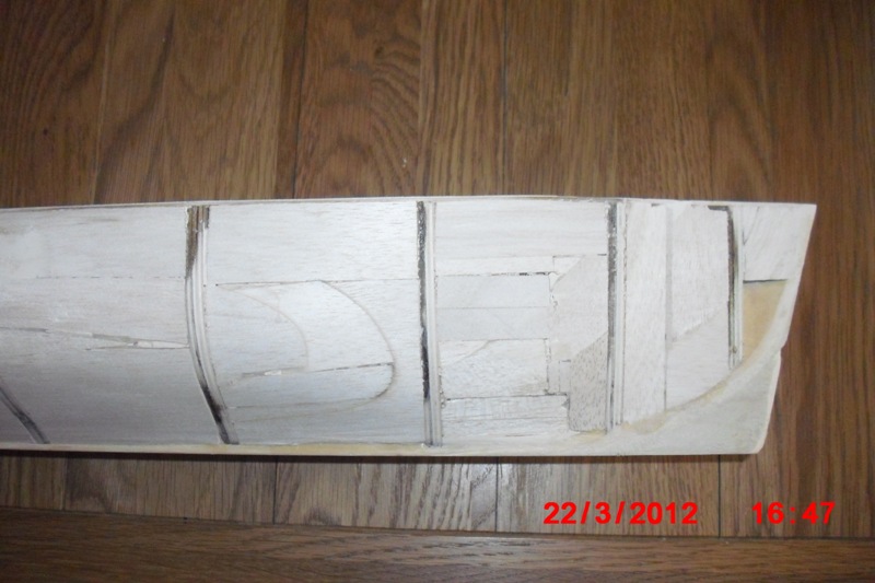

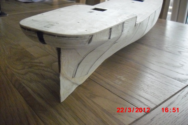

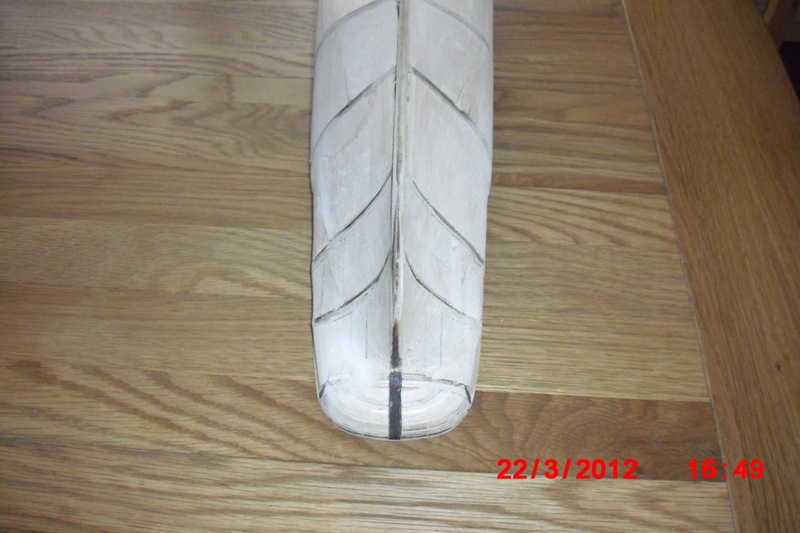

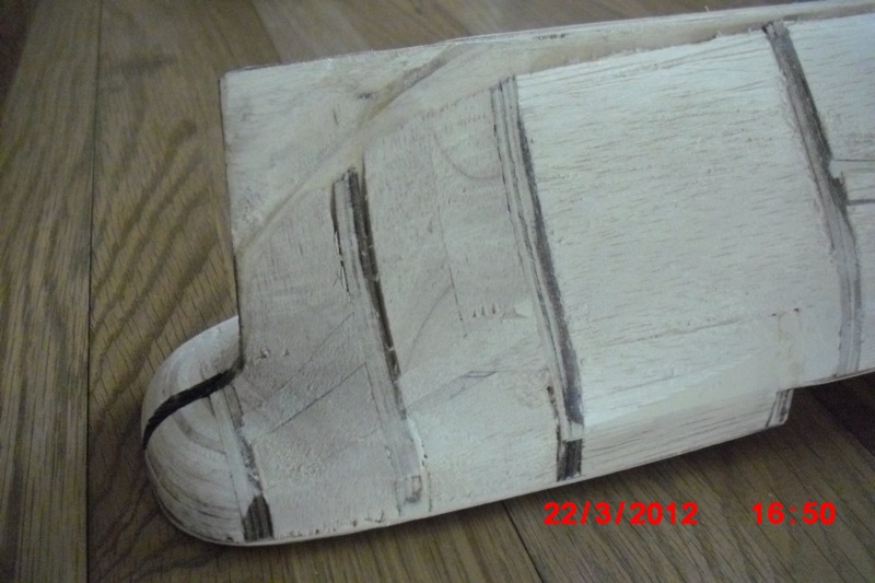

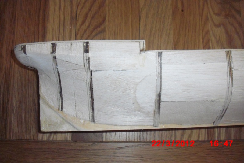

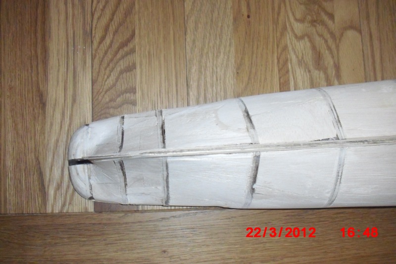

#51 Posted : 25 March 2012 20:02:46
BALSA FILLETS ON THE HULL
Hi Team as you know I have been fitting the whole Cutty Sark Hull with balsa wood here is the finished job:-
budgie
#52 Posted : 25 March 2012 20:07:04
Joined: 20/03/2010
Posts: 1,199
Points: 3,473
Location: Glenrothes
BigGrin good stuff Mike bet she weighs a lot more now
Cool me thinks you will be glad to start planking now
#53 Posted : 25 March 2012 20:09:44

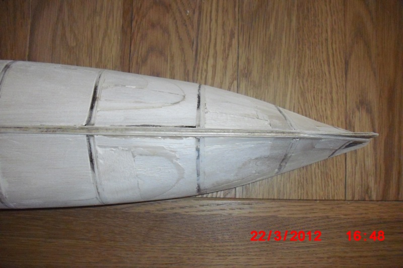

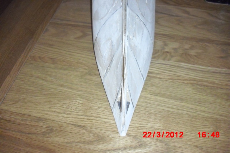

The last two photos show how easy it has been to get the shape of the Stern using this balsa method.
I am really pleased with the outcome, I have a great base to start my plankingBigGrin Questions and comments welcome.
Regards Mike
#54 Posted : 25 March 2012 20:12:08
Hi Budgie you are spot on, on both countsBigGrin Regards Mike
