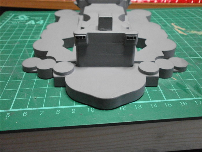

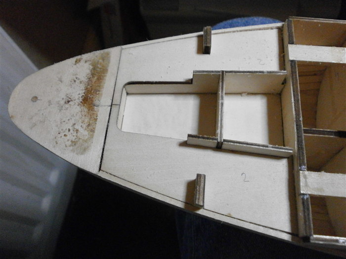

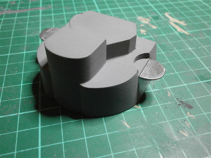

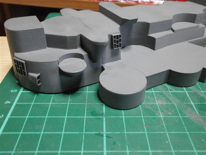

pack 6 arived in the week,so iv been fetling since then getting pieces to fit
#44 Posted : 26 November 2011 00:22:37

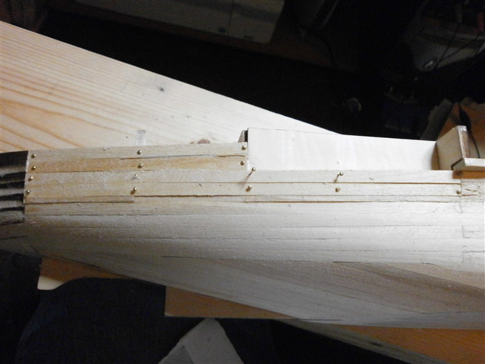

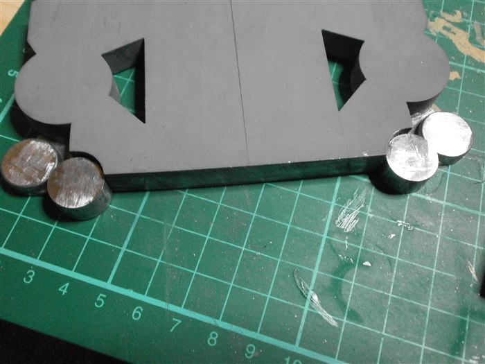

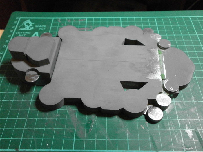

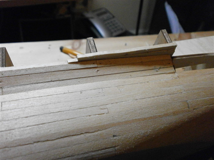

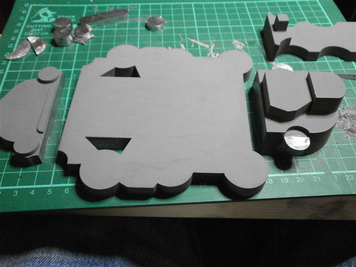

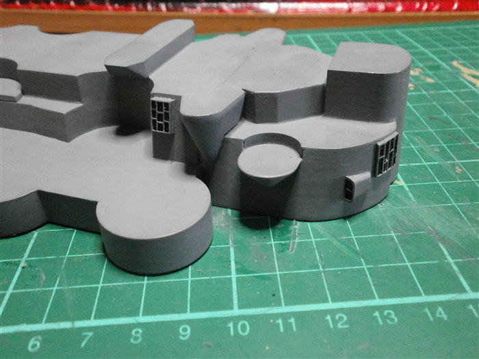

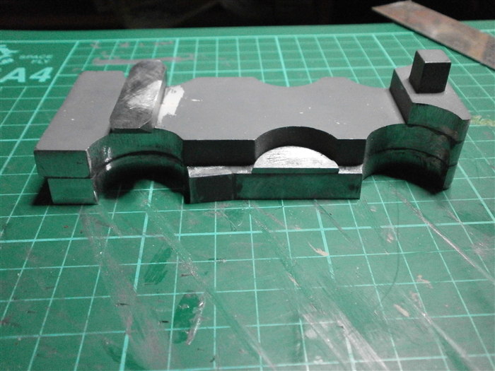

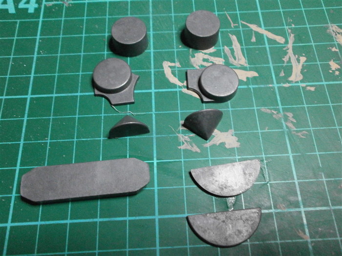

BigGrin Added the rear parts as instructed then used some filler on the gaps,some filler filling still needed around the bridge area
#45 Posted : 26 November 2011 00:30:08

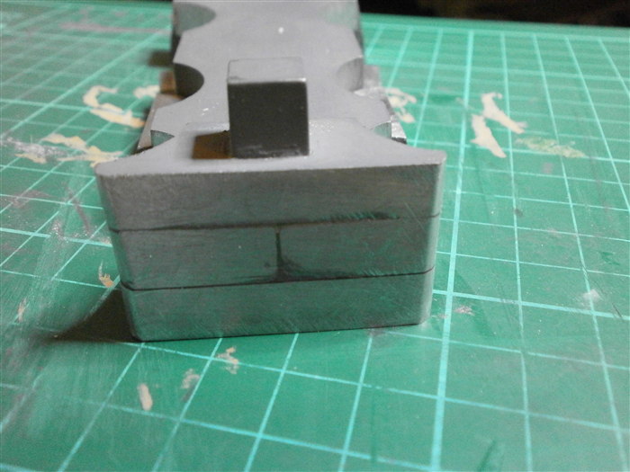

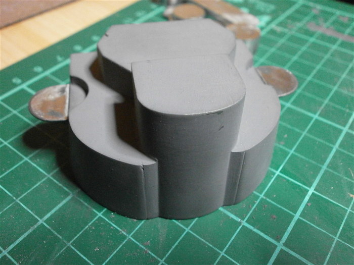

BigGrin The next two pieces needed a fair bit of work but got there in the end[not quite finished yet]
#46 Posted : 26 November 2011 00:34:38

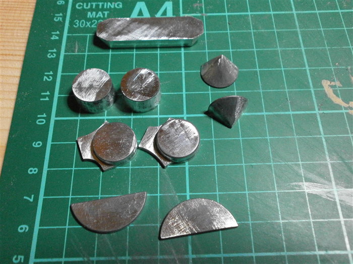

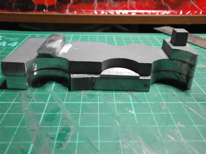

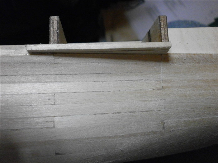

BigGrin Heres the bridge added to see how much i need to remove for a good fit,not a great deal to remove here, heavy sigh of reliefLOL.Im not too happy with the paint job on the bridge so il have to redo i think

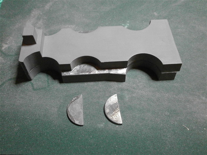

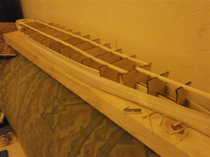

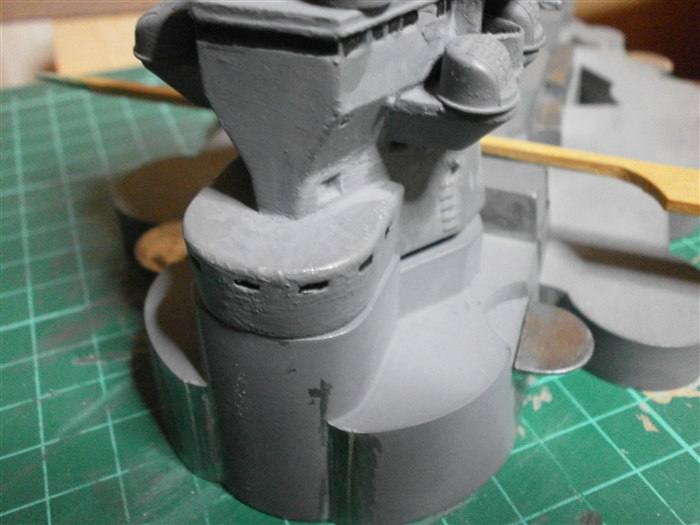

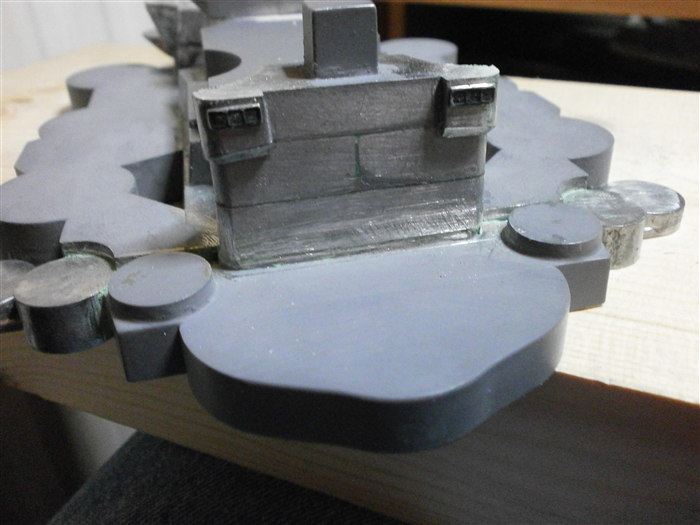

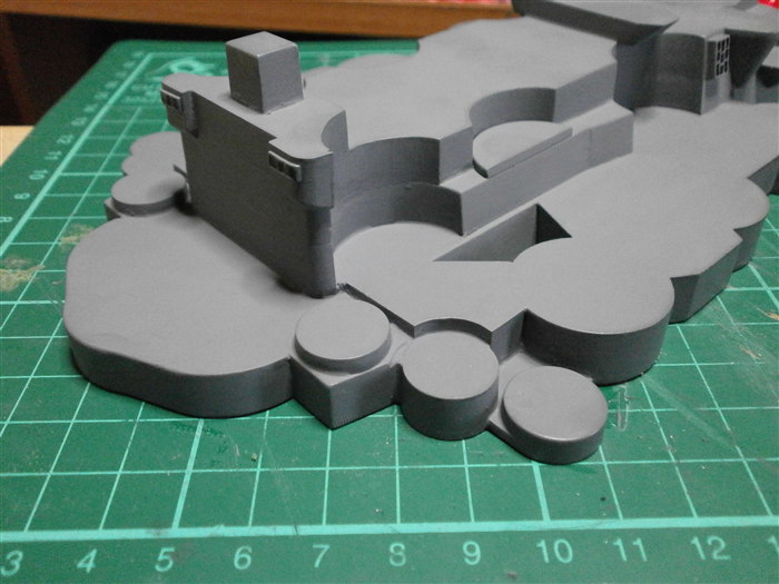

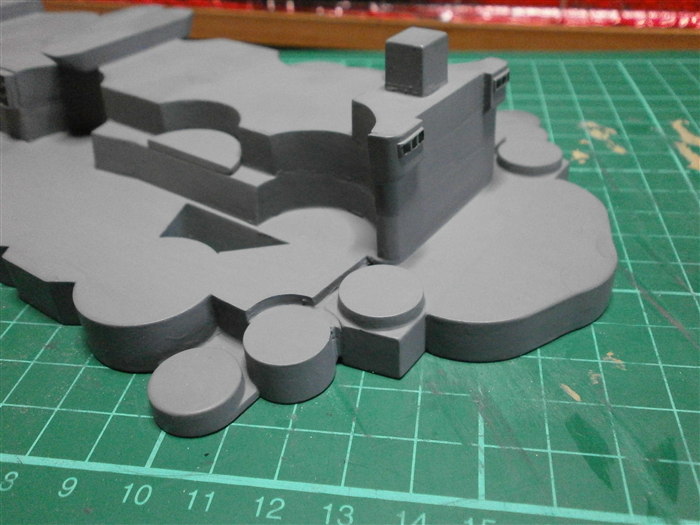

BigGrin Hi all a few more pics of the build so far

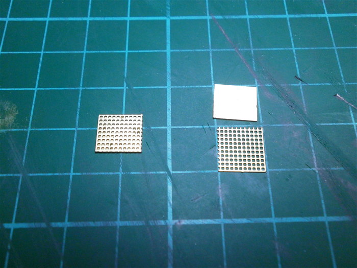

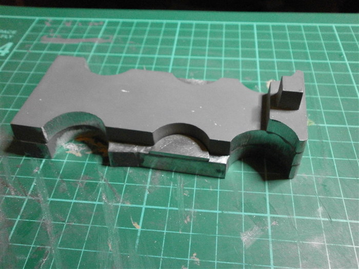

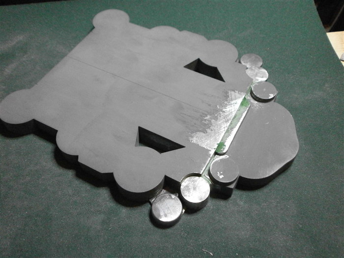

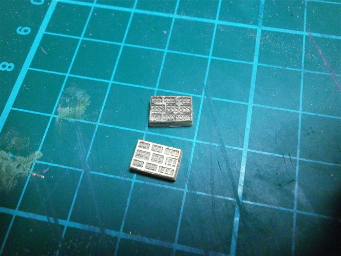

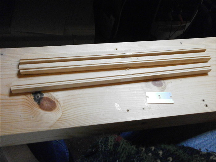

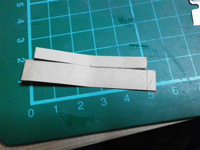

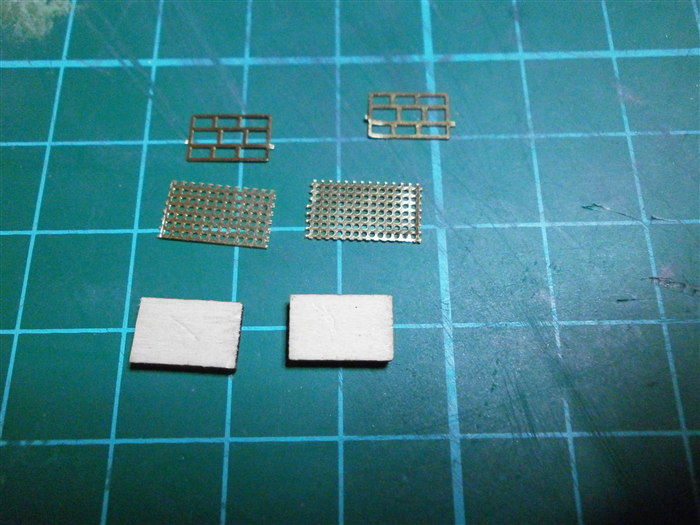

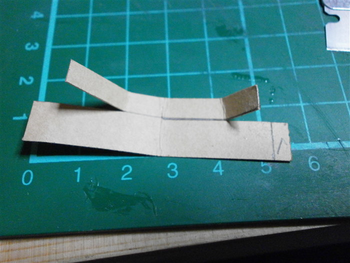

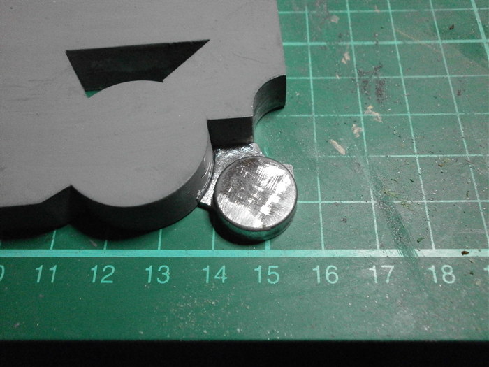

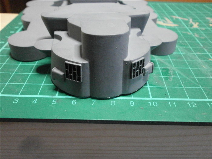

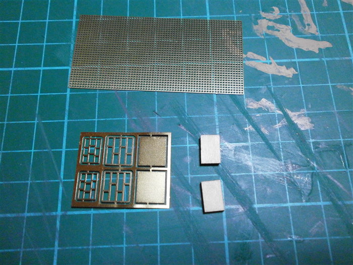

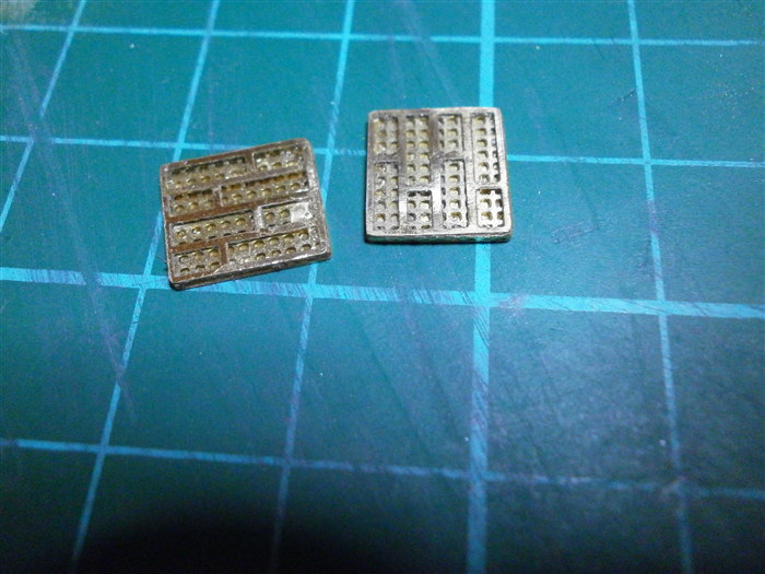

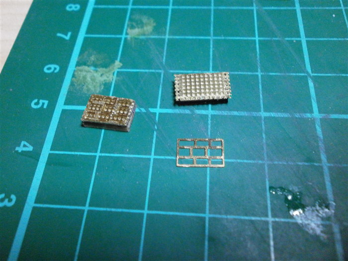

BigGrin Now to make the 4 grills,i ussaly cut the mesh a little larger than specified in the instructions then file back to the corect dimensions.Also included is the card template i used to position the front grills,cut it to the dimensions specified the use to get the cross hair position by fliping up the bendy bit
#49 Posted : 27 November 2011 12:49:31
BigGrin Heres a few pics of the results so farBlink ,now onto a more relaxing propasition the plankingLOL

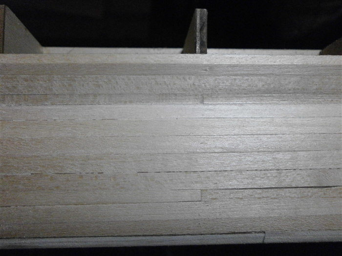

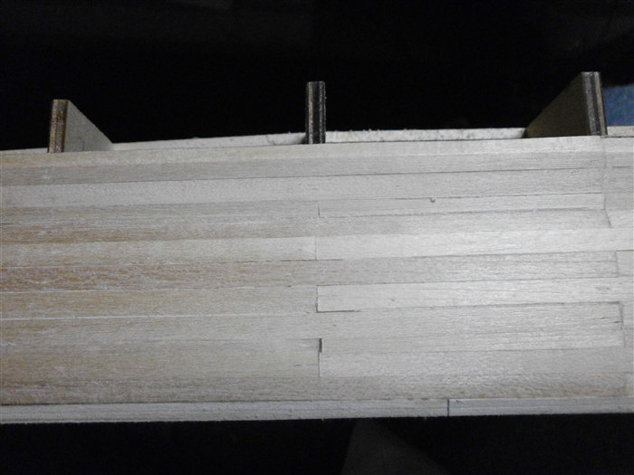

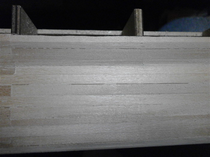

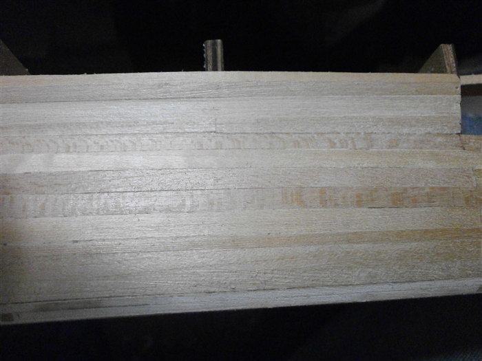

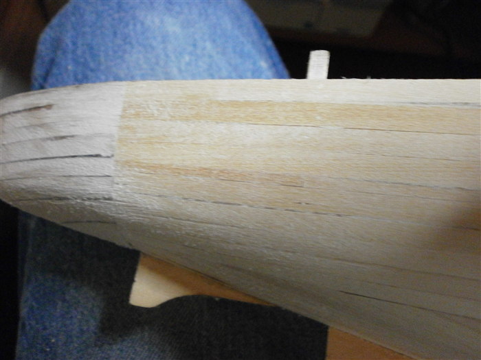

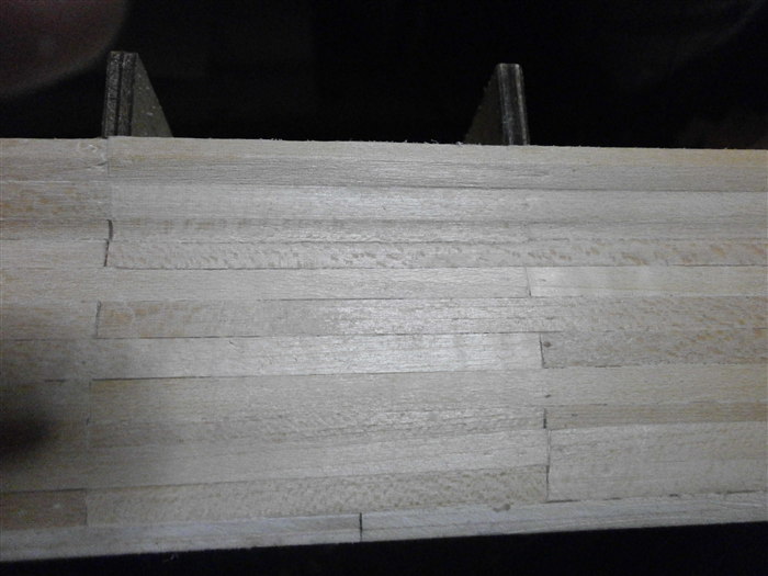

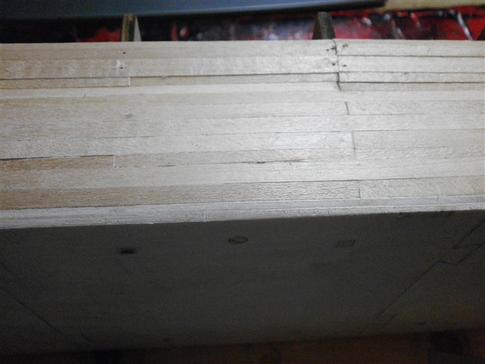

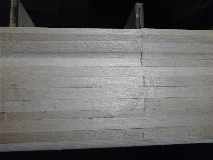

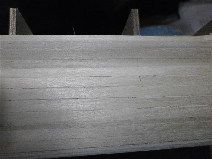

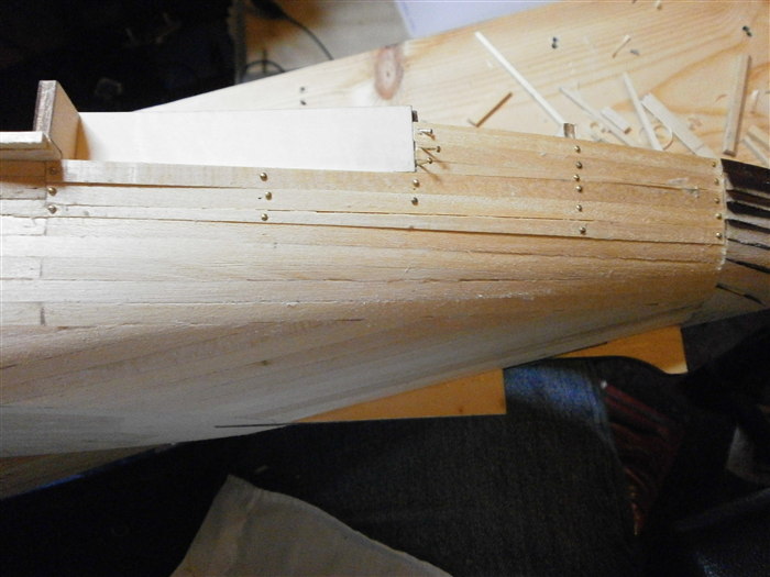

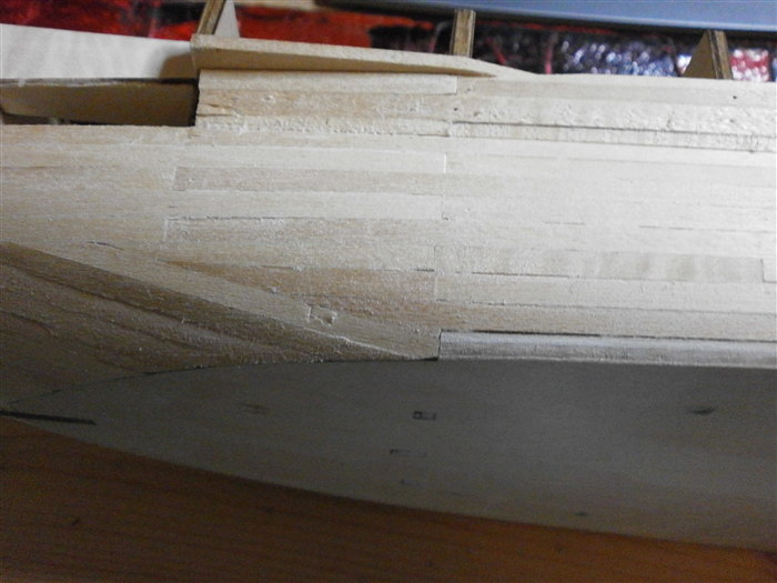

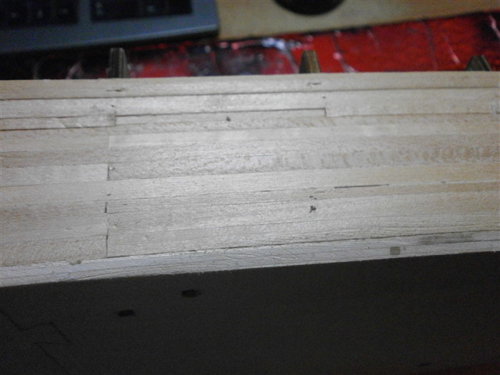

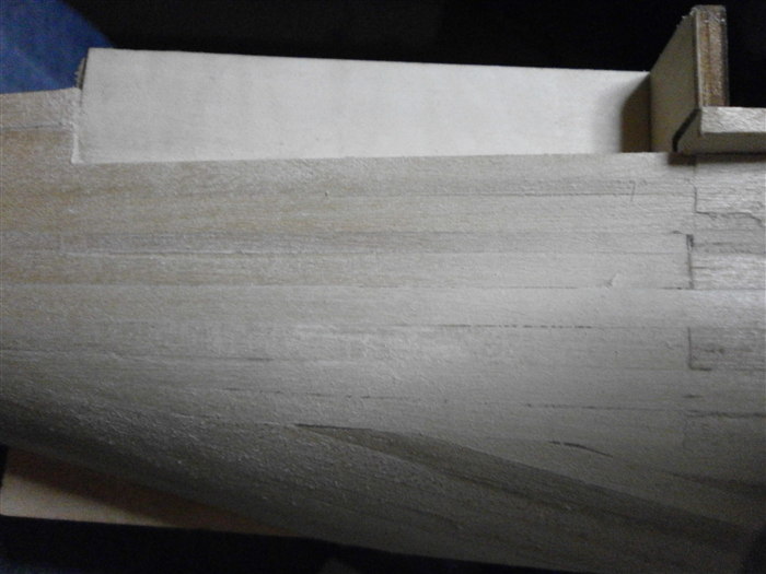

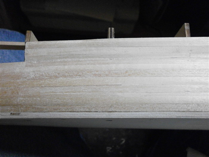

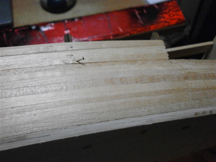

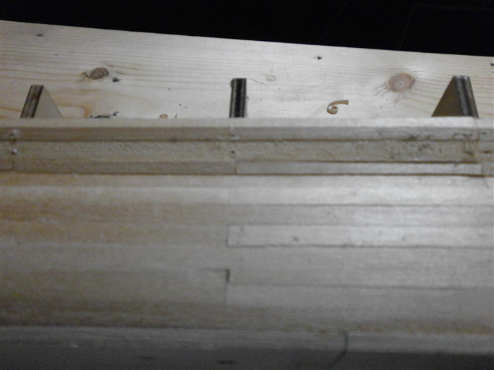

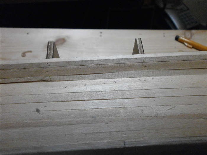

BigGrin Hi all some more pics of the central strakes build, still a bit rough as its before any sanding has been done.Crying But a word of warning here for this section of the build in the download instructions[pg 71-72]its a compleat hash.It says take a strack [no7] and attach it from frame 6 to 12 [the wood provided isnt long enough to do this anyway],then to take the second strake [no7] and attach directly below it, ignore these instructions. Instead follow tomics official build diary and attach strakes [no7] from frame 5 to 9 then the second strake [no7] to frames 9 to 13 [not frame 6 to frame 14 as stated in the download instructions]then fill in below with strakes [no6].Had me scratching my head for a while till i read an old post [pg3] of another builder who had the same problem,hope this helps bulders who are building this now
#51 Posted : 29 November 2011 20:49:58

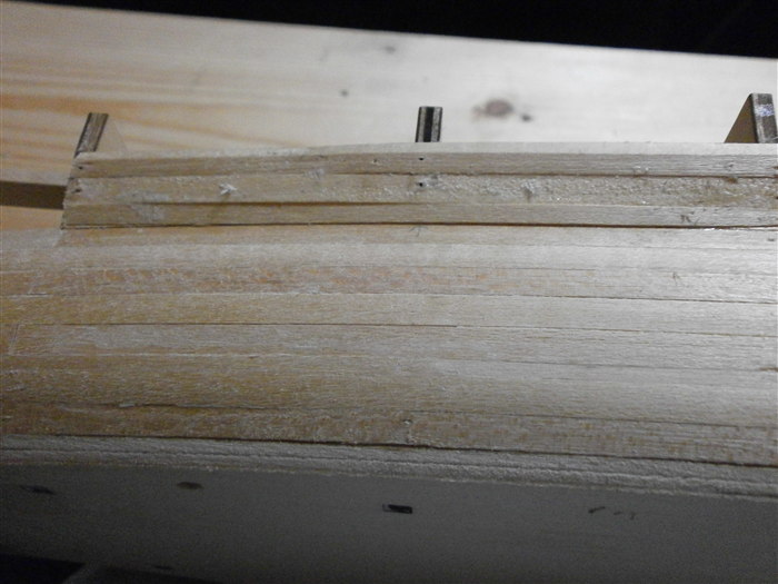

BigGrin Still have 30 strakes over so il be using these to close up the rest of the hull, more pics when iv used these up
#52 Posted : 29 November 2011 22:53:16

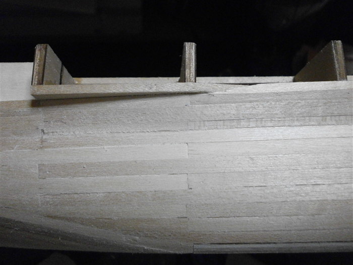

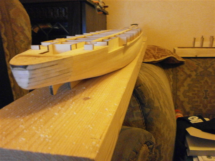

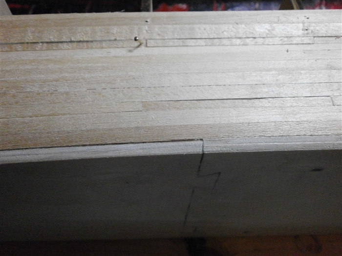

BigGrin Hi all heres the stern fully closed up,il do the bow next
all comments are welcome

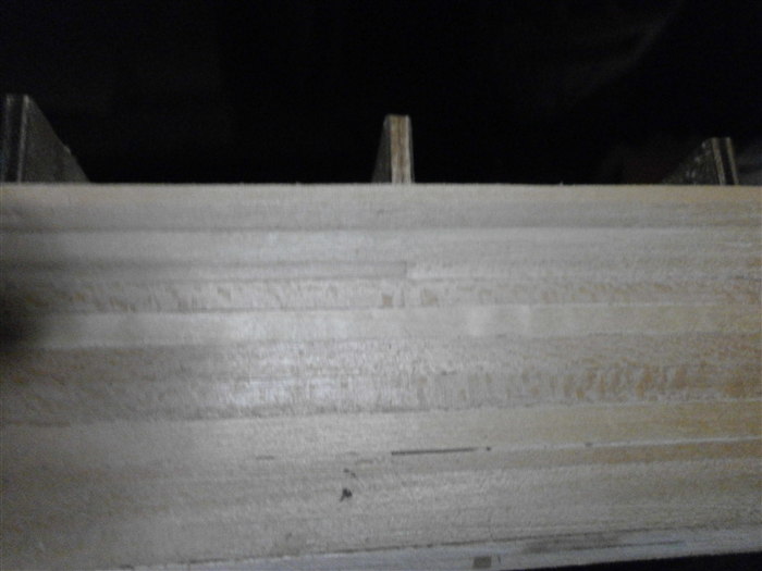

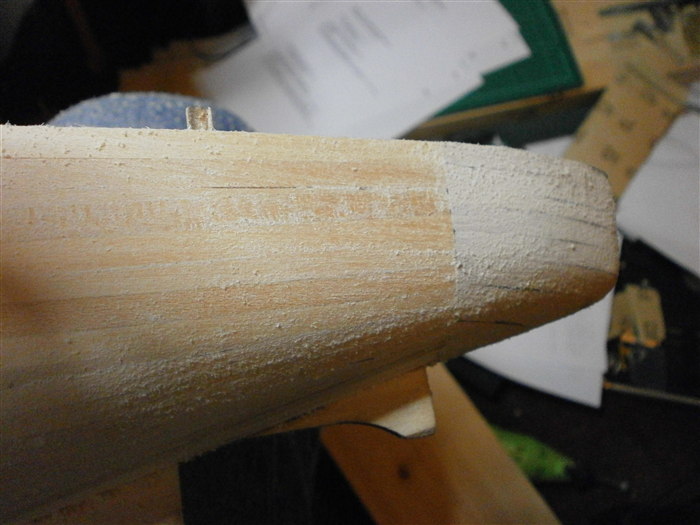

#53 Posted : 30 November 2011 22:44:00
BigGrin Hi all

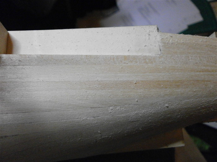

Some more pics of the stern/mid sections after a rough sanding, next to compleat the bow/forward section. All coments are welcome

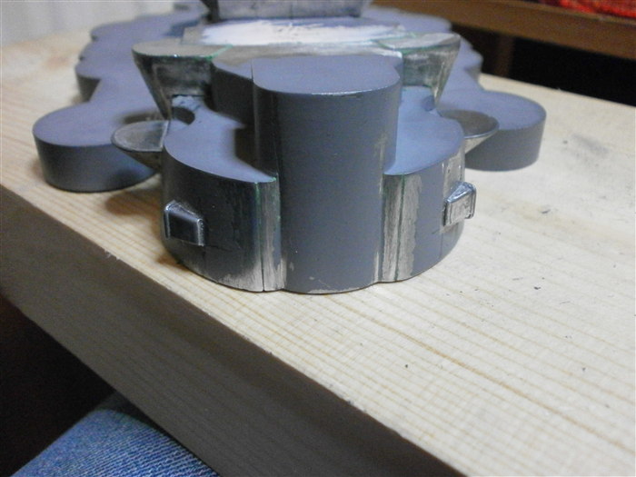

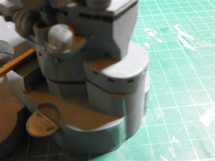

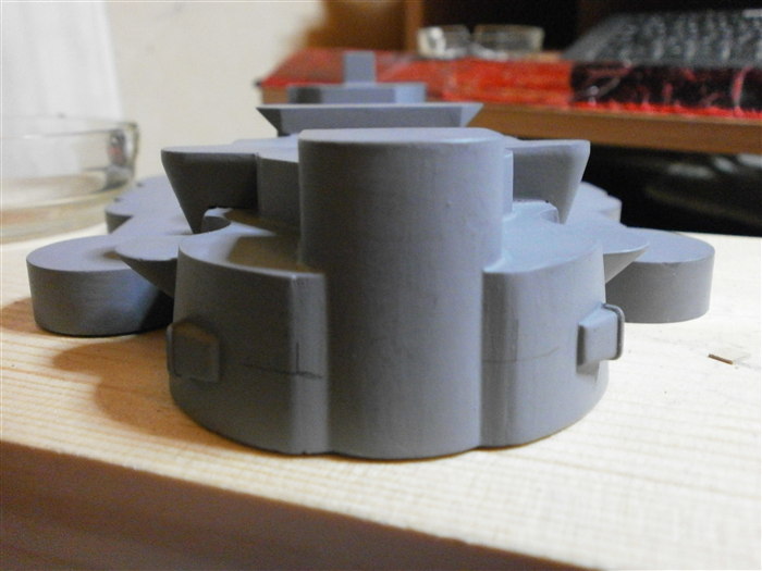

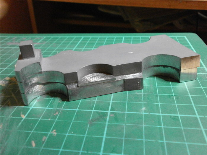

BigGrin A few more pics of the hullBlinklast 1s a bit out of focus sorry+ bad light sorryCrying

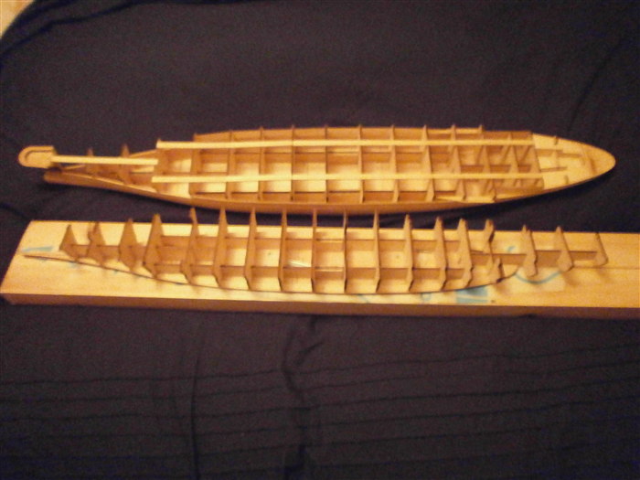

The Hull is really taking shape is that the Akagi in the background?BigGrin
#60 Posted : 01 December 2011 18:51:42

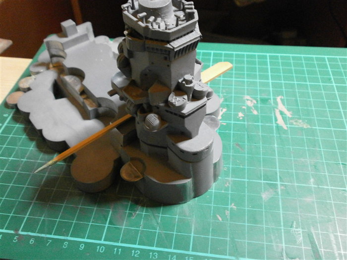

BigGrin Hi MWG
yes thats the Akagi heres a pic of both,and thanks for the comments as it sometimes feels like the Yamato build has been forgoten about[ plenty of views but not many comments, mainly yourself and tomic which are greatly appreciated by myself]. Il be posting the next instalment in the Akagi build diary as i got the latest package this week [pack 4]
