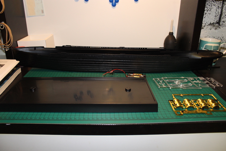

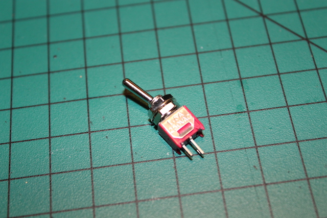

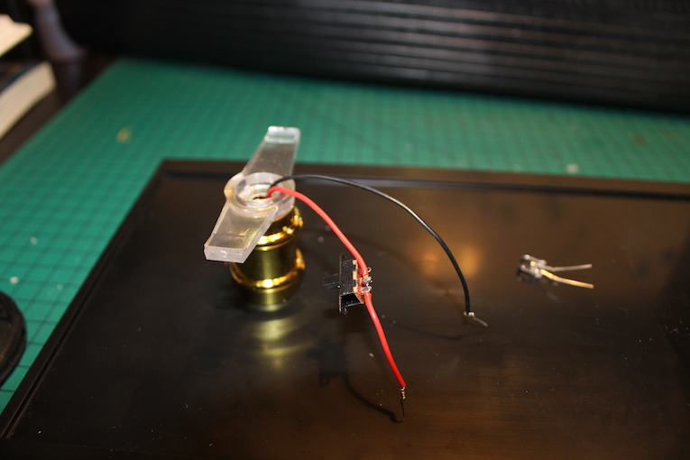

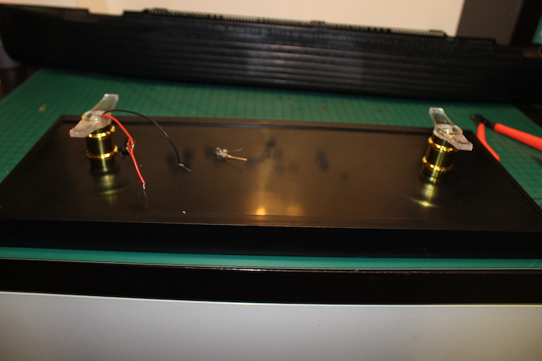

OK so while cross referencing multiple instructions, I made a start on the base. The plastic bee is very large but the ideal hight for hiding the battery pack for the lights. first problem is dealing with the wiring for the light which incorporates a switch. the obvious solution is to get the wire into the hull trough one of the stand uprights so I drilled holes in the base and hull cradle.
still need to work out position for the switch

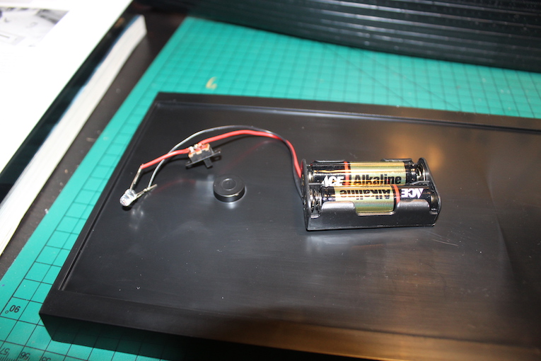

#43 Posted : 17 July 2018 21:37:26
Dont you need a resistor attached to that LED? I think that LED will burn out pretty quickly if you are powering with 3v.I assume the LED is probably 1.5-1.7v rated.
#44 Posted : 17 July 2018 21:53:57
Hi Jase
Hit the link below and you can get pre-wired led`s (ie resistor fitted) and if you go for the 9-12v range you can use a small mains transformer that will save you the cost of replacing batteries.
These are the ones I`m using on my Antanov 124 build.
http://bright-components...s/Ultra_Bright_PreWired
#45 Posted : 17 July 2018 22:23:24
Thanks both for the observation. This is part of a lighting kit made for the Titanic and there are no resistors. Totaly new to lighting never done it befor, but I do have a set of resistors and a resistor board from an old liting kit i never used
Any help on wiring greatly received
#46 Posted : 18 July 2018 02:38:14
No worries.If you can show me how many LEds etc we can figure out a lighting plan. BAtteries are good if you have a few lights, but if you have a lot or if you are using LED strips like in the Falcon build you are better off with a mains transformer or you will drain the battery really quickly.UNless you are wiring the LEDs in series you will need a resistor on each LED to drop the current going through the LED so it doesnt burn out.

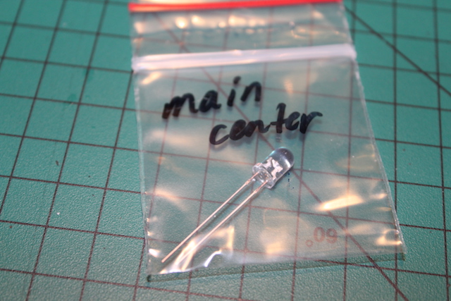

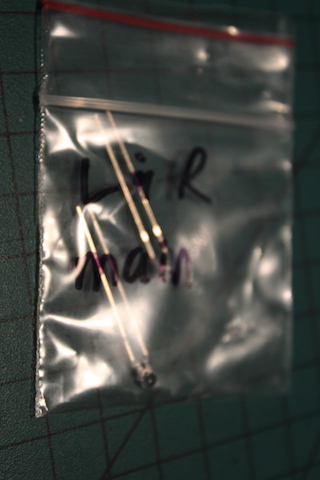

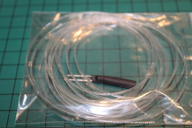

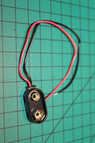

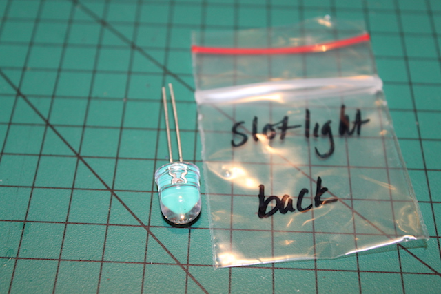

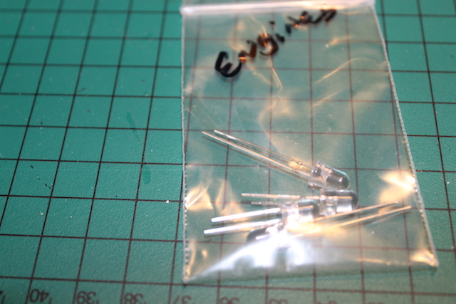

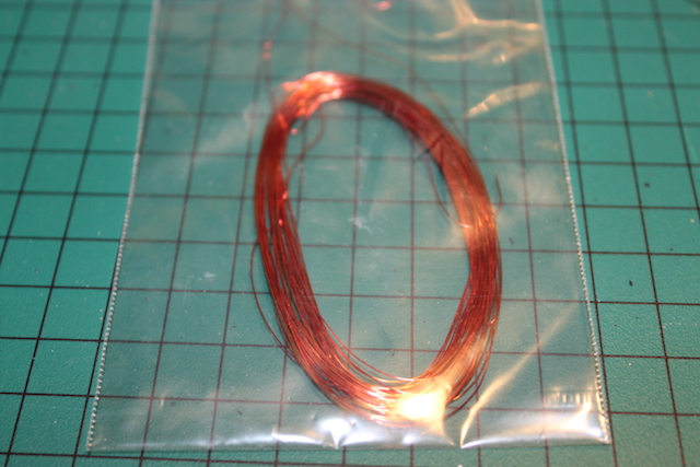

#50 Posted : 21 July 2018 22:27:24

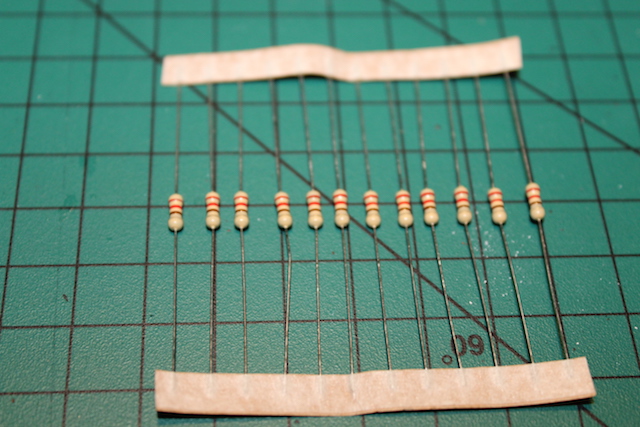

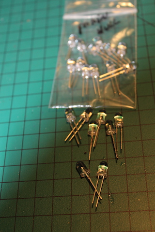

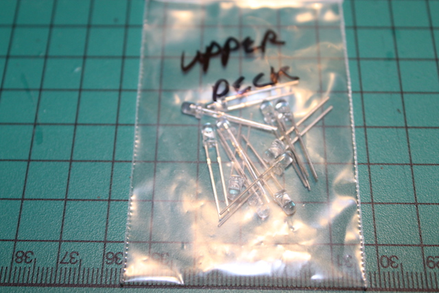

Ok as promised this is the bits n bobs I have for lighting up the model.
So like I said I bought a light set designed for the kit, comes with no instructions whats so ever.
there are 20 white LEDs which are bagged as for the hull.
a bag of copper wire
4 orange flickering LEDs for the funnels that I dont intend to use (only three were real funnels anyhow)
just over 4 meters of finer optic and 1 connector for it. I understand I cut to length and bundle them all in the connector.
11 small whit LEDs marked for upper deck
and a battery pack

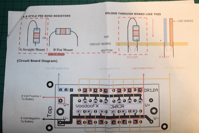

Now I also have a lighting set that was for a kit that got damaged beyond repare a few years ago
this gives me...
12 resistors
another battery connector and switch
another two small white LEDs
1 medium white LED
1 large white LED
a circuit board
a role of multicoloured white that can be separated
and a wiring diagram for the board
I also have small amount of wire to connect the switch to the battery pack.
at this point my basic plan is to mount the switch in the bottom of the base and run the switch wire up the stand support and through into the hull.
use the fibber optic for bulkhead deck lights and the LEDs for everything else
#51 Posted : 22 July 2018 02:05:58

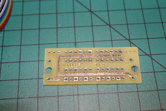

OK the first question is whether you are going to use a battery or 9V power supply. If you are using single LEDS you can probably power 25-30 LEDS with a 9V battery.If you plan on having more LEds than that OR if you are planning on using LED strips (like the ones used in the Falcon main engine) you are better off with a 9V regulated power supply otherwise the battery will drain very quickly.
The second set of parts is from a Voodoofx lighting kit by Randy Neubert. The circuit port is a port driver.basically you power up the circuit board with you 9V input and then you can put resistors on the board and then wire your LEDs to the + and - sides of the board.This means you dont have to put a resistor on each LED because the resistor is on the board.
Randy usually gives you 2 kinds of resistor 220 ohms and 1.2k Ohms.If you use the 220 ohm resistors the LEd will be at 100% brightness.If you use the 1.2K Ohm resistors the LEds will be about 40% brightness.
#52 Posted : 22 July 2018 08:10:10
Thanks carl
Going to stick with batteries and not going to add any more LEDs at this stage. i think I will utalise the risistor board

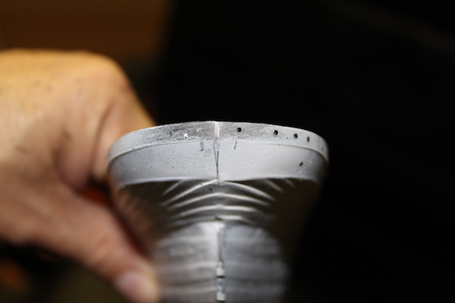

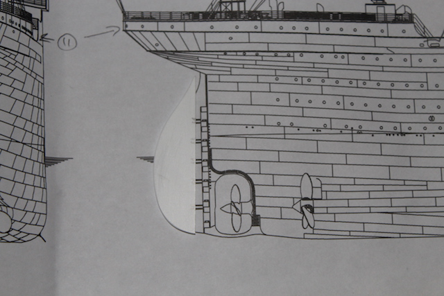

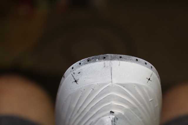

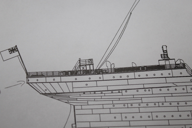

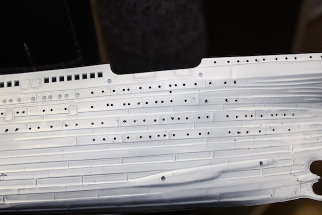

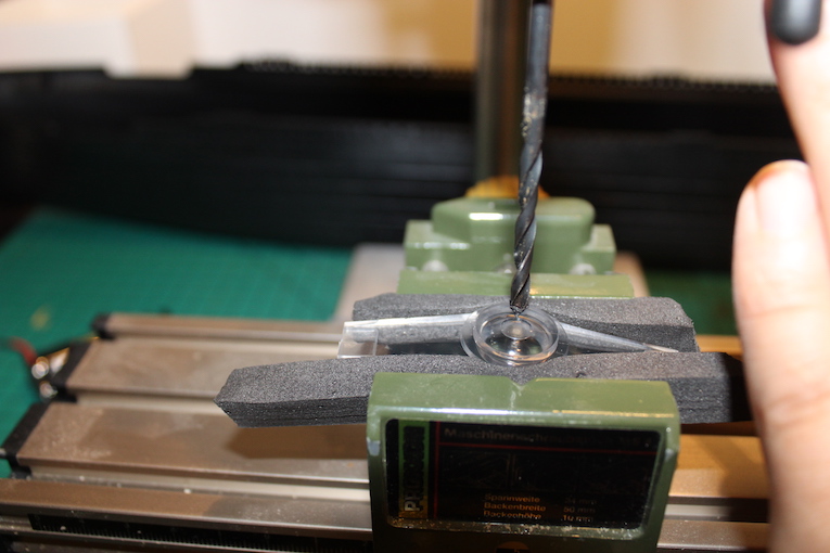

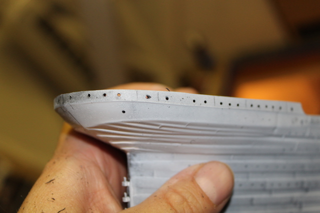

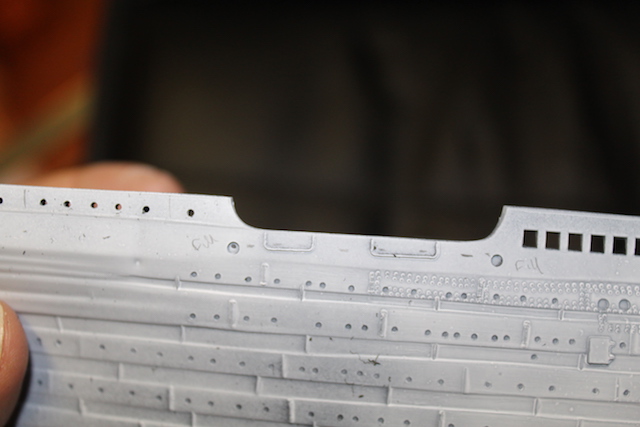

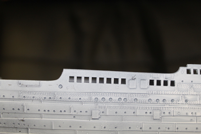

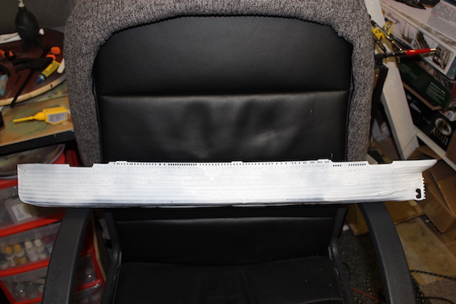

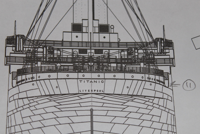

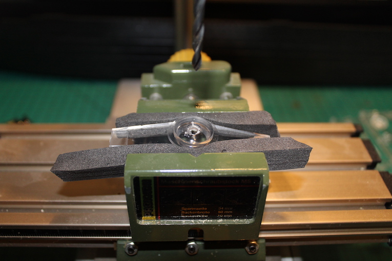

I have pulled to gather a list of modifications from multiple sources so that I have a tick list and don't miss anything I also have a copy of the Hahn plans to mark up.
having gone over the plans and my other reference materials I marked up the hull with additions such as hawse hoes drain holes coming doors hinge changes.
Build of the starts with giving the whole thing a dust of Tamiya white fine primer to help se the detail and allow me to mark up alterations to the hull.
Drilling out the small scuttles was the first task. This includes adding the missing scuttles on the stern which were marked out using the Hahn Plans. There are also two hates holes that need adding to the stern, again referenced on the plans.
There is a lot to do before we can get to painting the lower hull
Pictures of plans used with the kind permission of Dr Robert Hahn.

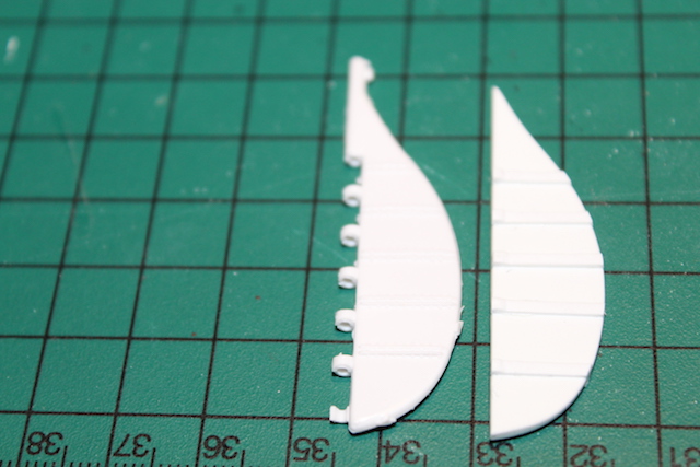

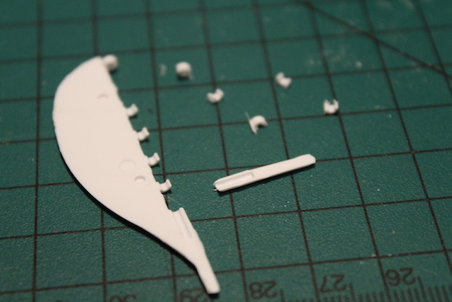

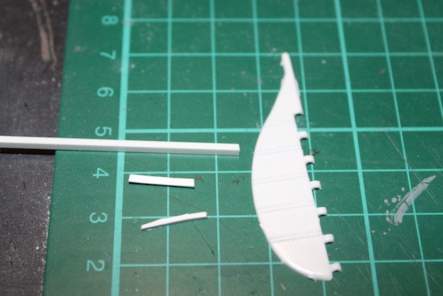

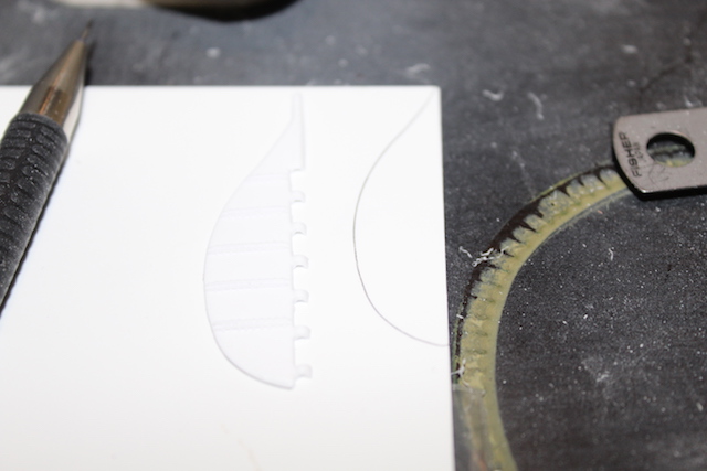

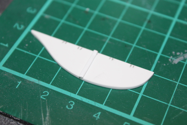

#56 Posted : 28 July 2018 12:18:24

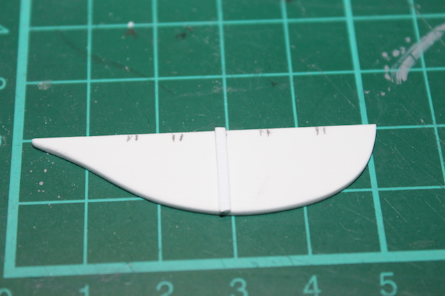

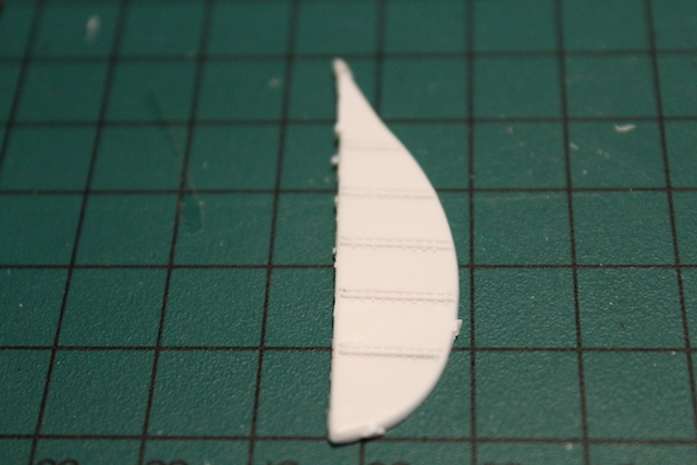

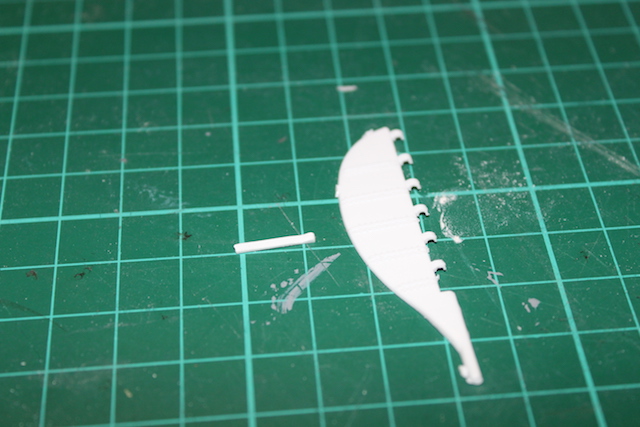

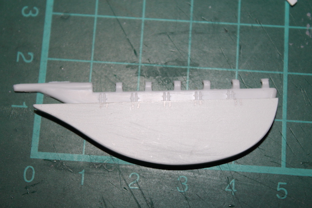

Next I have turned my attention to the rudder, the kit part is correct in shape and size but the ribs are not and when considering primary evidence the rounded off edge does not look right either.
The kit part appears to copy the rudder after fabrication but prior to fitting and importantly prior to the ribs being sealed in cement.
see pictures below
https://vignette.wikia.n...atest?cb=20160224090515
these pictures show the rudder fitted
http://onebigphoto.com/t...er-and-propellers-1912/
https://www.pinterest.co...pin/168322104796625590/
https://commons.wikimedi..._TITANIC_in_drydock.png

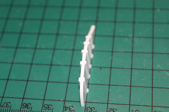

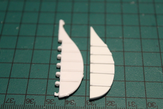

I decided it was best to totally scratch build the rudder. Fortunately I have some very thick white plastic card the happened to be spot on for width. The shape was traced, cut out, filed and sanded down to shape. The finished rudder was placed on the hahn plans to mark out the positions of the ribs. it shows that the kit have oneposition slightly wrong.
The ribs are made from plastic strip sanded to shape. whats important is to note the thick end of the rib at the stern post, this is shaped to form a stop.
Pictures of Hahn plans shown by kind permission.
#57 Posted : 28 July 2018 16:21:56
Nice work Jase BigGrin is going to be some build Drool regards PhilCool
#58 Posted : 28 July 2018 23:12:02
Looks good, nicely done...Cool Cool .. Look forward to seeing more....Cool Cool

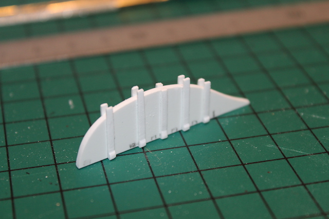

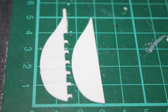

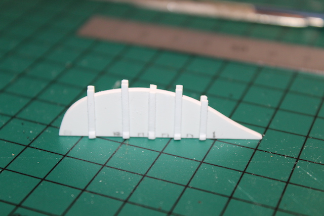

#59 Posted : 29 July 2018 19:02:10
the rudder is nearly done. the other 9 ribs are all compared to the first to ensure they are as close to it as possible.
The alignment is checked against the lines on the cutting matt. to make all the ribs took about 3 hours. the eyes the form the email part of the hinges were made up on the kit part then snipped of, these are perfectly usable as is the stern post which was also made up then snipped of prior to being fitted to the new rudder.
I did look at using bras rod for the rudder post but it meant further modification and filling where as the fit part will just need some filler and and sanding to the correct shape. pretty happy with the first bit of scratch on this build
