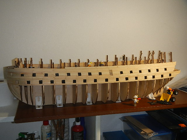

A few more of the lazy good for nothing swabs
travoski attached the following image(s):

#45 Posted : 17 February 2018 08:56:01
Coming on very nicely Trevor.BigGrin

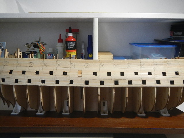

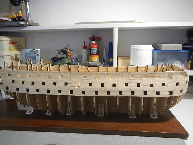

Hi All
A little progress busy planking above middle gun deck then more gun port cutting II also have a cannon production line going on the side,oh I also assembled the supplied stand but she will go back on the home made "shipyard" for a little while.A question if I may is there any reason I cannot start the gun port linings in between waiting for glue to dry on the planks.

#47 Posted : 18 February 2018 13:09:56
Looking good Trevor, well done....Cool Cool .. Can't see any reason why you can't do the gun port linings as you go along.... Cool Cool
#48 Posted : 18 February 2018 13:38:49
Nice progress and looks good.
Cool Cool Cool
Congrats on your "Blue" medal for running a diary. BigGrin

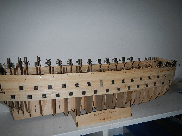

Issue 29

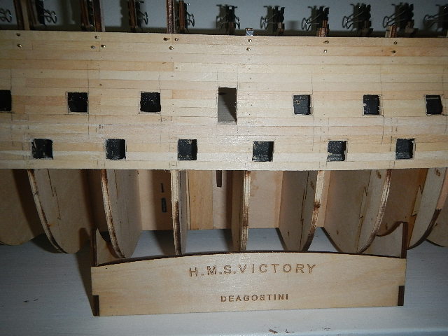

Hi All

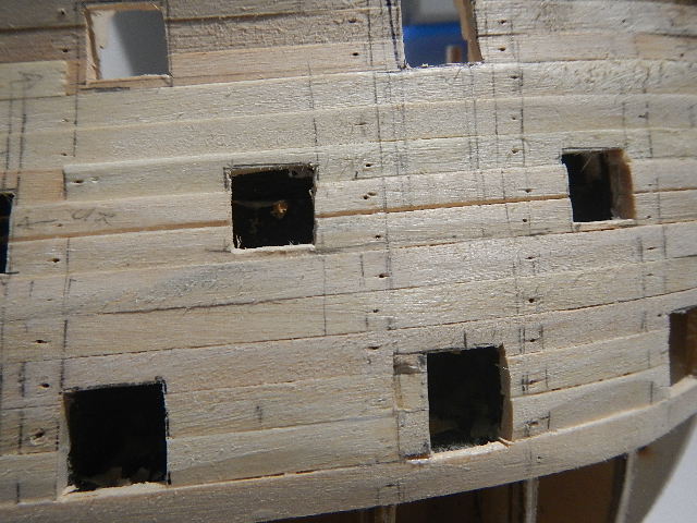

Finished planking as per issue 28,marking out upper gunports I have discovered I have made a mistake on the lower gunports one of the forward gunports is supposed to be in the centre of the two rails as per the attached photo I marked,so the way I see it I have three options 1) leave it as is and mark the top one the same(not sure if this will interfere with other stuff later on)2) cut it bigger to the right as per the photo and try to fill in on the left hand side,3) try to fill it in and then re-cut it again.I would appreciate any help and advice on how to proceed
Trevor

Hi Trevor
It will certainly look odd as the ports lie between the ones above and below. Have you decided what type
of finish you are going for yet, paint or bare wood with stain perhaps?
If painting, it should be fairly straightforward to go with option 3, widen the port out to its correct position
and use some spare planking to cover the gap. Then fill any gaps in the planks, rub down and paint. It should
look fine after that. Filling in first and then cutting may be tricky since the planks will not be substantially
fitted as the originals were.

Hi John
Thanks for your advise,I think I am going to paint my model,so I guess anything I do will be hidden by the paint I was thinking option two cut bigger and fill in to the left as you suggested as well

Hi Trevor,
If it were me I would look to carefully remove the two short planks running between the ports to the left of the problem port. Widen the problem port on the right side then cut and fit the two new planks between the ports, this way it would only leave you with a small gap to fit just above the two new planks you've just fitted. Repair done and unlikely to be noticed....Cool Cool .. Hope this helps.

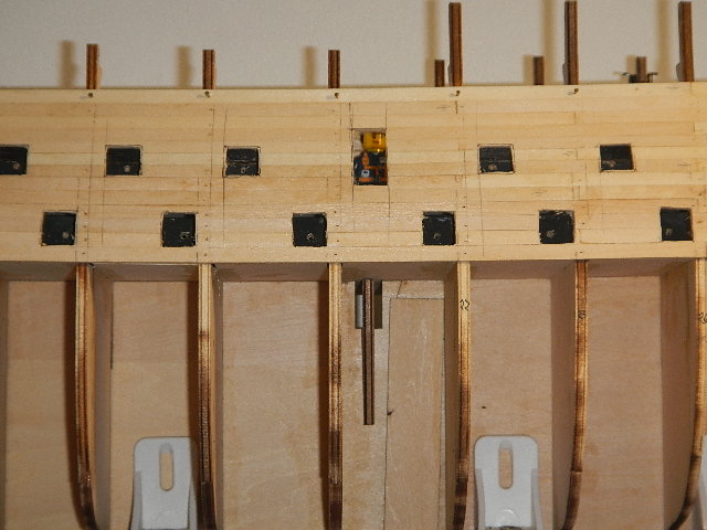

A little progress has been made,I have repaired the miscut bottom gun port and cut the top row on the starboard side now to do the port side
Trevor

#60 Posted : 23 February 2018 07:44:15
Groups: Unapproved
Joined: 24/05/2010
Posts: 1,761
Points: 5,351
Location: London & Greece
Looks fine, Trevor. I'm sure once it's rubed down, only you will know it's there.
