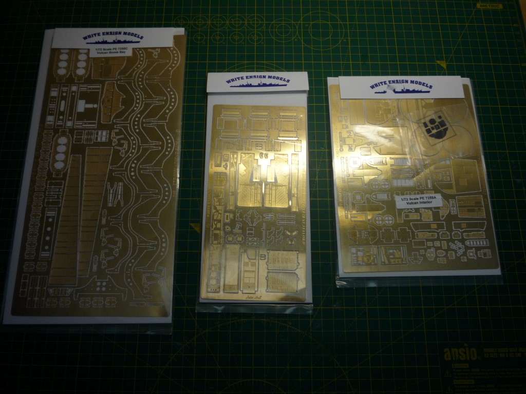

oooh thats alot of etch there GrayDrool Drool i wonder if you`ll glue any to your fingersLOL LOL looking forward to your startCool regards PhilCool
#42 Posted : 28 January 2018 00:04:59
Thats some fantastic etch from WEM. its always good quality. I have found the instructions have improved since the new owners.
I think this is going to be a seriously great project - enjoy
#43 Posted : 28 January 2018 21:35:18
Some fabulous etch details there Gray and nice reference material too. Really looking forward to the start of your Vulcan build. Drool ThumpUp
#44 Posted : 30 January 2018 14:36:32
You've got a fair bit of etch there, should turn out to a great build.
#45 Posted : 30 January 2018 14:44:26
Lots and lots of add ons, this is going to look great Cool hope your upgrading the undercarriage to cope with it all LOL

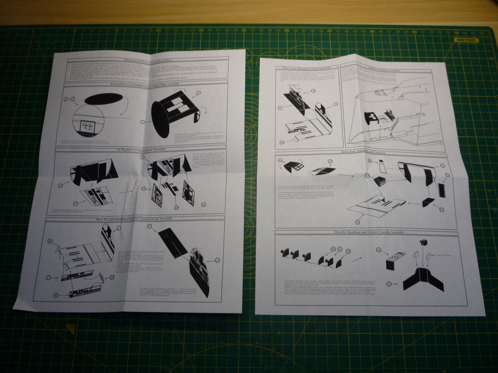

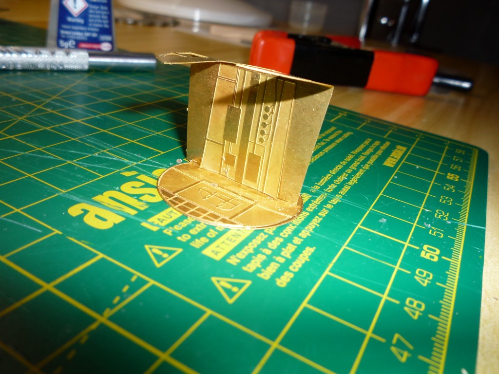

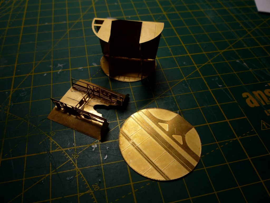

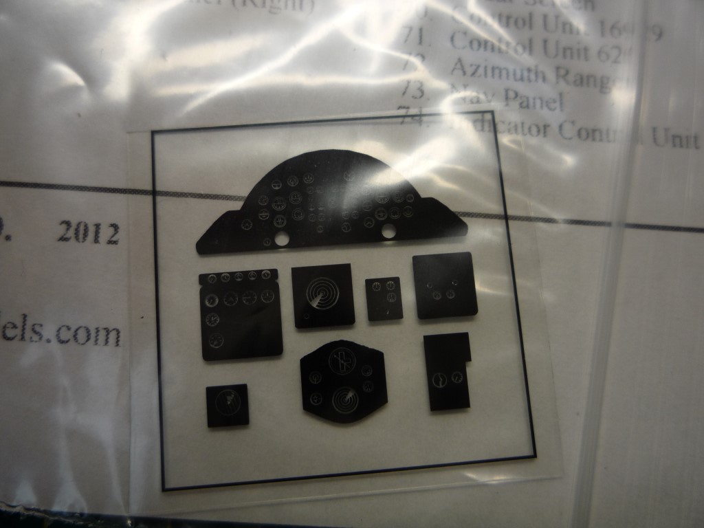

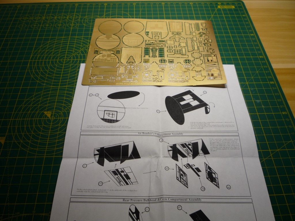

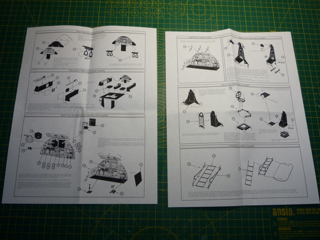

Finally having all the pieces in place, i decided to make a start with the cockpit. The supplied kit pieces are, well lets just say a little sparse, hence the etched cockpit. Here is tonight's progress. More to follow......

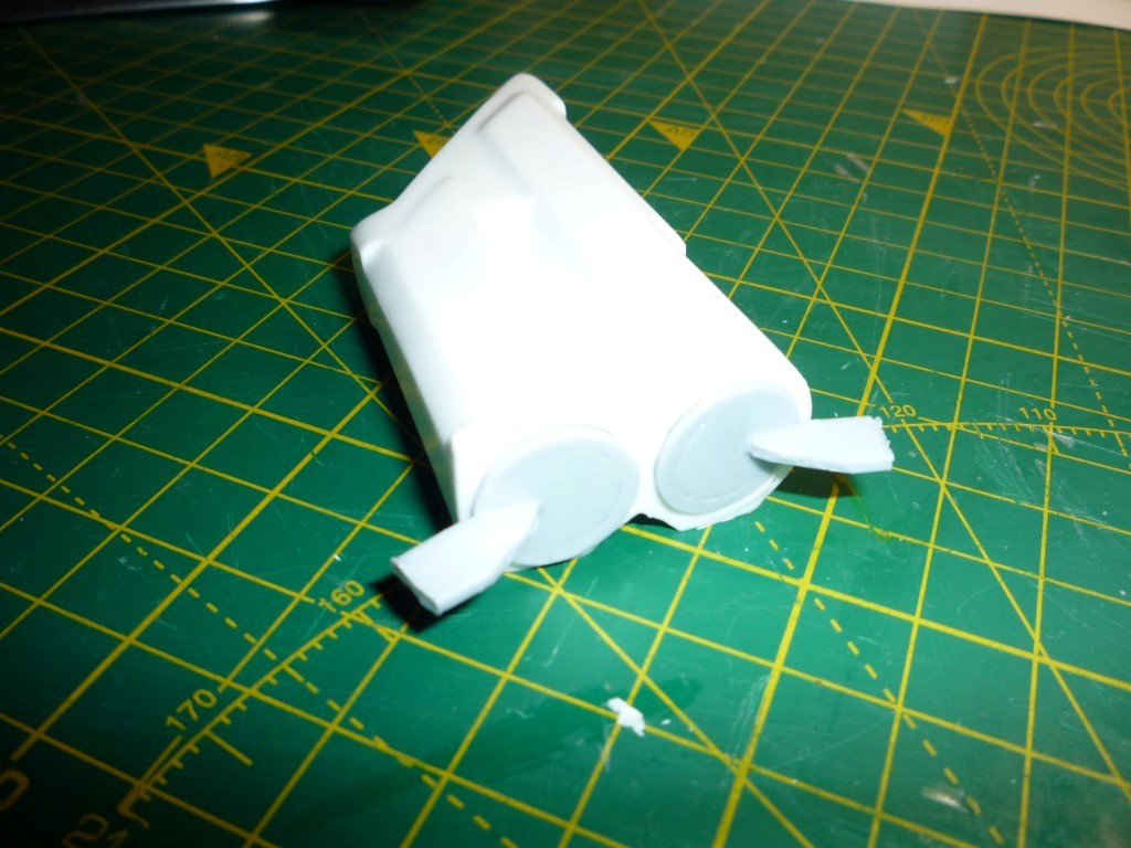

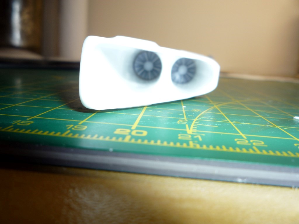

#49 Posted : 31 January 2018 21:59:48

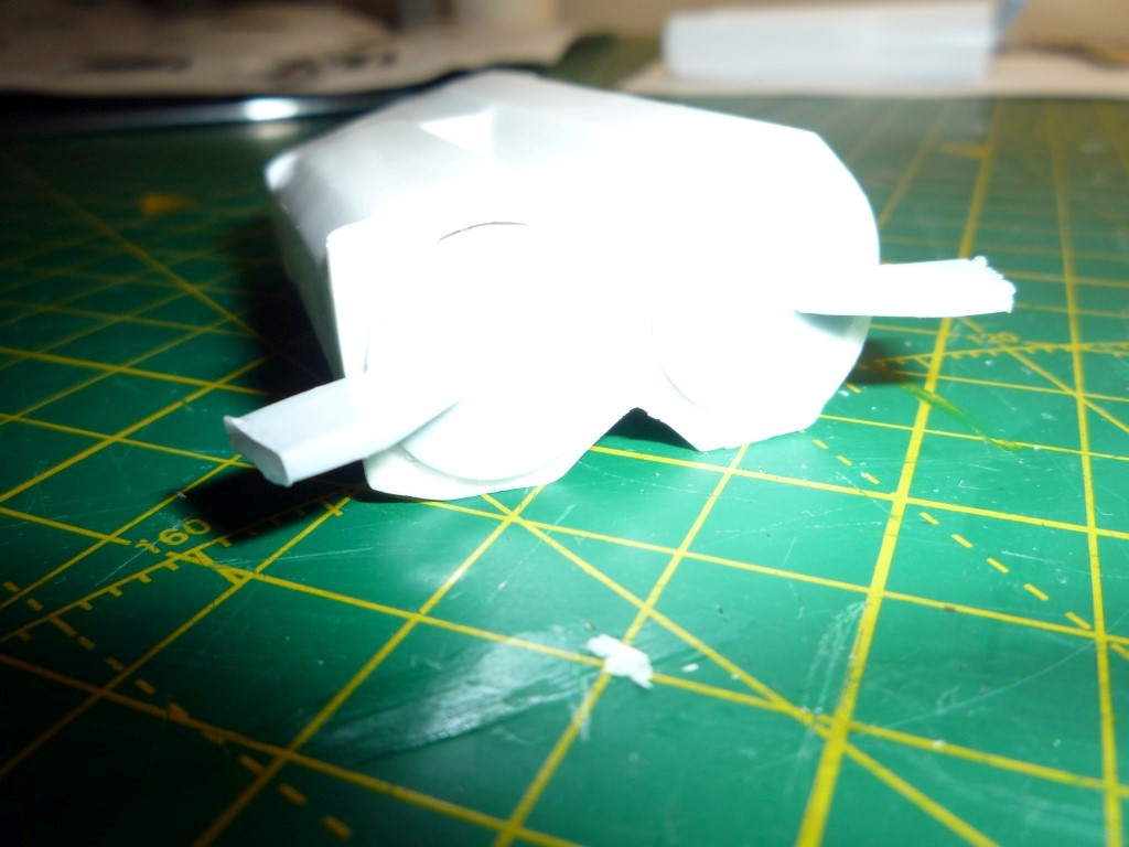

By this etch is very fiddley Cursing . I can see why for some people it might be a 'marmite' moment. Trying to glue the etch at 90 degrees is a nightmare 🤬
While waiting for the etch to set, i thought i would assemble the seamless air intakes. I just need to remove the fitting lugs once the glue has dried.

#50 Posted : 31 January 2018 23:31:08
Those intakes look so much better than the kit ones BigGrin

#52 Posted : 01 February 2018 00:12:48
Percevier with the etch it will be worth it. Intakes look awsum

Thanks for looking in and your comments guys. I am having trouble with the etch. It's the superglue. It's way too brittle. So... having done a little research i have found VMA Flexi CA at M.A.N Models. This stuff is quite expensive, but hopefully will cure my problem. It's not as brittle and seems quite workable.
I just need to find a way to butt joint at 90degrees now that retains it's shape Confused.
In the mean time i will continue the build working around the etch. Further updates to follow Cool

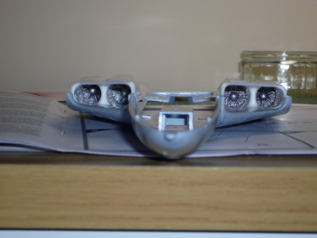

Engines fitted. supplied paint came in useful after all BigGrin

Looks like you are having fun GrayBigGrin BigGrin looks great so farDrool regards PhilCool P.s i always find when using etch to make sure i rough up the rear of the piece before gluing and i mostly use loctite superglue just a thoughtConfused

Try usung pva glue and jig your part. If the etch part is load bearing youcan always reinforce with ca afterwords
Alternativly you try using ca gel i fing the ca gel from zapp very good
If you show me phot of the problem part i am sure i can help

I sometimes use 5 minute epoxy glue to secure load bearing etch if two parts are being laid flat onto each other, just spread thinly on one of the joining parts with a clean fingertip, it gives you a few minutes to get everything in the right position and any excess seepage can be cleaned up around the edges with a suitable solvent/thinner whilst it is drying? If you want to join two parts which are perpendicular to each other, you could also just touch the edge of a bulkhead or suchlike into the mixed glue so that you get a thin bead along the edge of the part, and again clean away any excess whilst it is drying to leave a neat bead of glue. Once dried it is a very strong joint and can be strengthened by running a little thin CA glue along it with the edge of a scalpel blade using capillary action? You can also solder brass etch together but then it can cause problems sometimes with warping of parts due to heat transfer.
Hope that helps? Keep up the good work. ThumpUp

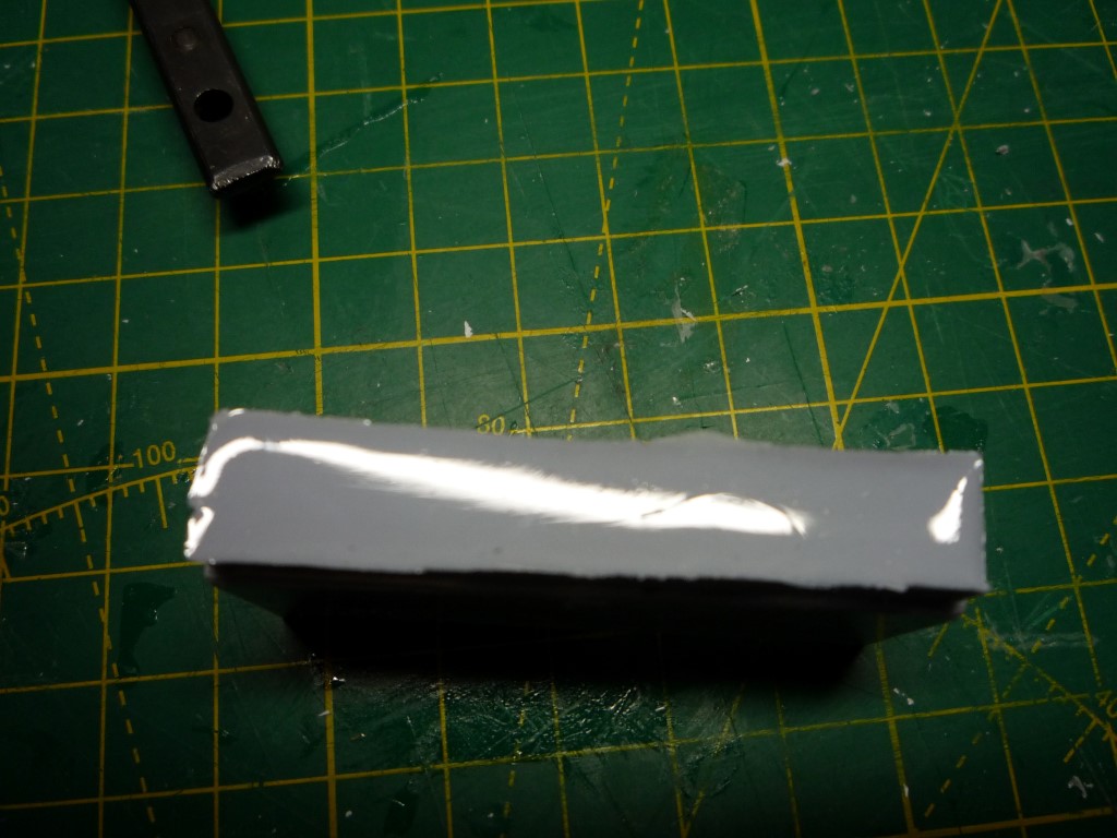

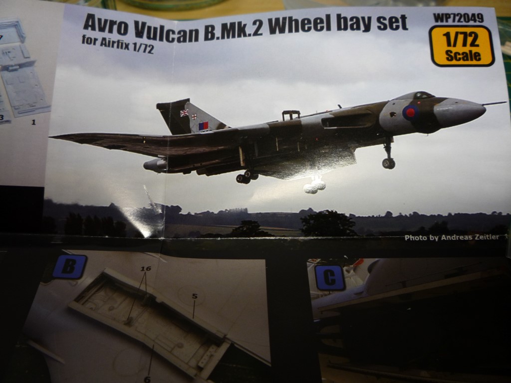

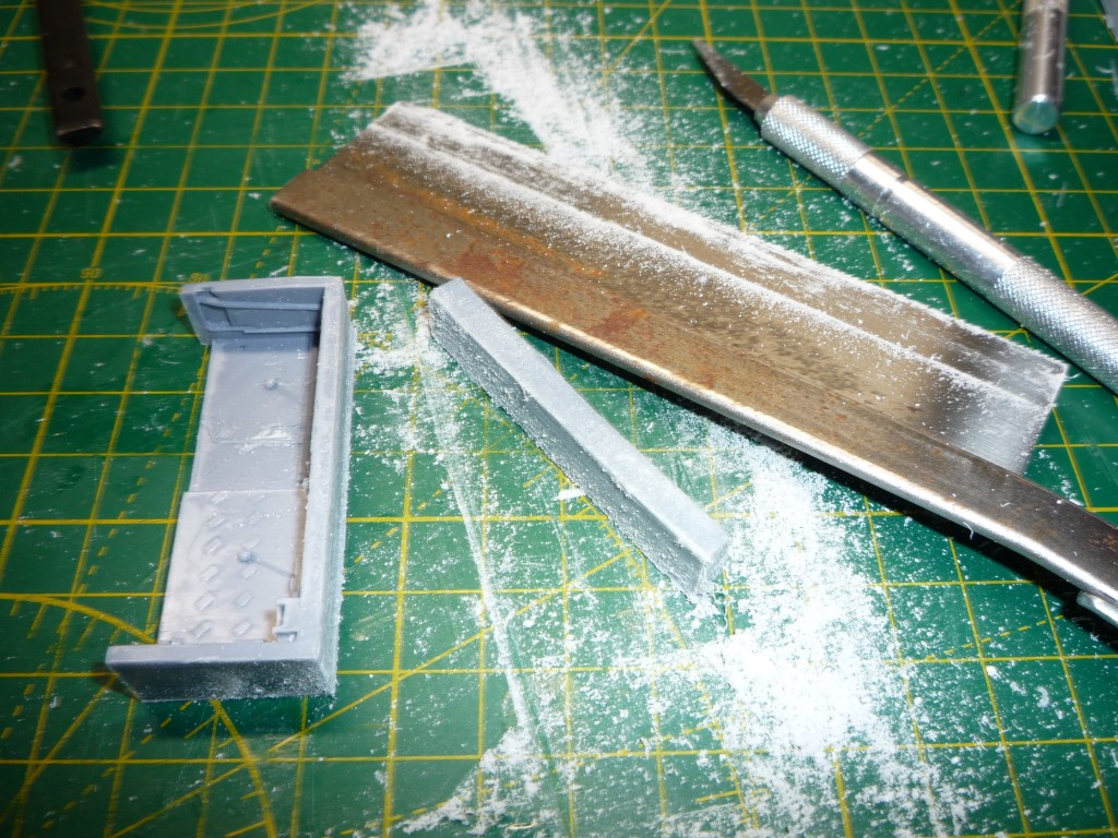

#60 Posted : 07 February 2018 20:51:25
Thanks for all your comments and tips. Much appreciated BigGrin

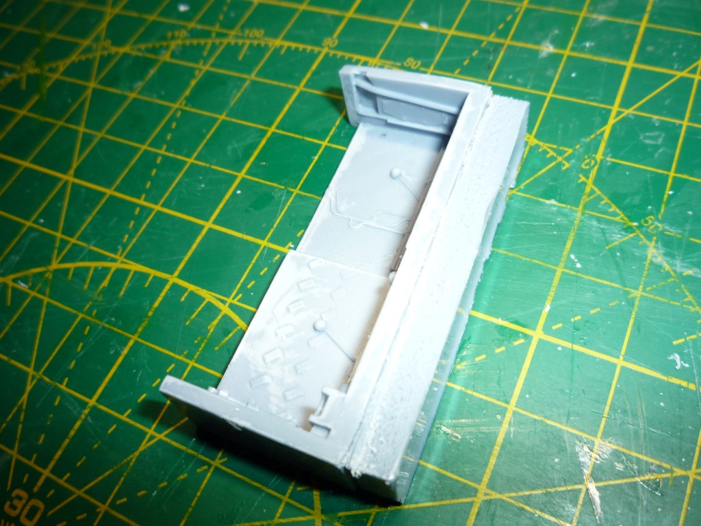

For today's update, this might sound a bit harsh but...I ABSOLUTELY HATE THE WOLFPACK WHEELBAY SET. Cursing Cursing Cursing
There, i've said it now (feeling much better). Its not the relative complexity, but a mixture of very poor instructions (read almost non-existant), badly fitting parts and MASSES of remedial work on the parts themselves.
Compared to the etch from White Ensign, its like chalk and cheese!
Needless to say the wheel bay set is getting binned. Hope i have a better experience with thier update set.

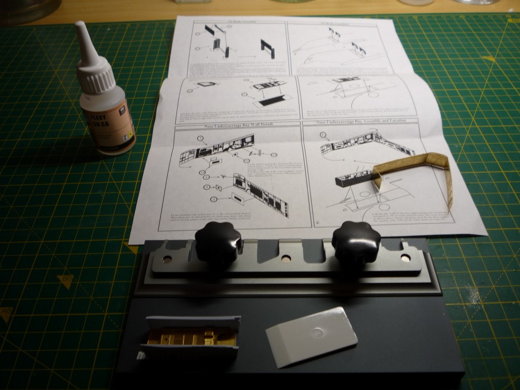

Anyway, enough of the negatives! Bought myself a MasterTools etch bender Love really happy with that Cool
More updates later. Here's pictures of the bad kit...
