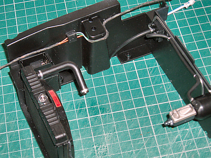

roymattblack wrote:

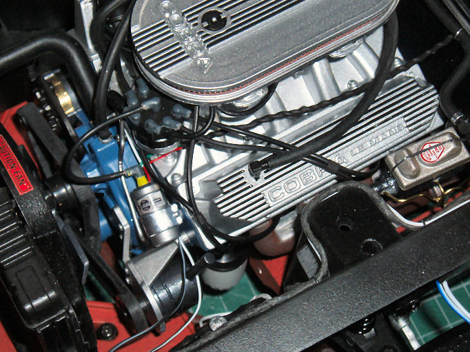

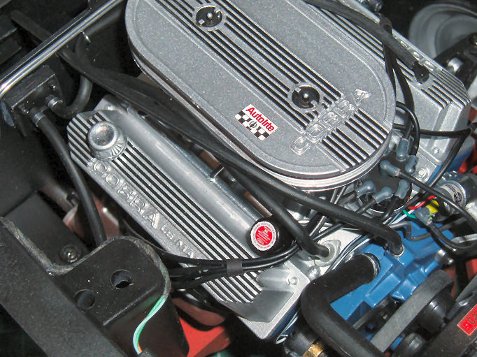

I've started to add some of the missing parts to the rear firewall.
One of the first things I noticed was the hose from the front of the engine block that goes to the clutch housing - it shouldn't.
It's totally wrong.
When you think about it, why would hot water be going into the clutch?
A google search of the actual heating system shows that the pipe should go through the firewall to connect to the heater matrix.
Kit pipe removed - new rubber hose fitted.
Also, there's another hose that should go from the front of the block near the oil filler, that also runs through the firewall.
This hose is missing from the model.
A mounting flange was cast and fitted, and the hose added.
Next, the vacuum system has a unit that should be on the firewall to the left.
This was scratch made and added.
A hose was connected between it and the brake vac tank and another hose will be added between the unit and manifold.
Two metal pipes were also fitted across the firewall - purpose not sure, but they should be there...
The pics show the firewall loosely in place to test clearances.
Relays and wiring need to be added to the side walls of the engine bay.
That will be next.
Roy.

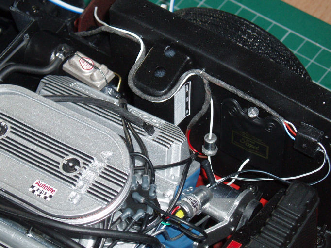

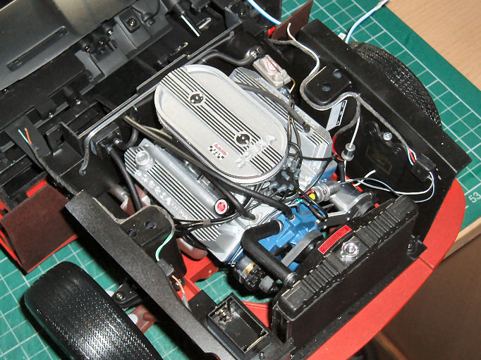

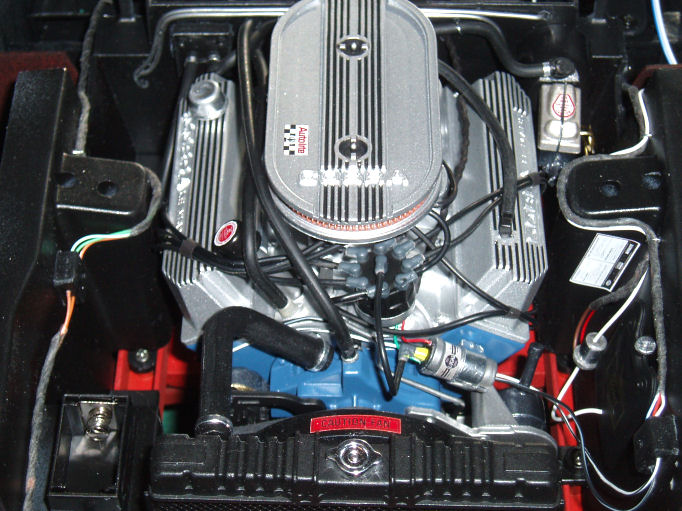

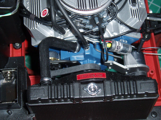

Anyway, a relay made up and fitted with some added wiring...
Roy.

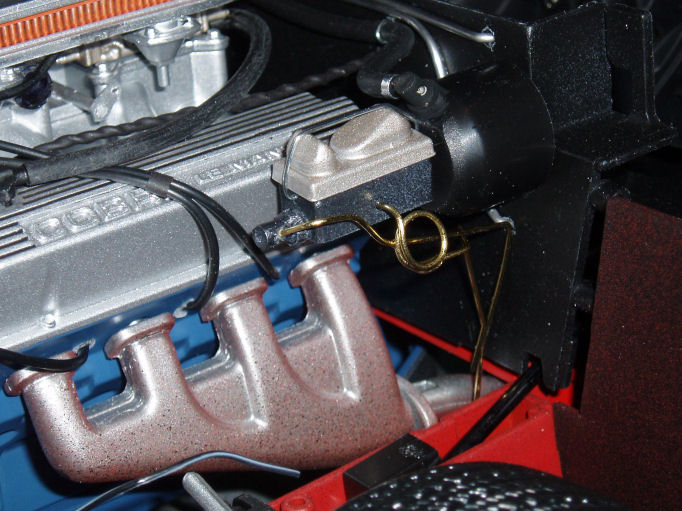

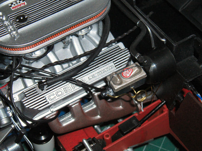

Yet again, a little extra.
Brake pipes added to the master cylinder.
Also, added a few decals.
Roy.
#48 Posted : 18 January 2018 12:41:39
Posts: 5,188
Points: 15,713

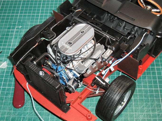

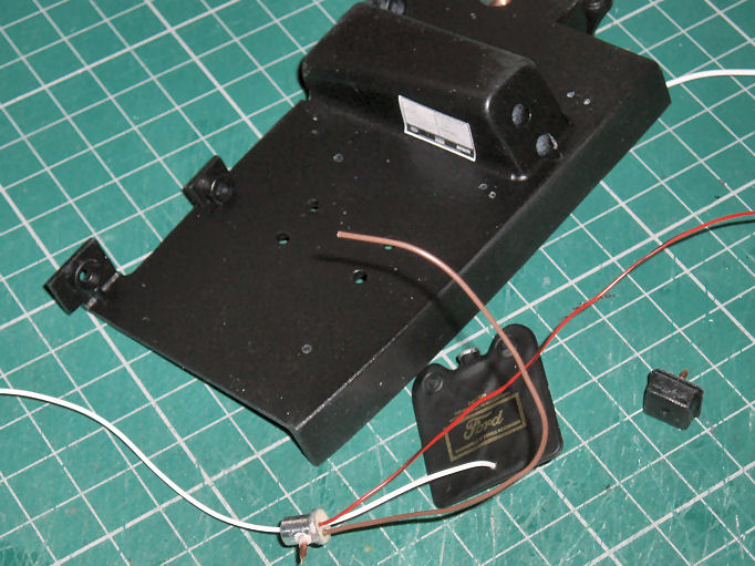

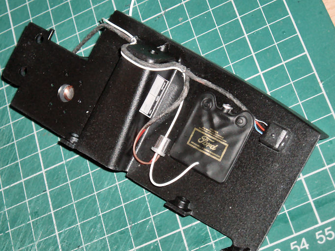

More done, this time on the other inner wing panel.
I made up the small water pump for the screen-wash bottle and added the water pipe and wiring.
Another relay has been added and some wiring for that too. All routed along the top of the panel.
The wiring from the alternator will connect to the relay when the panel is in.
Vin plate decal also added as per reference pics I've trawled.
Roy.

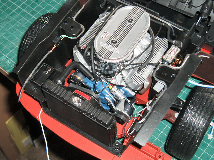

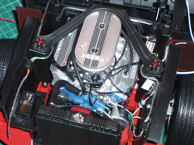

The panel has now been fitted and the assorted wires etc routed and connected.
Engine brace in place next.
Just the battery to attend to.
Roy.

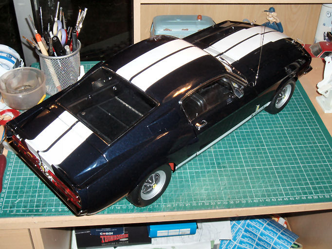

Well, moving on to completion.

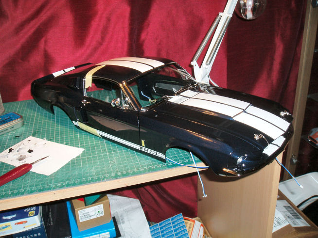

The windows are all in but I've left the radio aerial off for now as it will just get in the way when I need the body upside down.
A dab of cyano or epoxy to fit it at the very end will do.
The doors...
Well, after a full afternoon of fiddling and fettling I've finally managed to lose the 'door wobble' which is simply because the screws do need to be tight.
Anyhoo - the monster is looking blinkin' big.
The doors are taped to keep them shut in the final stages...
Nearly there.
Roy.

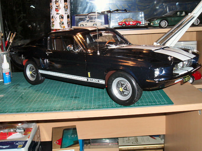

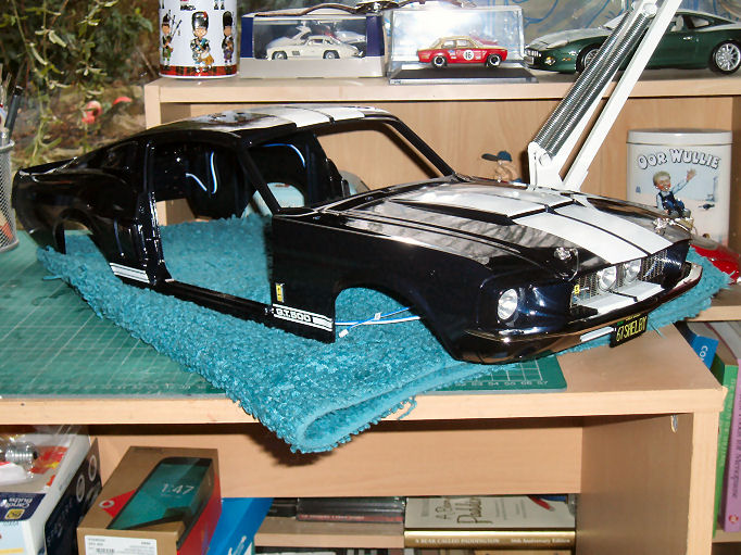

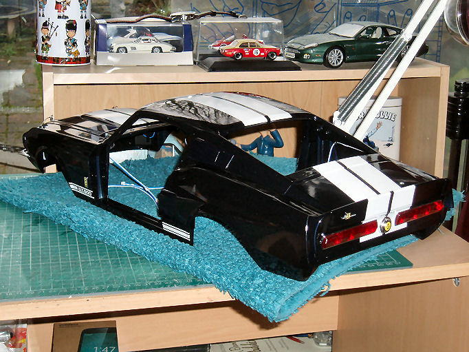

Body now on the car but still not quite finished.
Getting the wiring out of the way was a struggle as you need three hands but got there in the end.
Batteries needed to test electrics.
Whether the body on the bench wasn't quite level or square, who knows but with the body and chassis together, the doors work fine. No wobble, and they open and shut properly.

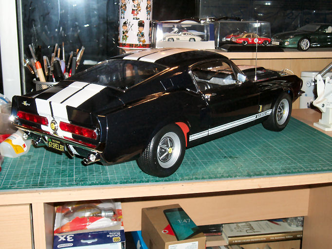

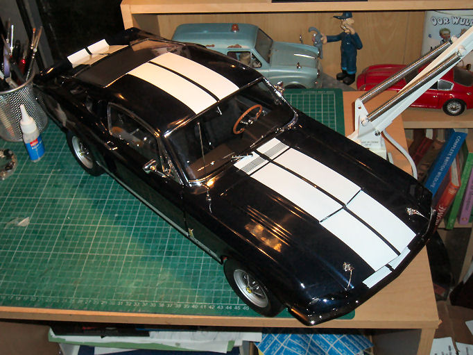

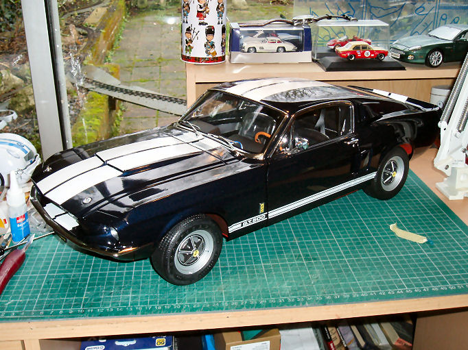

Well, here we be.
All done.
It was an enjoyable build and actually all went together in a very straightforward way.
I enjoyed adding bits to the engine area (my weakness) and may yet add a few racing decals just for a bit of variety.
Thanks to all those who looked in on my waffle.
OK - Back on with the E Type, TB2 and - who knows???
Roy
