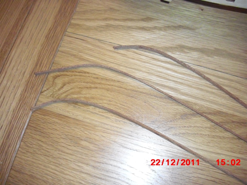

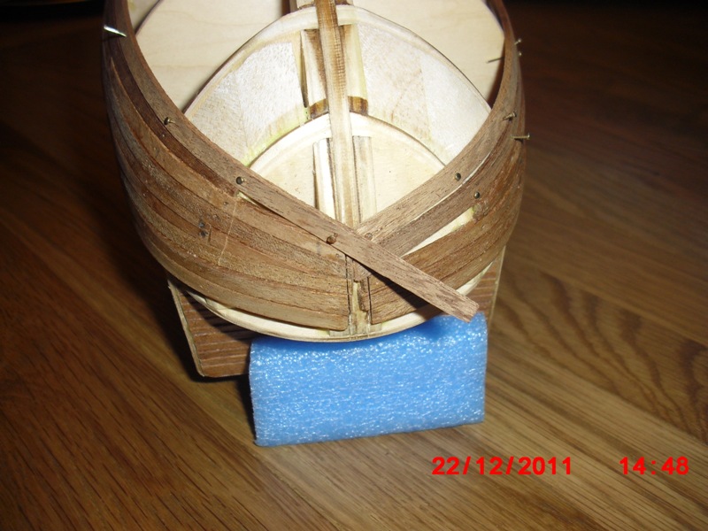

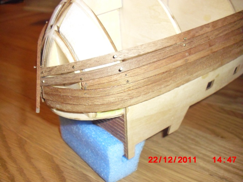

#44 Posted : 22 December 2011 14:54:42
PLANKING THE HULL
Hi Team, I continue planking the Hull, just a few photos of planks which I soaked in boiling water for 20 mins then I pinned them wet to the hull so when they are dry they will take the shape of the Hull.:-

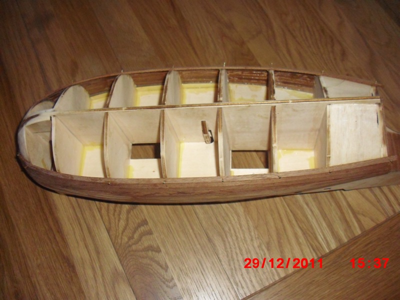

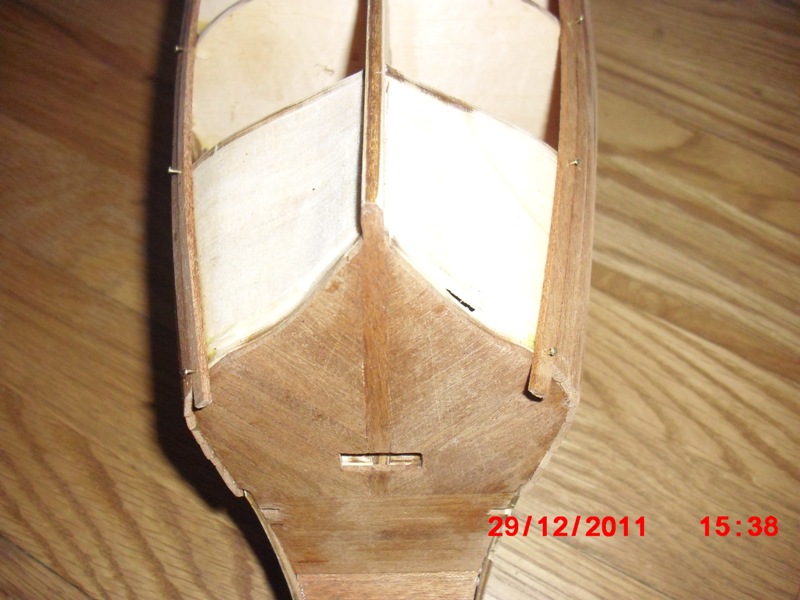

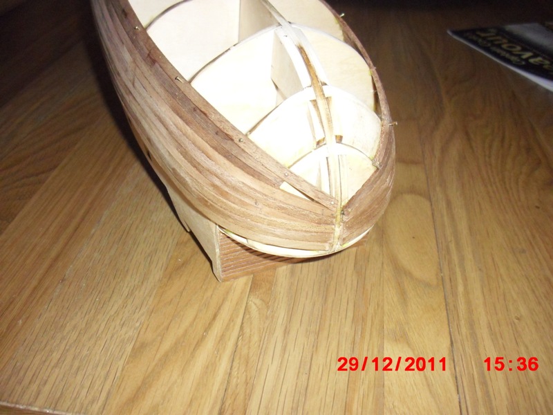

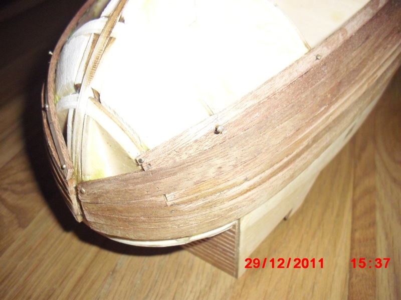

#46 Posted : 29 December 2011 15:55:19
PLANKING THE HULL
I fitted the formed planks to the Hull, then I soaked and formed some more etc etc, its a slow process but rewarding.
Please note how I have shaped the planks to fit the Hull and left a triangle to fit the "Dropper":-

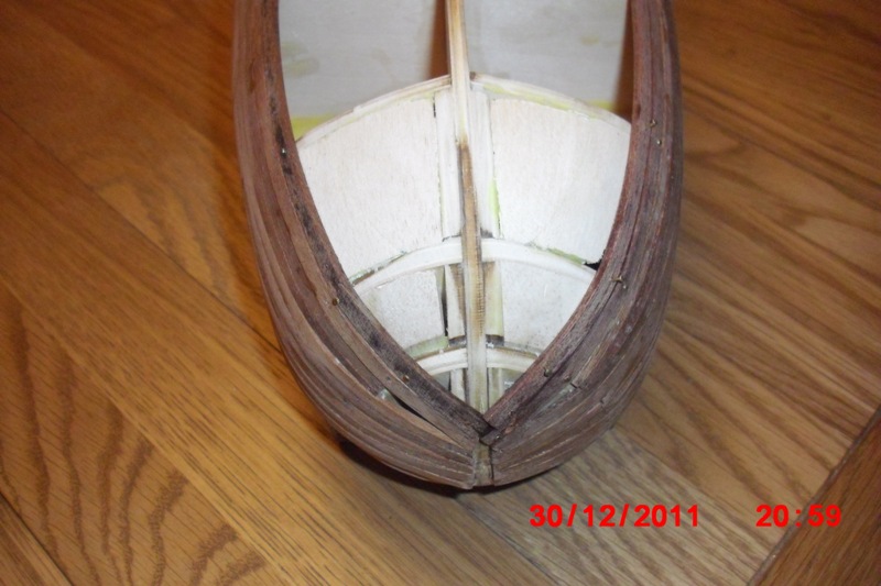

#48 Posted : 30 December 2011 14:32:19

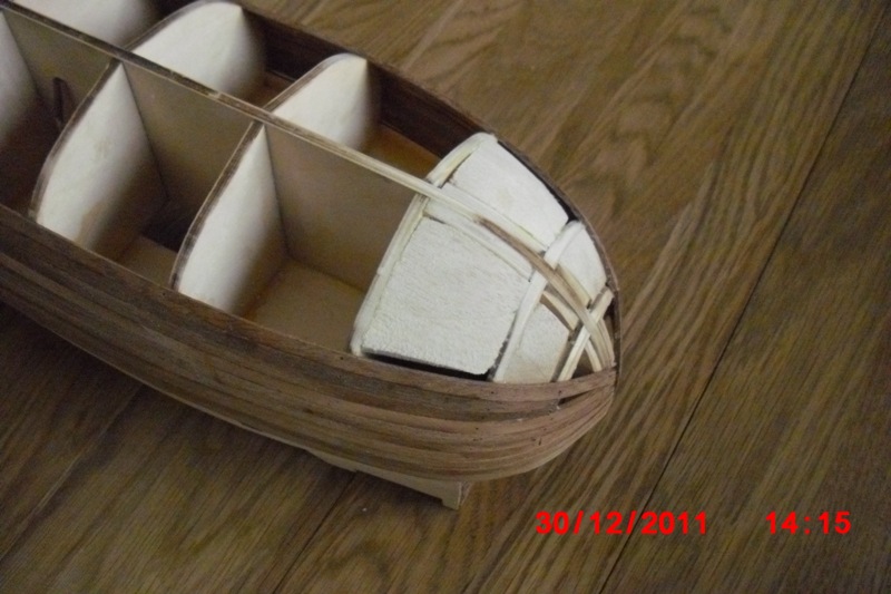

FITTING BALSA FILLETS
I decided to fit two more fillets at the bow to get a better curve on the planking:-

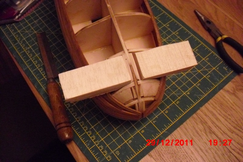

#49 Posted : 30 December 2011 21:18:37
PLANKING THE HULL
Well Team just a couple of photos, where I have soaked 3 more planks and pinned them onto the Hull to dry and form their shape.
The balsa fillets on the Bow have really done their job,producing a nice curve on the PlankBigGrin :-
Thanks for watching, Mike

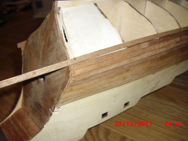

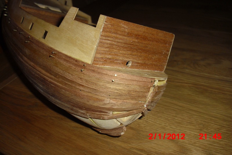

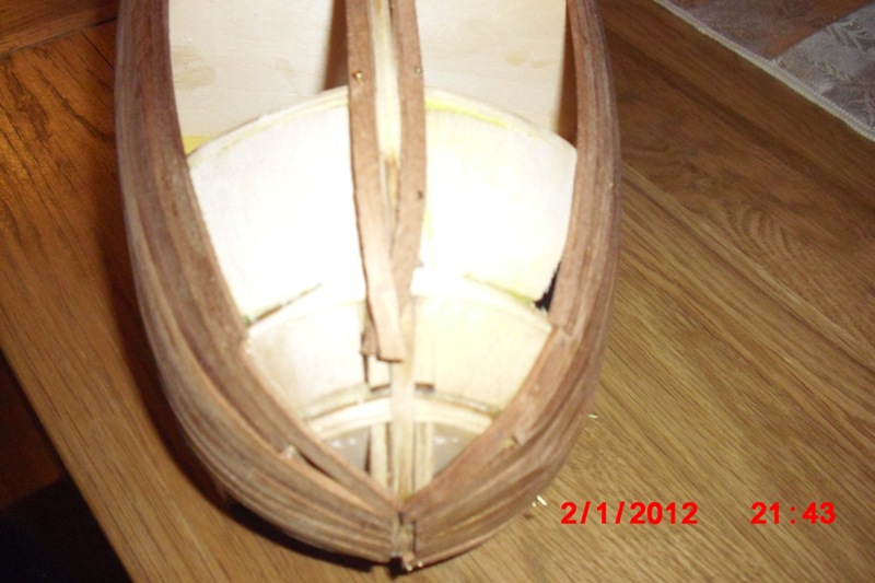

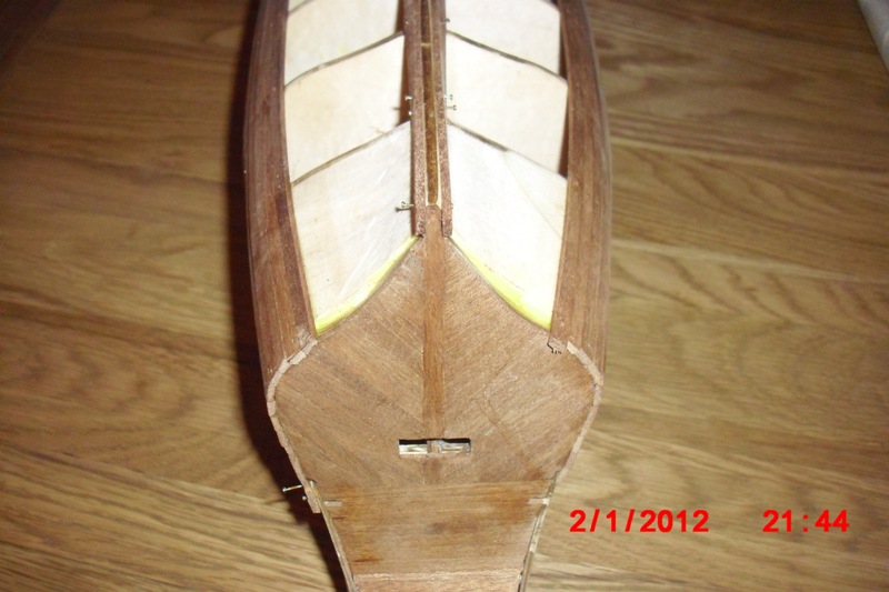

#52 Posted : 02 January 2012 22:03:51
FITTING THE GARDBOARD PLANKS
Hi Team I have soaked and and dry fitted these two planks so they will form the crrect shapeBigGrin Have a look:-

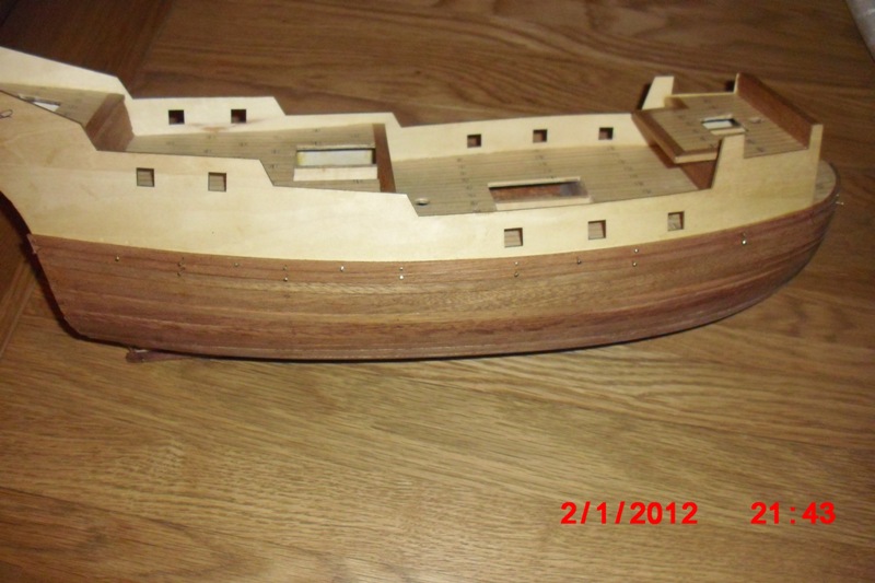

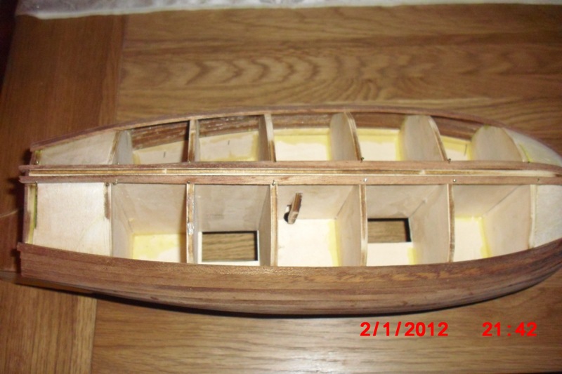

#53 Posted : 02 January 2012 22:10:43
PLANKING THE HULL SIDES
BigGrin
I have fitted two planks on the starboard side,which start to cover the side of the ship, thanks for watching questions and comments welcome, here are the photos:-
