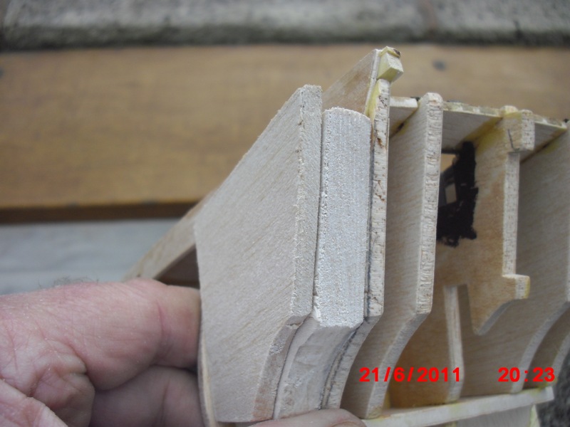

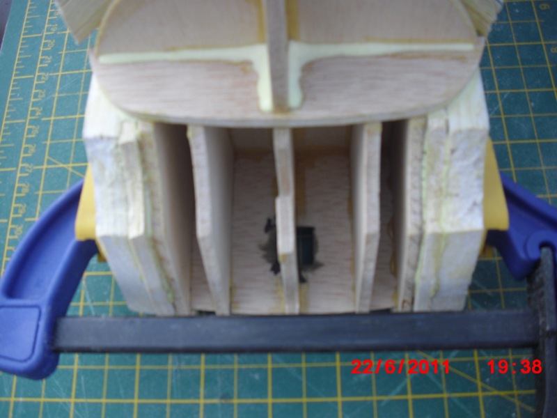

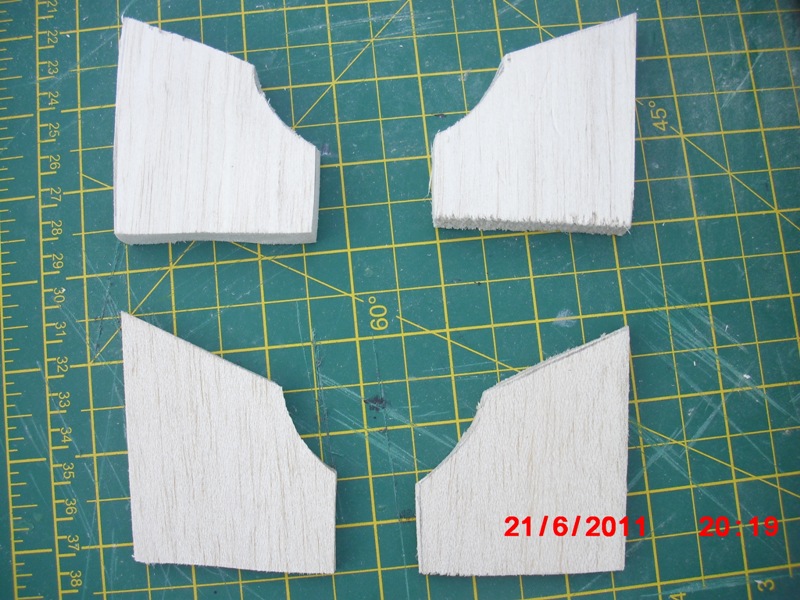

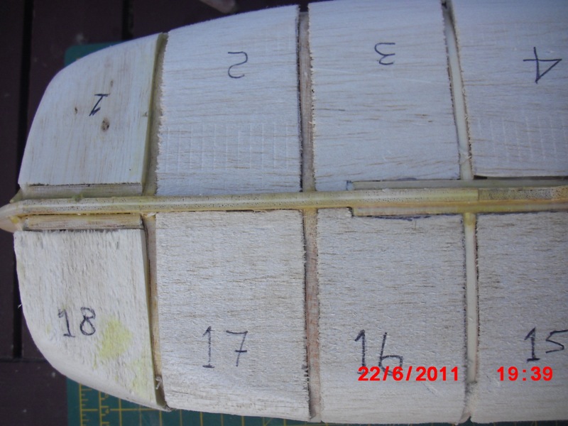

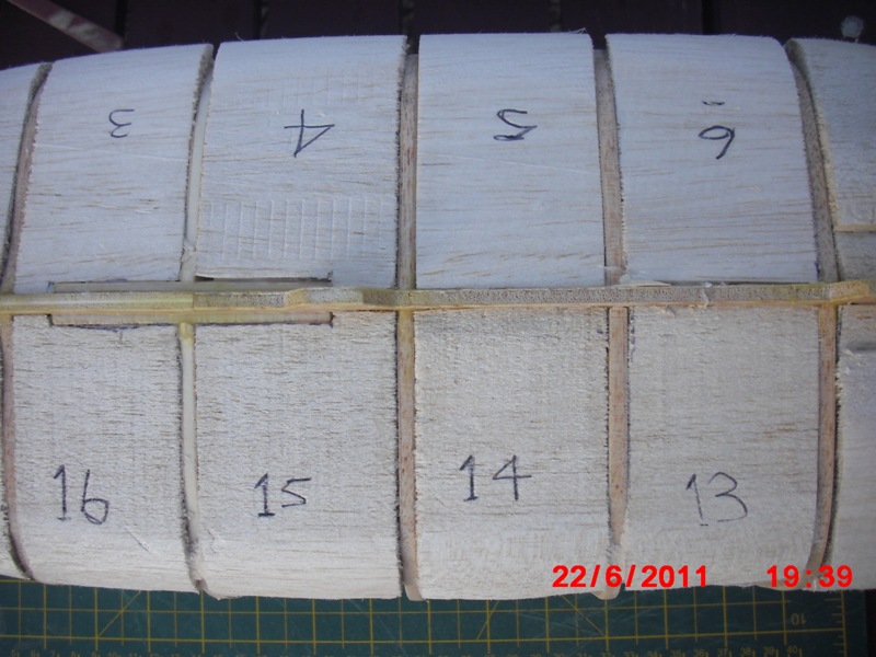

Next up is to do some shapeing of the balsa fillets I fitted to the base of the Hull.
I prefer to shape alittle bit at a time, its along build ( 100 issues ) so I do not have to rush, I can stand back and review each time I do it.
You will see any progress when you look back on the build, here we are:-

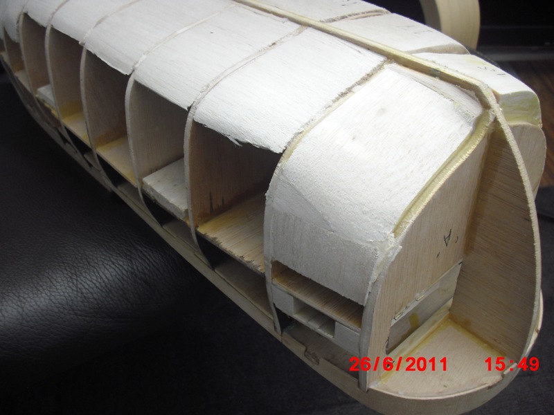

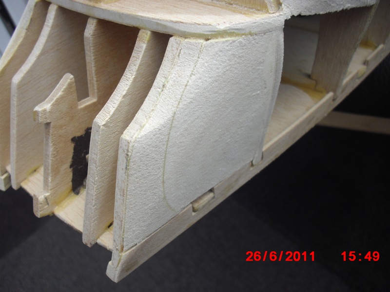

#44 Posted : 26 June 2011 17:23:55
Hi again, did some fairing of the Hull particulary around the balsa fillets at the stern, and work on the port side bottem of the hull, again balsa fillets, slow process but I have loads of time, so no rush, here are the photosBigGrin

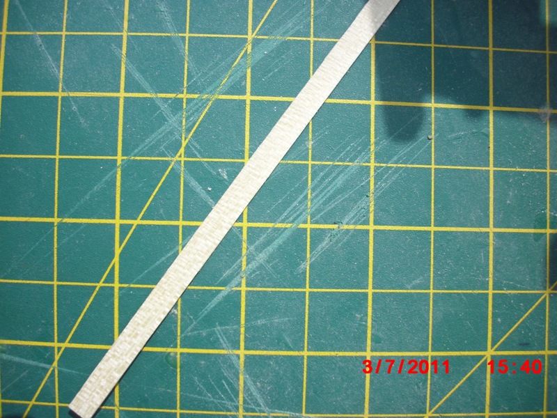

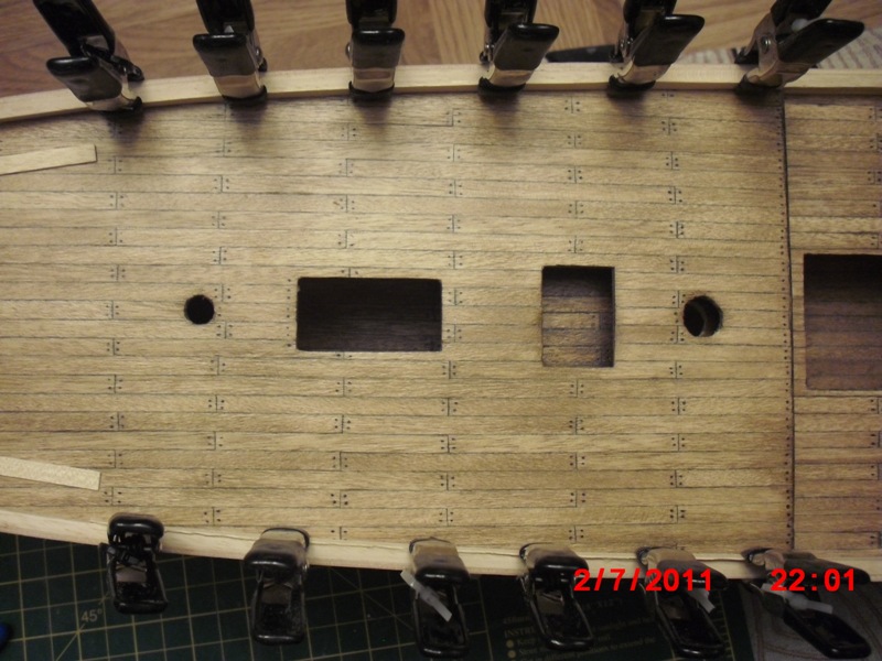

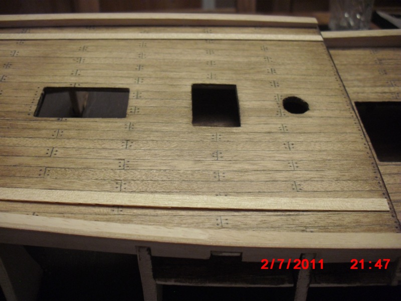

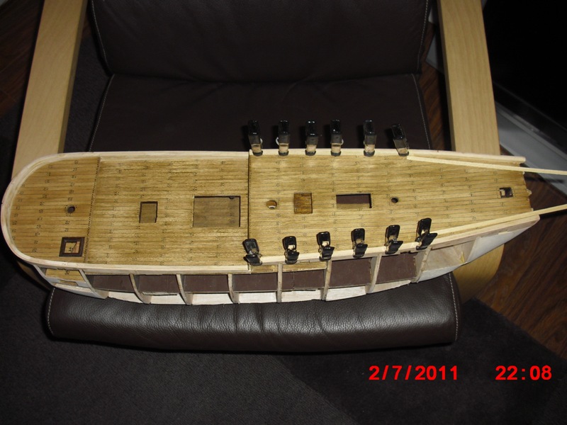

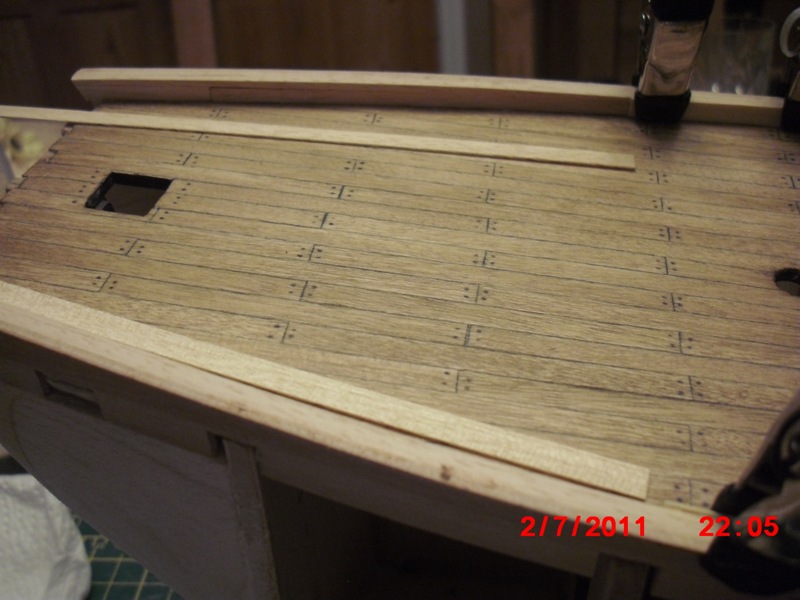

Hi again, the next job to do is line the rear deck Bulwarks.
You use stips of planking that have been left over from when you planked the Decks, see photo

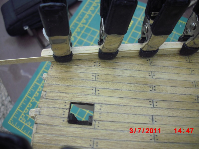

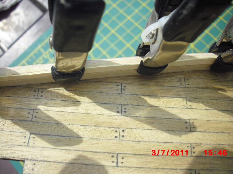

#48 Posted : 02 July 2011 23:31:44
Now run some glue along the length of the plank (I use Aliphatic for better adhesion) place it on the Bulwark, and clamp it in place.
Repeat the procedure for the other side, and leave to harden, it will look like this:-
#49 Posted : 02 July 2011 23:37:14

#50 Posted : 02 July 2011 23:40:39
This is how the Ship looks at the moment and that is all for nowBigGrin HAPPY MODELLINGLOL

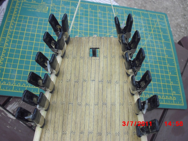

#53 Posted : 03 July 2011 16:12:44
Next up we remove the clamps from the work we started on the rear deck bulwark, the lineing is higher at this point, we will need to sand it down laterBigGrin
#54 Posted : 03 July 2011 16:17:42
We will now finish lineing the last 1/3rd of the rear bulwark, apply the glue to the plank fit it and clamp it.And repeat for the other sideMellow
As you can see the plank does not fit to the top of the Bulwark, we will add a couple of fillets next, when what we have done so far BigGrin is set.

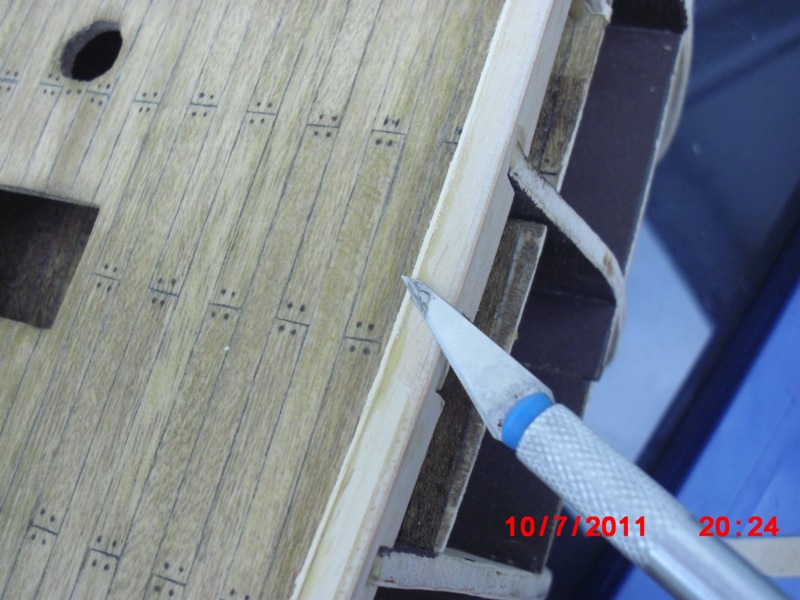

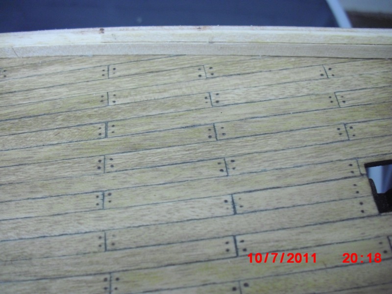

#60 Posted : 10 July 2011 22:08:22

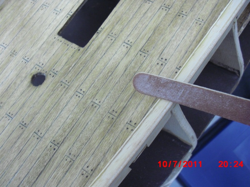

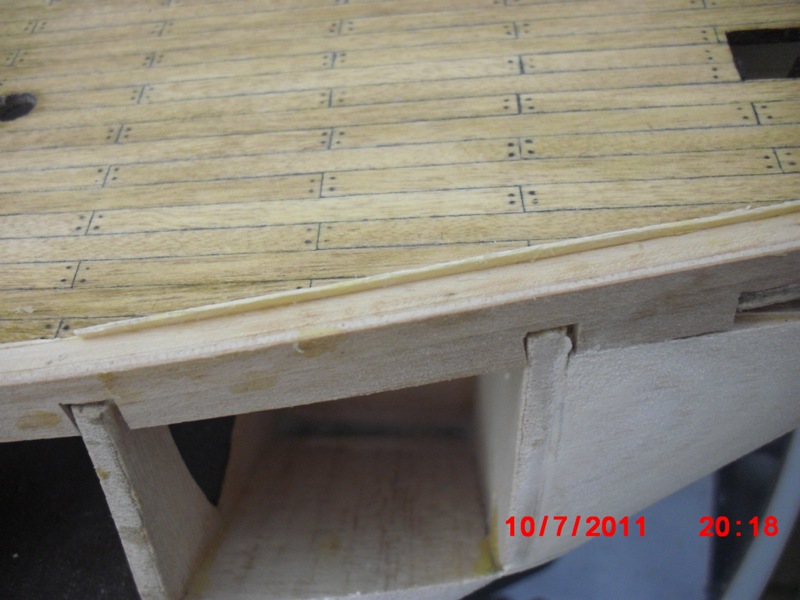

We need to trim these edges flush with the rear Bulwarks, useing a model Knife and a nail emery board, this is the result:-
