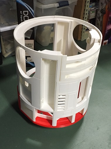

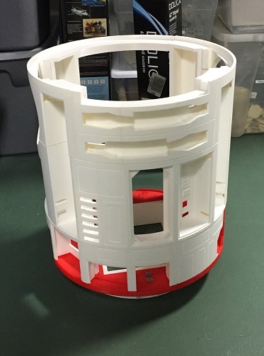

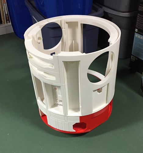

More stuff done on R2.my printer had a bad thermocouple so she neded some surgery to fix and now she is hard at work again.The body is pretty much complete except for a removable back panel and some braces for the shoulders.

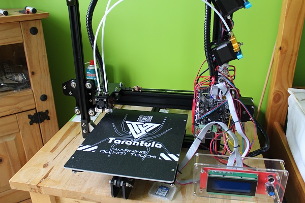

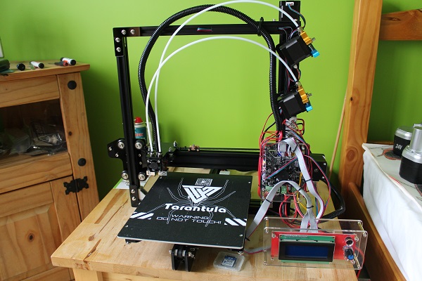

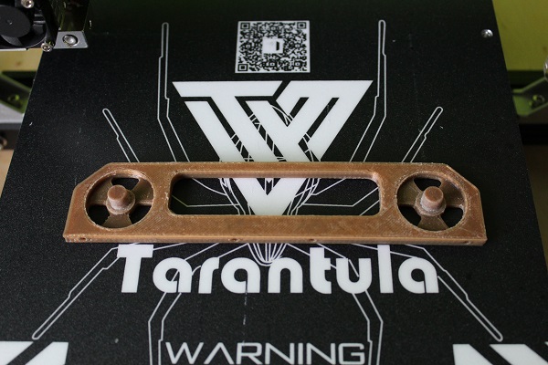

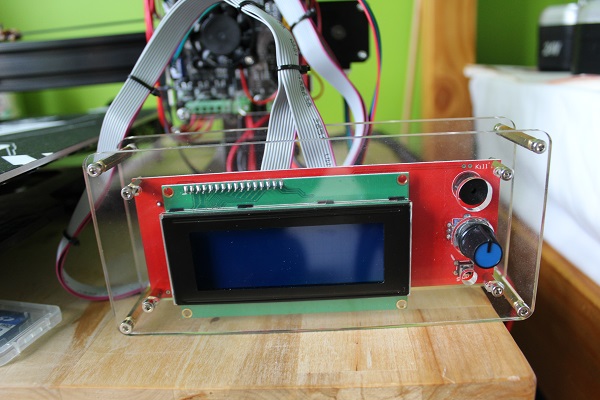

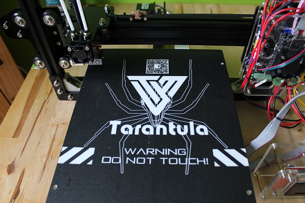

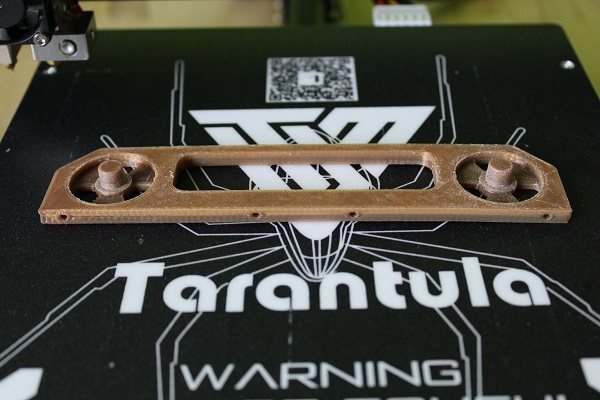

Hi Carl, he is a couple of pics of the Tevo Tarantula.
The part I have printed is for a filament dispenser.
Peter

Looks great.Does it have a heated print bed?
Ritchie69
#51 Posted : 30 August 2017 23:51:00
Joined: 29/01/2017
Posts: 177
Points: 546
Location: Corby, UK
Yes, I also got the large bed & the twin extractor.

Very cool.You can print some pretty nice sized parts with that

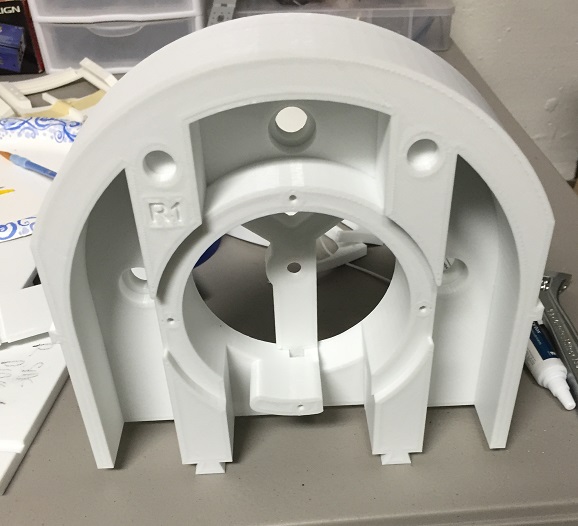

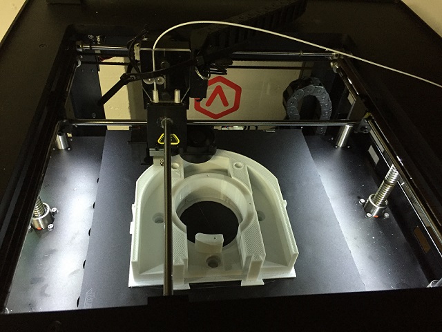

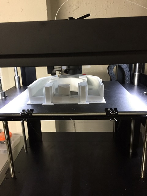

The longest print so far.27 hours.Used 400g of filament.This is the top of R2s right leg. Always a challenge printing large flat parts because of the parts lifting off the print bed.Set the print bed to 65c and it stuck like glue.

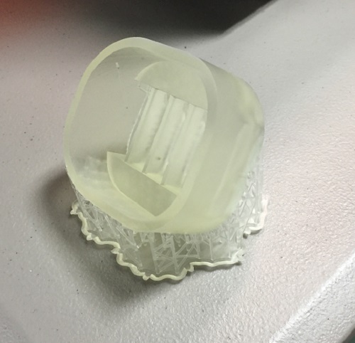

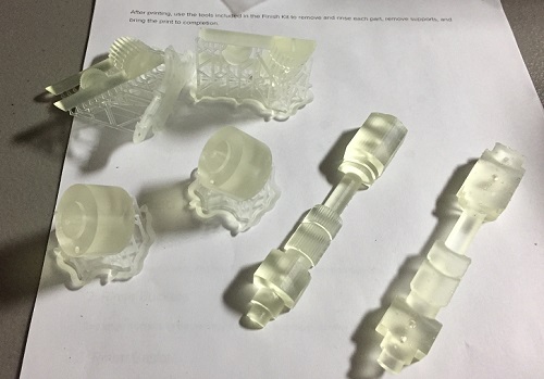

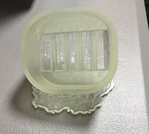

I started working on the detail parts for R2.The Raise 3d is not so great for really fine detail so I printed these parts on the Form2 SLA printer. These are the greeblies for the right leg horseshoe and one of the front vents.The vent is the largest piece I have printed so far with the form2.This was an 11 hour print.
