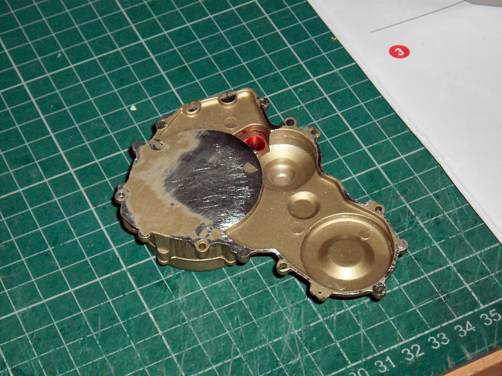

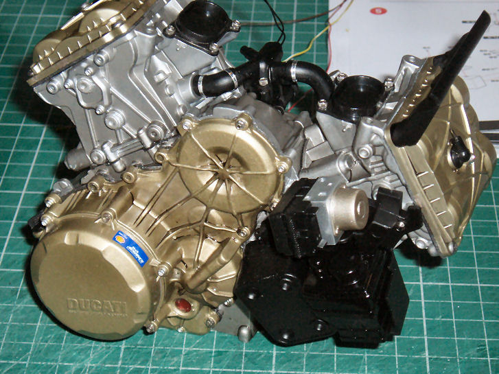

I'm going to make any 'extra' bits myself and add a very light touch of weathering, particularly the engine bits.
These bikes are 'superbikes' and I'm fairly sure they are pampered and polished as much as Ferrari's and Lambo's so the engine won't be an oily dirty object.
There will be some dust and grime in the nooks and crannies, but that's about it.

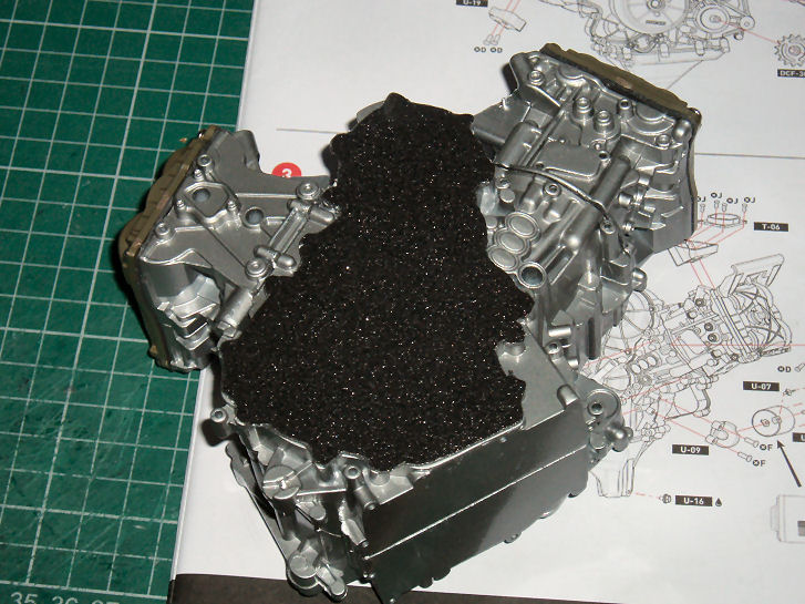

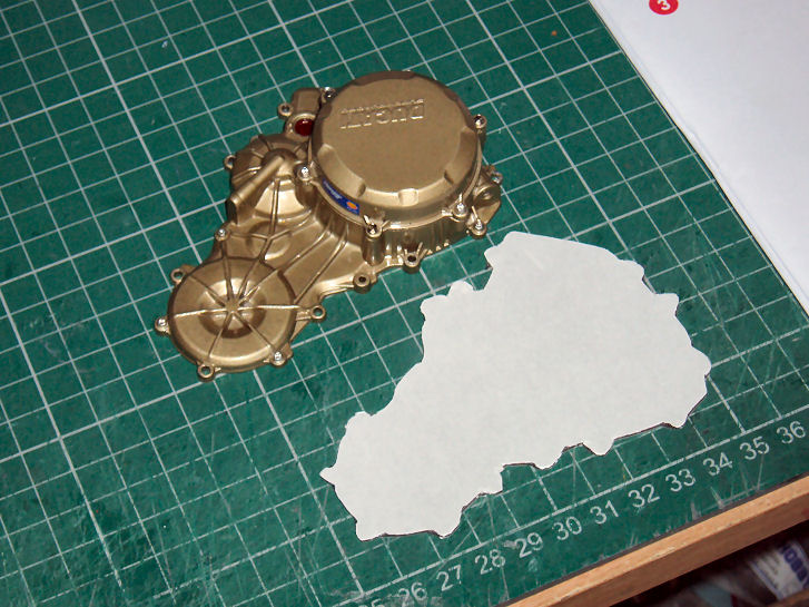

Anyway, one of the side panels to go on next.

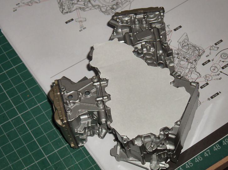

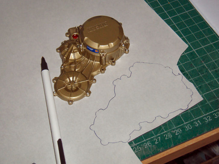

The back of the part had to be filed down as it wasn't flat and 'wobbled' on the mirror tile I use check these things.
Incidentally, a mirror tile is great for checking 'flatness', as any gaps show up very clearly, being reflected in the mirror.
A gasket was cut from the thin foam and trimmed to fit.
It was then carefully applied to the engine area, and then the outer cover was put in place.
The hex bolts will be added next.
Apologies for the 'first' pic being at the end.
Somehow I missed it during uploading them all.
kpnuts

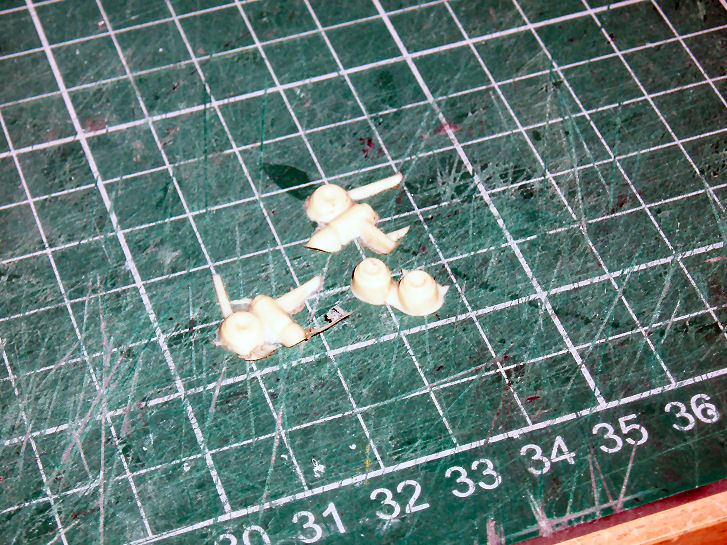

I've added a few more bits.

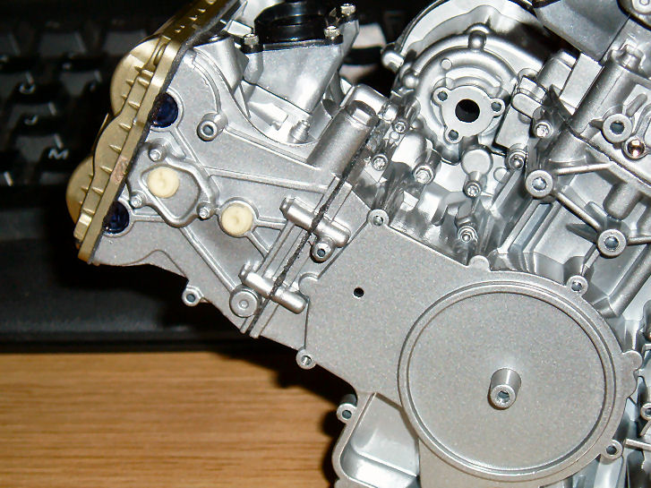

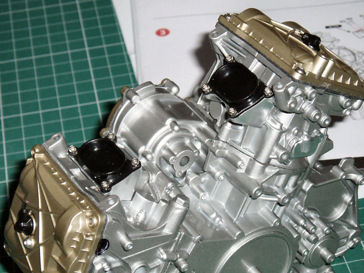

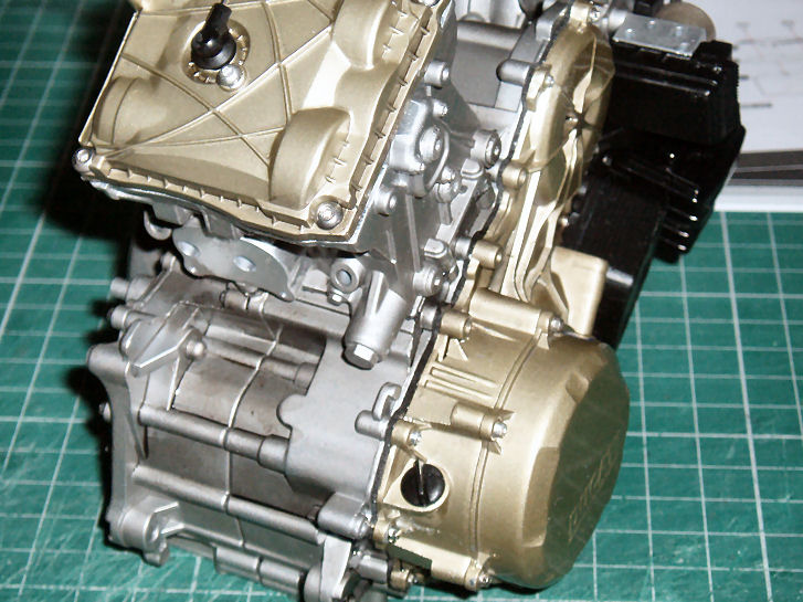

Something missing are the blanking plugs over the huge holes in the cylinder heads where the fixing screws go.
I made these by copying other plugs on the engine using good old Plasticine pressed over other similar plugs on the engine.
These were cast in resin, trimmed and glued (CA) over the dreadful holes.
The plugs will be painted silver.
When I get the replacement engine cover part and fit it, the light weathering will be attended to.

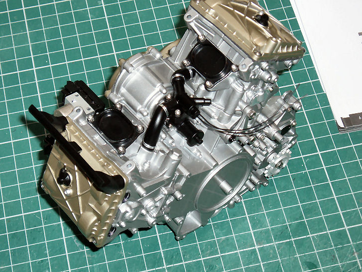

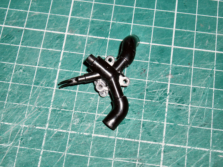

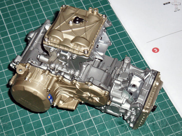

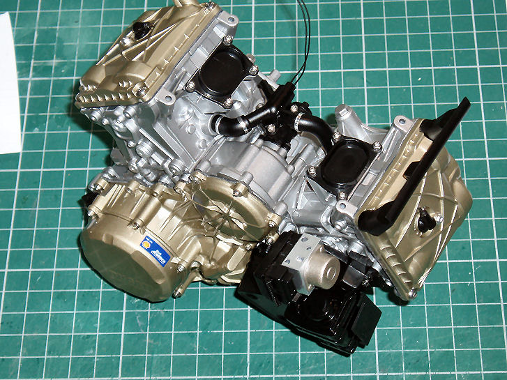

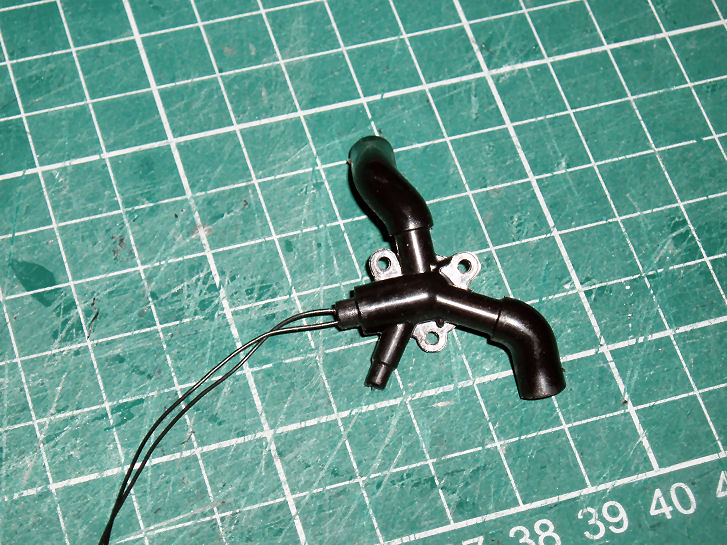

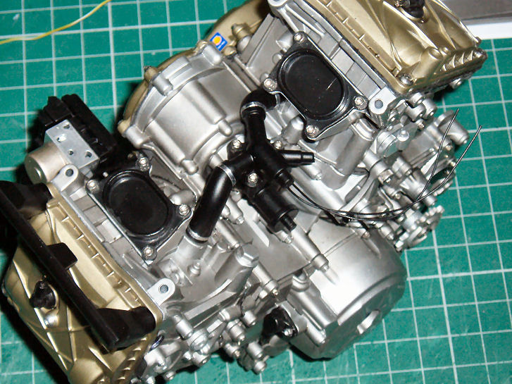

The replacement side cover arrived today so now that is fitted.
The water pump assembly has also been added after cutting off the little plastic pipes that are supposed to be wiring.
Proper wires are in place and will get some shrink wrap treatment when the shrink wrap arrives.
That will also allow me to get on with adding some of the umpteen missing wires...

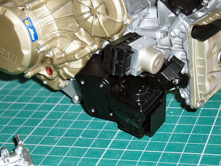

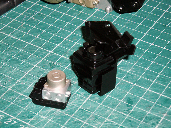

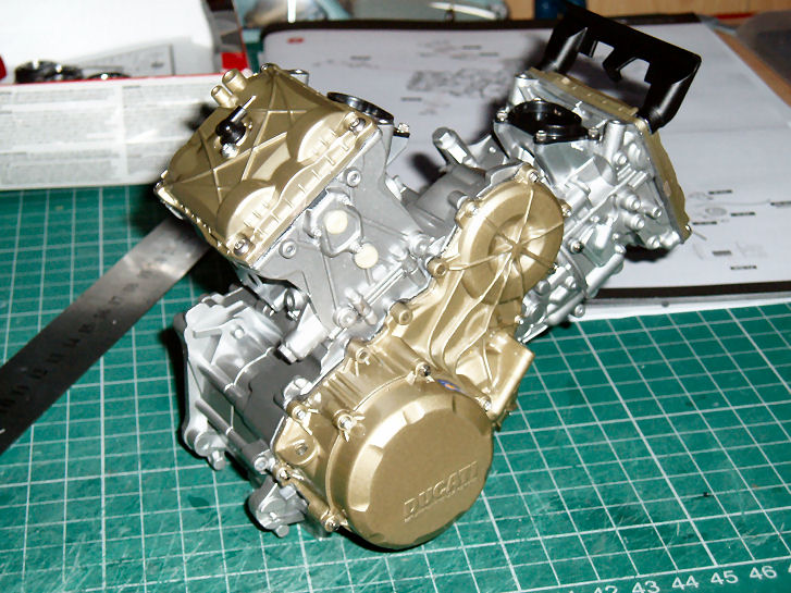

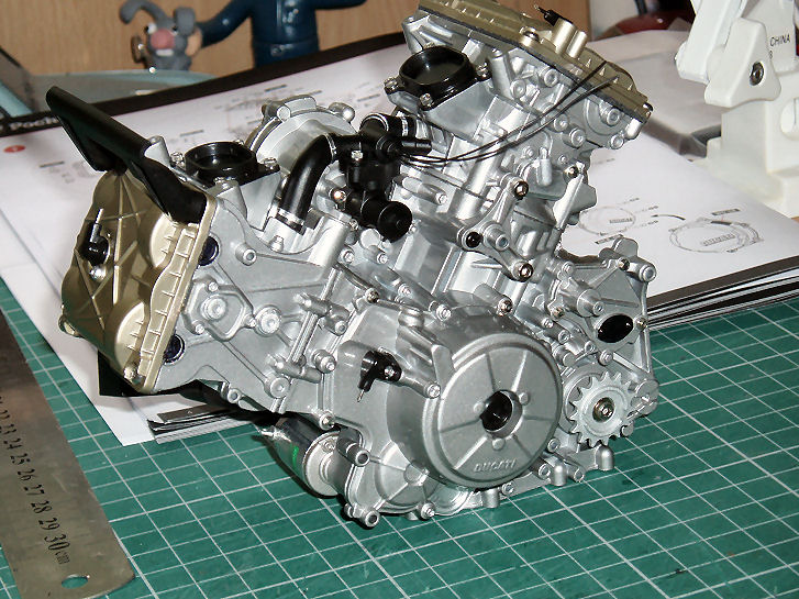

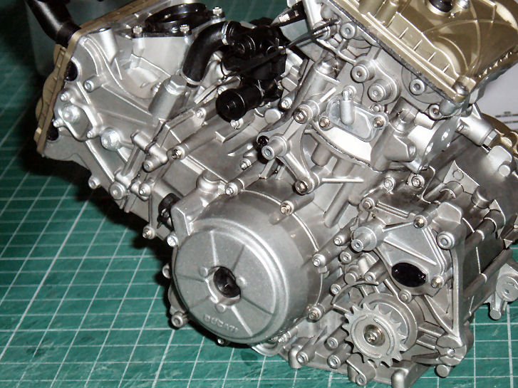

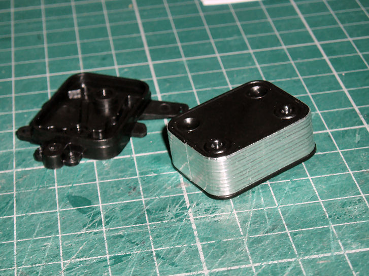

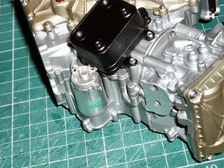

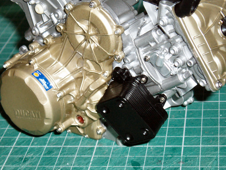

I've added the charcoal canister and oil filter to the engine.
Also assembled and fitted is the starter motor.

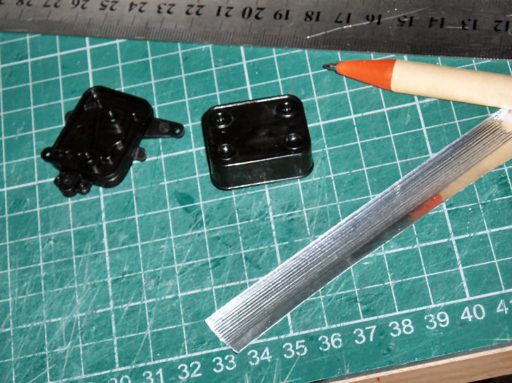

The oil filter in the kit is wrong in that the body should have ridges running around it.
I made the ridges by scoring parallel lines in thick aluminium tape and then wrapping it around the filter body.
It was then painted.
The ignition block was also painted and assembled, and then fitted.
I've now applied the first light washes of weathering using matt black, tan and dark earth paints thinned with white spirit.
Frustratingly, it doesn't show up very much in photo's but it is there.
I'm not going to go potty with weathering as I want the bike to still look very well cared for, but used.
kpnuts
