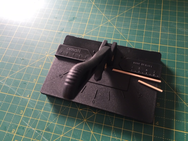

BigGrin ooow look at my new toy!!!! Love Just the job for cutting loads of planks to the same size Cool

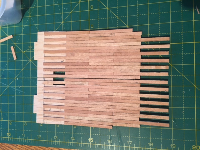

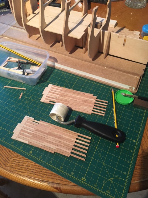

#44 Posted : 12 May 2017 13:29:51
Hi guys time for my next update. As mentioned, i wasn't happy with my previous attempt at planking, so bought my new toy (above), and this is my result! Used 4mm Tanganyka rather than the lime wood (nicked the idea from Steve-O thanks mate BigGrin ) Found a new use for my wallpaper seam-edger too!
Much happier with this one. Just needs sanding down and either matt varnishing or use Danish oil (never used this though)
Maybe a desision for another day BigGrin

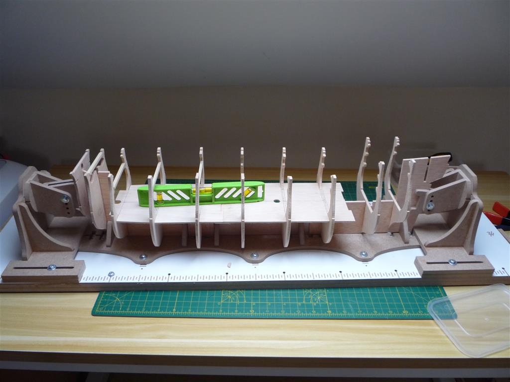

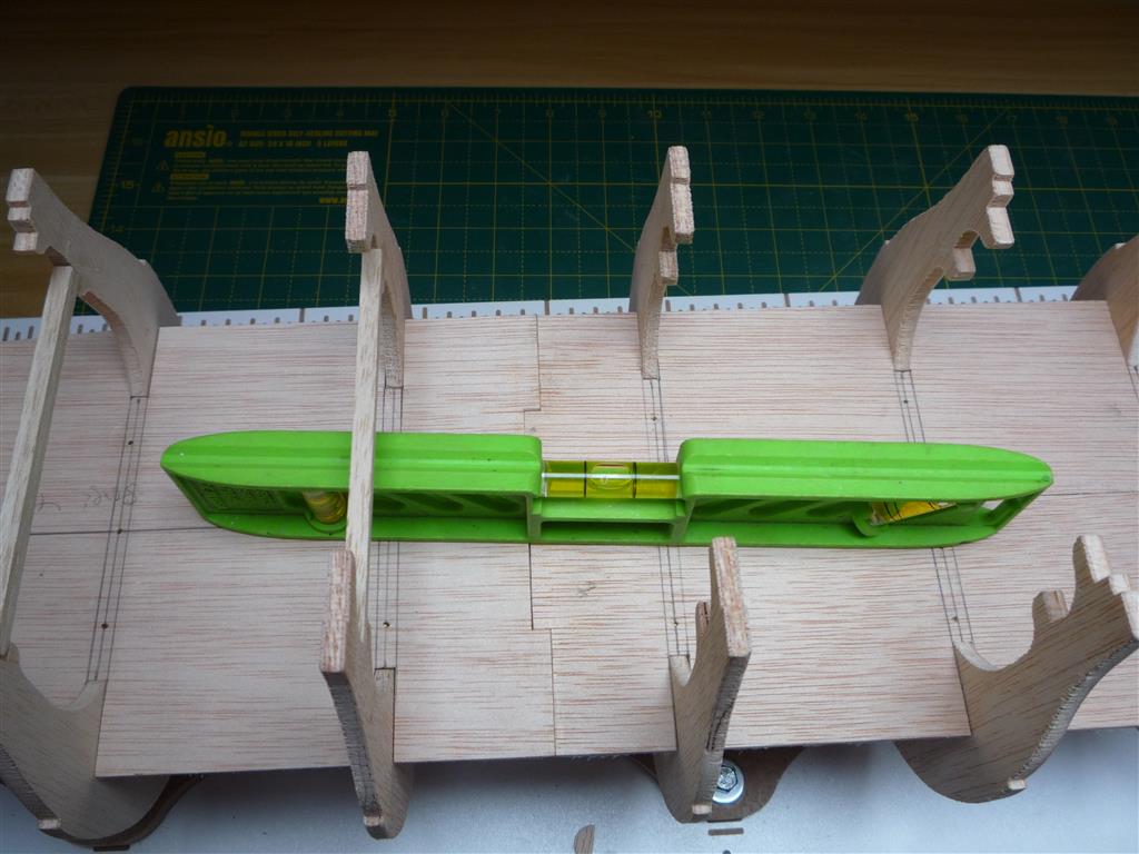

#47 Posted : 30 June 2017 15:19:22

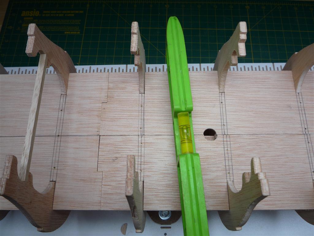

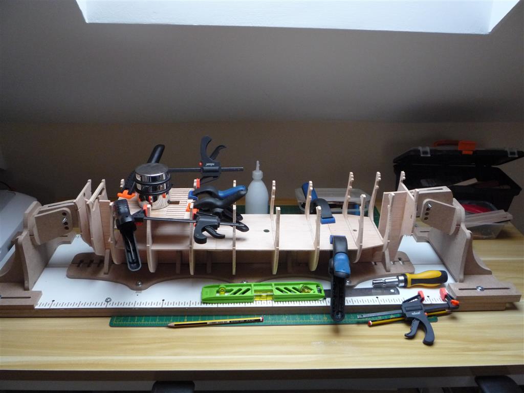

Cool Thanks for the kind words guys. Here is my latest update. As you can see i have moved her to the bigger jig. Really like the way it holds and squares everything up nicely. I have decided to build each deck up as far as possible as i go. That way i am hoping the planking lays better and the finished stain/varnish will be more even. More to follow....
#48 Posted : 30 June 2017 16:59:35

I decided to biuld the hull up with all the bulkheads in place so i can do a straight run on the deck planking. Didn't like the idea of stopping and starting as was descibed in the instructions. Had a little bit of an issue with the middle section not sitting right after gluing, so using a tip i had been given earlier, i applied hot water on a paintbrush to loosen the glue and re-seated the deck.

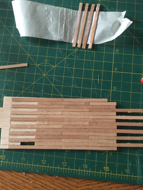

Hi guys,
Well it's been a while since i updated this build. Upon reflection, i didn't like how i'd planked the decks with the Tanganyka, doing it in small strips. So bought extra planking strips, and assembled them up to current point. Much happier with the result now BigGrin . I will upload photos later.

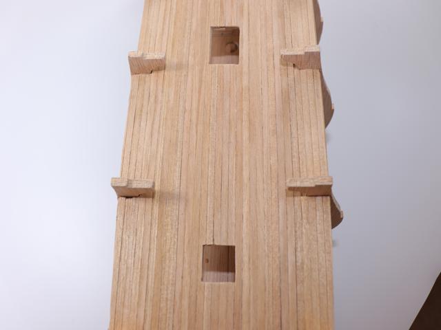

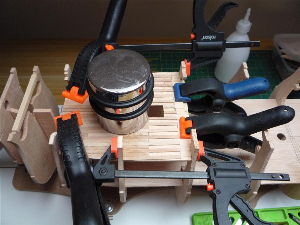

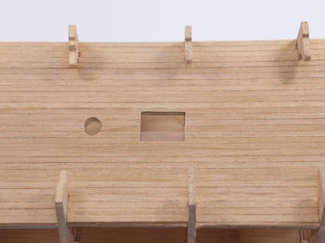

#54 Posted : 25 October 2018 19:55:32

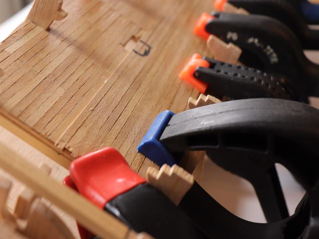

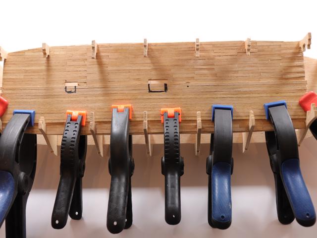

Some photos to show current progress. Have removed bowsprit deck for now to allow better access. Unhappy with the planking of the deck, i have started to redo it in full strips. Sort of like 'double planking' BigGrin . Much happier now.
That's the beauty of these builds, we can make them look as we want ThumpUp
Do you think all the clamps are overkill? Flapper LOL BigGrin
cheers Gray
#55 Posted : 25 October 2018 23:21:24
Very nice update Gray, making good progress....Cool Cool .. Can never use too many clamps, main thing is the pieces stay in place while the glue sets.....Cool Cool .. Look forward to seeing your next update.....

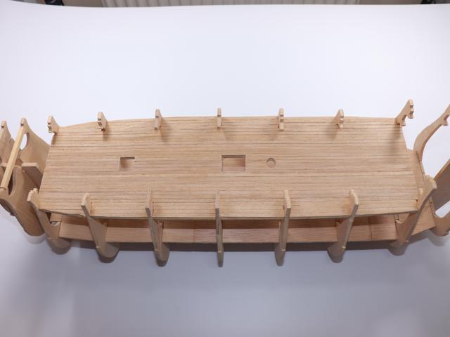

#57 Posted : 05 February 2019 20:29:18
BigGrin Thanks for looking in, guys ThumpUp
Here is another little update. I have completed the planking on the middle deck, and given it a light sanding. Next, i shall start looking at oils and varnishes. hopefully, that will really bring out the colour of the wood strips BigGrin
cheers
Gray
