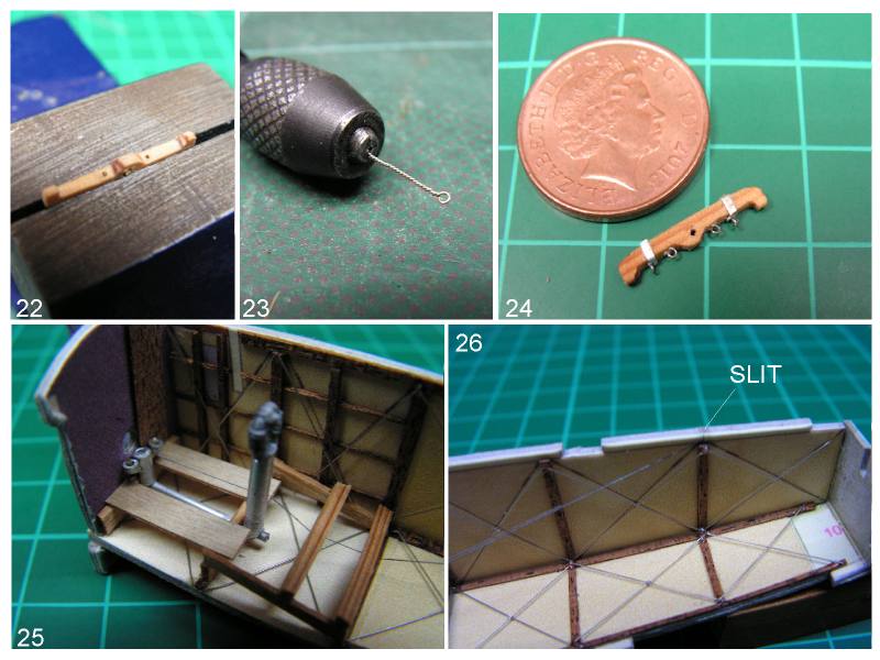

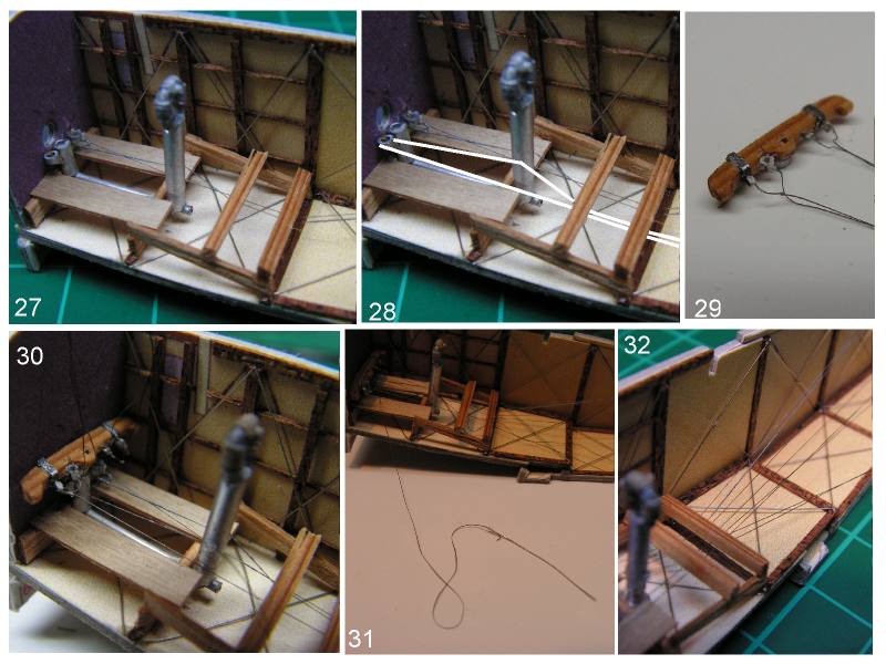

Carrying on with the rudder pedal bar, there are four attachment points for the control wires, two to control the rudder, and the other pair are attached to the tail skid which is actually steerable! (I have to admit, I never knew that thing was so complicated – I always thought it just ‘stuck out the back’, in actual fact it formed an integral part of steering the aircraft around on the ground!) The first pair of holes is being drilled in, in Photo 22, the other pair are further out and also have a metal re-enforcing band as first seen in Photo 24 alongside the traditional penny. Photo 23 shows the metal ring bolts being formed, the same wire strands again, curved into a loop which is gripped in the pin vice, a section of brass rod is threaded through the loop and the vice is simply turned repeatedly to form the ring and its tail. After drilling all four holes, the twisted eye bolts were trimmed to size and super glued into the wooden pedal, the inner two horizontally, and the outer pair vertically. The metal re-enforcing band was then formed out of some of the thin eye ointment tubing as shown in Photo 24.
Before the pedal can be fitted in however, I first had to add the control wires which connect the control column to the elevators. For this I decided to have a go at a new modelling medium – Uschi ‘Rig that thing’ Elastic thread. I first came across this stuff when I was looking up rigging biplanes on Youtube! The first one I found was called EZ Line, an American product which comes in a 100 foot reel which is two and a half inches across. This was first produced for the model railway hobby to represent power lines etc and I duly sent off for a spool of the line called ‘Rope’. I thought ‘rope’ was probably Yank for ‘thread’, unfortunately rope meant rope!Blushing The line was nice and stretchy, but it was also brown – for rope of course! This meant it was not quite right to simulate the steel control and bracing wires (although a later addition to my wiring up toolkit meant it may have been all right after all!) Anyway, I then came across this video on Youtube https://www.youtube.com/watch?v=mJGTPovCcg8
produced by Uschi himself showing how to use his stretchy thread so I sent off for one of them as well. The Uschi thread is actually half as long again at 150 feet but instead of the big plastic spool like the EZ Line, this comes on a tiny metal bobbin only 2cm across, in fact it’s a sewing machine bobbin (to cut down costs) even so, this thread is still around the £10 mark. For my model, the control cables will be done in the Fine Size (Item Code 4006 at 0.003mm diameter) and the later bracing wires will be in Standard Size (Item Code 4005 at 0.005mm diameter).
Photo 25 shows the very first application of this new (for me) accessory. This is the first part of the starboard elevator control wire. A length of the fine thread was cut, twice the length to reach from the column to the rear most wooden frame as seen in Photo 26. A tiny drop of super glue was applied to the control column, just up from the base and the thread was attached at about the mid point. The forward section of the thread was then taken around the right hand aluminium pulley and wedged in place with a short length of Victory Sapele veneer (you can just make it out in the corner of the cockpit front), this was just to keep the almost invisible thread out of the way whilst I secured the rear part! The other half of the thread was then run back under the pilot’s seat supports and then taken back to the previously mentioned wooden frame member where it was secured in place, wedged into a fine razor cut slit in the card fuselage side. This is the point on the outside of the fuselage where the control wires emerge on their way to the elevator. Once that was in place the veneer wedge was removed and the front half of the thread was brought back around the pulley, following the other wire under the seat and back to the same slit as shown in Photo 27. The next task was to repeat the whole process on the port side, illustrated by the white lines in Photo 28. This side however is a little more complicated! At the moment, there is no port side fuselage panel in which to ‘slot’ those threads so the two ends are simply placed inside a scrap of masking tape so they don’t get lost (or accidentally glued in the wrong location!) In the rest of the photos, when you see a pair of cables going nowhere in particular – that’s those two again! Now it gets very finicky, not to mention complicated. In Photo 29 we go back to the rudder pedal again, this time fitted out with its four separate elastic threads. The two outer ones go to the rudder whilst the inner pair run back to the steering mechanism of the tail skid. In the case of this model however, they all run back to the rear bulkhead, which you can see in the earlier photos. The rudder cables are secured in razor slits at the top of the bulkhead and the two skid wires are glued into a pair of wire ring bolts placed into two drilled holes lower down.
The rudder pedal has been glued in place in Photo 30, and the four threads are temporarily out of the way, placed over the top of the front bulkhead. As soon as I began to try and pass the threads under the seat supports it became obvious that I was running out of room to do each one ‘by hand’ – the thread is great at stretching, but it sure doesn’t appreciate being ‘pushed’ into tight spots! The answer was very simple in the end and is illustrated in Photo 31 – I just glued each thread to a temporary ‘needle’ made from a short length of the wire strand and then I could ‘thread’ that needle under the supports and out the other side carrying the elastic thread with it. In the final Photo 32, we have all eight control wires in place under the seat supports, six of them fixed in place and the other two still dangling away waiting for the missing left side panel.
In the next instalment, the stretchy threads become a lot more wire-like and the scratch building begins on the cockpit controls.
Until then Happy Modelling to you All!
Robin.

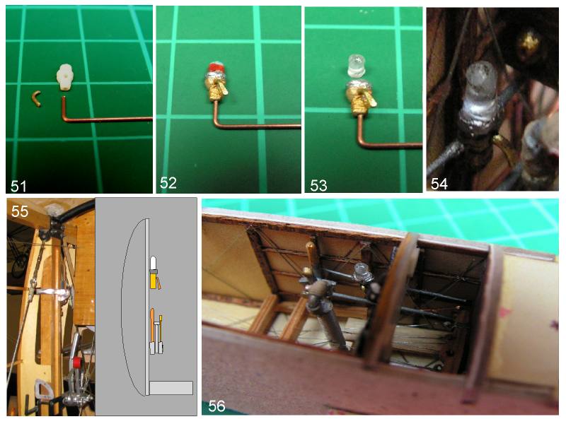

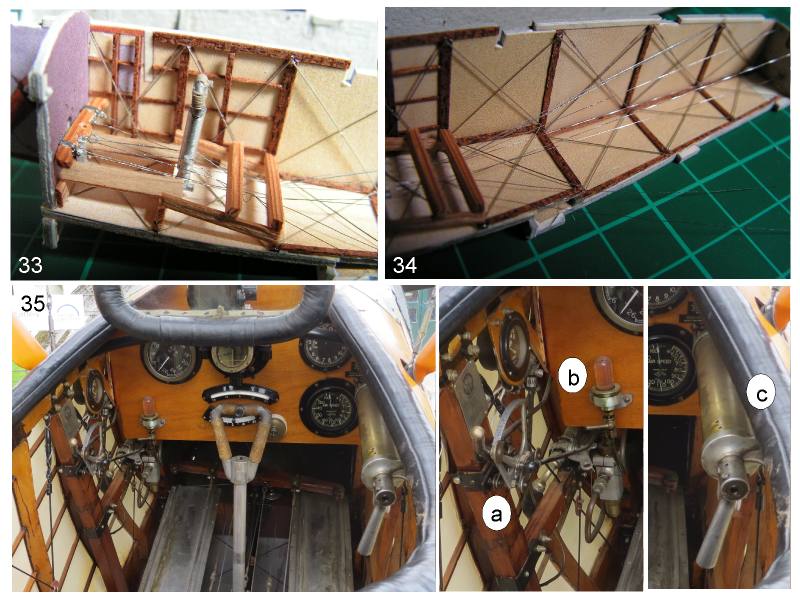

As I mentioned last time, that stretchy Uschi rigging thread was about to become a little more metallic looking to better simulate the high tensile steel that it actually represents. I found another Uschi advert on Youtube where he recommended a silver ink pen to colour the normally black thread. Fortunately, I had already sent off for something very similar after coming across a mention in the Modelspace Tool and Consumable section by Roymattblack regarding a pen with a real chrome effect ink (or paint) “Liquid Chrome that WORKS”. When I first read that account I suddenly thought ‘’ere, what if…’ and immediately sent off. I wasn’t disappointed either, as you can see in Photos 33 and 34, this ink really does turn the black threads into wires! Many thanks indeed for that one Roymattblack! The pen is made by Molotow and is called Liquid Chrome 20 Years Edition. I bought the 2mm nib size but it does come in other sizes too.
On to the cockpit instruments and controls then. Photo 35 and its two enlarged sections show the main set of controls that I intend to build for the cockpit. As mentioned earlier, the cockpit layout on the Pup is anything but standardised. The aircraft all have the same bits and pieces in there, but where they are placed is anybody’s guess. A good example is Part B. This is called an Oil Pulsator. It is connected on the tube which carries oil from the oil tank to the engine and just as the name says, it ‘pulsates’ as the nine cylinders of the Le Rhone 80 hp engine fire up, with the level of visible oil rising with increasing rpm. There’s none of your Castrol engine oils in the Great War however, and despite the Pulsator being there to show the pilot oil was reaching his engine on start up, all pilots eventually learned to fly by ‘feel’ and they knew the engine was ready for take off when the “pleasant odour of castor oil filled the cockpit”! As you can see here, this Pup has the Pulsator on the left side of the instrument panel, the aircraft photos I’m using for reference on G-EBKY however have it fixed on the left side of the cockpit frame whilst a description of starting up the Le Rhone mention it being on the right hand side of the frame!Blink I’ll be putting mine on the left side of the frame as the printed instrument panel shows it wasn’t fitted on the panel itself. Part A is probably the most complicated bit to make, this is a combined engine Throttle and Fuel Mixture control which is connected to the engine via two crank rods, one from each lever. The larger outer lever is called the Blocktube and controls the airflow to the fixed carburettor whilst the smaller inner lever controls the fuel flow to the engine. The positions of these levers is critical – too lean or too rich and the engine will cut out, too lean can be cured in about five seconds but too rich takes thirty seconds for the engine to recover – fatal at low altitudes! Again, this control is often found in different locations – always on the left side frame, but sometimes down at knee height and others just below the cockpit cowling. The big brass cylinder thingy on the right hand side (Part C) had me stumped for ages! I assumed it was some kind of pump and wondered if it was to inject petrol into the engine cylinders. In a way I wasn’t far off – it is actually a hand pump, but it is used to pressurise the petrol tank itself to about 2.5psi, which then forces the petrol into the engine! This is only employed before take off though, once airborne, a little propellor mounted on the Cabane strut (between the cowling and the top wing) then drives a Rotherham air pump to maintain fuel tank pressure. Most Pups have the handpump in this position but a small number were retro-fitted with a smaller pump from the Sopwith Camel, this was fitted vertically to the frame member under the right hand side of the instrument panel.
The last piece I need to build is the instrument panel itself complete with the various dials and other items. My intention here is not to just build the components and glue them in, but to experiment with designing silicone rubber moulds to cast the scratch built parts in polyurethane resin. Many of the Allied aircraft of the Great War used interchangeable parts, so if this little Pup turns out well and I decide to try some other types – I might have less work to do on the next one!

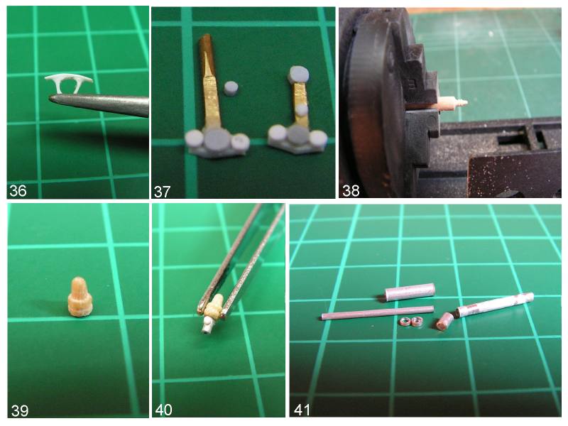

The first of the controls I decided to build is of course the most complicated – the combined throttle/mixture lever, also known as a Tampier. Photo 36 illustrates the first part to be constructed, the central scale which divides the two levers. The centre part being held in the tweezers here is a simple flat plate of thin plasticard with a curved top onto which is poly-glued a thinner strip of plasticard to create the slightly wider visual scale (marked from 1 to 10 in the real thing). Once the top flange was dry I then carefully drilled out and filed the hollow centre as seen here. The two levers, which go on both sides of the scale are shown in Photo 37. A lozenge shaped base in plasticard, onto which a filed brass rod is super glued for the handle. There are three discs on each base with a tiny disc on each handle and a larger one at the top of the Fuel flow lever. The tiny discs mark the point where the control crank (or push?) rods connect. The white discs are sliced from pre-formed Plastruct rod whilst the grey discs are from stretched sprue. This photo was taken after I made the silicone mould, that’s why the little disc has fallen (or been pulled)off the lever! The next item was the little Oil Pulsometer. This was created from a piece of 3mm diameter wooden dowel which was turned (accidental pun!)into the shape of the glass dome and upper body on the Mantua Mini Wood Lathe as seen in Photo 38. The resulting upper half as shown in Photo 39 was then glued to a short length of aluminium tube with another slice of Plastruct rod to mark the turn off switch position shown in Photo 40. As it happens, I had a late brainwave on this piece which really improved the look as you’ll see later!BigGrin The final Photo 41 shows the main components of the Fuel Tank Pressurisation Pump, the last of the cockpit controls before the Instrument Panel. These are all pieces of aluminium tubing sliced up into various parts. At the top is the main barrel with the long thin ‘push-pull’ handle below. The two little rings are the seals on each end of the barrel and the bit being cut off on the right is part of the handle section.
In the next instalment, building the pump and making up the Instrument Panel.
Robin.

The one problem that can be come across with these paper/card kits can be seen in the first photo above - a slightly 'rough' edge to the front bulkhead. This is caused by repeated test fittings of the various add ons which should be expected I suppose as the kit is designed to be built 'once only' if you see what I mean.
Fortunately I'm about three weeks ahead of the diary in the build and the missing side panel fitted on with no problems at all - just the seat belts to finish before I can fit in my scratch built resin chair and begin the outer skin. I was really pleased with the finished cockpit do-dahs (RNAS speak for complicated aviation instruments!)BigGrin

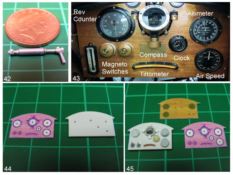

Beginning with Photo 42, we have the assembled Fuel Tank Pressurisation Pump. The various sections of the tubing were slid together and fixed in place with a drop of thin super glue. The final component for the cockpit (apart from the seat and seat belt which comes later) is the actual instrument panel complete with the various dials and other useful bits! Photo 43 shows another Pup’s instrument panel, this was the closest I could find to my aircraft’s layout – as mentioned before, there are a multitude of different types of panel depending on which company built the thing! There are a couple of extra dials ‘up top’ on this one which don’t appear on mine, one of them is I think the pressure gauge attached to that same pump which on mine is possibly on the port cockpit frame close to the Pulsator (whether I have enough room to fit that one in remains to be seen!) What the other one is I’ve no idea. On the top left is the Tachometer or Rev Counter. This one has been mounted in straight but many were fitted in pointing about 45 degrees to the right. This was a very simple and brilliant idea. On some of these tilted dials you can see a red mark at the twelve o’clock position. This marked the engine revs at cruising speed so with the dial tilted over, instead of the pilot having to constantly check his revs, all he had to do was to glance over and ensure the pointer was at twelve o’clock – much less concentration required!Cool In the centre of the panel is the Magnetic Compass, mounted on a set of gimbals allowing the compass dial to be vertical whatever the attitude of the aircraft might be. At the top right is the Altimeter, which measures the height of the aircraft above the ground. In this era, the altimeter was in fact a simple barometer which measures air pressure with a dial showing feet instead of millibars of pressure. Usually, the barometer/altimeter could be set to zero when on the airfield to allow for that location being above sea level. Below the Altimeter is the Speedometer or Air Speed Indicator. This again is a form of barometer but this time it is measuring the difference in air pressure between ‘ambient’ air pressure (eg, inside the instrument) and the air pressure inside a tube mounted on the main wing strut (the Pitot Tube). The faster the Pup is flying, the greater the difference between the two pressures and the more the dial pointer moves. The scale is calibrated in miles per hour. To the left of these two dials is a small clock although in some aircraft there would be a clip-in fitting to take the pilot’s personal Hunter type watch instead of a permanent time piece. In the bottom centre is the Tiltometer. This is a very basic Artificial Horizon which in this case is a simple spirit level – when the bubble is in the middle, you’re flying level (wing tip to wing tip)! Incidentally, there was another form of Tiltometer which worked the opposite way round, instead of a bubble floating to the top of the curve, the curve was upside down with a heavy ball bearing which would roll to the bottom. If you pop back to the photos of the real Pup cockpit an installment or two before, you can see that that particular Pup has played safe with both versions on the panel! The last two controls found on my Pup are the two brass switches on the bottom left. These are the leading and trailing Magneto Switches used to prime the engine for firing up, (what the pilot switches on when "Contact" is called out). Because the aircraft industry was still in its infancy, these were actually brass Edwardian style electric light switches as found in the ‘posher’ houses of the time!Blink The final instrument seen on this panel isn’t found on my Pup, what looks like a thermometer is actually the Petrol Gauge – the higher up the glass tube the yellowy liquid appears, the more fuel you had left! Mine must have a gauge somewhere - I’m just not sure where!

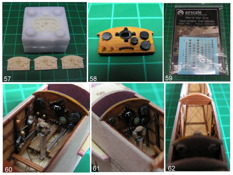

Ok then, on to the actual construction of the new ‘3D’ panel. The first task was to cut out the kit panel and use that to mark out a duplicate in 1mm plasticard. This will allow the replacement panel to fit exactly into the space occupied by the kit’s 1mm card backed original. Then, again using the kit piece as a guide I used a tiny drill bit in the pin vice to drill a hole through the paper panel and into the plasticard one beneath to mark the centres of each of the dial instruments as illustrated in Photo 44. A big jump then to Photo 45, which shows the completed panel against the paper version. The panel at the top is the rear face of the instruments – this is another optional add on part courtesy of the designer although it can’t be seen in the final model! The large grey dials are slices of model kit sprue whilst the yellowy clock dial is a slice of resin sprue from one of my earlier casting experiments. The ‘compass’ is built up from a slice of sprue cut in half for the actual instrument in the centre around which is set an ultra thin slice of aluminium tube. To prevent the tubing from collapsing under the knife blade I had to gently press the blade down with a solid wooden core inside the tube. Even then there was a little deformation of the tiny resulting ring and this was cured by passing the ring over a metal punch and sliding it down the expanding cone of the punch until it regained a circular shape again. Finally, a set of four slices from the Plastruct rod formed the gimbals. In hindsight however, they should have been ‘sticking out’ from the panel, and not flat on it. As you will see later, I remedied this for the final version and I may produce another master mould later on. The Tiltometer at the bottom was formed from a short piece of copper wire, curved over a suitable cylinder and hammered flat on the mini anvil before cutting it to size. Finally, the pair of Magneto switches were made by first stretching some sprue and then bringing the filament close to the candle flame to create a ‘bulb’ at the end. This was then cut off leaving just enough of the thin filament to create the switch lever. Two counter-sunk holes were drilled at the switches' location and the bulbs simply dropped into the depressions and fixed with a drop of liquid Poly glue.
The Master Panel is shown slotted into Pup No 1 to test the fit in Photo 46 whilst Photo 47 is a ‘group photo’ of all the cockpit items. As mentioned earlier, this was taken after I’d made the silicon rubber mould and as you can see, the lever knob, the pump handle and the tiltometer all got pulled off the components during removal from the mould – all easily stuck back on though.
Photo 48 shows the construction of the first experimental mould. This one was designed for resin ‘injection’ as illustrated by the cut down syringe on the left. This mould was a bit ‘over ambitious’ I’m afraid. What I should have done was a separate mould for the panel and another one for the rest of the instruments (with the instruments hanging down under the sprue not stuck on top of it). In actual fact I’d designed the mould with that in mind but got carried away trying to fit everything in and completely forgot that part! The walls of the mould are composed of good old Lego bricks bought on ebay (I’ve got hundreds of the ruddy things somewhere, but could I find them!) The blue base is a form of Plasticene called Scolaquip Colour Clay available from DWR Plastics, the on-line company I bought my resin supplies from, (others are available of course). The circular and polygonal holes are there to allow the eventual two halves of the mould to fix together. The circles were a paint brush handle and the polygons were the ‘universal holder’ part of my drill bits collection. Photo 49 is one of the early casting attempts. In fact, the very first one was even better than this with everything except the very top right corner of the instrument panel reproduced. The subsequent castings however were more like this one which is why I eventually settled for a separate panel mould. As you can see, not too bad but some problems with trapped air bubbles which is why the components should have faced down not up – any air bubbles should (theoretically) rise up into the sprue leaving the parts better formed. Anyway, eventually I had enough useable parts to construct a trial set of instruments as seen in Photo 50. This was just a trial set though and the actual ones I eventually used were better finished than these!BigGrin
In the next instalment, fitting my resin throttle and pulsator (with some alterations) into the cockpit.
Robin.

So now it was time to try and use my newly created resin parts. The first piece to try was the tiny little Pulsator. Before working on this however, fast forward to Photo 55, which illustrates the problem I’ve got with the basic paper/card cockpit. On the left is a shot of the actual Pup cockpit. As you can see, we have the vertical wooden frame and also outside of that the semi circular section, which gives the Pup its cylindrical front end. This goes from a complete cylinder just in front of the instrument panel to a flat box section back by the pilot’s chair. In the real aircraft some of this extra space is utilised for the controls and their connecting cables and pipes, in fact, at the top of this shot you can make out the edge of the Pulsator peeping around the frame upright – it is actually fixed in the ‘spare space’. On the model however, the entire cockpit is a box section shown by the light grey side and floor in the diagram to the right. The curved area is just an illusion, improved a little by the thicker ‘3D’ wooden frame and bracing wires. Experience has now taught me that you can’t physically fit a 3D object into an illusion – maybe on Gallifrey but not here! Both the Pulsator and the Throttle therefore had to get some ‘modification’ to fit inside. In other words, I had to sand them a little flatter! You can just make that out in Photo 51 which shows the three (soon to be four) parts to the Pulsator. The resin body has already been sanded down to flatten off the back surface and once done, two holes were drilled in, one in the front side to take the on/off lever and one underneath for the copper wire to represent the fuel pipe. The lever was a short length of brass rod, bent to shape and then cut to size before the handle part was gripped in a pair of flat pliers and squashed ‘flatter’. This is more evident in Photo 52 where the Pulsator has been painted – Humbrol acrylic Brass for the body with a thinned down orangey-brown for the fuel topped off with an acrylic transparent blue to represent the glass. This is where I had the brain wave!BigGrin I suddenly remembered that I still had some transparent sprue left over from the Spitfires and Hurricane’s canopies. The Hurricane sprue was almost exactly the same diameter as the glass dome on the Pulsator. The resin dome was carefully cut off and a length of the clear sprue cut away from the rest and one end sanded down into a dome shape. I then offered up the sanded end close to a candle flame until the heat just barely melted the surface removing the sanding scratches to leave a nice shiny finish. The sprue was then cut to size in the mini mitre box with the Exacto Razor Saw to leave the much nicer ‘glass dome’ shown in Photo 53. This was then glued onto the resin body using the Roket Card Glue to avoid ‘frosting’ the clear plastic and the final effort is shown in Photo 54.
The larger lever at the back was helped considerably by sanding off the three disks on the base before thinning down the actual stem and handle, the smaller front lever was sanded down from the back leaving the front detail intact. The two push rods connected to the levers were made of stretched sprue. Although in the photo here both push rods are inside the frame, on G-EBKY (which as mentioned is the main source of my reference material) the inner rod is actually in that curved area so I cut the stretched sprue and glued it in two sections either side of the wood veneer upright to give the impression of running behind it. The inner rod is a single piece and they are both joined behind the instrument panel by the petrol pipe (copper wire) from the Pulsator.
Now for that Instrument Panel! As I mentioned, the first over ambitious mould didn’t perform as hoped so I eventually settled for a much more simplified one as shown in Photo 57. In fact even this one got even simpler, as you can see this was originally a two part mould to allow the back of the dials to be modelled as well as the face of the panel. This proved too problematic as sometimes the resin flowed into the air vents behind the dials and sucked the resin away from the face! In the end I created the series of panels shown at the front by just pouring in enough mixed resin to fill the mould at which point I used a sharp cocktail stick to ‘twiddle around’ in the sunken depressions of the dials, switches and compass. This prodding has the effect of causing any air bubbles to float away giving a fairly consistent casting as seen here. It should be noted however that I did include a silly mistake in the master – I stuck the four plastic disks of the compass gimbals in flat when they should have been ‘on edge’! For the model I sliced off the resin ones and substituted correctly aligned ones from the same plastic rod. (I’ve since corrected the master and made a new mould!)Blushing Here I must apologise – I took a complete series of pics of the entire process of painting up the panel, Photo 58 is the sole survivor of that group – all the rest were corrupted in my camera ‘accident’. Anyhow, this photo marks the half way stage. As far as I can remember it went something like this:
The plain resin casting was cleaned up around the edges and sprayed with Poundshop Grey Primer. Once dry, it was then given a coat of Admiralty Yellow Ochre and while still wet a mix of Admiralty Wood (Walnut) and Revell Aqua Color Lufthansa Yellow was streaked across to form the wood grain pattern. When that had completely dried, the instruments were painted Citadel Chaos Black, which brings us to Photo 58. After that I used a thinned down wash of Citadel Rust Brown Ink to darken the overall effect followed by Citadel Skaven Brown Ink applied both in streaks for more wood grain and afterwards to add shadow around the instruments. The final paint job was to add Humbrol Acrylic Brass to the Magneto switches with more Skaven Brown Ink to accentuate their outlines. Then it was time for a little ‘splashing out’!Blink
Having gone this far it was silly to spoil the final effect with ‘blank’ dials for the instruments. Leaving them with a ‘glass’ of gloss varnish would have been acceptable but then I came across this set of WW1 aircraft instruments by Airscale as shown in Photo 59 and couldn’t resist them! The decals duly arrived and that was when I encountered a slight hitch. The decals are 1/32 scale and my paper kit is 1/33 so you wouldn’t think there’d be that much difference. Unfortunately, my scratch built panel was made out of suitable bits and bobs – suitable for the overall look of the panel but apparently slightly under sized as far as the instrument dials were concerned.Glare
This meant that the decals were therefore slightly too big! Airscale also do this set in 1/48 scale, which might have looked all right, but there was only one sure way out of this dilemma. I had to scan the decals on my computer and use the Corel Print House program to reproduce them down to about 90%. I could then print them off onto a sheet of white inkjet decal paper, give them a couple sprays of clear gloss lacquer to seal them and then I had a set of instrument dials that could fit my own resin panels. The real downside to this however is that I then had to very carefully cut out the new decals – the Airscale sheet itself is composed of separate decals – no cutting out required! The tiny decals were applied with Humbrol Decalfix solution onto the panel which had already had the matt black dial positions gloss varnished to maximise the decal grip. When dry each one received a drop of Micro Kristal Klear followed when set, with a drop of clear gloss varnish to simulate the glass. Photos 60 and 61 illustrates the final effect and I have to admit, I’m really pleased with the ‘look’ of the panel after all that. Finally for this instalment, Photo 62 is a ‘look back’ through the open cockpit area. The first wooden cross piece on the floor is that step down where the extended cockpit floor ends. As you can see from this view, the illusion of the floor continuing back seems to come off ok. The top part of the old card bulkhead has been replaced with real wood and if you look at the left side there appears to be a blemish on the surface. I thought it was a bit of rough wood, which needed further sanding which it received. It looks fine now, but it turned out to have been a tiny trace of the Roket glue which must have got onto the tweezers I was using to carefully align the wooden part after gluing it in! Must watch for that in future!BigGrin
At this point I did temporarily fix the fuel tank pump in place but had to yank it out again after realising that the wicker chair wouldn’t fit down in place with it installed. Once the chair was down I then discovered that the pump wouldn’t fit in either! That’s the subject for the next instalment!
Robin.

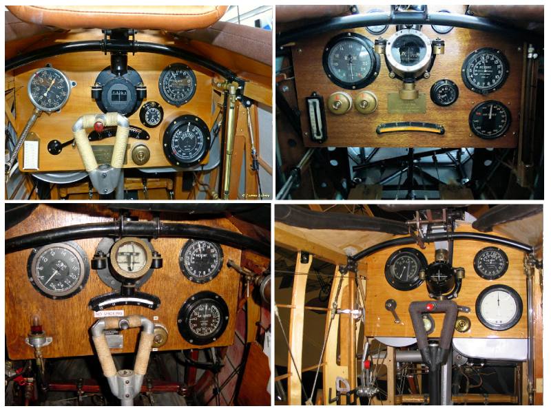

Great work on these parts... I was curious though... I was looking at the pic of the instrument panel and there are 2 gauges above the compass. What where those for? You didn't put them on the panel you made... Hope I didn't make more work for you.

You're right there Ron, fortunately it doesn't mean more work (at least not on the instrument panel!) As you can see in the photos below, the instrument layout of the Sopwith Pup was not exactly standard! Each of these is a Pup cockpit and each one is slightly different! You have to be very wary during research on WW1 aircraft. Very few actually survived to the present and many of those seen flying today are actually reproductions. The problem is, build a Pup today and you have to include all the modern safety regulations to get it passed to fly. The top left photo (copyright James Fahey) is possibly one of these as the instruments seem like modern versions of the originals. The other three I suspect are genuine but again all are different. As for those two extra dials, one I'm almost certain is the Fuel tank pressure gauge, used to check the result of pumping up the air pressure with the big brass pump (coming soon, mine is a separate dial fixed on the port side fuselage frame) The only other original WW1 era dial I've managed to find is an Air Temperature Gauge so I suspect that's what the other one is. Not sure if my cockpit has one of those, there were also subtle differences between the RFC Pups and my own RNAS ones. I did find another repro Pup with three extra dials - one for Battery Charge, one for Oil Pressure and the last for Oil Temperature - again modern regulations, the original Pups had none of those! What is the same on all four photos however is that tubular curved metal support - I haven't got one of those in mine, these are all Vickers Machine Gun armed, mine has a diddy Lewis!
