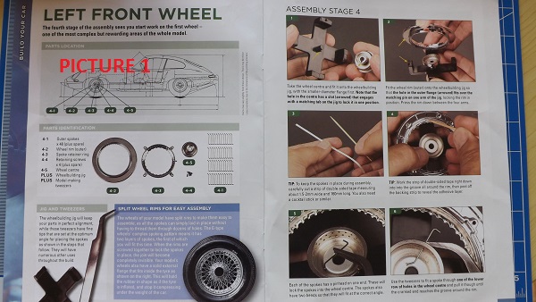

PICTURES 1 & 2
Here we have the build instruction pages from issue 4. Of note this issue is the fact we have a more complex build to work on and this is reflected in with the instructions covering 4 pages for this edition.

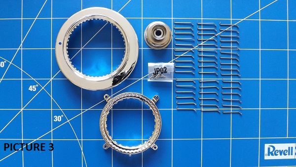

PICTURE 3
This picture shows each of the component parts we receive with Issue 4 (again this is from the TEST so there may be some changes with the full subscription Issue 4 Parts). In my test pack I had just the required 48 spokes for this stage and no spare. Not an issue to be honest.

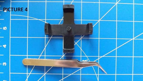

PICTURE 4
Here we can see the jig upon which the wheel will be constructed. This issue we are also provided with a pair of tweezers to allow us to work on the spoke section.
I personally found the tweezers supplied rather springy and needing a fair amount of pressure to keep closed. As I have a bit of an issue with my fingers I opted to use a pair from my own tool kit.

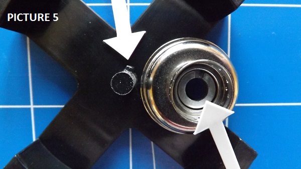

We need to place the Wheel Hub onto the jig and to ensure the lines up correctly the jig and the hub itself are both keyed with a peg on the jig and a slot on the hub. Make sure that these align when matching the 2 halves together.

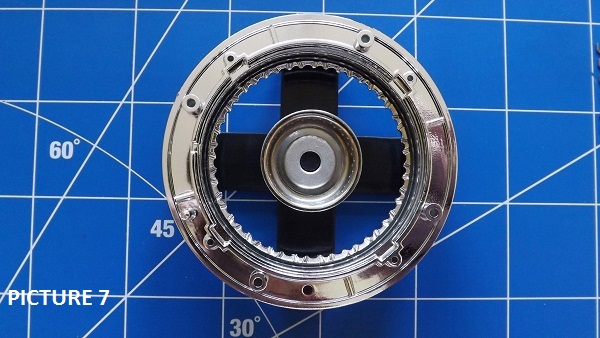

PICTURE 7
And once both parts are aligned on the jig this is what it looks like. At this stage you are now ready to start inserting the individual spokes. well.

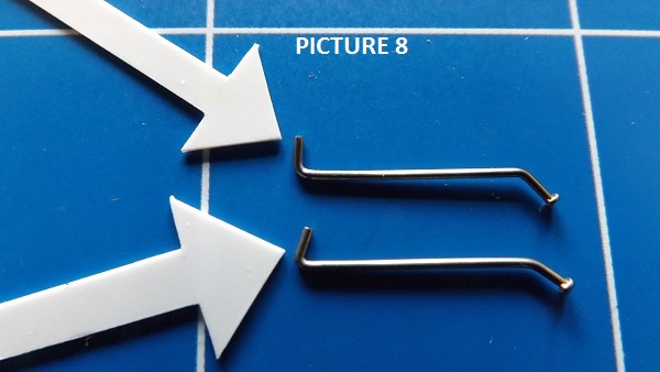

I noticed in my trial parts that some of the spoke ends are slightly more bent over than others.
This had not detrimental effect on my assemble other than finding were the end is not at 90 degrees it does make inserting the spoke through the hub a little more difficult as you have to insert the spoke and then angle it to get it fully through the hole. If you have an issue here nothing stopping you from adjusting the angle on the end of the spoke with a small pair of pliers.

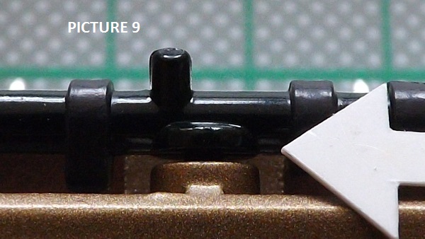

PICTURE 9
“PROCEED WITH CARE”
Picture 6 on page 13 of the build instructions appears to show the spoke end pointing towards the right.
WHILE IT DOES NOT STATE TO INSERT IT INTO THE RIM IN THIS ORIENTATION IN THE BUILD INSTRUCTIONS JUST ENSURE YOU DOUBLE CHECK HOW THIS PART DOES FIT THE RIM FROM THE NEXT SET OF PICTURES IN THE INSTRUCTIONS.

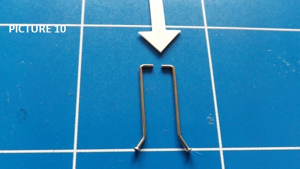

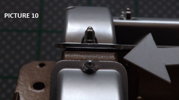

If you look at the ends of these spokes for each pair inserted into the hub you want to ensure you always have 2 of the bent ends facing.

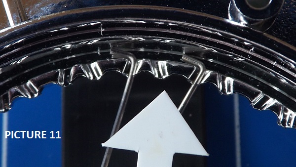

PICTURE 11
As you start inserting the spokes into the lower set of hold on the Wheel Hub bear in mind that its “SPOKE”, “MISS ONE” “SPOKE”, “MISS ON” all the way around the slots in the Wheel Rim.

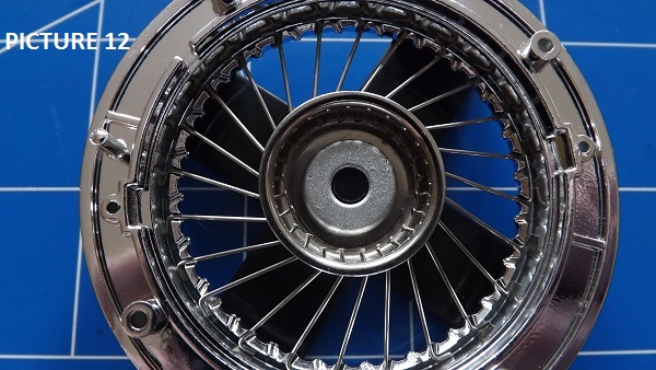

PICTURE 12
This is the wheel after inserting the first row of spokes. So onto the second layer.

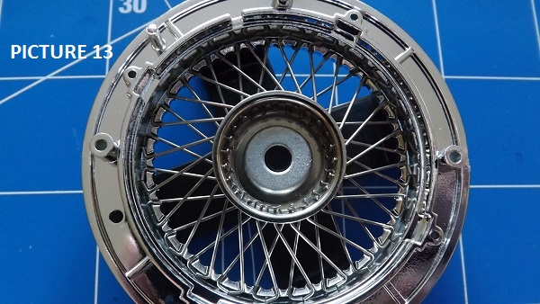

PICTURE 13
And having inserted the remaining 2nd layer spokes this is the effect.

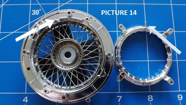

We now have to prevent all of the spokes coming free and for this we are provided with a Spoke Retainer Ring.
This part is again keyed with a TAB on the Retainer Rim and a Slot on the Wheel Rim.

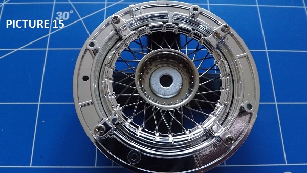

PICTURE 15
Carefully check that all of the bent ends on the spokes are correctly in place and then lower the Retainer Ring into place.
It gets secured using 4 of the 5 supplied screws from this edition. Again remember that you are screwing into plastic so do so with a light touch to prevent damage to the plastic part.

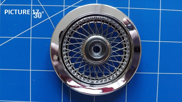

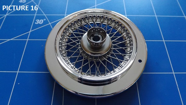

PICTURES 16 & 17
And having removed the assemble from the build jig this is what the first half of the wheel looks like. And I must say it looks very smart indeed.

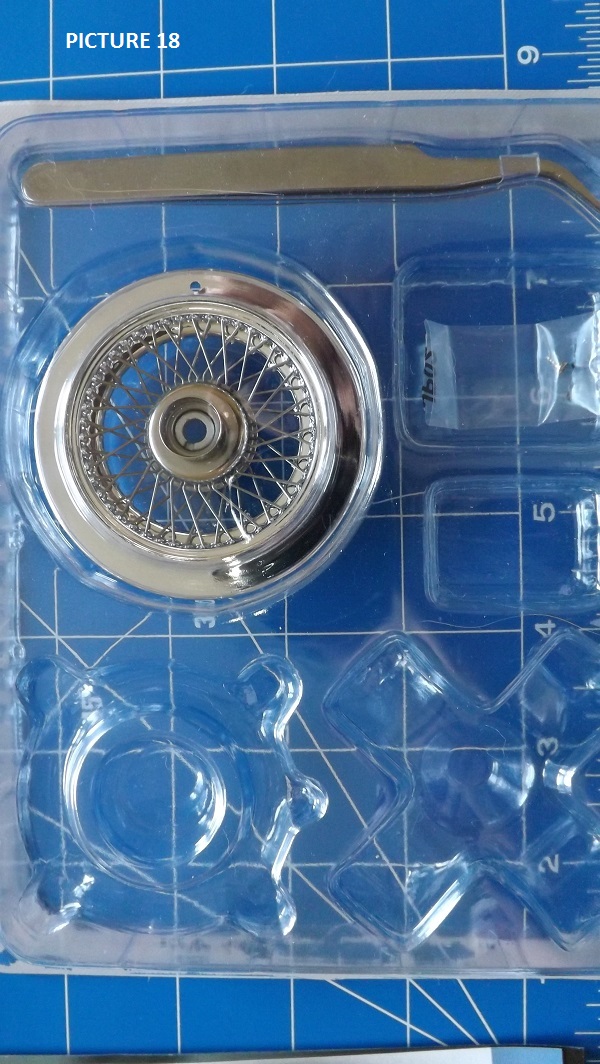

Ensure that you pack away the wheel assemble you have been working on along with the tweezers and build jig in a safe and secure place until its required again.

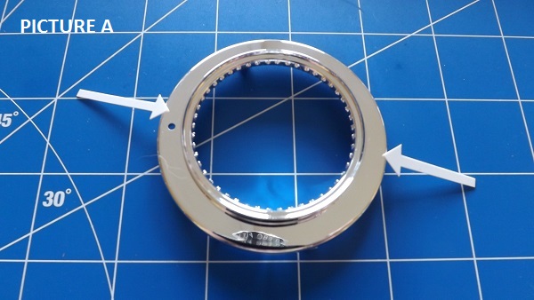

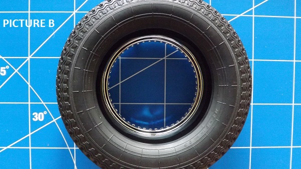

Just for interest it’s worth noting that the large flange around the wheel rim as indicated in PICTURE A will actually disappear from view once fitted into its matching tyre as shown in PICTURE B.

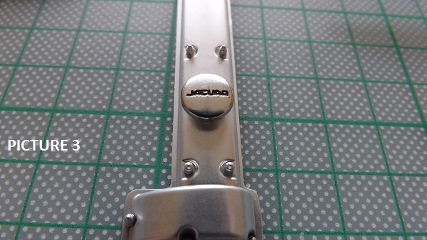

PICTURE 1

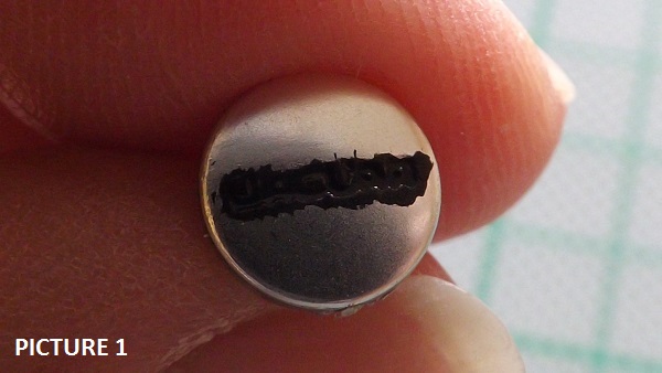

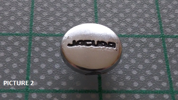

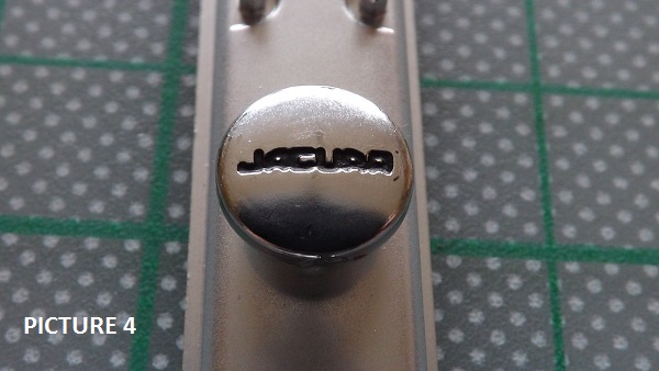

The first part that has seen a change is the Oil filler cap which sees the locating tab being in a different position meaning that when installed the JAGUAR logo runs across the cam cover.
There is some fairly decent depth to the Jaguar lettering on the oil filler cap so I thought it would be good to bring out this detail with a little paint.
“PROCEED WITH CARE”
If you should decide to follow me with this slight enhancement, please ensure that you use nothing more than a water based paint to infill the lettering. Anything that involves solvents is highly likely to destroy the chromed finish on this part so proceed with care.
PICTURE 2
Having given the water based black paint a few moments to settle I used a cotton bud to remove the excess paint leaving it just in the recesses of the JAGUAR name.
PICTURES 3 & 4
And this is what the oil filler cap looks like once screwed into place on the cam cover

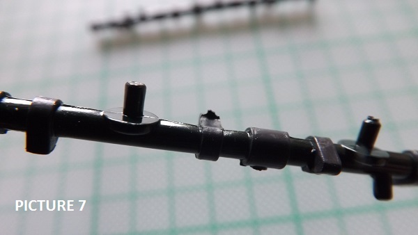

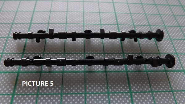

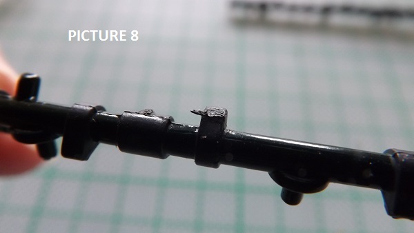

PICTURES 5, 6, 7 & 8

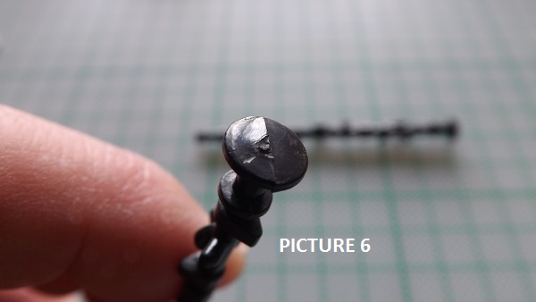

I was somewhat disappointed with these revised can shafts. They have been changed in that the cams themselves are not all aligned in the same direction as was the case on the test parts.
However, in my example there is a significant amount of flash on the parts (easily cleaned off with a small file), but slightly more disappointing is the fact that one of them is a very loose fit in the engine mounting and the other has one end that will not fit flush into the hole in the engine part.

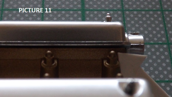

PICTURES 9, 10 & 11
The issue with the cams not sitting correctly has a knock on effect in that when the Cam Covers are pressed into place the do not sit correctly and a gap is left between the cam cover and the engine mount.
At this stage the correction would be the use of spot of CA glue but as I do not know how these parts will interact with future instalments I do not want to start gluing things at this stage only to cause myself issues later on.

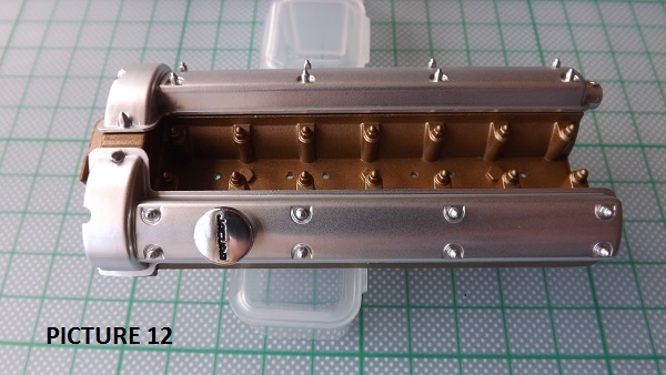

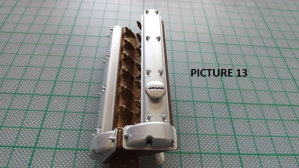

PICTURES 12 & 13
This what the result of this part of the build looks like. I rather like the way the painting of the oil filler cap has brought out the detail on that part.

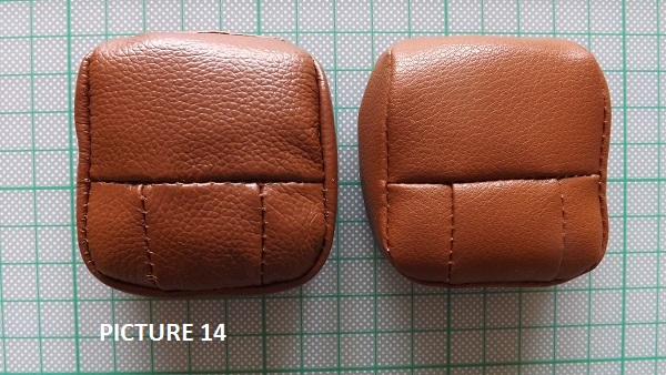

Also included with this particular issue is the first seat cushion. In this picture you can see the original test part on the left and the revised part on the right. Apart from a difference in the grain of the material being used (the revised part being much finer) and a very slight colour difference there is not much to say about this piece.
It’s just a case of storing it away for now until its required later in the build.

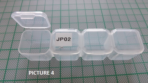

As we progress with the build chances are that we will build up quite a collection of spare screws that are provided with each instalment.
Chances are that once you have screwed a part together you may never need that spare that has been provided. However, if you are like me you will never throw away parts like this because you “never know when they might prove handy”.

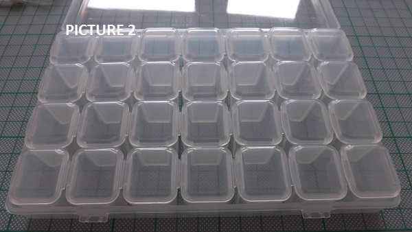

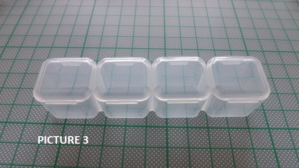

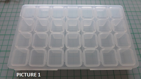

So what I have purchased is one of those “7 days 4 a day” pill storage boxes.
This one does not have the usual “mon, tues, wed etc.” lettering so suited me better.
With this one end up with 28 individual little compartments in blocks of 4 each with its own little cover.
What would have been nice would have been some dimensions adding to the screws being used because chances are over the coming weeks many of the screws we will use in this build will be the same size.
It seems the screw pack naming convention in each issue i.e. JP-02 probable means “JAGUAR PACK – 02” so that is how I have started to label my storage box but may change that later as the build progresses and we end up with more spare screws.
Pictures 1 – 4 shows the box I have purchased (my earlier version saw a refund being given as it arrived damaged in the post but luckily I was able to track down an identical version to replace it.

While they have changed the cam shafts in the new release if they are never to be seen under the covers i may just revert to using the old ones as the fit was a lot better.
Its a case of waiting to see how it all shapes up over the coming months without rushing in and making changes that could cause problems later. BigGrin

Looking good with the box for the screw storage.
Just one point I cant say that I have ever bought a kit that has needed some sort of rectification of parts such as your Adler build which has major filling/gap problems.

The cam lobes differ from the test because they are closer to accuracy than those of the test. Also the, the seat cover of the test was faux leather, the launch version is real leather.
