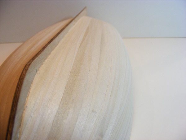

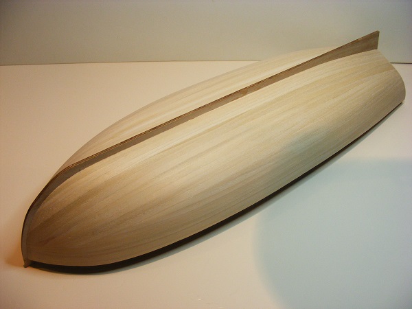

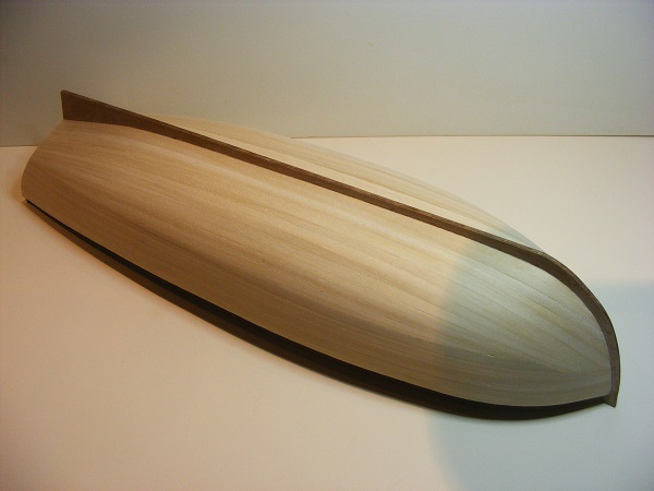

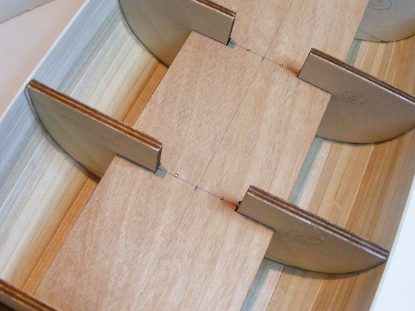

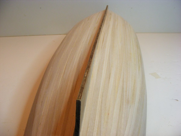

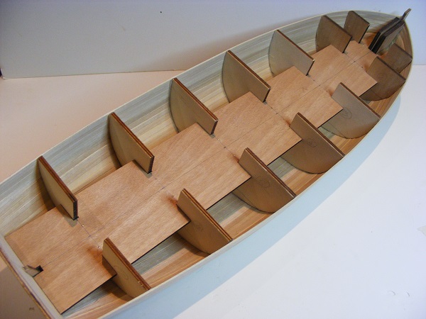

Managed now to progress this build some more with the completion of the first layer of planking. Considering the planks are not glued to the ribs at all but only glued at the stern and bow ends, I am very pleased to see the hull has retained the contour very well.... Have also sanded the outer hull ready for the second layer of planking to be added. The second layer shouldn't take as long as I now have a base to work from. First layer of planks used 1.5 x 6mm strips with the second layer being a little wider at 1.5 x 7mm strips. Will update again very soon....Cool Cool

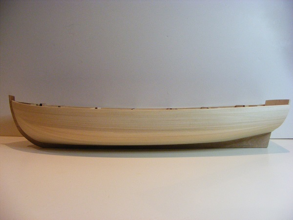

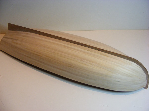

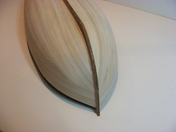

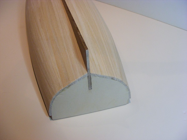

#56 Posted : 30 April 2017 09:21:27
A lot of work done laying the second layer of planking and a short update of the progress. Most of the sanding process has been done, still some minor imperfections to put right, these will be revealed when then the outer hull is primed. Cool Cool. Next job is to now cover the keel....Cool Cool
