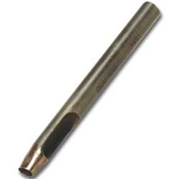

Clear decription Malc. Very useful help!
I saw on NsxKidd' topic (i hope is a right think) that he painted to simulate this clamps.
To make the 3 holes is possible to use this tools?
#46 Posted : 03 February 2017 13:27:52
@ frah2o, yes that's an idea to use a hole punch like the one you show. Put the piece to be punched on a hard wood ( or Aluminium ) surface and you should get a clean cut. With such a thin plate there may be some distortion. I suggest that you experiment. Maybe try a strong adhesive tape over the part and punch through the two. BigGrin Malc.

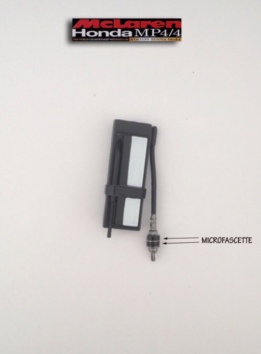

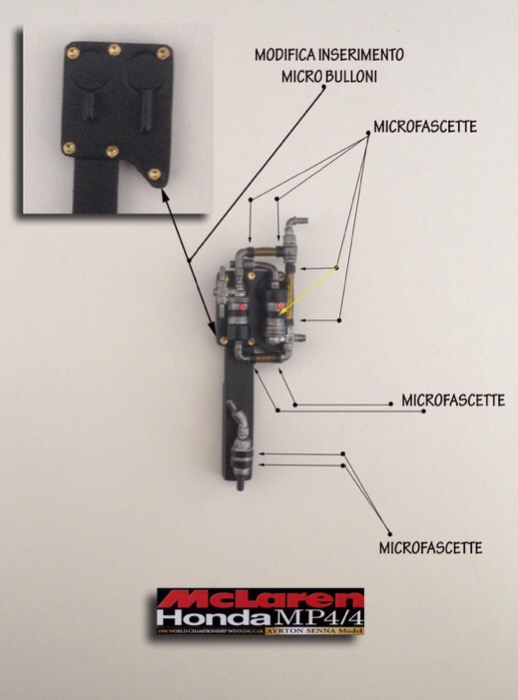

improving control units and battery
maurizio67 attached the following image(s):

the question, which tool you used to make the hole to the inside mesh radiator?
#55 Posted : 17 February 2017 06:30:26
I used a hole punch like you've shown in post #45 above. Choose the same size as the hole in the plastic part. This is illustrated in post #65 in my build diary. Use a wooden block to support the mesh.
I hope that's of help.BigGrin

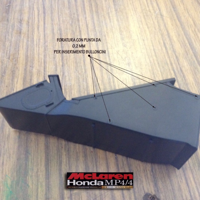

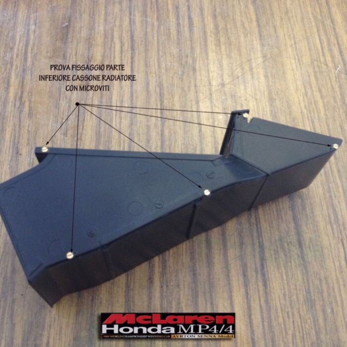

Some advances until the next exit, evidence of the mounting box cooler with micro screws, and holes for inserting bolts photo engraved, the box will be coated with carbon.
