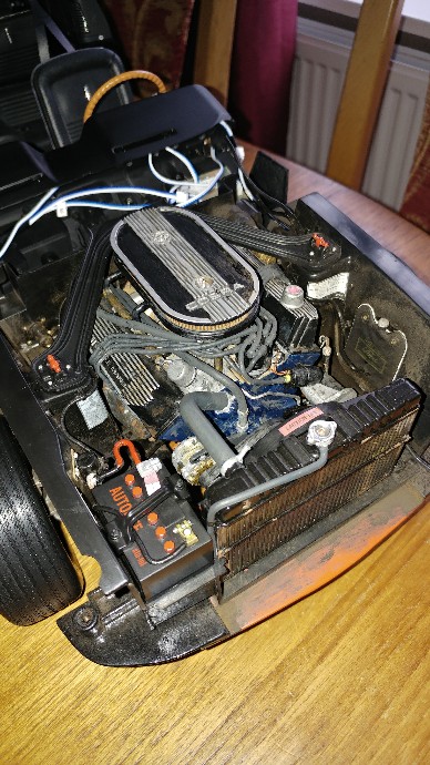

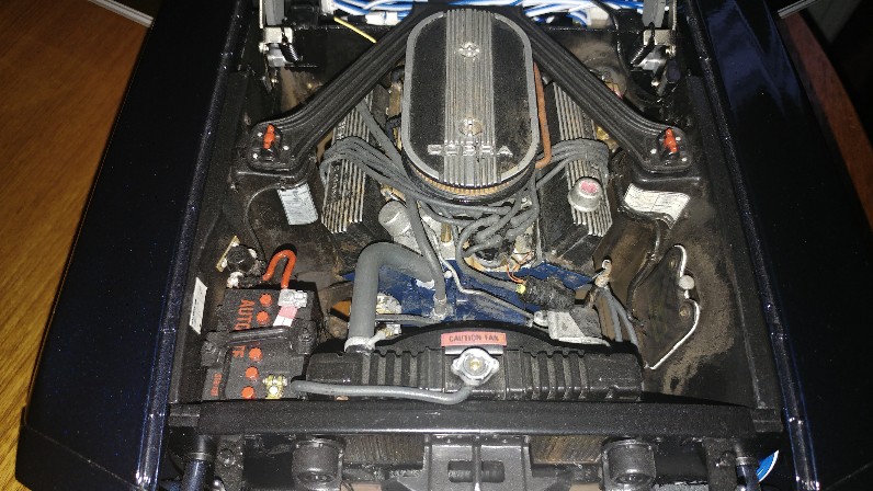

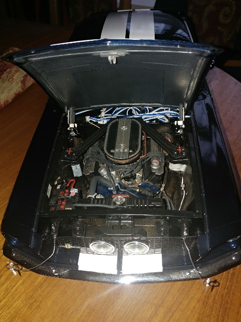

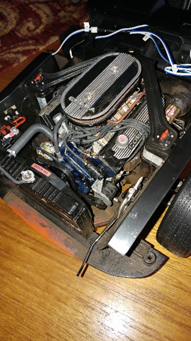

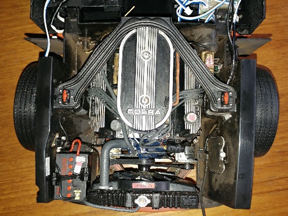

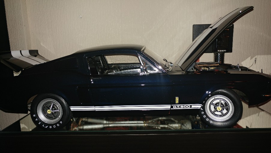

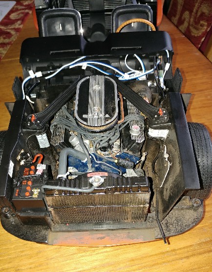

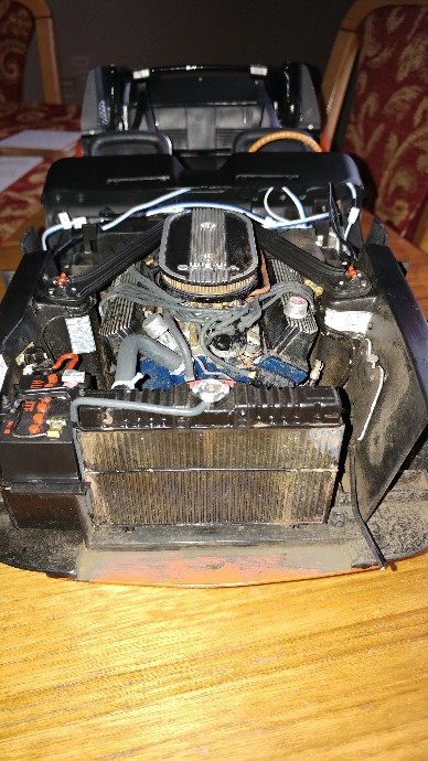

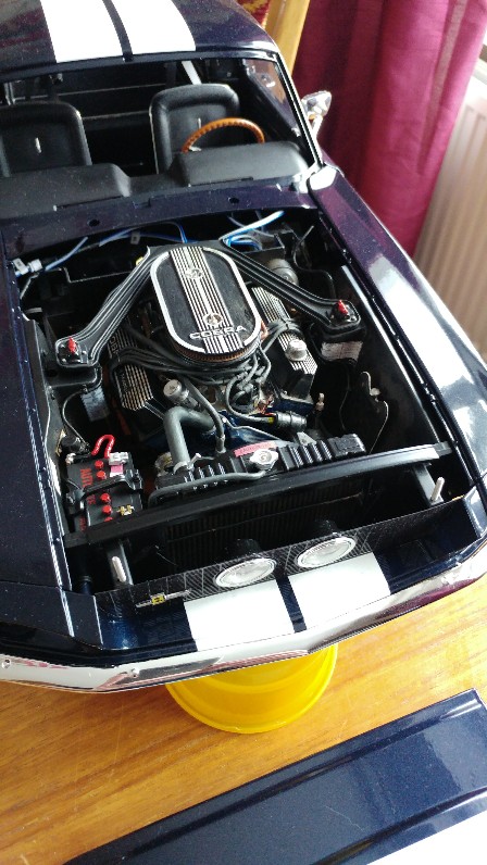

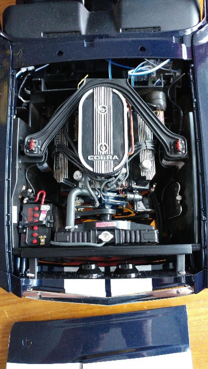

Hi all
Engine is now in the engine bay permanently but only problem I've noticed is the decals are a little too big but I can live with it.
I've relocated the circuit board and waiting on a replacement board as it had W1-7 missing but I can use this board for the interior lighting.
Really can't wait for the body to turn up as it's due anytime this week and it can be test fitted.
P-Lother attached the following image(s):

Really looks something specialDroolCool looks excellentDrool well done so farBigGrin regards PhilCool
#46 Posted : 05 September 2017 14:56:46
Nice work.Love
#47 Posted : 06 September 2017 18:55:42
The engine looks fantastic now its attached to the chassis. All the weathering really brings it to life. Love it Cool Cool

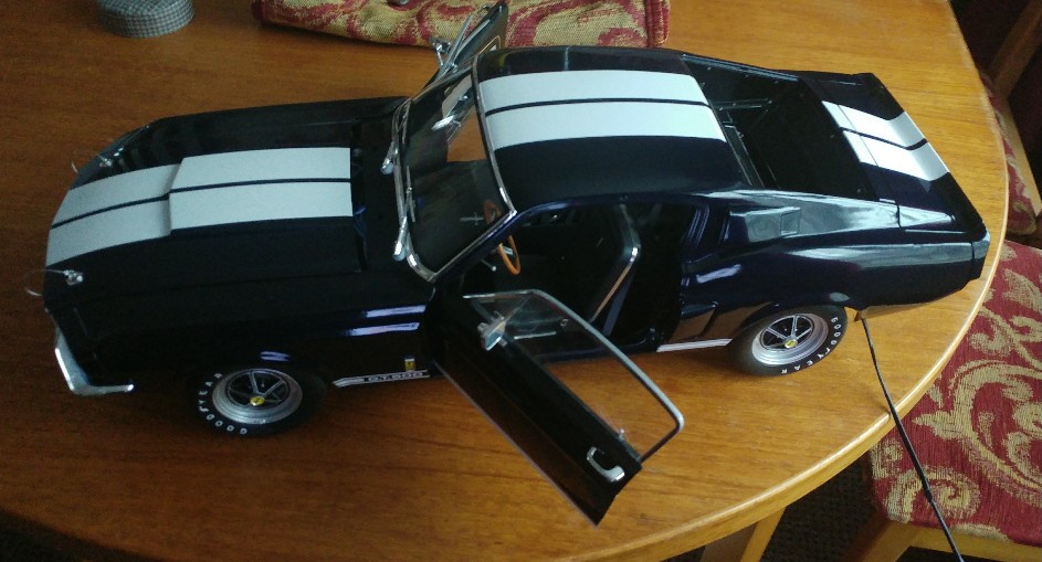

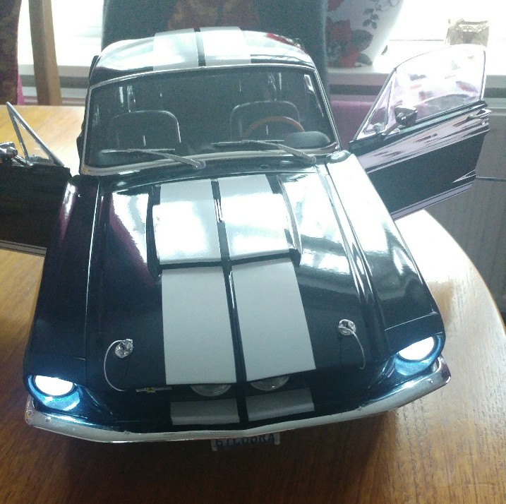

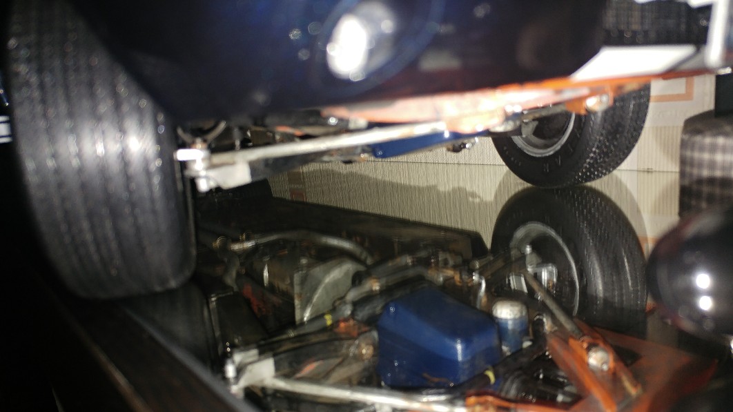

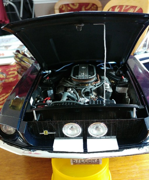

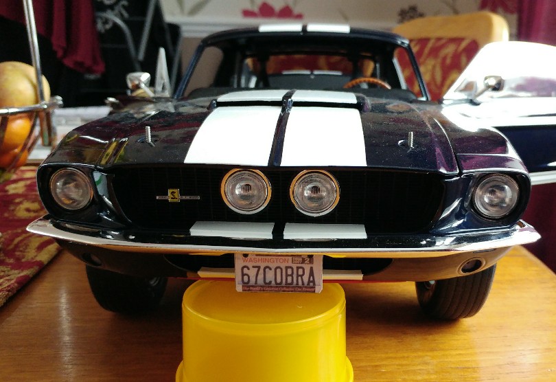

Hi all once again
The body turned up and it looks great but with all the work I've done the front wheel hubs got damaged a while ago and needed jb weld to repair them I knew they needed replacing at some point one snapped few weeks ago and now with the body on the other side snapped so now waiting for back issues to arrive.

Nice job. Shame about your wheel hubs but unfortunately these things happen now and can. Won't be long until the replacements arrive BigGrin Cool
#50 Posted : 14 September 2017 22:03:47
Impressive work, looking fab....Cool Cool
#51 Posted : 14 September 2017 23:42:14
Some very detailed and skilled work you have added to your build.

#54 Posted : 07 January 2018 22:24:34
Joined: 19/11/2016
Posts: 133
Points: 404
Location: North Carolina, USA

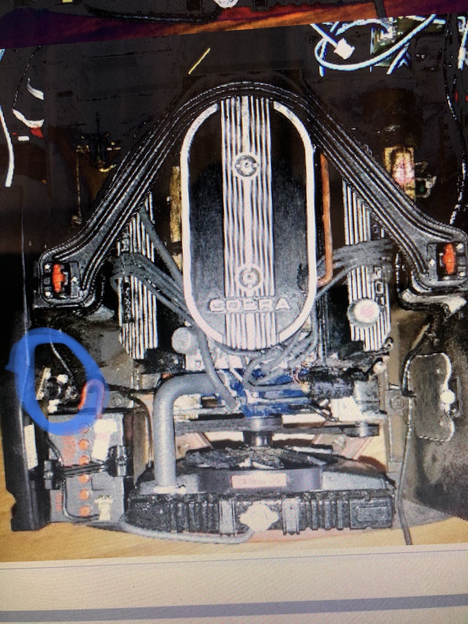

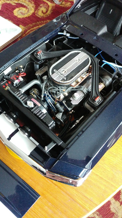

P-lother, where did you get your starter solenoid switch?
See your photo with part circled in Blue. And great authentic look on belts and hoses. Would you mind sharing how you got the authentic look? Thank you for any information on starter solenoid and hoses, belts.

Hi rich
I used very thin copper wire, thin card, 1mm nuts and for the main part of the solenoid was cut from an old cheap plastic paint brush I cut up and sanded to shape.
For the engine belts that came with the model I just painted the pulleys gloss black and used 1200 grit sand paper on the balts for a matt finish and for the hoses around the engine was from different thickness of electrical wire painted humbrol gray and left for 1min and went over with a dry brush to create a dull finish.
Phil

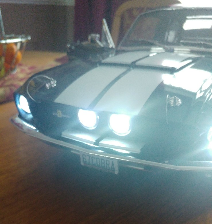

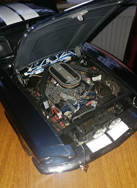

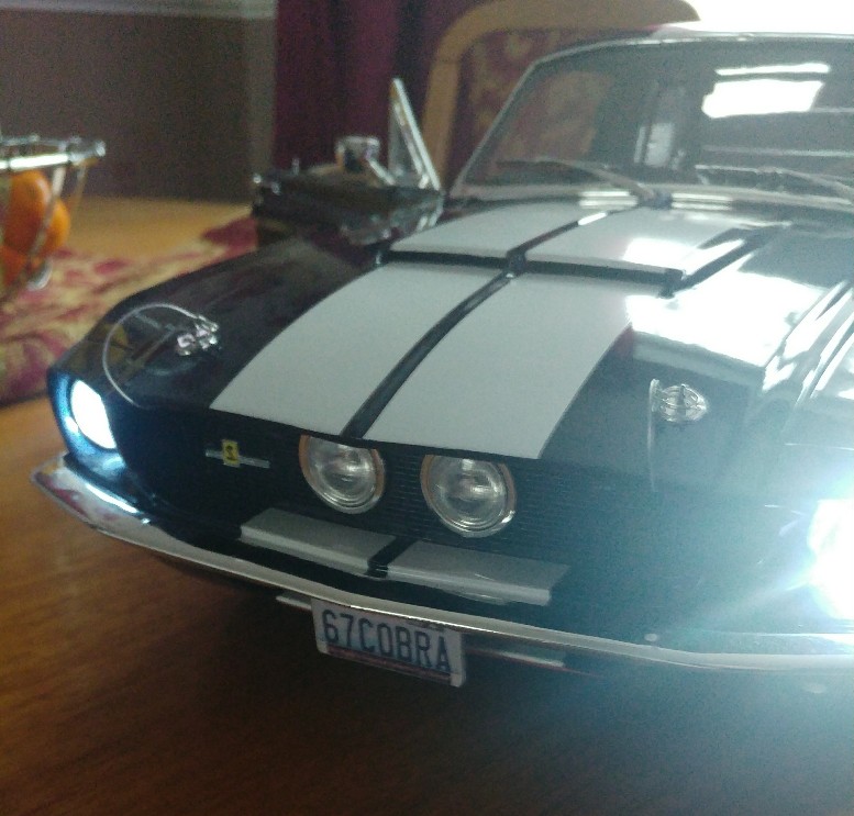

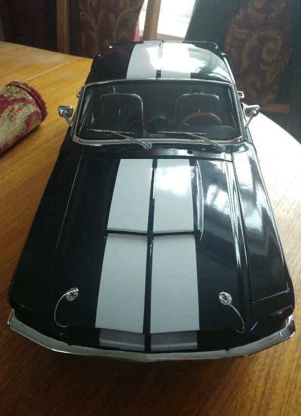

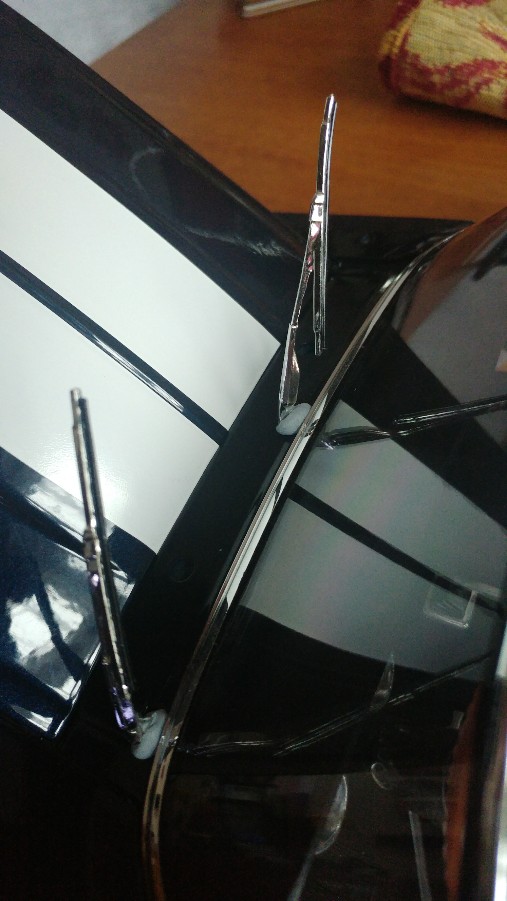

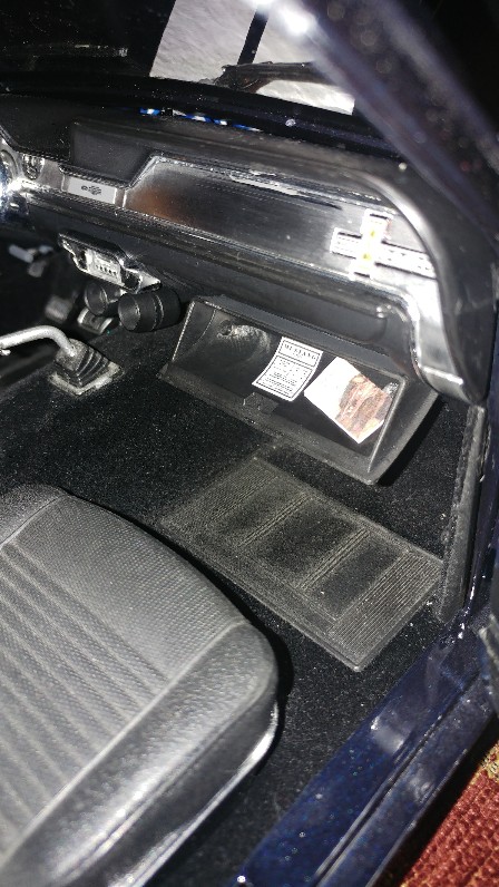

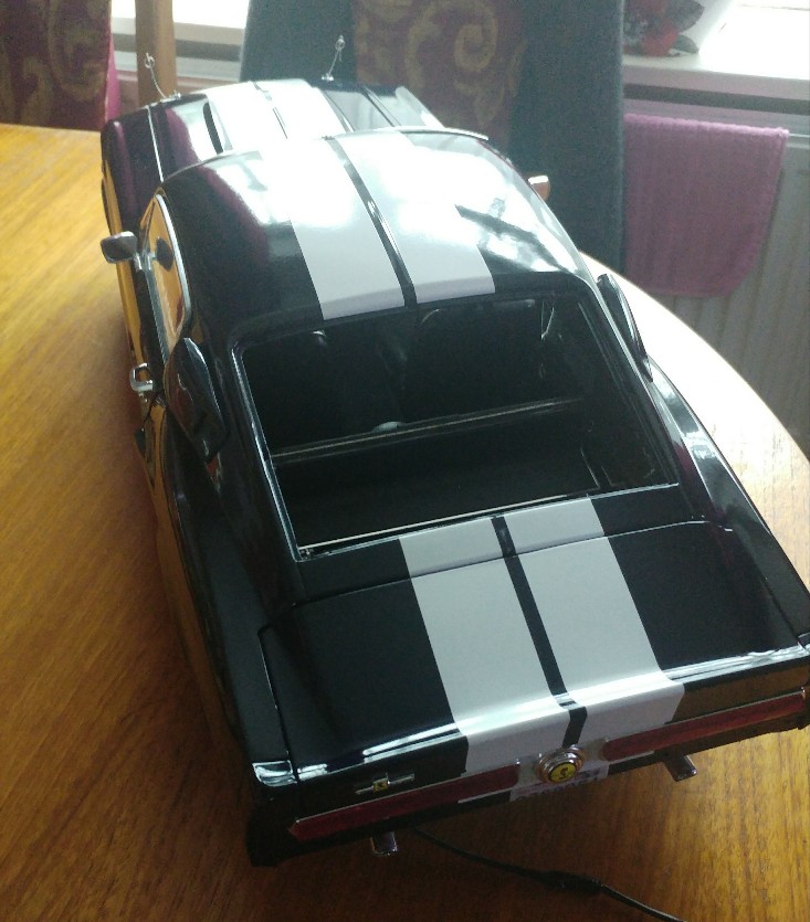

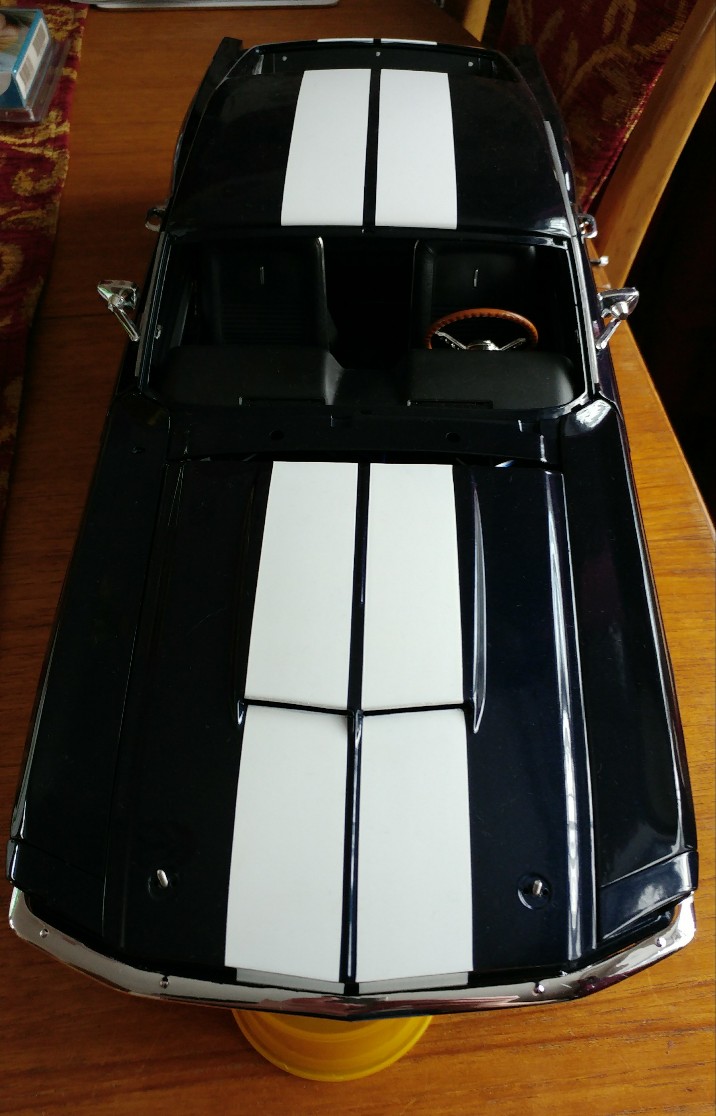

Hi all

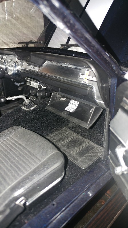

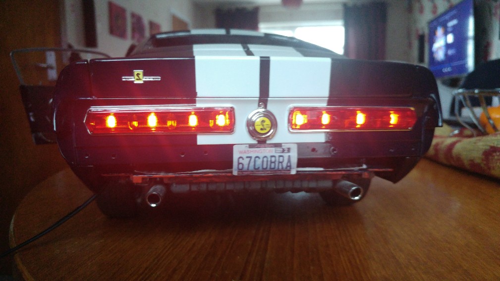

I've been busy so not done much through Xmas so I had a pause and fallan behind a little issues 93 to 96 should be here next week.
I've wired up the lights so It can be used on the batteries or mains
The front center grill lights work as high beams when the horn pressed
Added some more decals around the car plus owners manual in the glove box
Added wiper blades to the wipers
