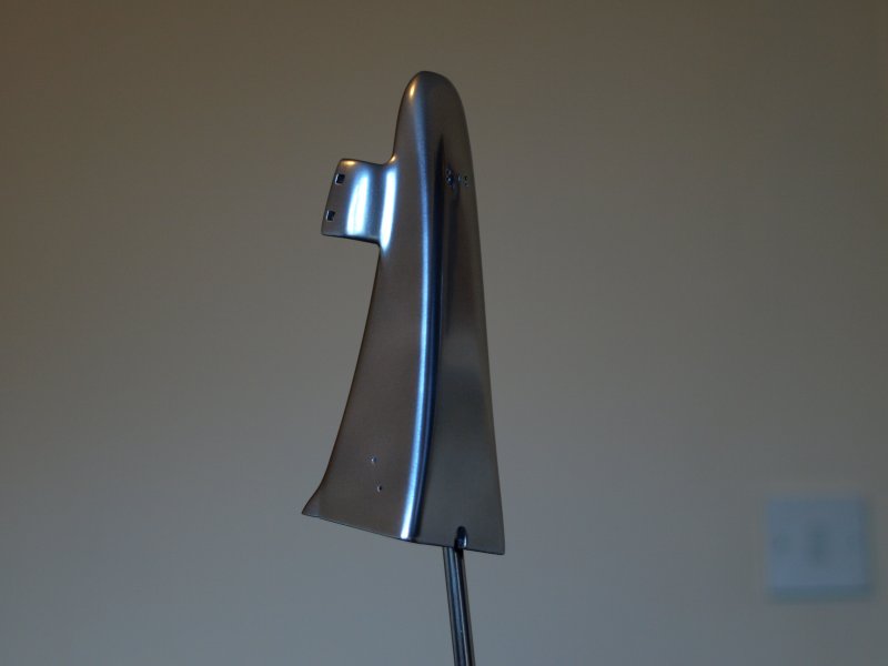

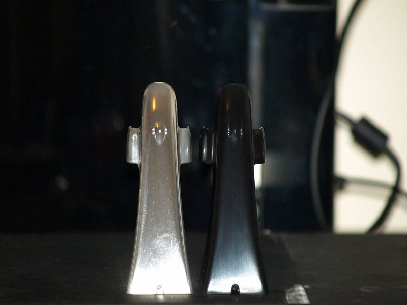

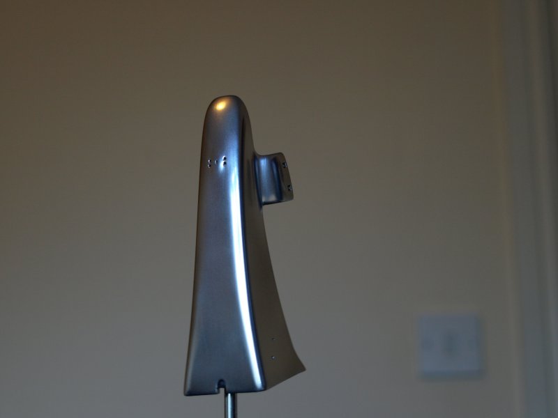

Ok I've been trying my hand at a few different attempts at "Chrome" on the nose section and although i've not fired up my air brush as of yet, I do have a bottle of "Testors" Chrome Metalic to try out. In the meantime I tried something just to see how it came out and I'll leave you all to guess what it is that I used. If I succeed with this effect then I'm going to have a major job on my hands doing the whole model with this stuff!!! Anyway I hope you like the effect so far and any suggestions or comments will be appreciated...

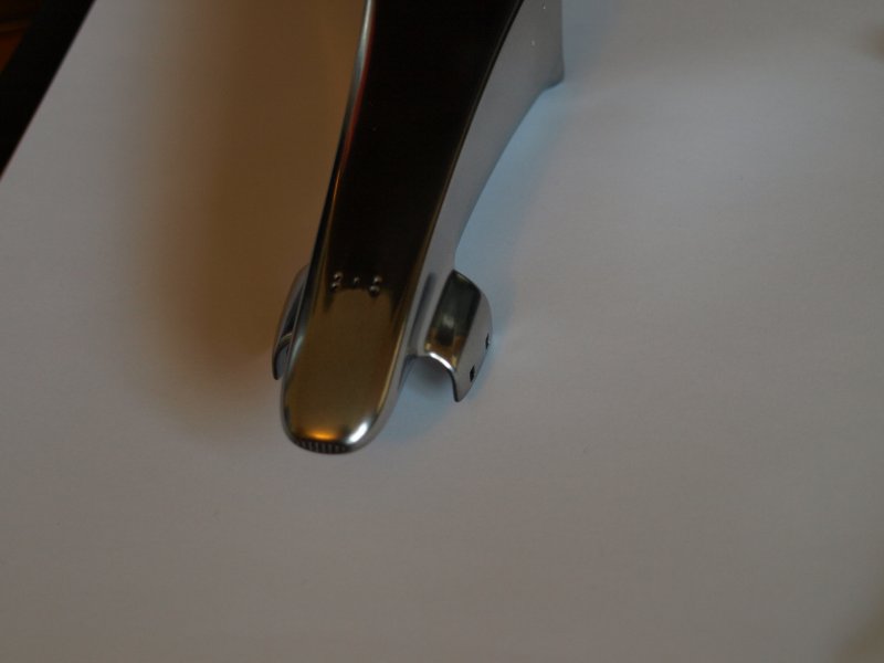

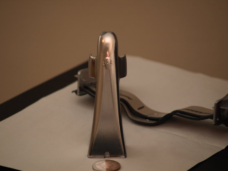

Here are a couple of photo's using Alclad2 Chrome.. I must say this is the one I am going for as the photo's don't do it any justice...
I used my Aztec airbrush and compressor at 15 psi to get the best finish. I could probably get it better but i think i might quit while i'm happy with this one lol..

Hi Spencer, that looks really good, i used to work for a company that chrome plated plastic, been in touch and going to see what we can do[poss black chrome] as i think it would be more like the real thing then silver paint is. I take it your now going to have to re do all the work you did on the front wing ?
When i look at the carbon on your front wing it looks black, i have used black on pewter and it looks to gray to me !! which one have you used ?
Keep up the good work

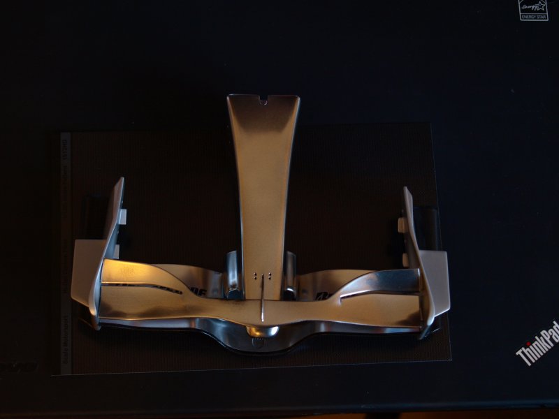

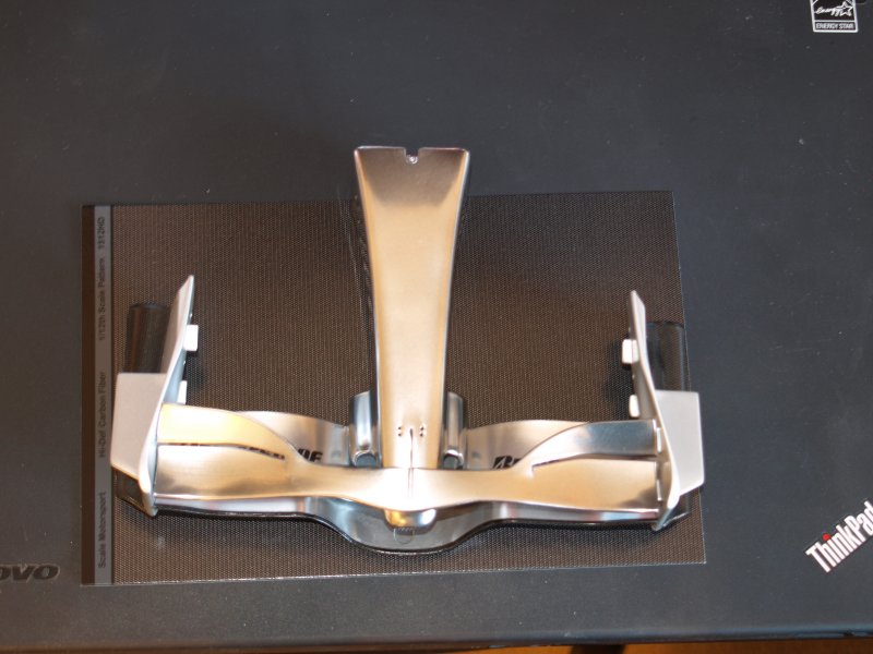

#60 Posted : 10 May 2011 21:23:20
Hi Glen
As you can see from these pictures I should'nt have to do anything to the wings as I have been aiming to get as close a match as possible. I think I have managed that BigGrin
As for your carbon decals you will have to let me know which ones your odered?? so I can see. Give them a coat of Tamiya "smoke" to dull it down a bit.
All parts are loose fitting btw
