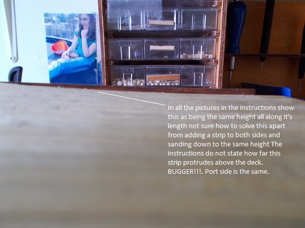

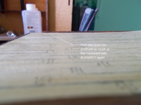

Just got pack four and have a problem with the fittings of the two Bow gun ports.
eebygum attached the following image(s):

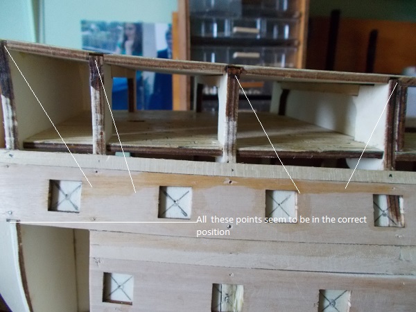

#47 Posted : 20 September 2016 11:53:46
Hiya, It is around 5-6 mm above the deck line showing. I will have a look through your pictures when I get them to load and see if I can see where the problem lies. Otherwise it would mean adding a plank in. But wait until I have looked before you do.

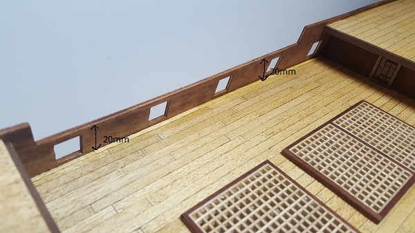

Now you have all the Parts for Pack 4, If you look at stage 34 and temporarily fit the next gunport strip. Measure from the inside of it from the deck to the top and let me know if it is 20mm at both ends of the lowest point.
eebygum
#50 Posted : 20 September 2016 20:22:00
Joined: 18/08/2015
Posts: 294
Points: 897
Location: Amesbury, Wiltshire
Yes both sides are 20 mm at both places.

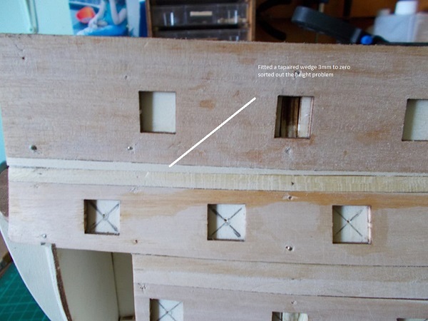

#54 Posted : 22 September 2016 13:00:54
Joined: 18/08/2015
Posts: 294
Points: 897
Sorted out the forward gunports thanks to a lot of help from Chris (magpie1832)
thanks again Chris
#55 Posted : 22 September 2016 15:53:41
BigGrin Nice fix Terry looking good Cool
#56 Posted : 22 September 2016 15:54:46
Watching this build with interest.Great job so far
#57 Posted : 22 September 2016 18:46:26
Very well done Terry, nice to see you're back on track with this one....Cool Cool Cool
#58 Posted : 22 September 2016 20:54:30
BigGrin Nice work, although where the gun port hits a rib you could have marked the gun port and then rebated the rib so the gun port blank slides in side ways to fill the gun port neatlyCool
