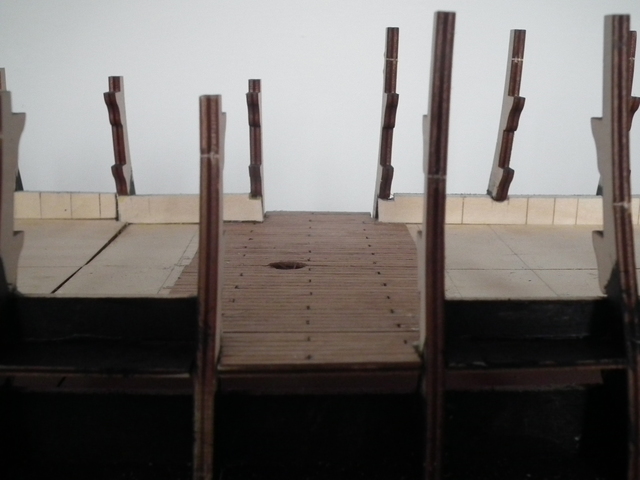

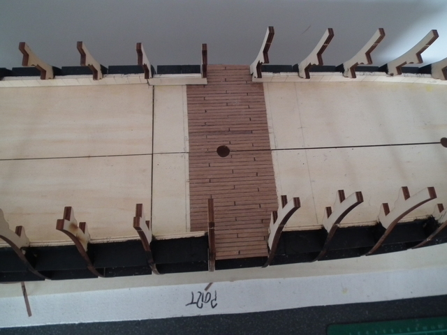

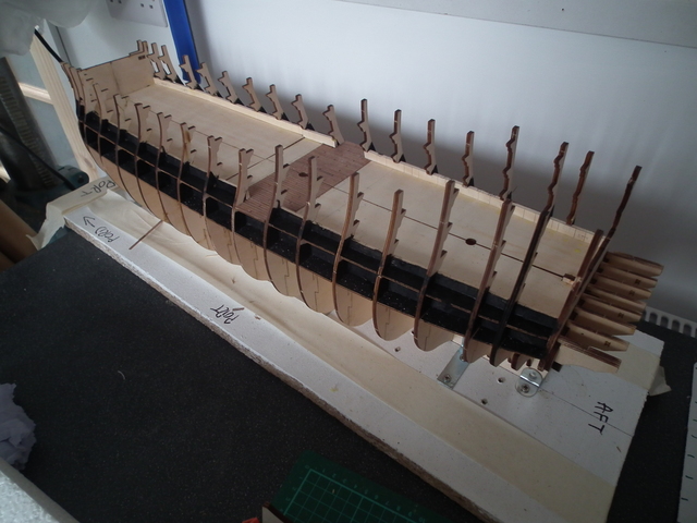

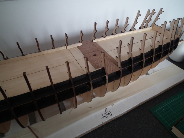

So the middle gun deck is now fitted, complete with planking around the area visible through the entry ports. I realise there should be margin planks at the deck edges and proper arrangements around the mast opening but I think it looks better than drawing lines on the deck so at least I'm happy with itBigGrin
It also gave me some practice for later!
The forward port corner of the middle deck looks a bit high when viewed from the side; I think some of the original "warp" returned during the period the glue was drying. I don't think it will impact on anything else because the hull planking (which starts curving up towards the bow anyway) will hide the deck edge and I'm not aware of any other structure that relies on the middle deck being perfectly flat all over since we build off the ribs. If I do need to sort it I will have to do so before planking the hull but I don't really want to start sawing the warped area of deck and re-fixing it unless absolutely necessary.

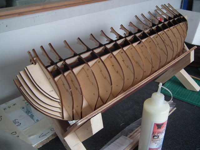

The hull is now off the building slip and sitting on her new stand as I start fairing. I didn't realise how much sawdust could come from a model ship, and that's just at the start - plenty more to come!

Yes, and you may want to keep the sawdust for latter filling, if any.
Nice work Gary and make sure you don't skimp on the next stage. I glued 3 planks together to see the run run along the whole length of the ship. If it doesn't look right in every position it won't look right when you finish planking.
So take your time and don't stop 'till you are finished.
#47 Posted : 23 March 2016 16:37:11
Looking very nice Gary ThumpUp ThumpUp
#48 Posted : 23 March 2016 19:50:11
Nicely done Gary, looking good. If you think you have a lot of sawdust now wait until you start sanding after she's planked....Cool Cool .. As John says, keep the sawdust in a container, may come in rather handy for filling small gaps etc....
