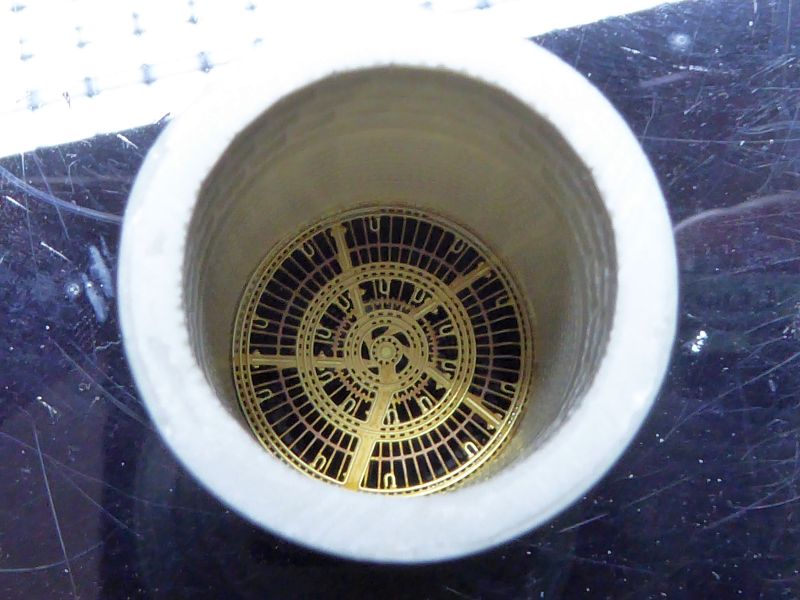

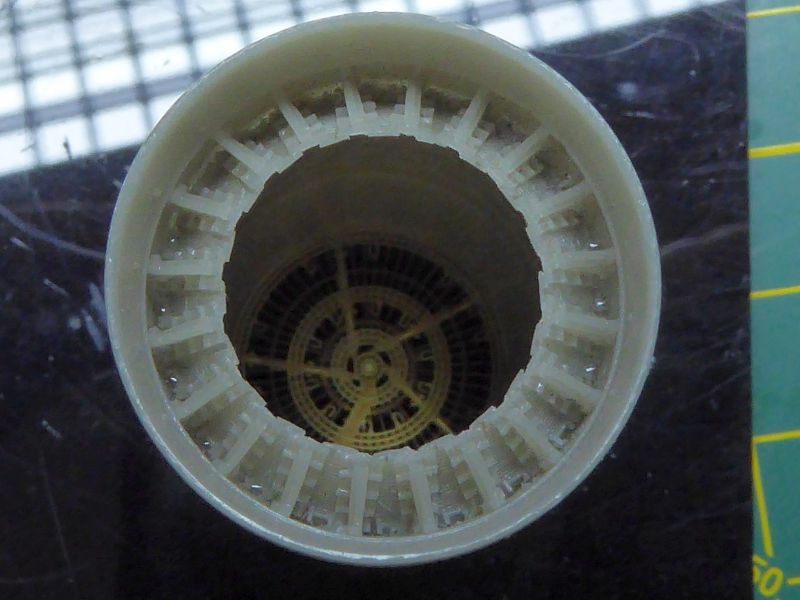

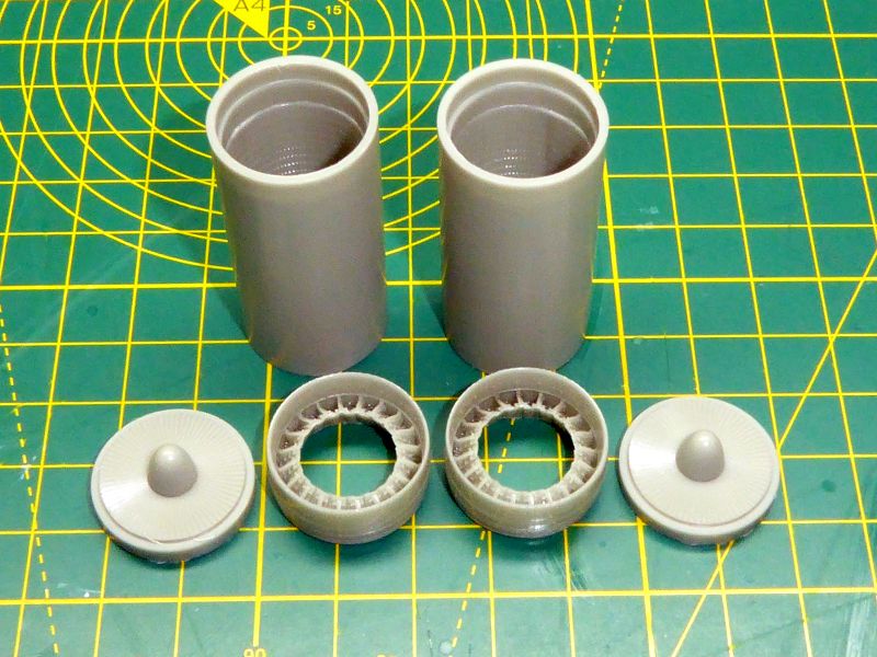

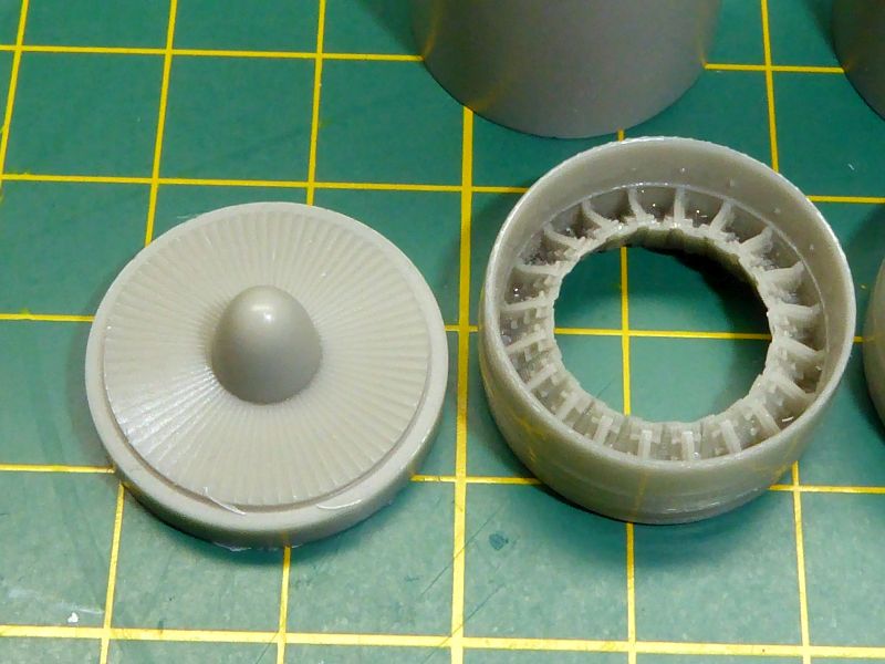

I started working today on the resin engines that I have, they are very nicely detailed compared to the plastic kit parts, its just a shame that the resin air intakes are gone as they would have made a really nice addition too.
This is the first time I have worked with resin. After recalling advice from others on here I set about cutting off the casting blocks and sanded down the edges until everything fit together nicely. This was done while the parts were wet to stop the dust getting everywhere, I also wore a mask just in case.

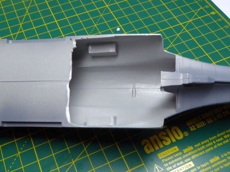

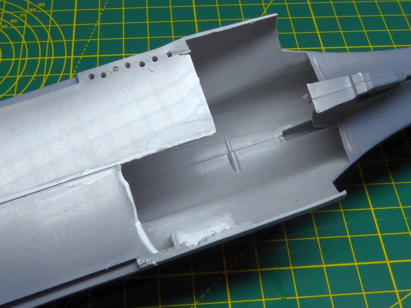

These are now ready for primer, in the meantime I had to butcher the underneath of the fuselage to enable the new engines to fit, a simple enough job of drilling some holes than a small hobby saw.

Nice looking exhaust cans Dave, they will look fantastic when painted, washed and dry brushed!! Good work on the surgery to the underside of the engine bays, always a scary moment when you start cutting great lumps of plastic away from a kit - there's no way back without a lot of work if you get it wrong - but it'll all look great when the resin is installed I'm sure.
When you come to do your rescribing of the panel lines use a hard edge to run the scriber along, if you try doing it freehand you'll likely end up with a wiggly panel line no matter how hard you try to keep it straight!! I use a bit of stiff 'Dymo' tape as a guide which has a low tack self-adhesive side to it which sticks to the plastic and won't move until you remove it after the rescribe? Dymo tape is cheap enough and readily available from most stationers like WH Smith or on fleabay.
Well done you for remembering to wet down the resin and using a mask, quite nasty stuff is resin dust, so always take precautions. I normally use one of those atomiser spray bottles (that the kitchen anti-bacterial sprays come in) to wet down my cutting mat as well as the resin and the saw blade and use surgical gloves and then clean up thoroughly afterwards? You can never be too careful!!

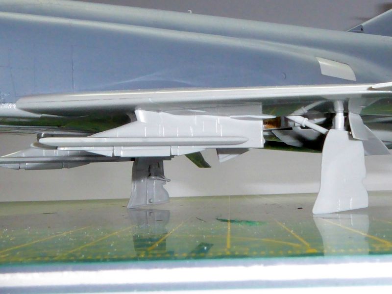

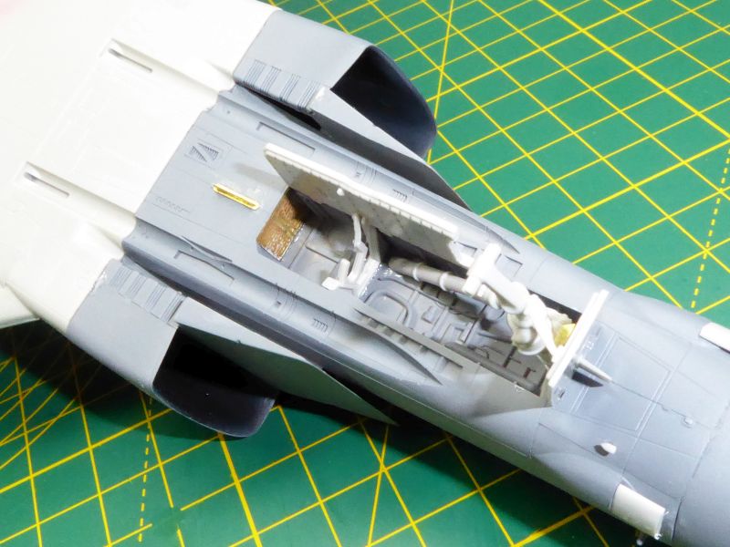

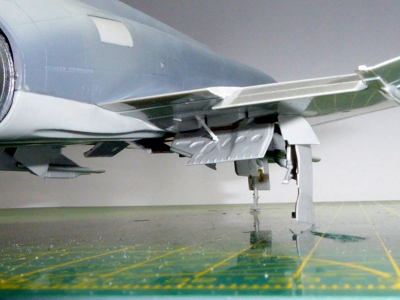

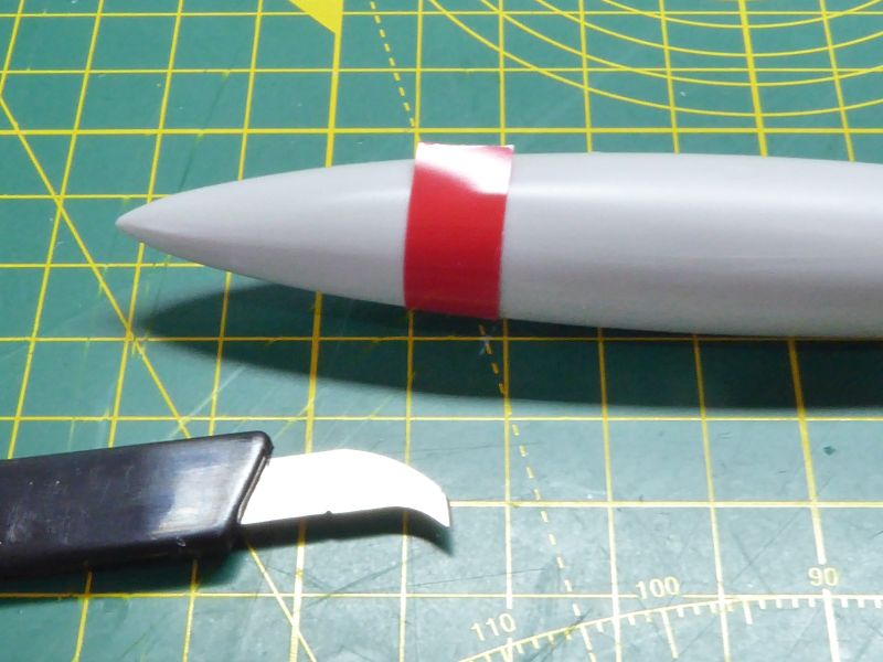

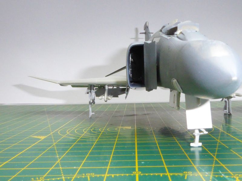

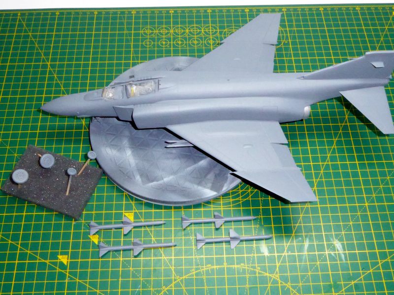

Thanks for the comments all, and thanks Kev for the rescribing advice, the Dymo tape worked a trick, still a little work to be done with the scribing but now Im confident with a good result.

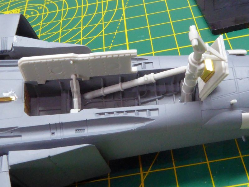

I have ploughed on with the construction with this and got most of it primed ready for paint. Just some drop tanks and gun pod left to assemble and clean up.

Thats all taking shape very nicely Dave.
Its a fantastic looking aircraft just a shame that the British version seems next to impossible to get hold of.

Nice work Dave, certainly cracking on with this and glad the Dymo tape worked for you, looks like you made a good job of the re-scribing. Forgot to mention, when you use the Dymo tape, cut it into thinner strips using a straight edge - I usually cut the tape into three or four strips from one width - that way it will comply to curved areas easier and sit down flatter, but it will also make your roll of tape last 3-4 times longer?

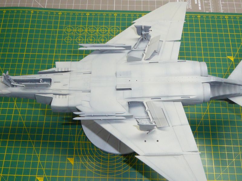

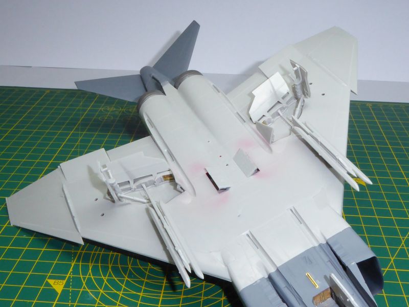

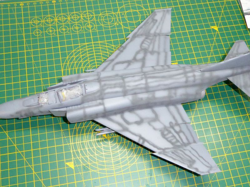

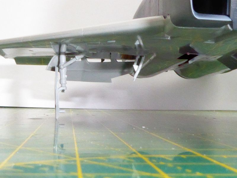

Today I had the day off so started on laying down the final colours.
First I started with the preshading using German Grey, looks a little light but when I put the light grey on the belly of the Phantom the preshade worked really well, can just about make it out in the picture. I will have a bit of masking up to do on the bottom as the wheel wells are supposed to be white.

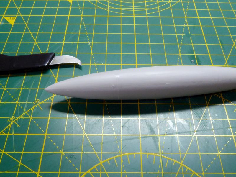

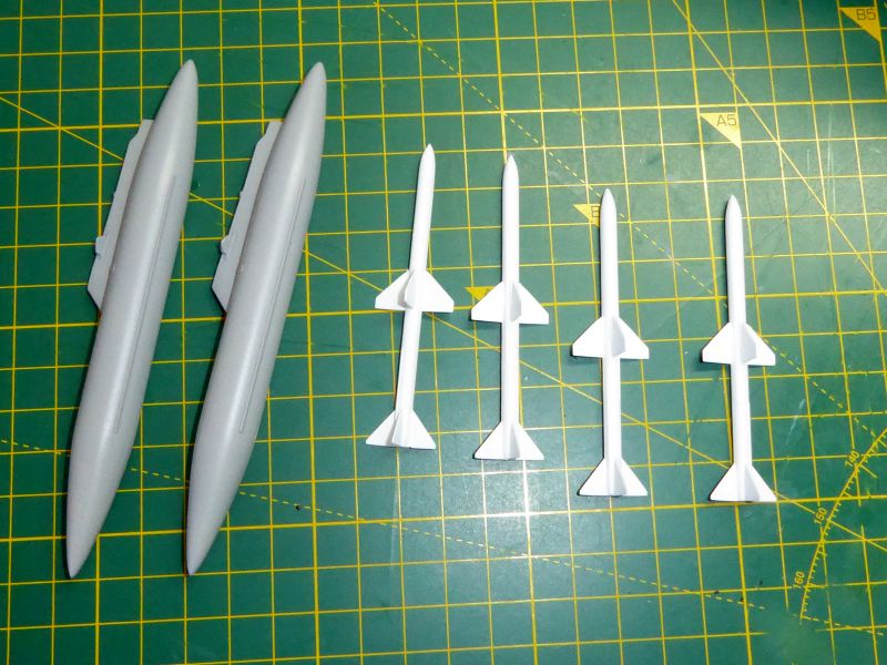

I have also cleaned up, primed and sprayed the drop tanks ready to attach to the wings. These were a pain to get done as they had a nice seam where they joined. Lots of filler sanding and cleaning to get to this point.
The gun pod has now been primed ready for its coat of paint too but no picture of that.
The sidewinders also have had their final white coat, although this was more like 20 coats to get a nice white finish. More to come.
#58 Posted : 07 September 2016 19:48:38
Very nice finish on the belly with the pre shading and she is coming together well.

#59 Posted : 07 September 2016 20:23:10
A fabulous update Dave and some very nice pre-shading, I think you were right to keep the pre-shading to a dark grey, where some would have used a much darker (almost black) colour. When your grey top coat has been sprayed it looks just about right, being just visible which is how it should be? Well done!!

#60 Posted : 07 September 2016 20:32:45
Nice job on the paint. The pre shade is spot on with the top coat, so easy to over cook it and you end up with a zebra! I likes it!
