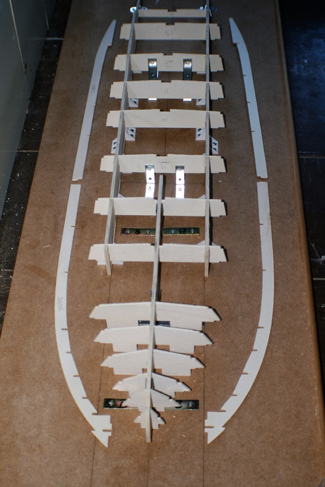

The first picture shows the four shears laid on the build board close to their relevant positions.

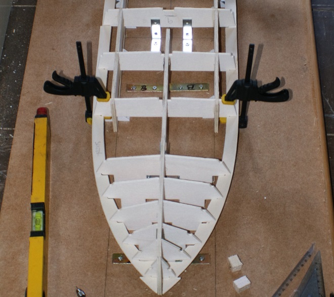

The next picture shows the forward shears held in place to check it all fits together Ok. (No glue at this stage)

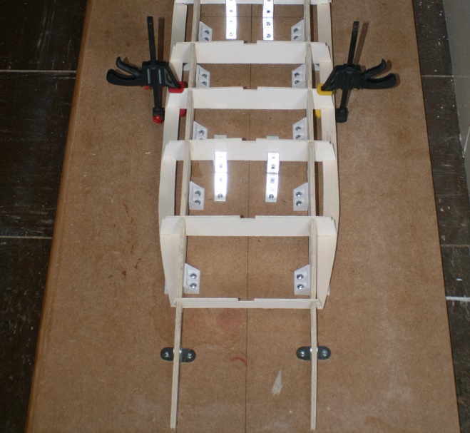

The last picture is just to show the fit of the rear shears. These will need very minor adjustment in length after the front shears are set in place.

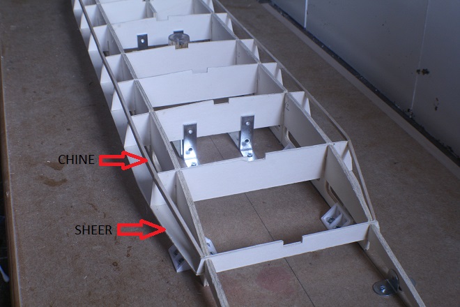

Since the last update I`ve managed to fit the shears in place on both sides and when set, started working on the fitting of the chines.

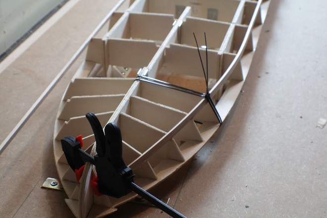

Due to the length of the chines three pieces of wood make two chines. one piece cut in half and then each half length spliced to a full length.
To accommodate the curve required on the stern end of the chines, small cuts at 1/4inch spaces were made for the last six inches of the chine. This met with limited success as the wood is loose grained and even with the saw cuts did begin to splinter slightly. I`ve glued and clamped until set these areas and all now seems ok.
The bow end of the chines is easier to fit. Only issue here was how to clamp things while they set. Trying to get clamps to hold pieces of wood that all lay at different angles was a little testing, so an alternative method was used. Yep, well positioned cable ties did the job.
So just a couple of pics to show what`s been done.
First: Stern end showing sheers and chines fitted.
Second: First bow end of the chines clamped whilst glue sets.
