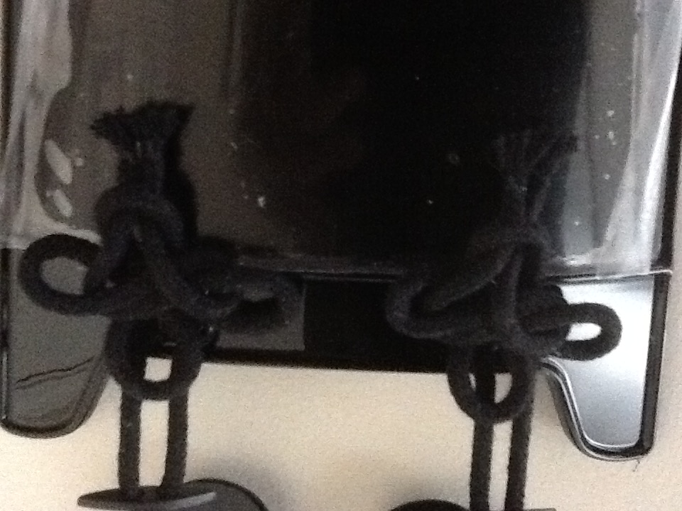

Finished Pack 4 on Friday April 1. Had some "Honey Do's" this week and Spring has sprung. spent about 24 man hours and it mostly went as instructed. I still have to redo the three neck guard rings and those hours will be added later. The only real problem encountered was the short amount of cord provided for the decorative curiass knots. I was not frugal. Both knots were made but they looked horrible - just balls. Had to go back to my fallback black cord and am very happy with the results. My Bad. Suggest that this step be done by wrapping the better ends with narrow strips of scotch tape. Determine the mid point of the cord and wrap that with one turn of tape also. Cut the cord in half through the tape. These ends will pass through the curiass holes without problems. I treaded the toggles first to find the mid points, threaded the ends through the curiass holes in reverse of the instructions. Then measure off the 3.5 cm spacing and put a dab of CA on the backside of the curiass plate to keep the spacing. Bring the ends forward and you will have enough cord for nice knots. Tie off the ends, remove the tape and fray the ends. Just a suggestion to consider.

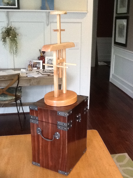

Pack 5 came in today. Thanks for all the comments. All I did today was to finish the last two pieces of the stand. My first complete portion of the kit! Feels good. BigGrin

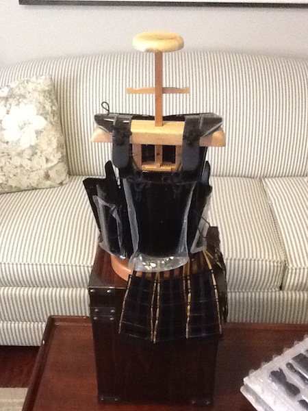

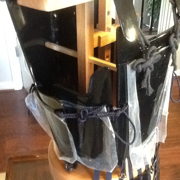

Sunday evening. Only an hour or so working yesterday but got back into things today. I was excited that the end of stage 17 would actually amount to something on the stand. So I glued up the curiass back and started to assemble things. Assembly was smooth but but when the whole thing was stood up nothing was level.Cursing
I know that I am only modeler on this forum that ever made a mistake and had to try to correct screw ups.Huh
The two half side plates where way off. After analyzing things the fault had to be in the hinges on the back plate. Did I but right on left and vise versa? So began a learning experience and good info about the use of CA glue. CA de-bonder is absolutely necessary to have at hand. I found earlier that if I smeared a the CA on the plates the de-bonder would easily remove it without damaging the planet lacquer finish in any way. Dampen a clean rag (t-shirt scrap) and remove the smear and redo to finish up.
I turned the back plate ventral side up and put some drops of de-bonder where the hinge was attached. Wait and redo until the hinge pops loose. Clean up the contact surface with an exact-knife and more liquid. Sure enough I had mixed the hinges. They are marked on both surfaces so be sure you have the right match. They reassembled without problems.BigGrin And things were level! This was potential disaster and the redo ability, with patience and care saved the project as far as I could see.
This sucker is HEAVY! When putting it on the stand one of the shoulder plate knots gave way. I removed the plate, redid the knot but securely glued it from the backside. The real purpose of the shoulder plate cords for fitting the armor to the man became very clear.
All happy again.BigGrin

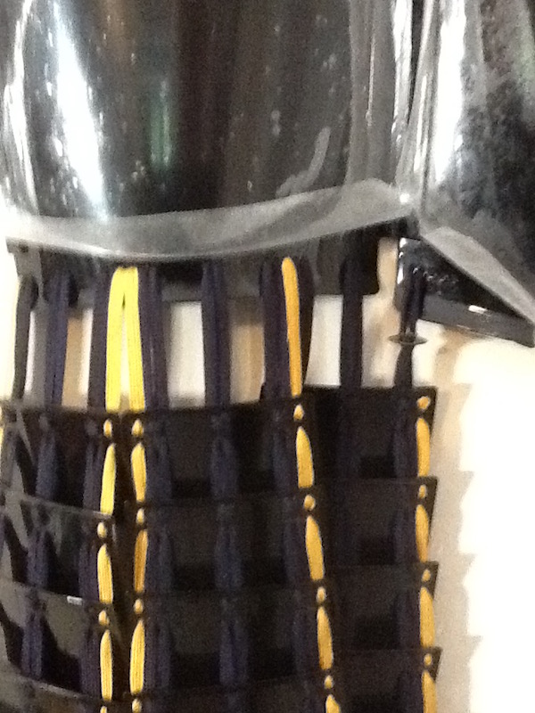

#56 Posted : 02 May 2016 19:03:29
Joined: 22/12/2015
Posts: 246
Points: 776
Location: Birmingham, AL, USA
Slow progress as the Boss has had her own agenda for me lately.

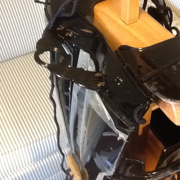

I was impressed with the attachment of this new Tasset assembly to the curiass. You really get an appreciation of how the armorers designed the suit and how it was assembled on the warrior. See pic.
The lacing of the last neck guard is BORING but has to be correct. These neck guards have been the most frustrating and tedious parts of my build to date. I did the yellow lacing watching TV and will do the same with the blue laces which I cut in half to manage the spaghetti effect. This will be done relaxing with the Boss and I will move on in the meantime.
Tom
tnequette attached the following image(s):

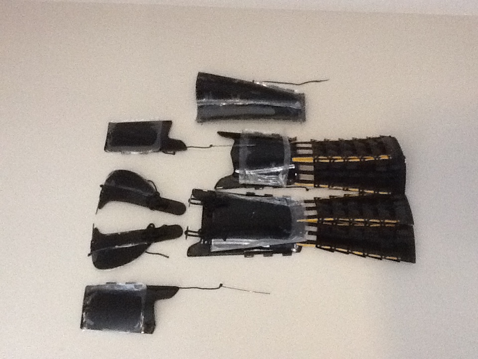

#57 Posted : 08 May 2016 18:23:40
Joined: 22/12/2015
Posts: 246
Points: 776

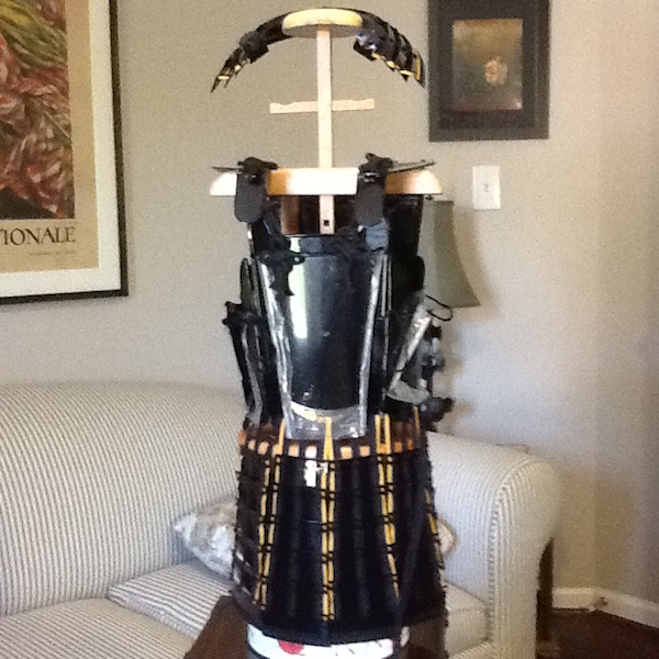

Finished Stage 5 today. It was a time consuming stage, a lot of lacing and fitting. Spent 50 man-hours between April 19 and May 7.
Tassets are over half finished. 👏 The hated neck rings are complete. 👍😜 The suede (?) material provided for the attachments of the pole support quickly pulled apart for me and I substituted some thin leather strips that was on hand. So, be careful with this material and do not pull them strongly. No big deal.The curiass fastenings were a bit of a challenge and I put the stand on a cookie can, as can see, to install them. The can allowed everything to simply hang straight. I do worry about the two right side plates aligning correctly but it is a bit early for that right now.
So, the Boss now has me for a couple of weeks. 🙁
