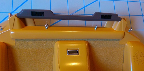

Pack 07 was rather simple so assembly didn’t take long.
First though I decided to improve on the footguard from the previous pack. I didn’t like the look of I, too glassy, so I covered it with chrome Bare-Metal Foil, drilled two holes and inserted satin pins on superglue to replicate attachment screws. Looks much better now.

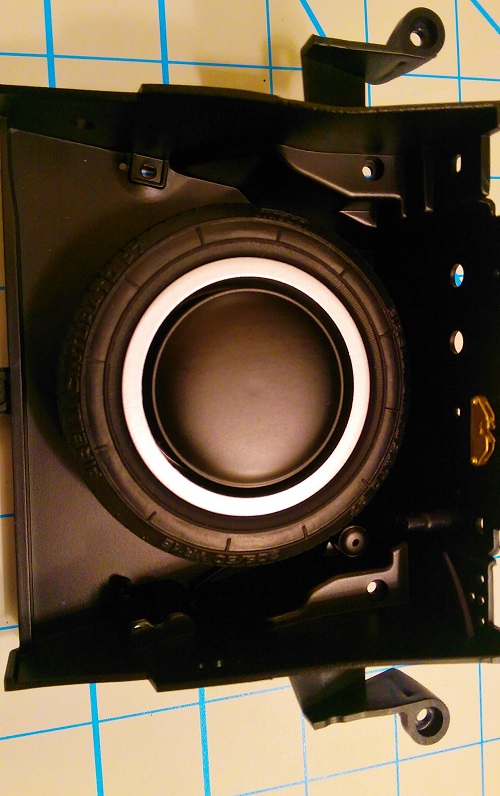

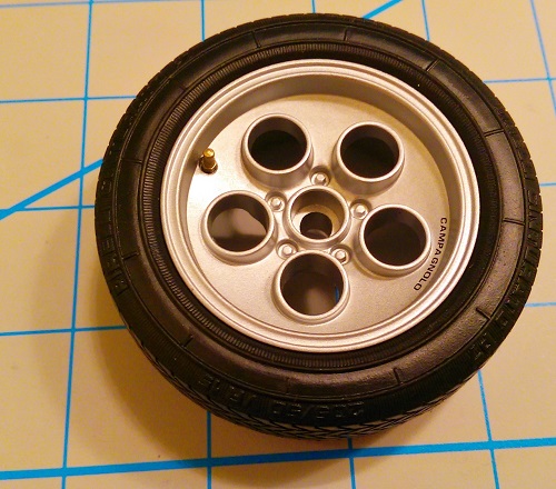

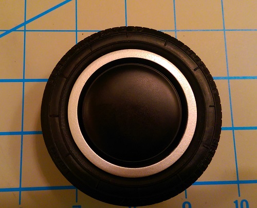

Stage 22. Washed the front tire and buffed it up with ArmorAll Extreme Tire Shine, as before. Gave the same treatment to the spare tire.
Stages 23, 24. Installed the bonnet lock and A/C dryer filter; assembled and installed the spare tire.
I found a couple of good pictures of the inside of the spare tire compartment so I plan to add a few more details (in particular, extra wiring) during the next stages.

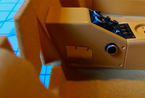

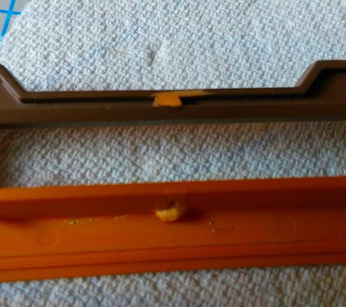

While awaiting for Pack 08 to arrive, I’ve decided to do a couple of minor improvements (idle hands… and so on ).
1) I was still not happy with the footguard, so I used the kit-supplied piece as a template and cut a piece of polished tin from the bottom of a sardine can. I filed down heads of four satin pins to make them more to scale, drilled four corner holes in the footguard and plastic console behind it, and attached the footguard and pinheads with a bit if multipurpose glue. Looks so much nice now, almost like the real thing!

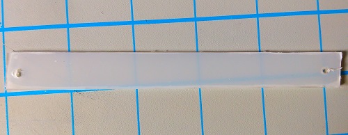

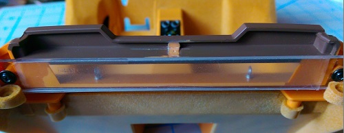

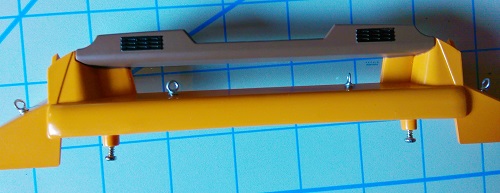

2) My kit-supplied rear window was quite a bit scratched; the transparent plastic is so soft, even rubbing it against the coarse PE kit bag creates shallow scratches; they should have put protective film over it. I tried to polish it using Novus No. 2 & 1 polishing products and covering with Johnson Wax Pledge Floor Care Multi Surface Finish (formerly Future Floor Polish) but the results weren’t very good.
So I removed the kit rear window completely and used it as a template to cut off a piece of 1/8” thick Lexan sheet. It has much better transparency and came covered with protective film on both sides. I drilled holes for the screws and attached the piece to the rear window assembly. I also cut of cylindrical knobs in the center of the assembly as they are extraneous; the screws hold my newly cut window nice & tight against the frame.

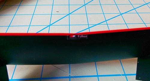

The original window also had a small decal in an upper corner (VECRIS and a serial number). So I also created a small decal in Paintbrush program and printed it (on a color inkjet printer) on Testors clear film decal sheet, and sealed it with Testors decal bonder spray. After it dried, I cut it out using manicure scissors, wet it and attached it to the rear window. It’s not a good as the original, but not bad. The letters are so small, you can see them well only with a magnifying glass anyway.
See pictures above. The rear window looks a bit hazy because I left a piece of protective film in place to prevent it from accidental scratches.

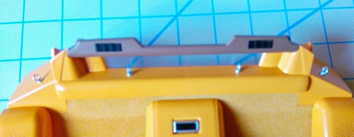

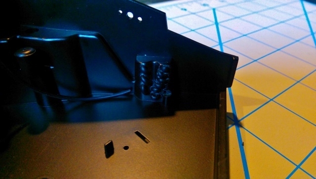

3) Pictures of the actual car show that there is a decal on the rear edge of the rear wing saying “Automobili Veloce” (I guess “Speed Cars” in Italian) and a narrow Italian flag over the word “Automobili”. So I recreated this sticker in Paintbrush and printed it on Testors white film decal sheet. The sticker is abt. 1/2” long and 1/8” wide in scale.
I cut out and attached the decal to the rear wing and after it dried, I carefully brushed on with 00 brush some Testors dull coat lacquer. You can’t see it very clearly in the picture below but it does look good!

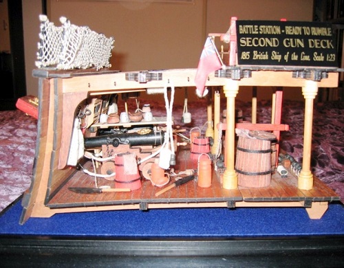

Derek, very impressed by your ship models. Never had a chance to build a full wooden ship (keep hoping though) but I did build a couple of naval dioramas (a battleship gundeck and a Mediterranean boat shop, see pics. below. It's been a while, though...

The second gun deck model you`ve shown, is one I have built the frame for and is a great kit for detail. Feel free to post some pics of it in the finished build gallery, along with the workshop dio. (Not seen anything like that before)
Cool Cool Cool Cool Cool Cool Cool
Should you wish to take on a large ship build, then there is always people here to help you along the way, but the big ships are a long term project.
Smaller ones are available if you want to try something different.
Something for you to think about in the future maybe.BigGrin

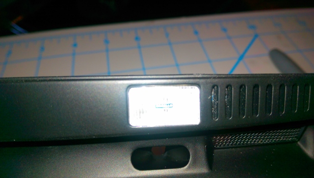

1) Lined fog lamps with Bare-Metal Foil and added silver-plated plastic cylinders to simulate lamps. They now have more realistic look; you can see how well they reflect light now.

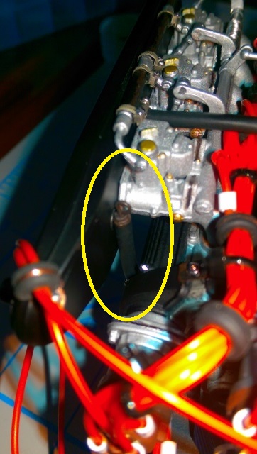

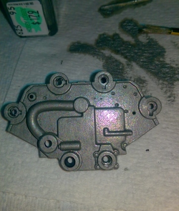

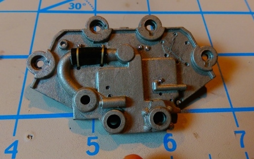

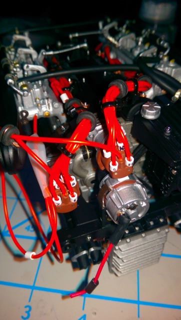

3) Disassembled the front part of the engine, painted oil casing chrome silver and dry-brushed, added extra details with tubing, photoetched hose clamps, and miniature screws. Looks much better now.

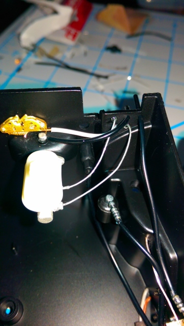

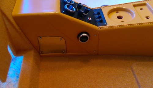

Pack 08. Stages 25-27.
1) Added extra details to the bonnet lock using some online photos as reference; cleaned up the lock and painted with brass enamel.
2) Repainted connectors of A/C dehumidifier and condenser hoses to a more realistic worn metal.
3) Cleaned up and repainted brake master cylinder, cut off hoses and replaced with wires (to match metal brake fluid pipes coming out of it in the real car).

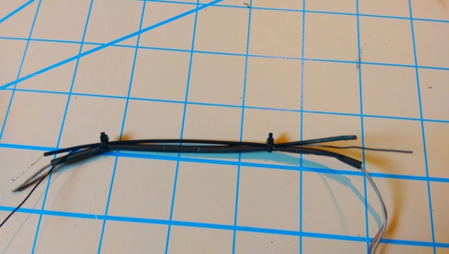

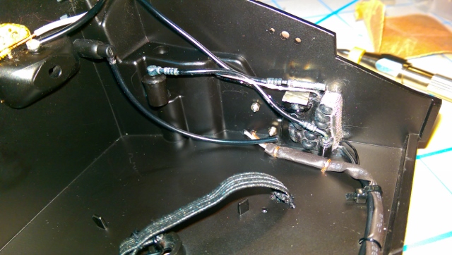

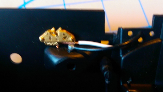

4) Added some extra parts on the left side of the front compartment using nuts & bolts, coated wire (for A/C heat-exchange piping), bare wire and wire mesh.
5) There is a thick bundle of wires in the real car which I had simulated with thin coated and uncoated wires and some heat-shrink tubing, and connected into place along the front edge.
