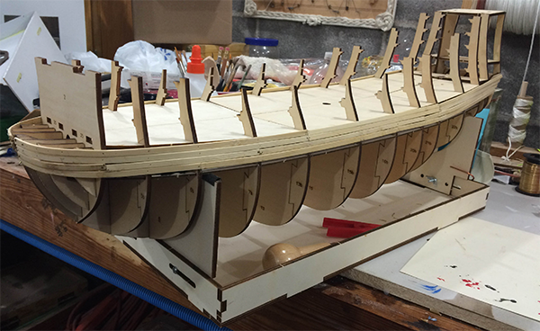

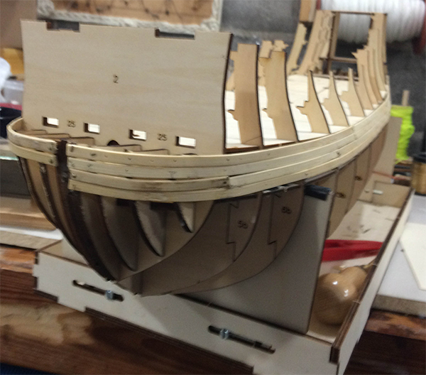

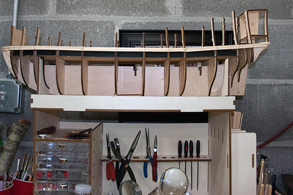

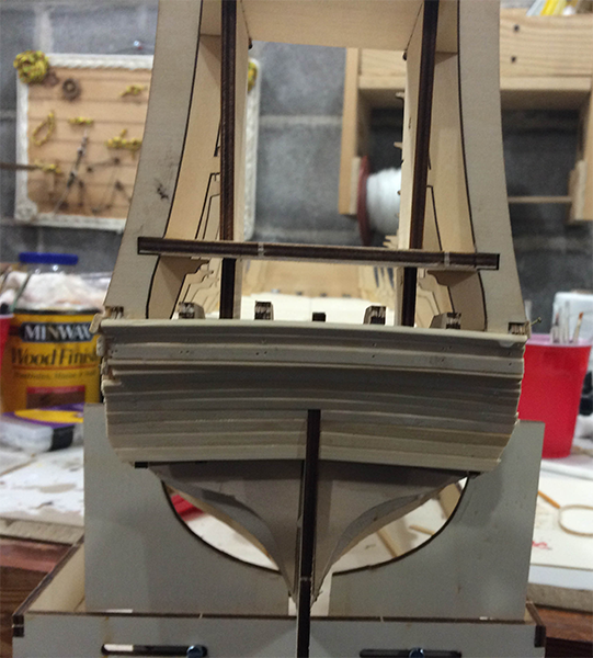

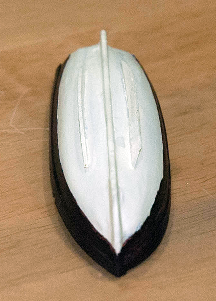

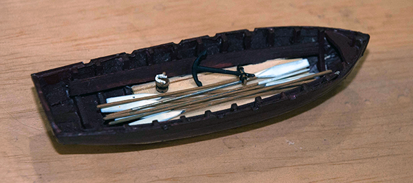

Update on SotS build. I received my second package and resumed my build
prject pictures-8.png (709kb) downloaded 39 time(s).

#42 Posted : 20 October 2015 00:08:30
Great looking work area you've created for yourself, looks very organised.
Think you're off to a great start and nice work on the launch...Cool Cool .. Looking at the first two rows of planks you've laid it is important you stagger all the joints as you fit each row of planks. Looks like you've got the joints at the same point on both rows. The staggered joints is what gives strength to the hull and it also helps give the hull the nice flowing lines she has. If you ensure your first row follows the curve of the deck then you will find when it comes to measuring and marking out the gun ports the task will be a lot easier. Cool Cool .. Hope this helps and look forward to your next update...

Thank you that is why I stopped with only the first 2 rows I thought I had it wrong.

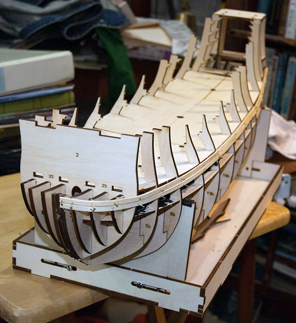

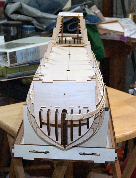

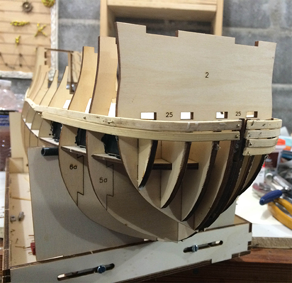

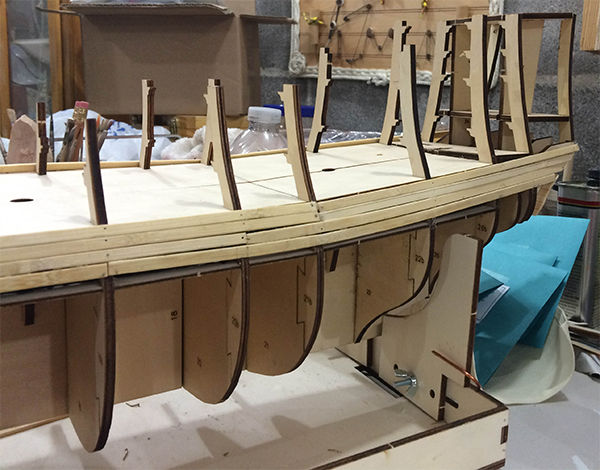

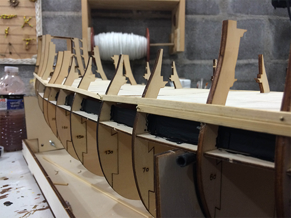

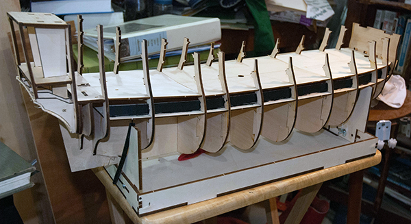

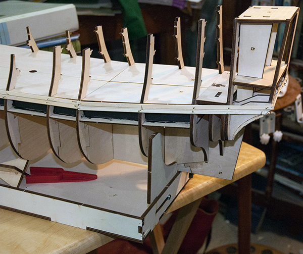

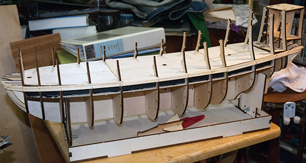

I have been working on the ferring but having some problems with spacing here are some shots of the progress. Any suggestions will be greatly appreciated.
sots 1 size.png (892kb) downloaded 44 time(s).
sots 2 resize.png (1,298kb) downloaded 41 time(s).
sots 3 resize.png (1,084kb) downloaded 41 time(s).

#49 Posted : 09 November 2015 08:28:10
BigGrin Hi Tom looking at your pictures you need to do a bit more as some of the frames still look a bit square.
The art of fairing the hull is to take off as much of the wood to allow the plank to sit on the rib and get a nice flow of the plank but without altering the shape of the hull as it is quite easy to take to much off . The best way is to sand a little then check with a plank to see were the high spot is Cool
Hope this helps Reg Martyn
Ps fairing the hull is the job I hate most Mad
#50 Posted : 09 November 2015 09:30:42
Hi Tom, I think your problems have started before you laid your first plank and believe we need to take you back a few steps. From what I can see you haven't done nearly enough fairing of the ribs nor have you achieved a nice flowing line looking along the hull with your first planking row. I would advise removing the planks you have done and lets get the hull faired correctly. Have a good read through Mr T Official diary from Stage 16, it explains very clearly the process of how to go about fairing the hull and also take a look at some of the other diaries on show..
http://forum.model-space...aspx?g=posts&t=5496
The process of fairing the hull is a critical part of any build to ensure rigidity of the hull and to give the hull that nice flowing look. Take it slow, post pics as you progress with the fairing and we'll be here to guide you along. Removing the planks is a straight forward process, using hot water and a paint brush. Brush hot water where the planks are glued and after a few minutes the glue will soften enough to enable the planks to be removed.
Hope this helps and if you need to come back to us then please do...

#51 Posted : 09 November 2015 20:49:50
Joined: 09/12/2013
Posts: 577
Points: 1,748
Location: smethwick england
Hope you don't get too disheartened by starting the planking again,I think everyone hates faring the frames, but has to be done. It took me a couple of days to get it just right,good luck and happy sanding.

Thanks for the advice I will retry to get this right.
#53 Posted : 10 November 2015 01:36:18
Hi Tom, remember we're here to help you as much as you need. It is far better to correct things as you go rather than move too far into the build only to find it has all gone horribly wrong. We all make mistakes, it is part of the learning experience we all go through and even the best builders are still continuing to learn.... Cool Cool .. We're here to help you.....
