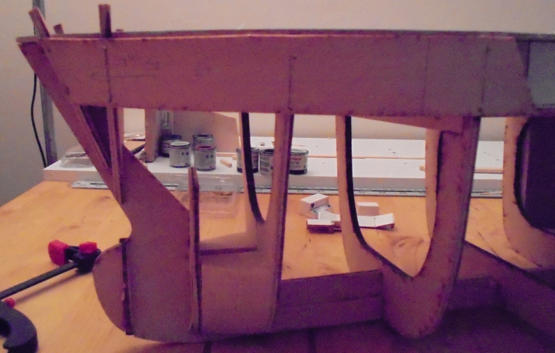

Hull fairing

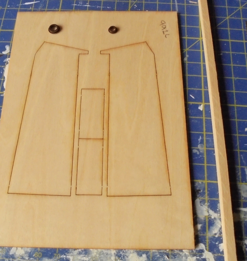

For the hull fairing a used a Dremel 4000 at the lowest speed. The bulkheads material is tougher than the material that the SOTS is made from so manually sanding the frame would have been much more difficult.
Triangular sections had to be fitted to the bottom of the stern, to do this I had to remove some of the existing material on the spine
Picture 1

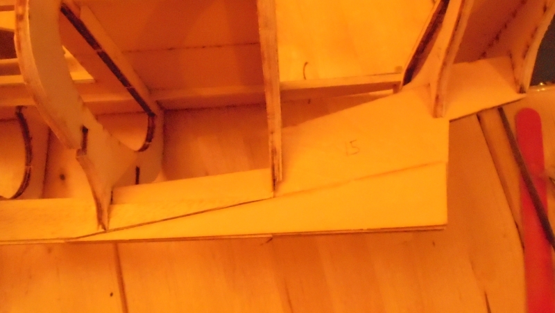

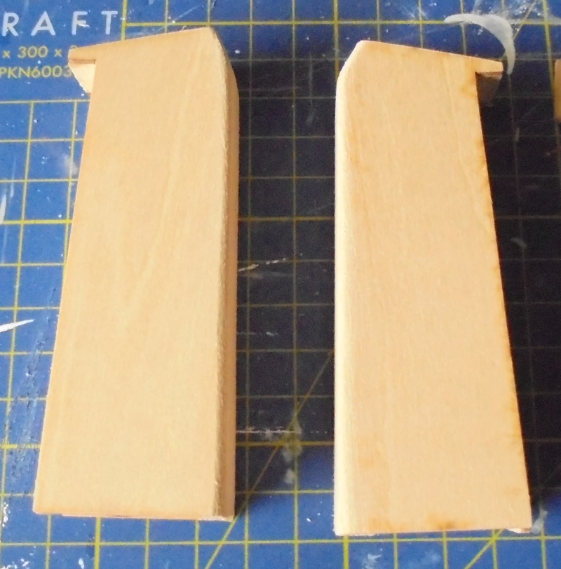

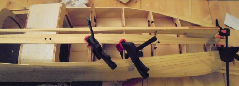

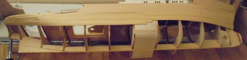

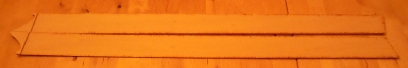

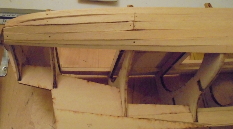

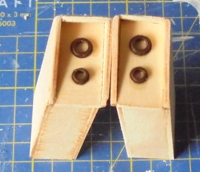

Balsa wood blocks were added to the bow and between frames around the middle of the ship. The provided planks are not long enough to go end to end so I will use the midpoint extra surface area as the join point
Picture 2-3

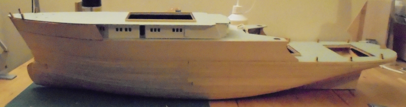

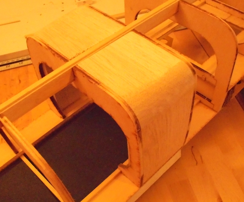

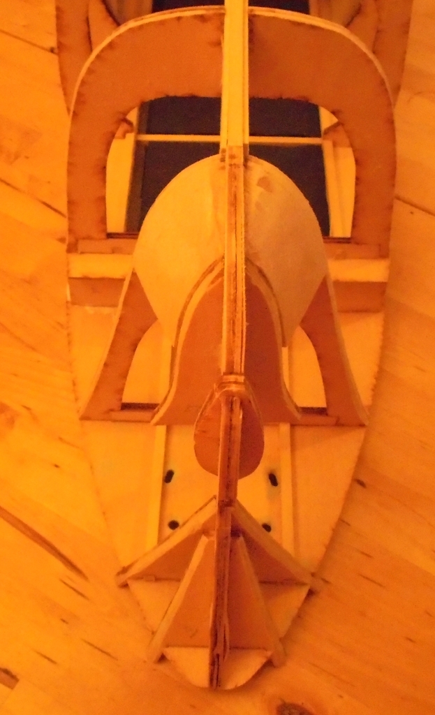

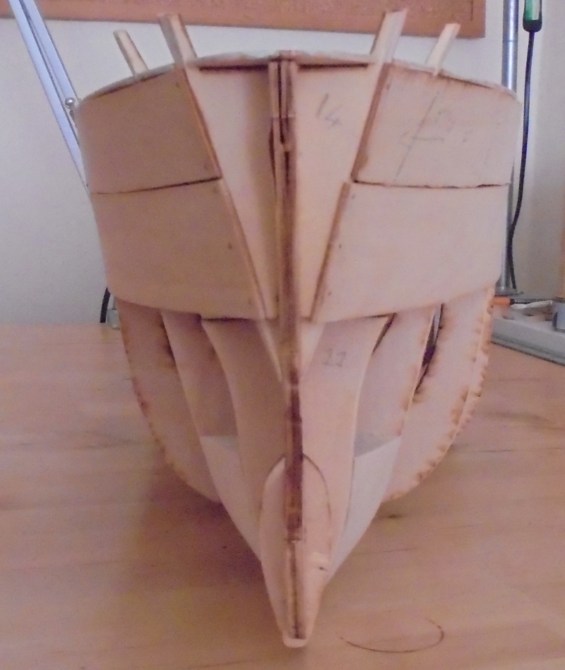

The final bulbous bow frame had to be removed because it wasn't fitted correctly. I soaked the front section in warm water for about twenty minutes to soften the glue. The miss-alignment was caused by a glue plug that had formed because the tight fit of the parts hadn't allowed the excess glue to escape. The part was replaced without glue as it wasn't required.
Picture 4

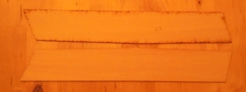

Hull strips
The top section of the hull is formed from two pieces of wood, these will need to be soaked to allow the correct curvature. This will be done once I have painted the inside area that will be visible

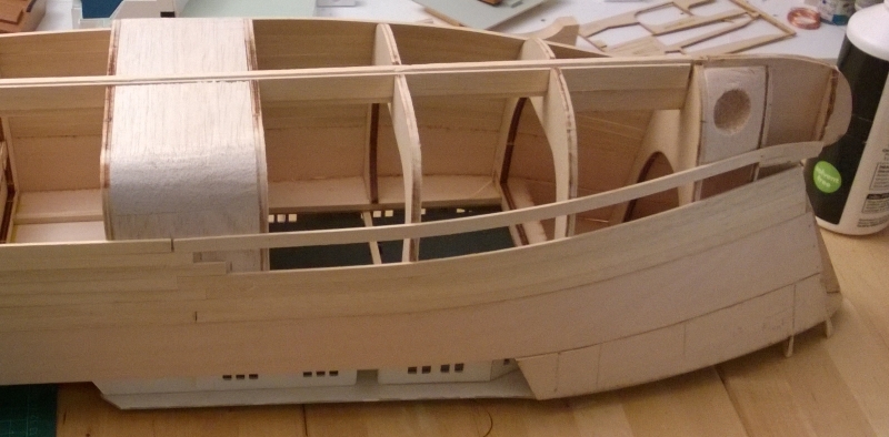

Hull strips

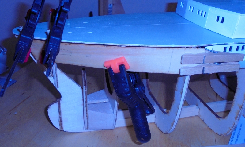

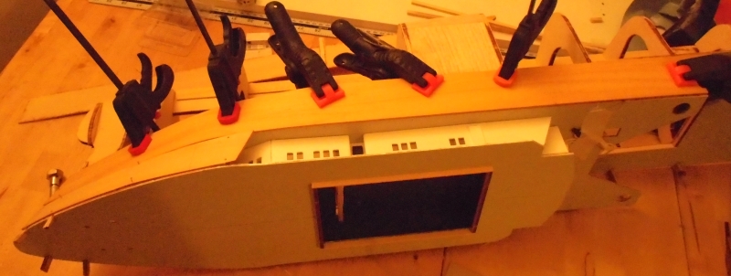

The hull strips were soaked in warm water and then bent into shape. Once the parts had dried they were glued inplace and brass pins used to hold sections where I couldn't get clamps in place.

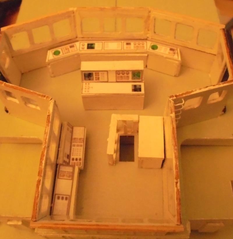

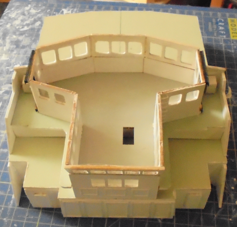

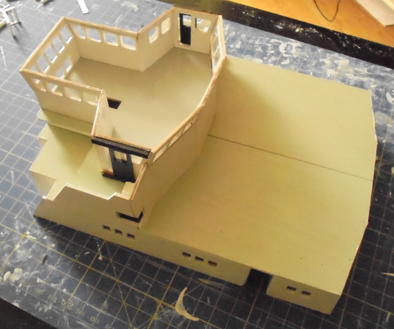

Wheel house

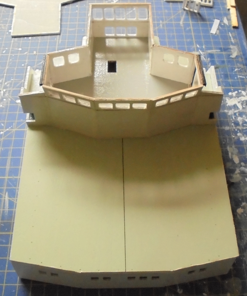

The wall sections of the wheelhouse were glued in place and any gaps filled with wood filler.
Picture 1-3

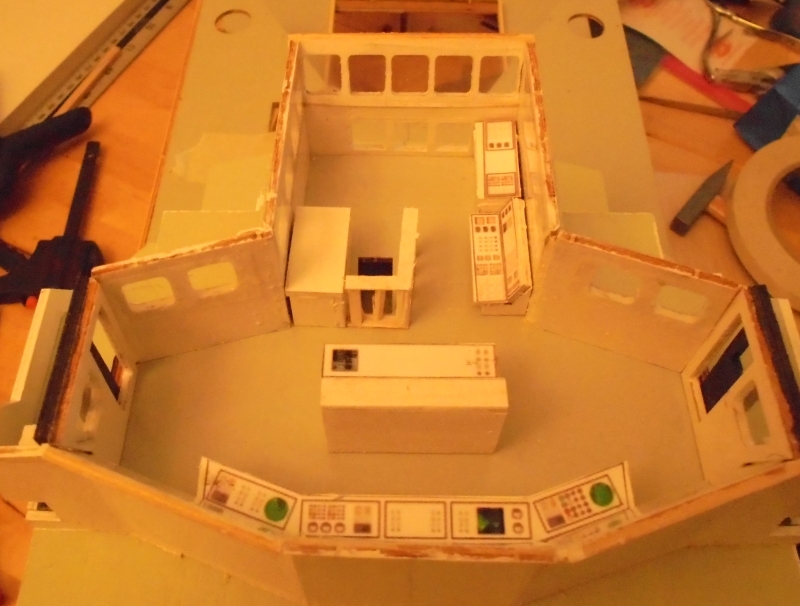

Finally the wheelhouse instruments were glued in place
Picture 4-5

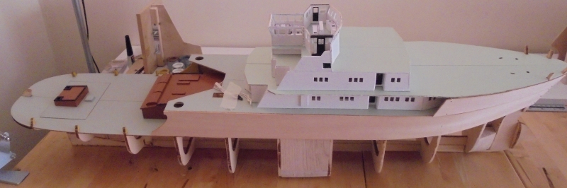

Current progress
michael.rolph attached the following image(s):

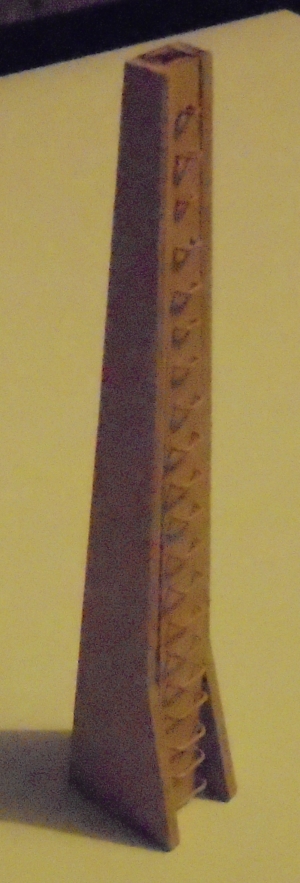

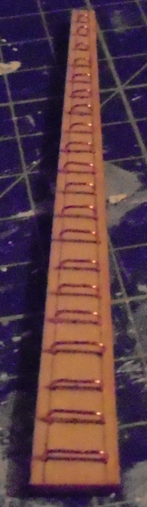

The final major component of the ship is the aerial superstructure. The mast ladder was created using the same methods as previously used on the
wheelhouse.
Picture 1-2
The inner parts of the platforms where sanded until the platform fitted at the correct height on the mast.

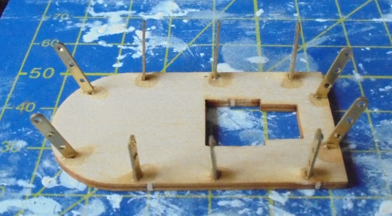

The locations of the rail posts was predrilled and the posts fitted and secured with superglue.
Picture 3

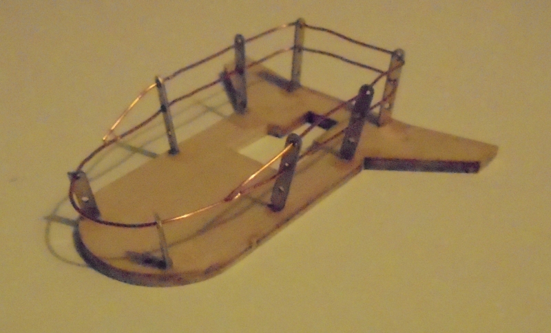

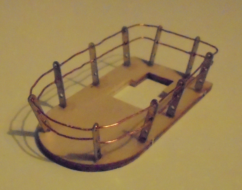

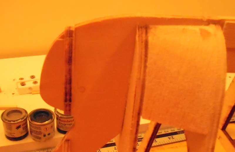

For my first attempt to fit the rails I pulled the copper wire thought the holes while the posts were in place, this proved to be quite
difficult and lead to some kinks that were difficult to remove.
Picture 4

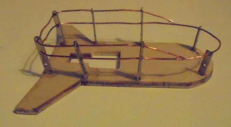

For my second attempt I prebent the wire and then added the posts before trying to fit them to the platform. This worked slightly better than
the first attempt but was still rather fiddly.
Picture 5-6

#52 Posted : 08 September 2015 00:06:50
Looking good Michael,
I have used thin steel rods sometimes for the railings.They are tough to bend, but they don't kink as much as the copper ones

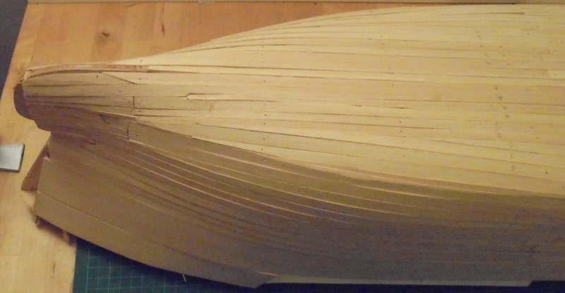

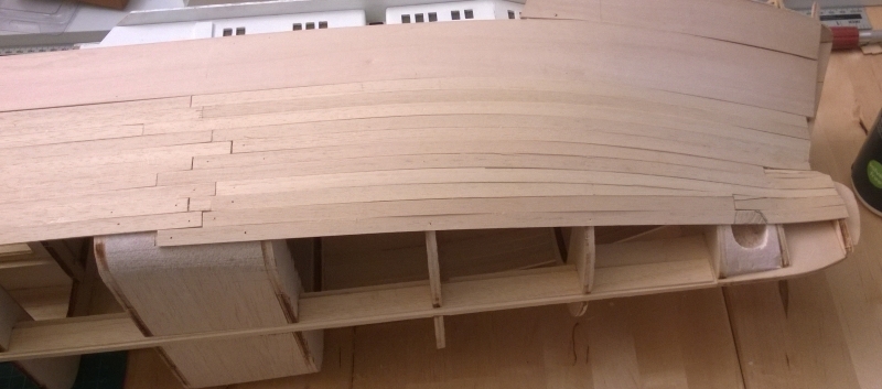

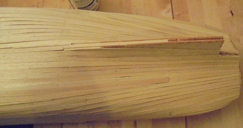

Planking the hull 1
I decided to put the work on the wheelhouse on hold while I concentrated on the planking.
The hull is a single layer plank. As the hull will be fully painted I will be able to hide any minor problems with wood filler.

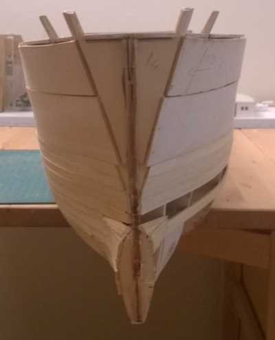

The planking towards the bow required little bending or shaping to fit. The initial stern planks were quite tricky and I ended up cutting some parts off and patching it with leftovers from the bow. The problem shouldn't be noticable once the filler has been used.
Picture 1-2
Once I got to the section above the bulbous bow I skipped a couple of rows and added the plank running to the top of the bulbous section. I then used some small pieces to form the top of the bulge. Planks were then shaped to fill the gap and planking continued down to the section just above were the sides curve to become the bottom.
Picture 3-5
