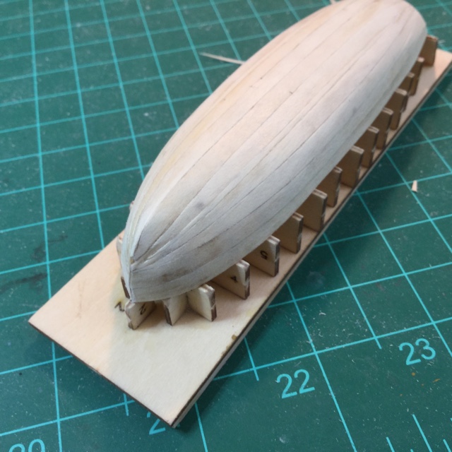

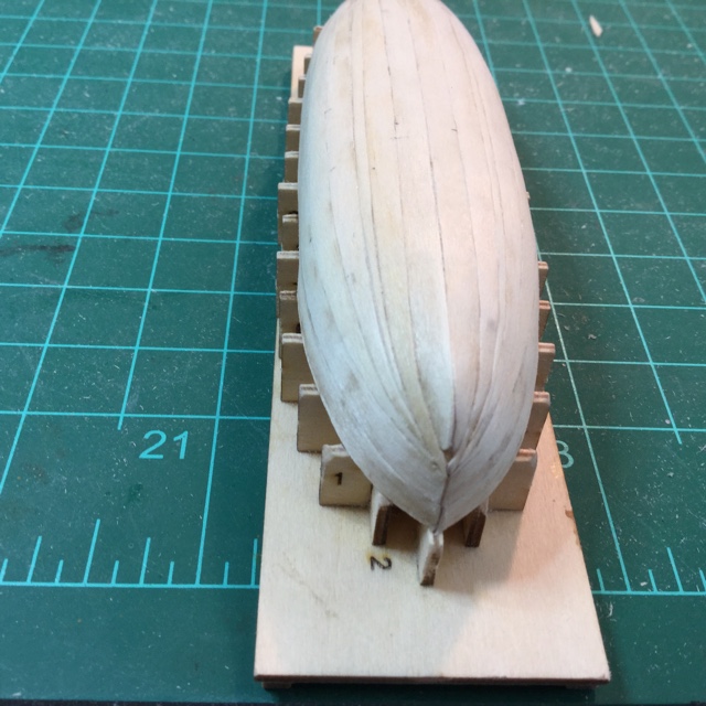

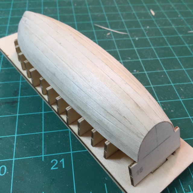

I also started planking the ship's launch. First 4 planks I have ever done. I am pretty happy with them although I wish they would have fit a little tighter together. Not sure how practical that is with planks this small.
Is there some point where I should start tapering the width of the planks at the bow and stern? I am assuming that I will need to do that after I lay the next set of planks down the center of the bottom.

Hi Dominick, coming along nicely... Cool Cool .. You should have already started to taper the planks, the second plank you applied should have been gently tapered towards the bow but not at the stern, subsequent planks need to be tapered at both ends but more at the bow than the stern. The taper should be applied so you are butting a tapered edge onto un-tapered edge of a fitted plank....Cool Cool .. Correctly tapered planks will help eliminate any gaps appearing.. The next planks you need to apply are the two running down the centre of the launch after first marking the centre point on each of the ribs. Cool Cool .. Hope this answers your question....

Alan,
Thanks. I just ran the two down the centerline and then tapered and ran two next to those. They took a long time and a lot of try and retry but they laid in nicely, fair to the frames with no gaps.I think the remaining space is about 2 1/2 planks wide. Should I trim three planks so they fit the space exactly at mid-ship before tapering the remaining ones?

Hi Dominick, you should fit the planks from the first two planks you fitted up towards the keel, tapering the planks as you go. The final plank will need to be shaped to fit the remaining gap, a fiddly job but just take your time and it will get there... Cool Cool

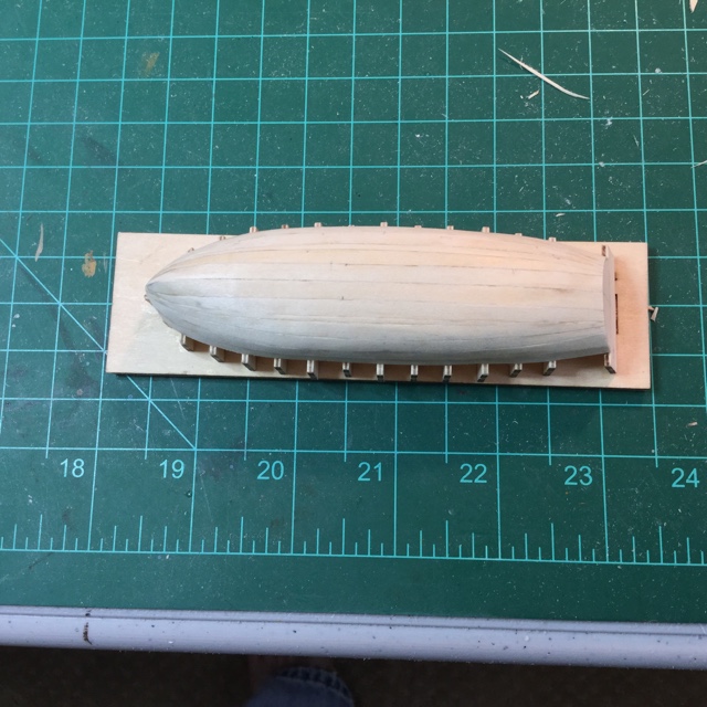

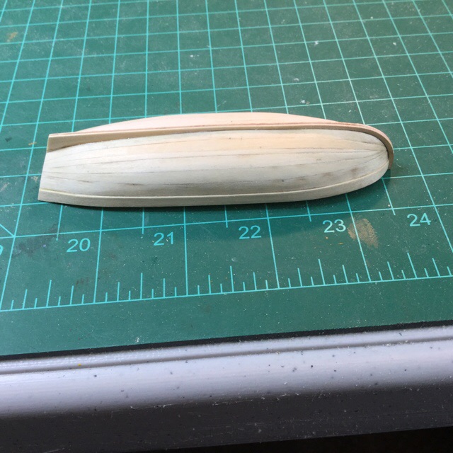

Here's the latest work on the launch. I finished the planking except for the additional planks at the gunwales which I'll add before cutting it off the jig. All in all, it wasn't too bad - just a little scary for a first-timer and quite a bit fiddly as you say in the UK. I discovered a few tricks along the way, I would place a mark on each plank i was tapering and a matching mark on the plank next to it so that as I test fit and sanded I always re-test fit in the exact same spot. That worked well.
The stealers were indeed a bit fiddly as Alan mentioned but sand a little, fit, sand a little fit, etc. and they went in pretty well. I filled some very minor gaps with a little thick CA and then a very light sand just to smooth everything out.
Overall I'm pleased with it as a first ever attempt at planking. I do wish I had tapered the second course a bit especially since I would have gotten a much better fit at the bow. Which, by the way, is the only part I'm not really happy with. After I install the keel I'll see if it needs a touch of filler and a light sand - just at that little dimple.

Hi Dominick, it all worked out in the end and very well done on your first attempt at planking, you've done a great job.... Cool Cool .. Now onto the next task, the additional planks either side then removal from the jig.... will be watching as usual .... Cool Cool

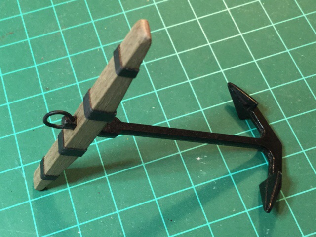

Not much progress today. I cut some paper strips from a nice thick paper for iron straps around the anchor stock. I wasn't sure how wide they should be but looking at the pictures in the instructions I decided on 4mm for the wider band and 3mm for the narrower band. Then I colored all of the edges and faces with a black sharpie. I sealed the stock with Vallejo Satin Varnish and then put the straps on and touched up any white edges. I had to make the strips from 2 pieces each because of the complex angles on the stock. It looks really good. Then I glued the anchor into the stock and slipped the ring in and closed it. I painted half the ring and later I'll spin it and paint the other side. Then I can attach the rope.

Finished the anchor last night. I'm very pleased with how it turned out. I haven't attached the rope yet because it has a few kinks in it from being in the package. I want to dampen it and stretch it out a bit and see if the kinks straighten out first.

Looks good DominickBigGrin It's nice to see the planks through the paint so at least you can tell it is woodBigGrin It depends on how perfect you want the finish.
You could tie the rope to the anchor, then wet it and hang it up somewhere for a while to straighten.
