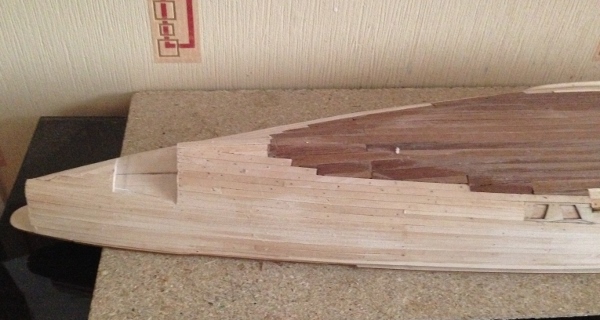

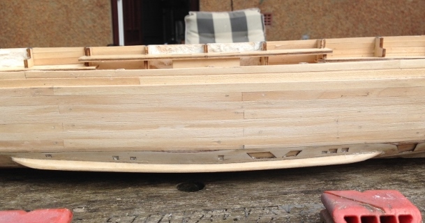

BigGrin Mornin' Folks

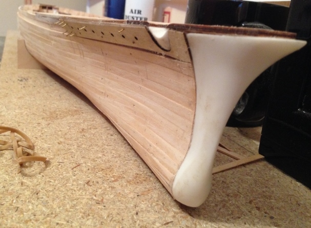

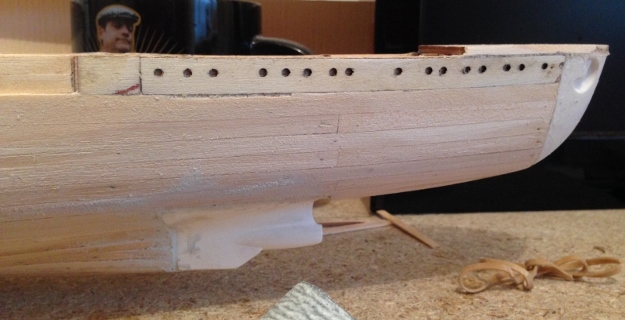

Have added the "bilge keel" i am more used to calling this part the stabiliser
I used "serious glue" for this part.....once dried i will try and pull it off
They do fall off in real lifeFlapper
HMS Torquay crossing the Bay of Biscay with one stabiliser in a force 10
Crying The only time i got seasick lol
Cool Still several months in Whitley Bay while repairs getting done at Harland n Wolf at Wallsend
budgie attached the following image(s):

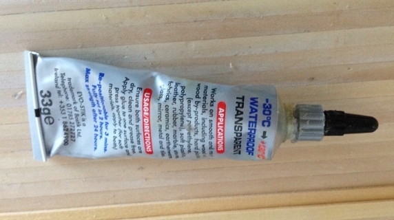

magpie1832 wrote:
Looks great Stuart. It's coming along nicely.Which serious glue then BigGrin I used superglue to stick mine on the only problem with this is you only get one go at positioning it.
BigGrin Hi Chris thanks for popping in

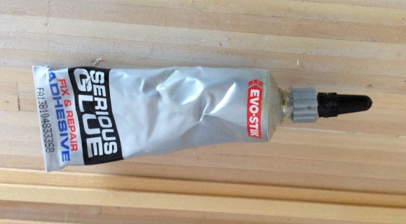

This is the same glue i have used to attach the resin part to wood and it seems solid enough
It is thick and gives you a few minutes to play about with positioning the part
The instructions does say to use epoxy but i would rather use a glue that requires no mixing to save mixing too much or worse not enough for the job in hand
I did think about drilling holes in the "stabiliser" and hull and using brass rod as dowels
1st time i have used this glue on wood to wood but seems solid enough at the moment
Wiil give it a "tap" once fully hardenedLOL

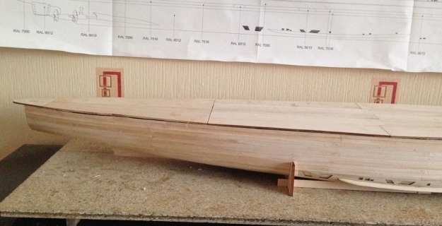

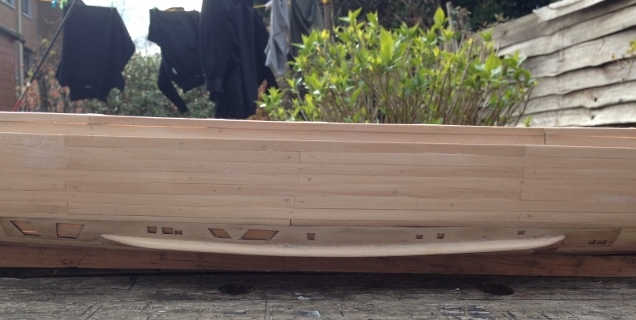

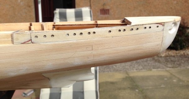

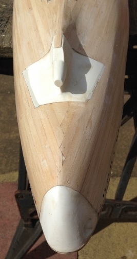

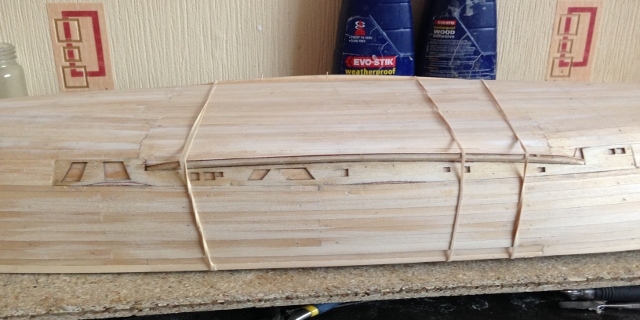

Spent the past week adding the rest of the 2nd planking
I did think about using the thinner planks supplied once past the stabilizer area and hope it blends in after sanding but decided to use same thickness as the 1st planking..... hence the dark wood (not enough of light planks to finish)
This will give me a bit off leaway when sanding as i am quite heavy handed and would probably rub thru the thinner planksLOL
Going to rough sand the hull... weather permitting before adding the resin parts and the ply with porthole detail at bow and stern
I have not double planked the top 2 rows of the hull yet will use thin strips for that
Thanks for lookin'

#50 Posted : 02 May 2015 21:05:01
BigGrin Planking looks greatCool
#51 Posted : 02 May 2015 23:32:40
Looking great Budgie, looking at the planking the hull should sand down very nicely..... Well done indeed....Cool Cool

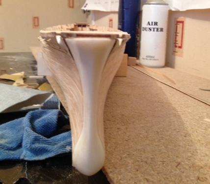

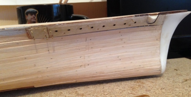

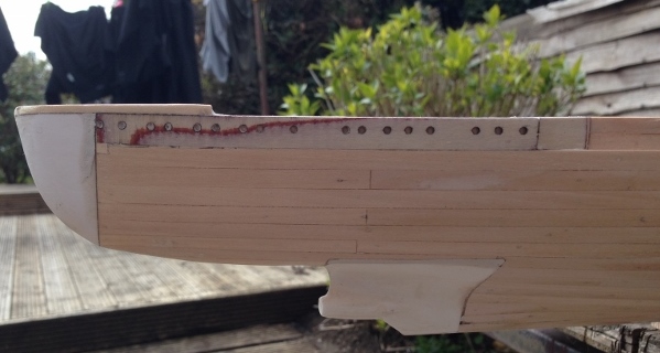

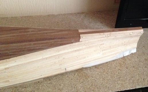

BigGrin Morning Folks
Crying Nearly got caught sanding indoors as SWMBO returned home earlier than expected

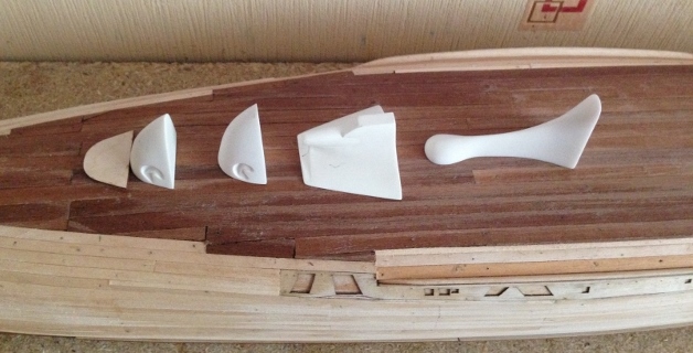

So decide to add resin and detailed ply parts...felt good to finally start seeing some detail appearing
Still got a lot of sanding and tidying up at the joins etc
Progress pics so far...thanks for poppin' in

#53 Posted : 03 May 2015 12:05:19
Loving this build. The shape of the Bismark is remarkable. Your making a great job of the planking and shaping. After sanding down it will certainly please you.
On my Hood for filler to smooth it and blend it all I used Stopper. Which is car filler in a tube used for getting rid of the fine scratches left behind when wet and drying.(Google auto repair stopper filler) Dries pretty quick and is rock solid. Use wet and dry to smooth it.
Hope you don't mind the tip.
Regards Chris

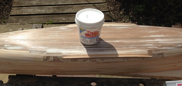

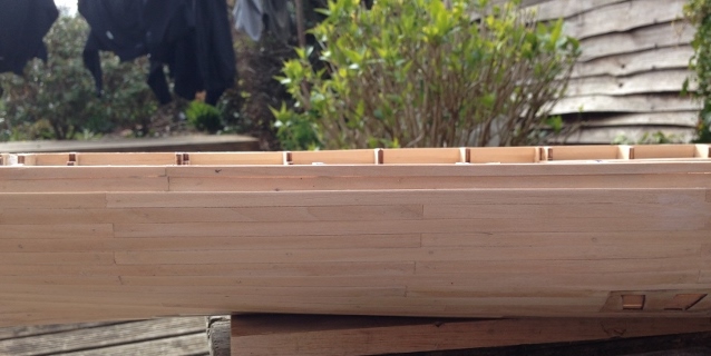

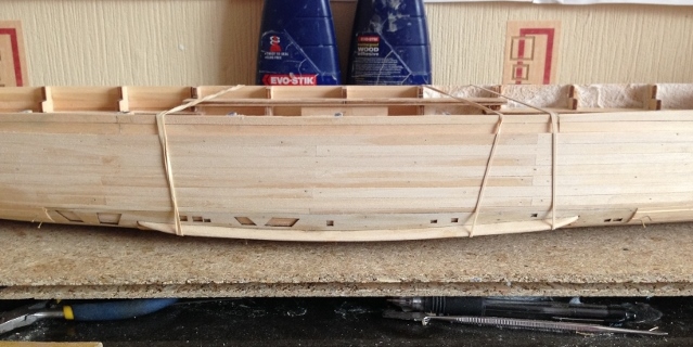

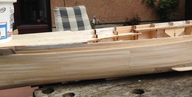

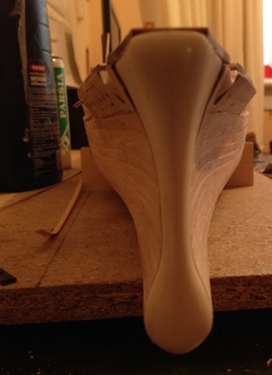

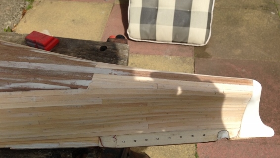

#60 Posted : 04 May 2015 16:34:58
Joined: 20/03/2010
Posts: 1,199
Points: 3,473
Location: Glenrothes

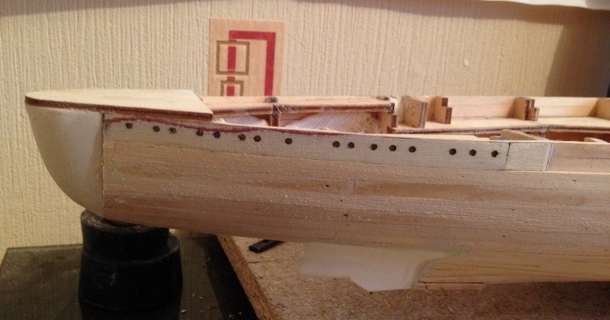

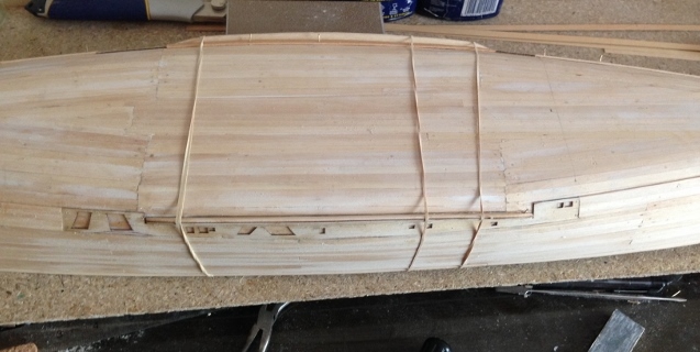

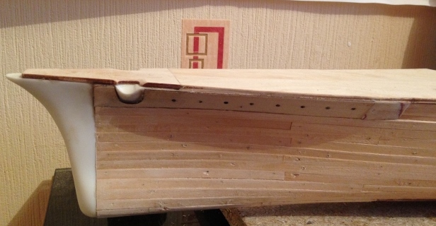

BigGrin Hi Folks .....thanks for taking the time to leave encouragement

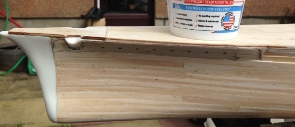

Cool covered the hull in filler and been rubbin' away all day OUTSIDE LOL
Crying Sloooooowly getting thereCrying
The pics show some areas where light is shining thru on the 2 upper rows of planks and the squares at the bilge area
But i have still too double plank the upper two rows with a thin veneer and to finish off gauzing the inside off the hull (got bored doing that earlier)
