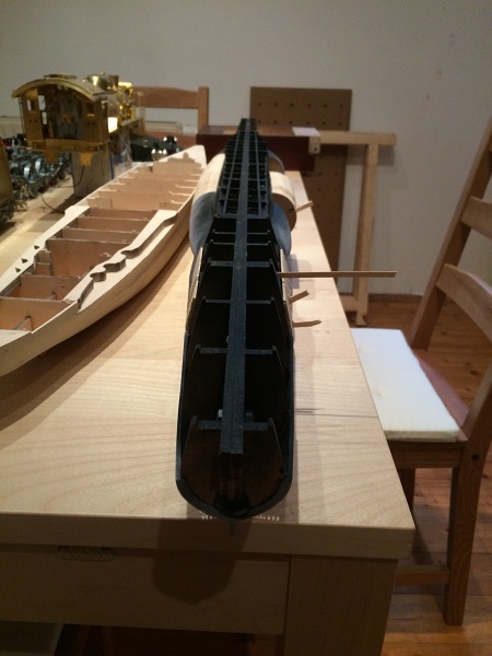

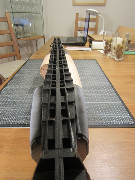

Because, what you can`t see on the pics very well, my U-96 turnes out to be a "banana-boat"!
Although i had it rested in the jig!
The keel seems almost straight, but when i removed the hull from the stand and turned it over, there was some serious curve on the deck-side.
So there must be some twist in the middle Frames.
Don`t know how this could happen, as i glued the parts on a absolutely plane surface and then put it in the jig.
Well, i will have to live with it and hope, it won`t be that visible once the Tower is mounted and you can`t see in a straight line from the bow to the Stern.

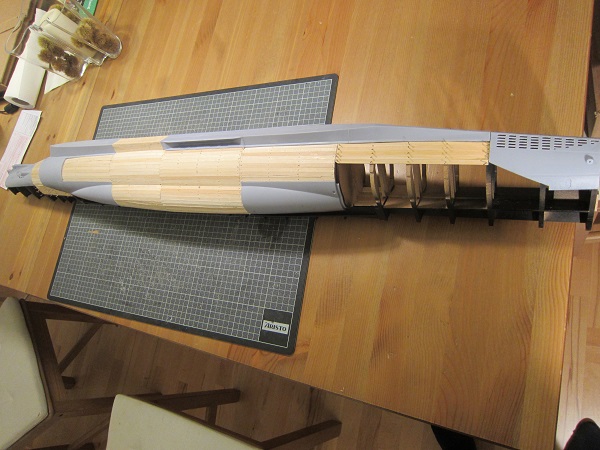

#49 Posted : 24 October 2015 22:38:02
As promised here are my latest pics:
Here you can see the warping without the removeable section:
That`s where i am at with the planking - now waiting for the side parts of the removeable section:
daffy09

Nice work on the planking Walter. It's really taking shape now and it must feel very satisfying to get to this stage.
The problem you had with the warping doesn't look to severe at all in the photos ( it's very hard to spot and interesting to see that it's in the same place as it was on my build.), and hopefully your work on the planking has gone a long way to straightening her out. I feel sure that when the rest of the planking is on, you will have a much stronger hull and it will have cured the problem.

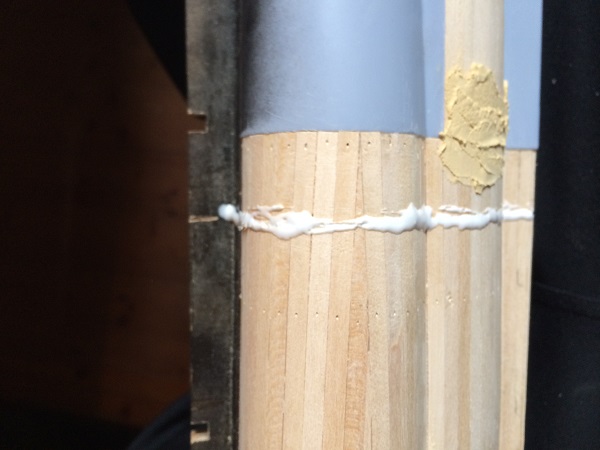

I spent some time today with sanding and a little bit of filling - to get a smooth surface for the second planking.
I tried my new delta-sanding-machine - but that didn`t work very well - so i went back to manual sanding.
As i was full of sanding dust already, i went on to sand the starboard-side of my AKAGI-hull. Here the delta-sander did a good job!

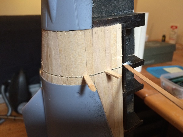

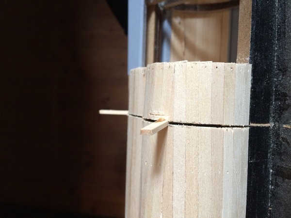

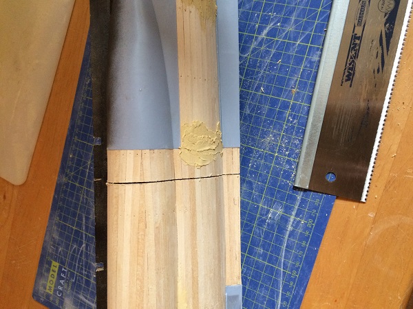

after sending some prayers i took a saw and just cut the hull straight to the middle-frames from both sides at the site of the strongest bending - hoping the whole thing wouldn`t break.
I then put some wedges on one side, bending the hull to the other side. The gap on the wider side i filled with epoxy-glue, the other side i tried to glue with PVA-Glue (sitting about an hour and holding everthing in place!).
And this the result of my work. I can`t say how pleased and happy i am with the result as now i have new motivation to proceed with the build
[size=8]I´m very happy right now as this has been bothering me for some week now!!!!
Thanks for looking in!!!!
