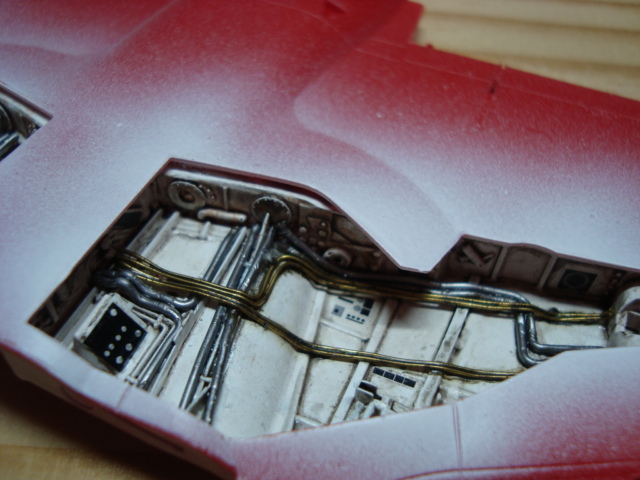

Thanks for looking - mini update, I have toned down the brass wire with an oil wash, think they were a little bright. I did plan to blacken them later but cant find my blacken it solutionAngry

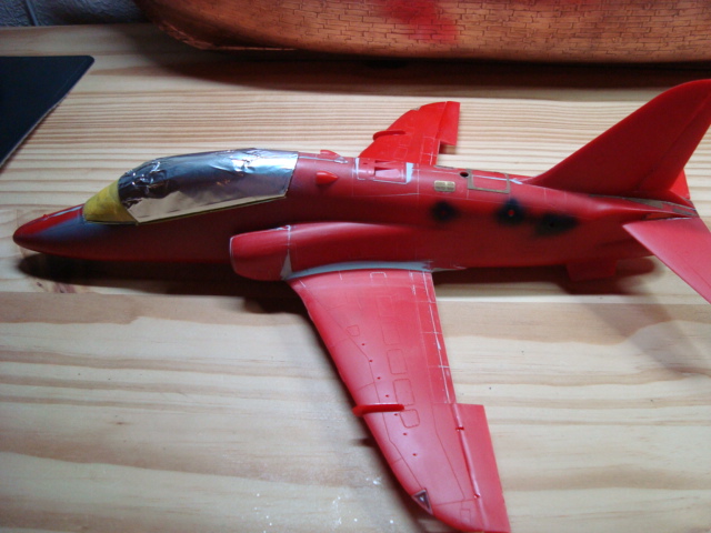

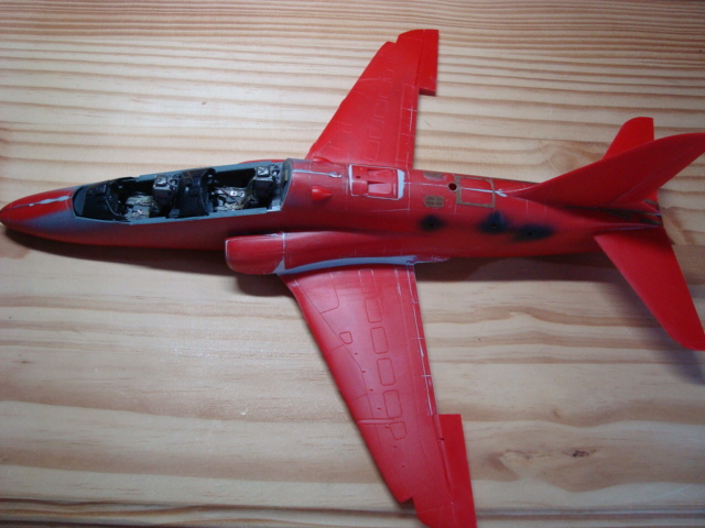

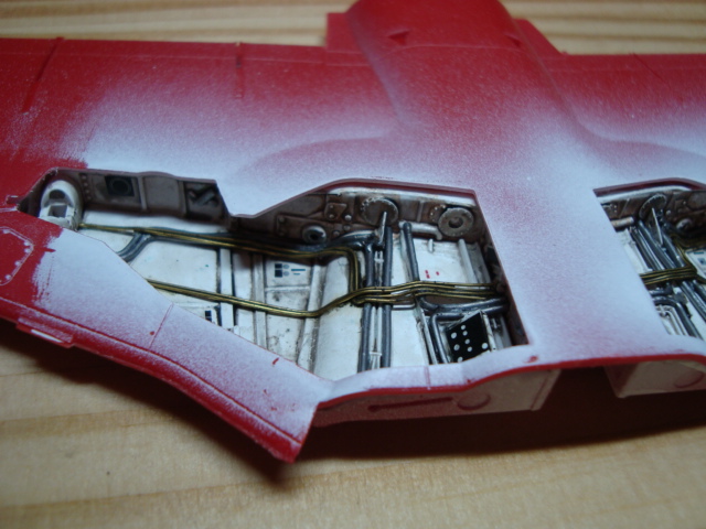

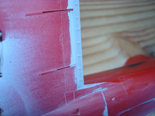

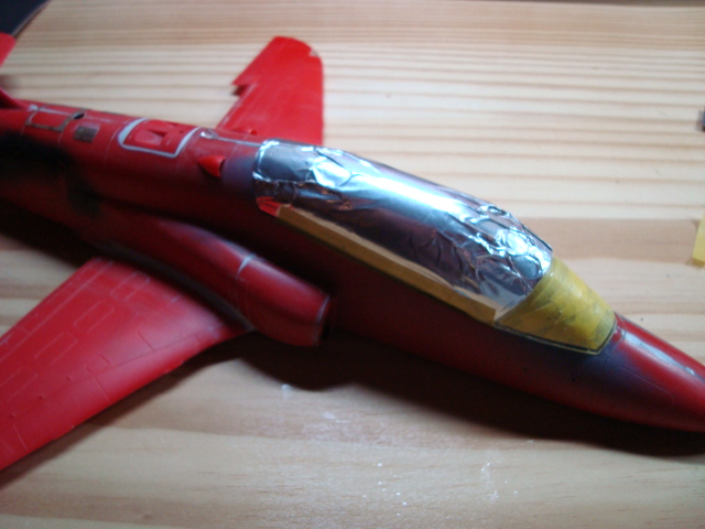

Thanks for the comments guys - bit more work done, not quite ready to prime yet - bit more prep than I imaginedAngry
All the main bits are on and filled and I reckon it's as smooth as it's going to be before priming (prob need a fair bit after though).
The resin landing flaps will be going on much later as I need to sort out which parts are red / white on the underside. I have put in the internal resin flap parts though.
All the lighting wires are now out of the way, I have trailed the + / - wires through small drilled holes in the under-carrige bay - I hope to be able to disguise them as hydraulics on the landing gear before going out through the base to the batteries.

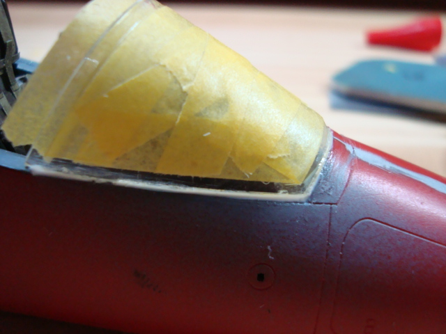

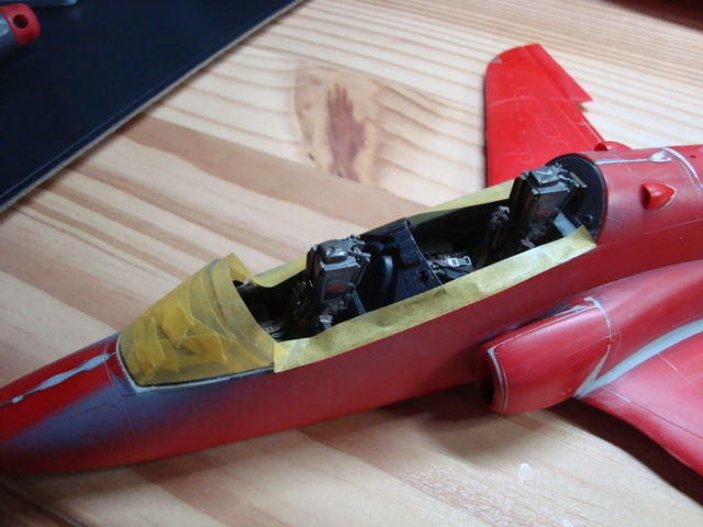

Front canopy is fitted, may need a little filling when the canopy glue is dry.
The main canopy is not fitted as it's going to be displayed open. Im just using it as a mask covered in foil. I will detail the canopy separately as there is etch and decals to go inside and will most likely be fitted right at the end of build.
I'll post up some pics when she's all primed upLaugh

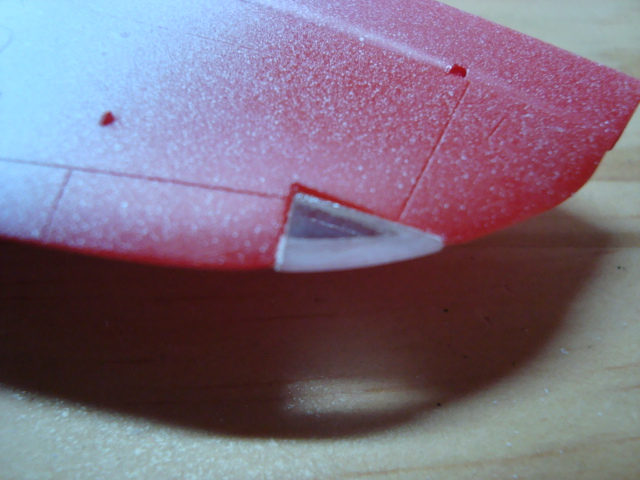

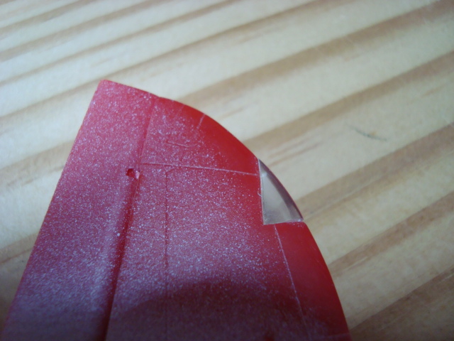

You have some pretty bad sink on the wing light, do you have a thought on filling it?
#52 Posted : 25 February 2015 10:39:16
Thanks Alan,
Jase, it look pretty bad in the pic, not as bad as that at other angles but certainly noticeable. It's sunk on both sides of each lens too so cant even reverse them. The frame on the lens will be painted red and the lenses are going to be painted with Tamiya's transparent red and green, whether it shows better or worse after that I'm not sure reallyConfused
I'll have a think about it, maybe it can be sanded out and re-polished or filled with some canopy glue? Updates to follow Laugh

With regards to the sink marks in the wingtip lights, if you cut a small section of clear sprue and sand it to shape and then polish out with micromesh, that ought to do it? You could even sand the new tip light to shape whilst it is still attached to the spare sprue, which would make it easier to handle? Or just cut a section, glue it to the wingtip and then sand/polish it to shape if you want it perfect? Several ways of doing it.
Hope that helps?
#54 Posted : 25 February 2015 11:13:34
Thanks Kev, I was thinking of finding some clear acrylic to sand to shape. I dont have any spare sprue big enough really - looking to be around 10mm x 6mm and at least 3mm thick before sandingConfused I saw a thread somewhere where a guy used pieces of old toothbrush which were transparent red and green, looked fab sanded and polishedBigGrin Wonder if any family members would notice the ends of their toothbrushes missingLaugh

You might find this product useful, comes in red and green transparent and has the sizes you need and could be carved roughly to shape on the rod before cutting off and attaching to the wing?:
http://www.ema-models.co...parent-square-rods.html
They also do plain clear in square and round sections as well as many other shapes and cheap enough to make it worthwhile too - one 900 x 6mmm square length would last you a lifetime for less than a fiver!!

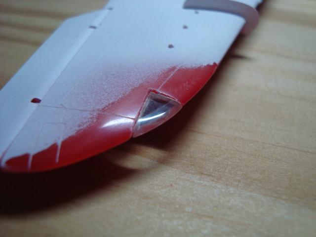

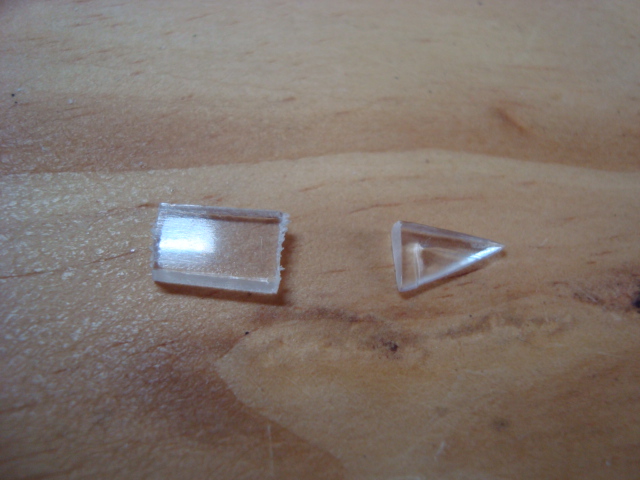

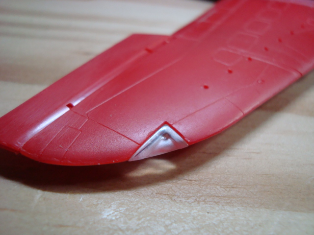

Made some new lenses out of a piece from a clear plastic box, sanded to size and polished up through all the grades of micromesh after fitting to the wing. Needs a tiny bit of filler at the edges but will be fine. These will be painted transparent red and green after the main colour is on.

Top job on the lenses. I thought you might use krystal clear maybe, but i think your scratch build has given you better results Cool Cool Cool
