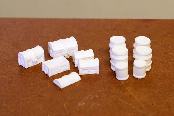

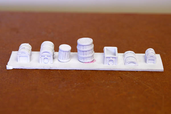

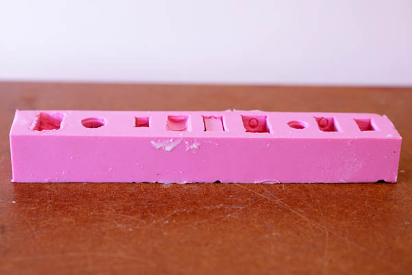

I was a little concerned that the barrels etc. may not be enough. I.e. that the hold may appear a little thin with the parts supplied. I had some time at work and I made some barrels and chests. I then made a mould and cast them out of resin. Unfortunately, there are some imperfections and air bubbles, but as they will be positioned in a dark hold, this should not be a problem. (Famous last words – hope not)

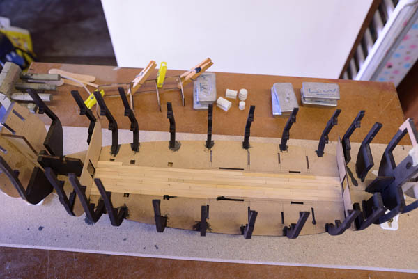

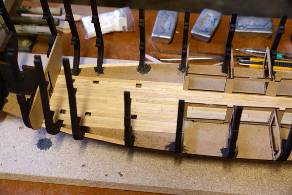

Began planking using the coffee stirrers. It has gone quite well – I chopped off the ends and glued them down. I used my lead weights to hold them in place.
My main concern here was that the deck was never designed to be planked, and that raising the deck height by 1mm was going complicate matters down the line. I.e. the height cell walls and bulkhead columns are going to be affected by this.
I see my options as being; to plank the deck and trim the cell walls etc, reduce the thickness of the mdf deck, or leave openings in the planking for the parts to slot in. I chose this method as the mdf deck is already thin and I think that it adds to the structure of the model and cutting all the cells and columns, well I just don’t feel like doing that. I may have chosen the more difficult approach – well I really enjoy planking.

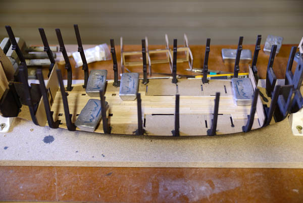

I installed the cells and marked their position. I then removed them and began planking.

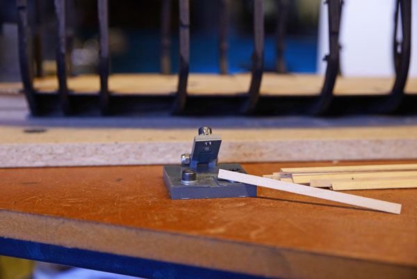

I have made a planking nailer jig at work. I call him “Spyker” (Nail in Afrikaans) it has really sped up the process.

BigGrin Now that looks a neat little tool I would patent it quick and nice workCool

Nice tool there Garth Cool the Soyker that is Tongue

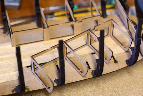

I added a little more planking and built the cells. I decided to build the cells as a sub assembly, this should make finishing the bars a little easier.
I glued a coffee stirrer to the edge of the deck to look like a Nibbing Strake – I’ll sand it later to follow the shape of the Supa wood.
