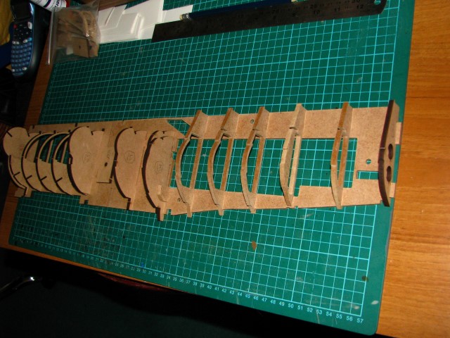

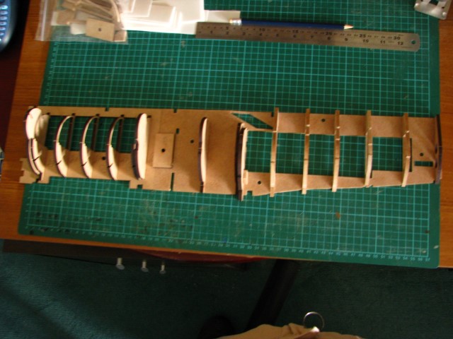

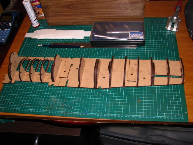

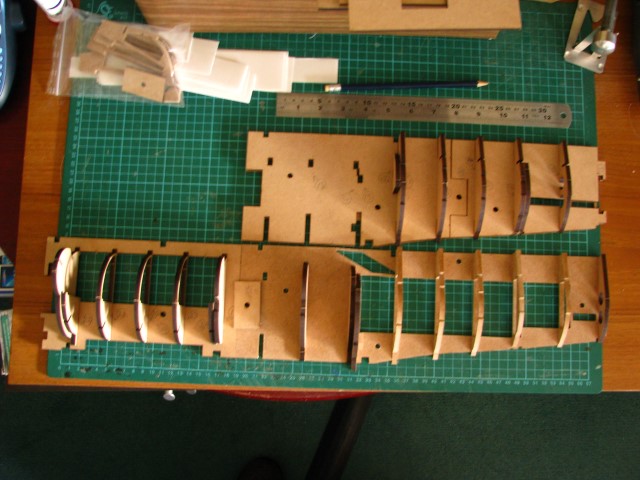

BUILD UPDATE #3
Hi shipmates.
Much to my surprise, I had a package in the post this morning which turned out to be the MDF parts for my forward torpedo room conversion. MarineModelWerft have surpassed all my expectations of a long wait - they had quoted 4 week delivery, and to receive them within a week is outstanding.
Anyway, the MDF parts replace the frames #1 and #2 from the build and use a couple of the parts that were supplied in the 'standard' build.
To see the difference, I set to work cutting out the MDF parts from issues #1,#2 and #3 and dry fitted them together. I found them to be an exceptionally good fit with no extra work involved in getting them to sit correctly. I have taken some photos to illustrate these differences.
Thanks for the kind comments and feedback, and thanks for looking in.
Happy building
David

Yes it was, I was most surprised because as I said, I hadn't received any notice of dispatch. The 2 downsides are that frame #13 will have to be modified slightly as you can see from the pictures so that the bottom notch fits the new frame. The second is that the instructions that came with it are in German, so I'll have to find some way to translate it - not sure how at this stage - I'll have to think about that. But all in all, a very good mod and the parts are of the highest quality and I'm certain you will be as pleased with them as I am. Let us know how you get on with them.
Happy building
David
