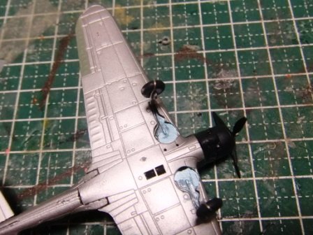

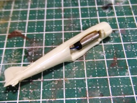

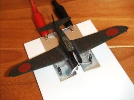

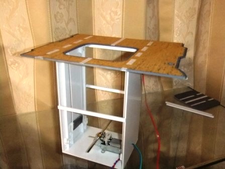

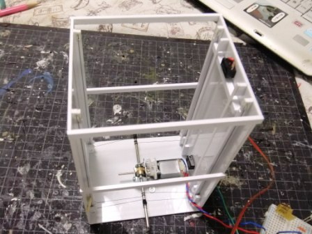

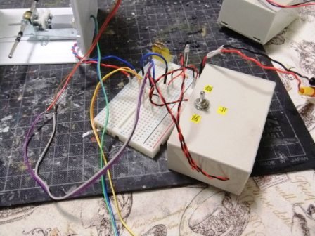

I have entered next step of the Akagi building. I have to prepare some gimmicks for this model.

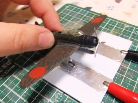

The aircraft was enhanced. The smallest electric motor that I could get was installed in a 1/144 model of Nakajima B5N (Kate).
Electric power is supplied through the legs of the model. Putting the model on the aluminium electrode starts the propeller rotating.

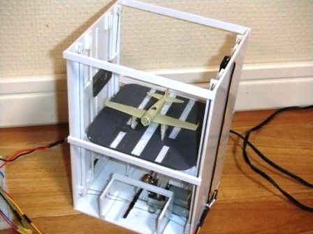

I have also started making the lift. The structure is the same as 1/250 model's lift that I built before. I put a You Tube movie of my trial manufacture of the lift.
Scared Caution! Down the sound level of your PC before click!
http://youtu.be/cuv6KaAoYbo

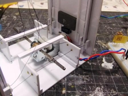

Hi All!

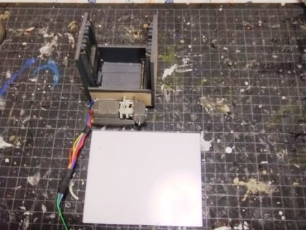

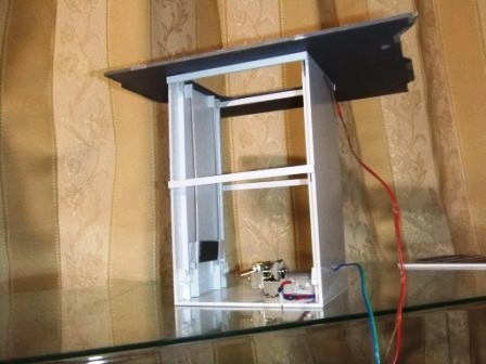

I attached some additonal photos of my Akagi.
The model of the lift had some problems, and I had to solve them. During the process, some prototypes were destroied. Finally I have made the lift model almost satisfyingly.
This is just a prototype. I'll make a practical one.
http://youtu.be/3iFcvNXv4ko
I tried using the flight deck panel with the lift.

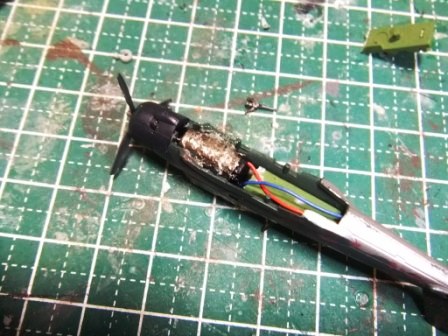

http://youtu.be/A9mboqbwdic

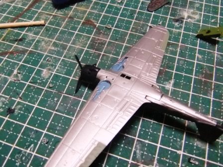

I installed the small electric motor in 1/144 Mitsubishi Zero. It's propeller will be rotated soon.

#45 Posted : 05 October 2014 15:19:20
Yutaro
Absolutley wonderful.

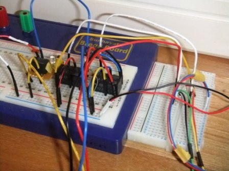

Brings back sone happy memories of when I used to play around with electronics seeing your breadboard setup.
Very clever idea with the aircraft propellor and good to see you managed to find a motor small enough.

Hi All!

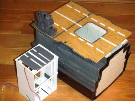

I attached some progress of my Akagi cut model building.

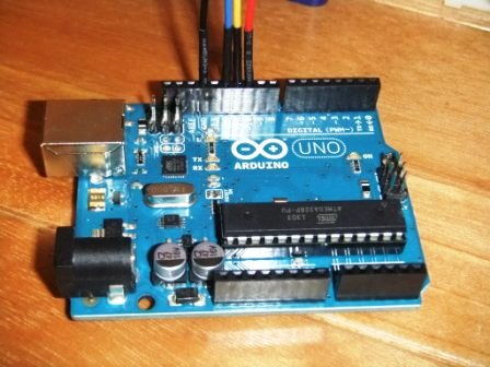

A one bord microcomputer, "Arduino UNO R3" was given to me by my friend the other day. I thought that it could control the lift of the Akagi model. I heard that this computer is well known to train modellers
I used it not only elevetor but also propeller of Nakajima 97, Kate.
I tried making a simple sequence program for the computer as below:
1) Up the elevetor floor at the top
2) Stop for 2 seconds
3) Rotate propeller for 2 seconds
4) Stop for 2 seconds
5) Down the elevator floor at the bottom
6) Return 1)
http://youtu.be/Ug1NoNgdkKY
I do not decide to use it for the Akagi at this time. I guess it is more fun to control the elevetor by my self.

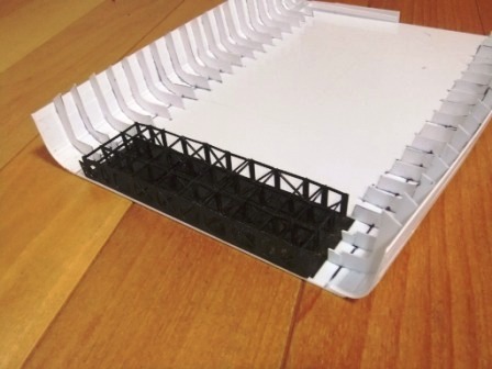

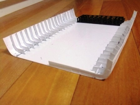

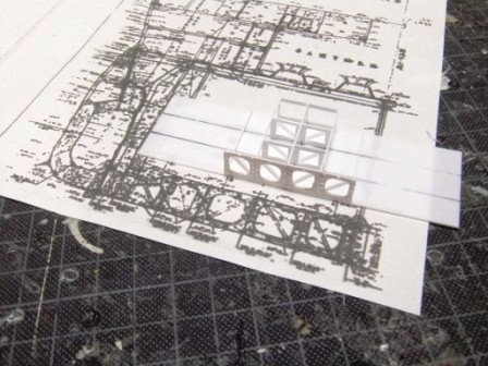

Hi All!

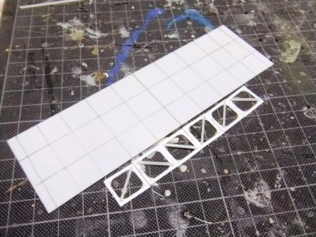

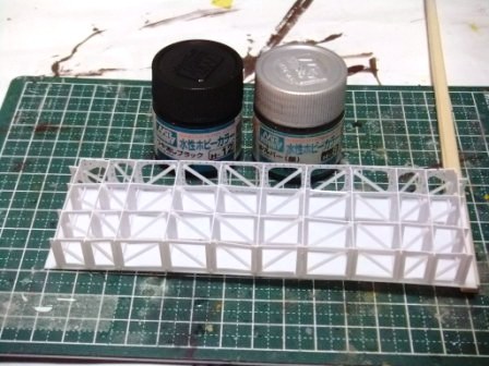

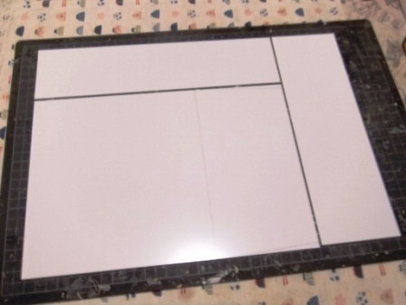

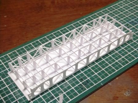

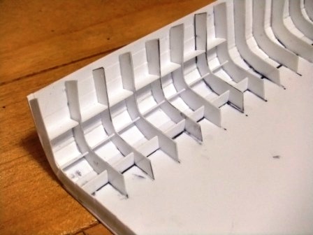

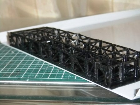

I attached some photos of small progress of the Akagi's model. I have started building the hull. There used to be truss structures at the bottom of the hull. Now I try to build them on my model.
Best Regards,
Yutaro
