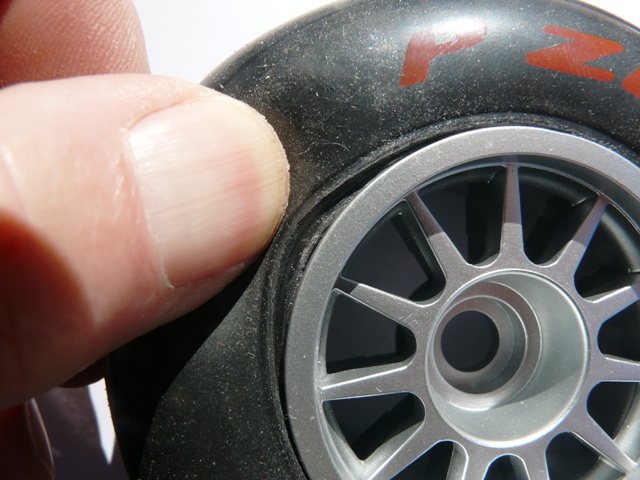

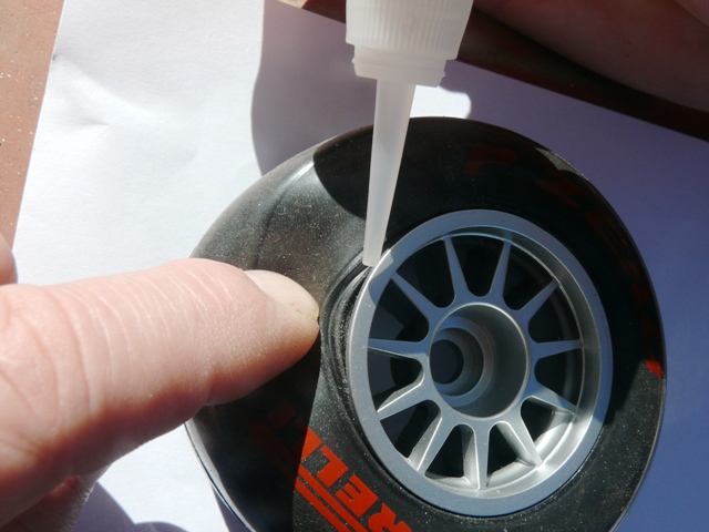

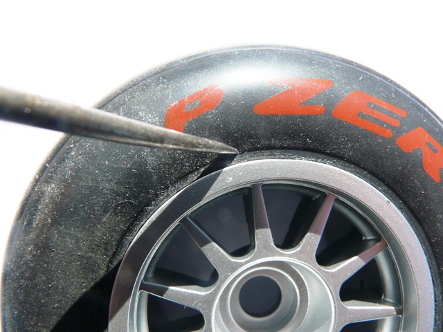

Greetings all, from a cold Swellendam, but it is winter here in South Africa. As I mentioned on a previous post, I am now building out of sequence because I do have all the parts.
I, myself, do not agree with the way we are told to glue the tyres onto the rims. Super glue is a different beast, batch to batch. This is how I did it.
Roughen the rims as per instruction. Fit the tyre and check that the bead is the same all around the wheel. Pull the tyre away from the rim and then put in the super glue as shown.
AndreZS1AZ attached the following image(s):

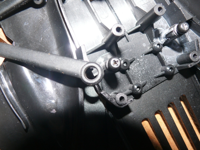

Hmm, it seems that I am talking to myself. Everyone has done the build and then I come along. The major play on my car is at the rear ball joints and swing arms. I should have taken pictures with a gauge to show the amount of play, but as they say, hindsight is 20/20 vision. Bearings too loose in the wheels and so on. My car was built on a Monday or a Friday. I am going away for the weekend and will show how I fixed the play problem when I get back

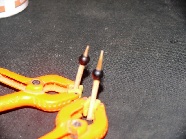

It seems that we have the same ideas. I have been down to our place on the Breede river and then got ready for International Lighthouse/Lightship weekend so not much done on the car. Had a bit of a cold this week. Ok, what I did with all the balls on the suspension arms was give them a thin layer of glue. The glue that I use is harder than the suspension arms and a bit softer than the balls/knuckles. Once assembled, I will spray them with a teflon spray which is quite hard wearing. I do not mind redoing the glue after a few races, at least there is no slop.

Hi guys, it's a weekend and the weather is fine. 20°c in the radio shack. Right the last suspension balls have been done and assembled. It is a thin coat of Alcolin Ultra and that works. I do not use it on balsa wood because it is too hard. I seem to have run out of Teflon spray but I am using this stuff. I use it on my buggy axle joints and it seems to work well. Now on to the diff. I will be using Huddy diff oil once it is taken apart and cleaned. Have a great weekend
