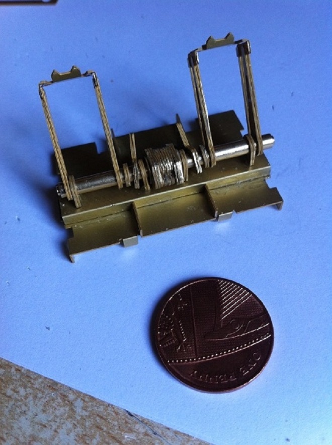

Last stage was issue 7, where I made up the base plate of the pilot`s control peddles.
Issue 8 goes on to add the control levers and the pedal brackets. The last addition is obviously the foot pedals themselves, these include a heel stop and an over the foot strap, where the brass parts are fed through each other like a buckled strap.
A lot of the parts are fine etched and most are double plated to give the extra thickness where required.
Any parts that revolve around the pivot pin have to be fixed together on the pin, but not stuck to the pin as before.
First the pivot bar retainer brackets (four in total, two parts each). Pic 1
The two pins locate into the base plate, I did not glue these in place until I confirmed that everything else would fit together.
The swing arms for the foot pedals are made up of three parts each.
Pic of the detail on the outer face. Pic 2
There are obviously two of these parts, the reverse side is smooth brass.
Two parts have to be fixed to the reverse side to show the inside detail of the swinging arms.
The next pic shows one of the interior detail panels fitted to the right hand side. Pic 3

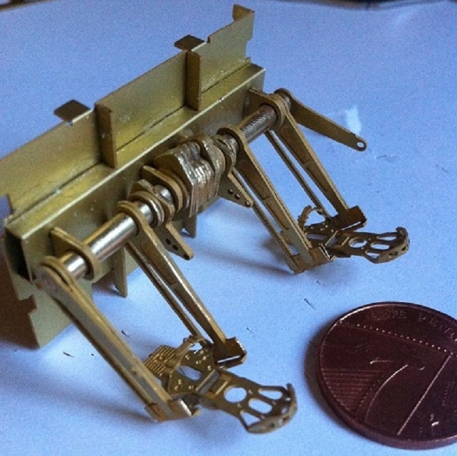

When you have fitted both interior parts to both levers thay have to be bent along the pre-scored lines.
The result: two swinging levers. Pic 4

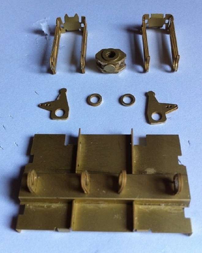

Two more small levers are now made from four parts and everything is ready to put together on the pivot bar. Pic 5
You will see that at this point the pivot bar retainers are still not fixed in place. Had to assemble everything on the bar and then fix in place. Pic 6
At this point two end of bar retainers are made up(yep, you guessed, two parts each) and the foot plates.
Each foot plate has a heel stop to bend up and shape and a foot retainer strap is fixed over the top.
This is the completed construction to this point. I think there will be cables or part thereof to attach to this at a later stage.
End of Issue 8. Pic 7

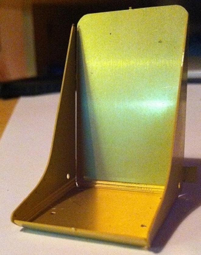

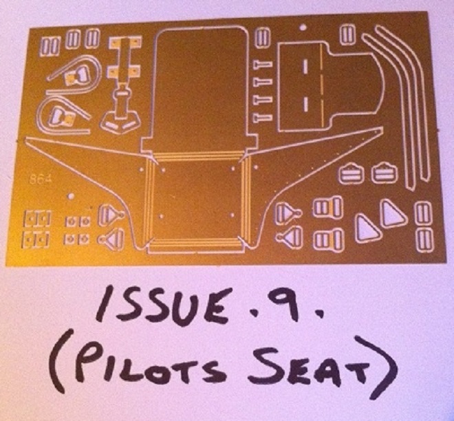

This issue builds the pilots seat, which starts from one piece of brass.
It`s the additional parts that make this "better than good".
The seat incorporates, the pilot`s harness, which has to be constructed down to each individual buckle, strap etc, etc.
The etch plate: Pic 1
I`ve removed the main part that makes the seat and put in the graduated folds to make the basic seat. Pic 2

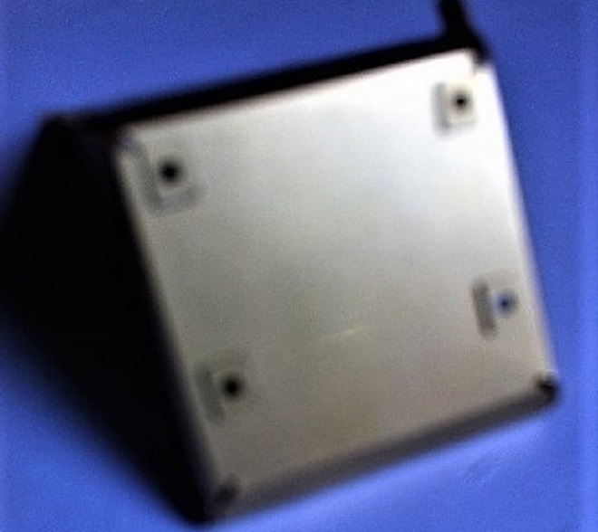

Having previously removed the main seat panel from the fret, I stuck the seat sides to the back.
Some edge reinforcement was then added to both sides of the seat. Pic 1

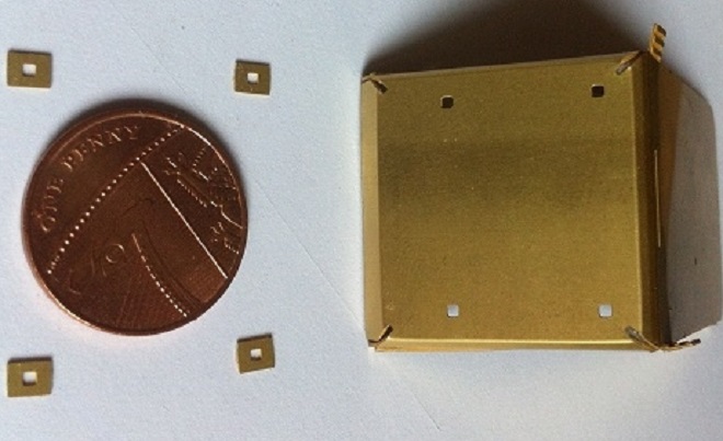

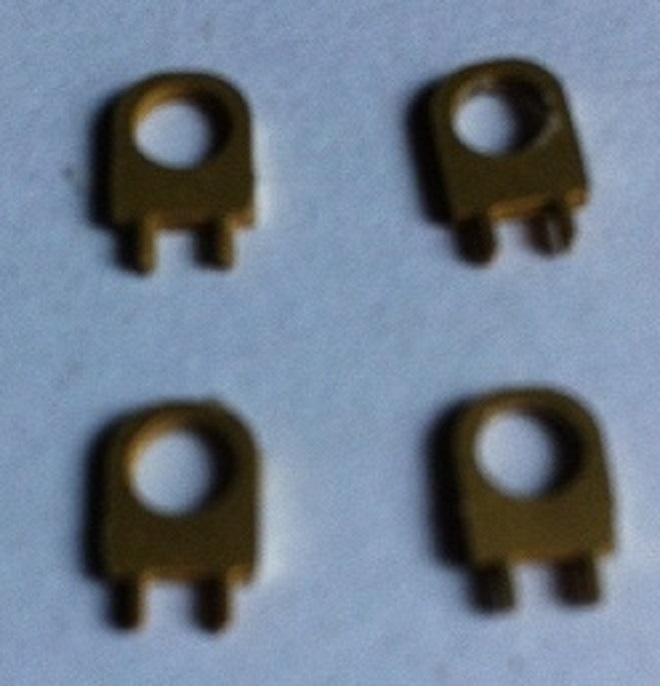

The next miniature addition was four reinforcements for the seat fixing points, where it fixes to the seat adjuster carriage. Pic 2
Sorry this ones a bit fuzzy Blushing Blushing
It shows the four parts fitted.
They were applied with the use of a good old cocktail stick, to make sure the holes lined up.Pic 3

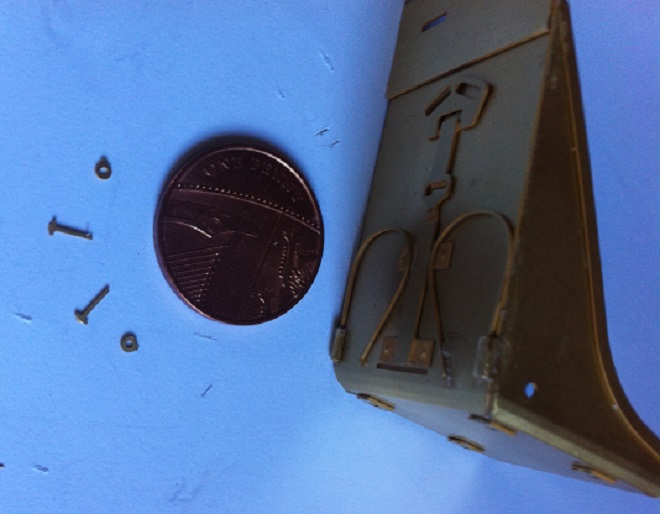

This section further adds to the seat detail and begins the addition of the pilots harness.

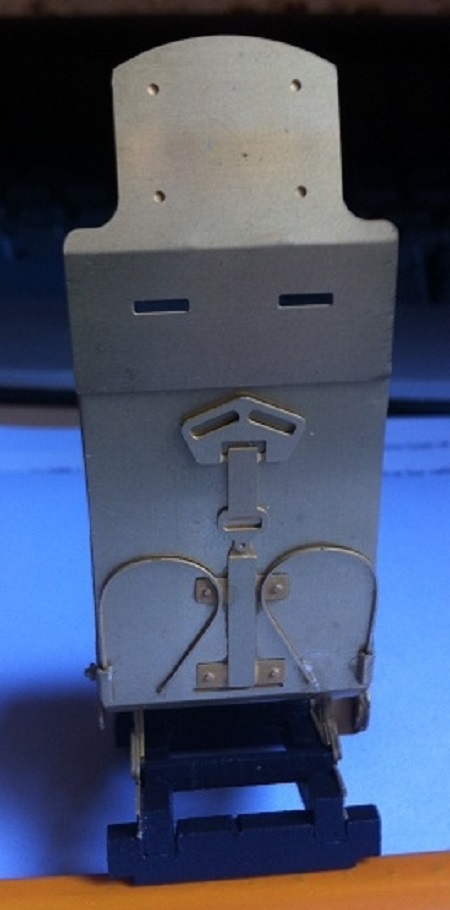

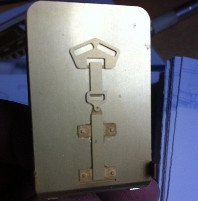

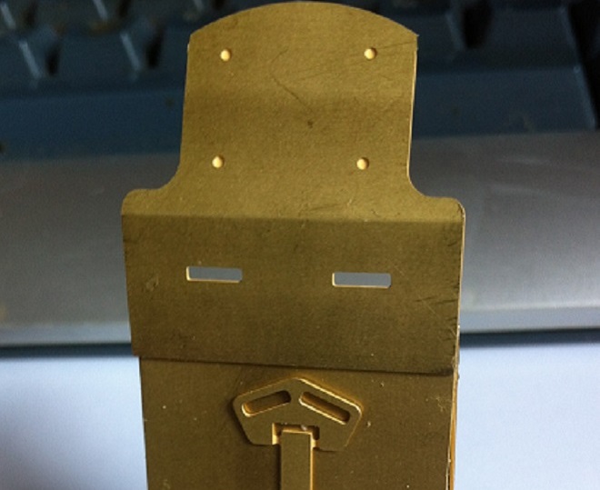

First addition: the centre harness attachment on the rear of the seat. Pic 4
The above part was only stuck to the seat via the bottom half, so that later on seat belts can be threaded through the slots in the upper bracket.

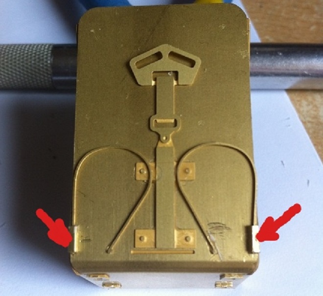

Next are the seat adjuster cables. (Note the two tabs that were at each side of the back of the seat have now been turned into box sections - shown by the arrows).Pic 5
The seat back is now extended to accommodate the head rest later-on.
This is just a flat plate that`s bent along a scored line and added to the back of the original seat back. This is carefully fitted so as not to cover the harness slots in the seat. Pic 6

The parts left in the fret are saved for a later issue in the build. Making the pilot`s harness.Pic 9
Well that`s it for issue 9.
I have completed issue 10, but as you may imagine the eyes are done for the day,so update to follow soon.

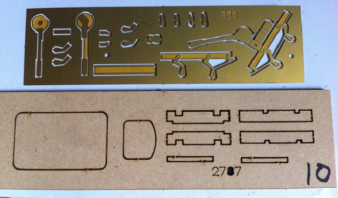

As a taster here`s the frets for issue 10.
One MDF, the other brass.Pic 10

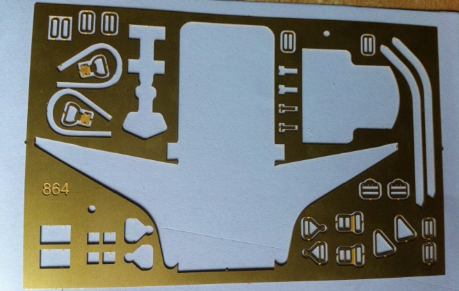

Hi All, BigGrin BigGrin
As promised today is the update of issue 10. Cool

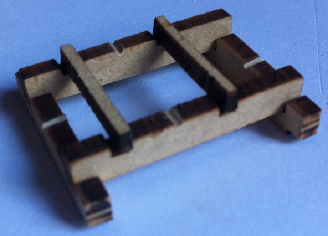

Issue 10 is the first using MDF, but that said it`s the easiest part of the build so far.
The six small parts were removed from the fret. The small squareish part and the larger oblong part will be saved for later, these make up the pilots back and head rests.
Nothing technical here, just follow the orientation of the parts according to the instruction pics and you end up with this. Pic 1
So, that`s the main seat base, still to be painted before the addition of the seat adjuster mechanism. (covered next).

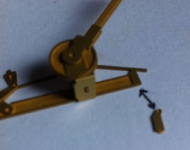

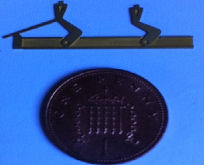

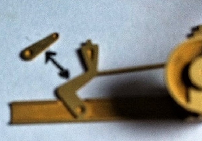

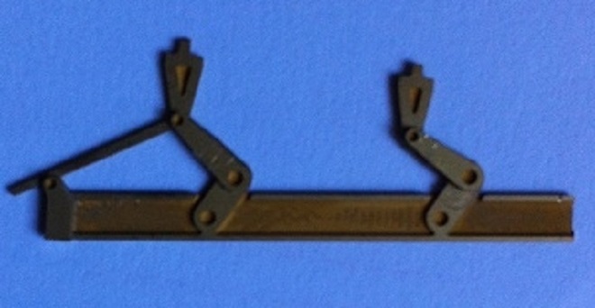

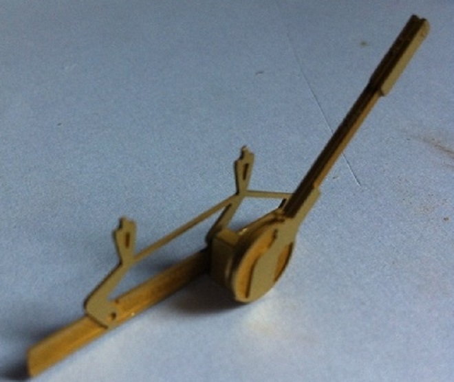

The seat adjuster mechanism.
This is made up of numerous brass etch parts, with a bit of strategic bending included.

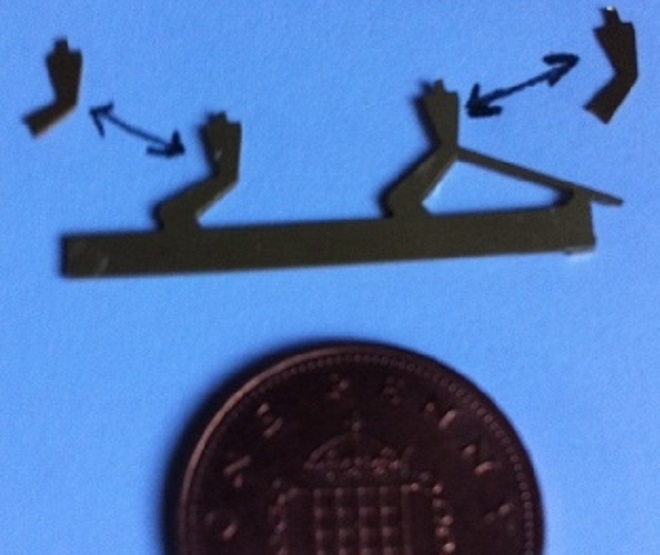

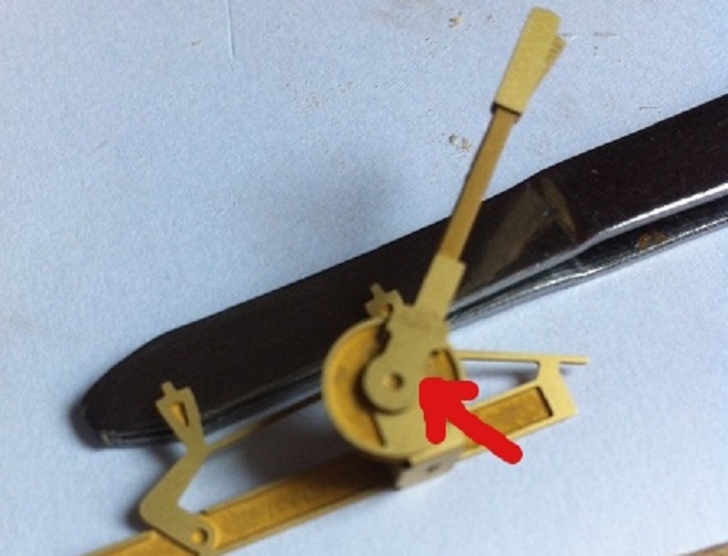

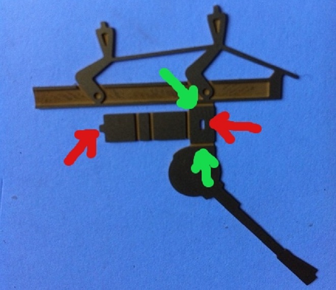

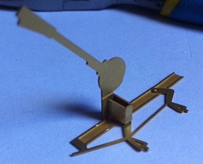

The main part seen below makes up the right hand side rail and adjuster lever. Pic 2
The left red arrow indicates the small lug that fits into the hole shown by the right red arrow. This is brought about by bending the centre part of the piece into a box section using the pre-scored lines.
The two green arrows show where the lever and side seat rail are bent upwards to meet either side of the box section.

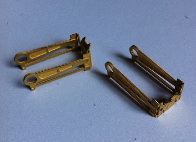

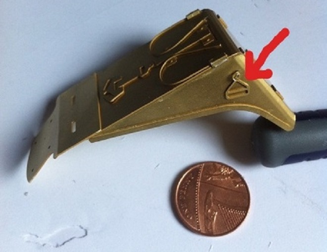

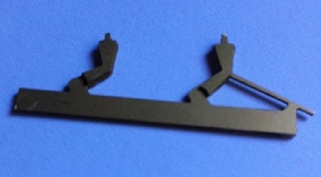

Pic shows box section made and rail folded to it`s side. Pic 3

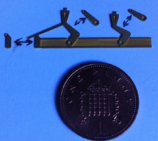

The next pic shows the result of the final fold.Pic 4

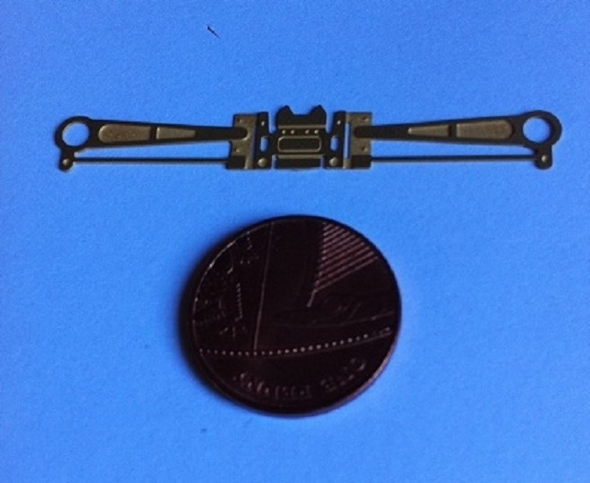

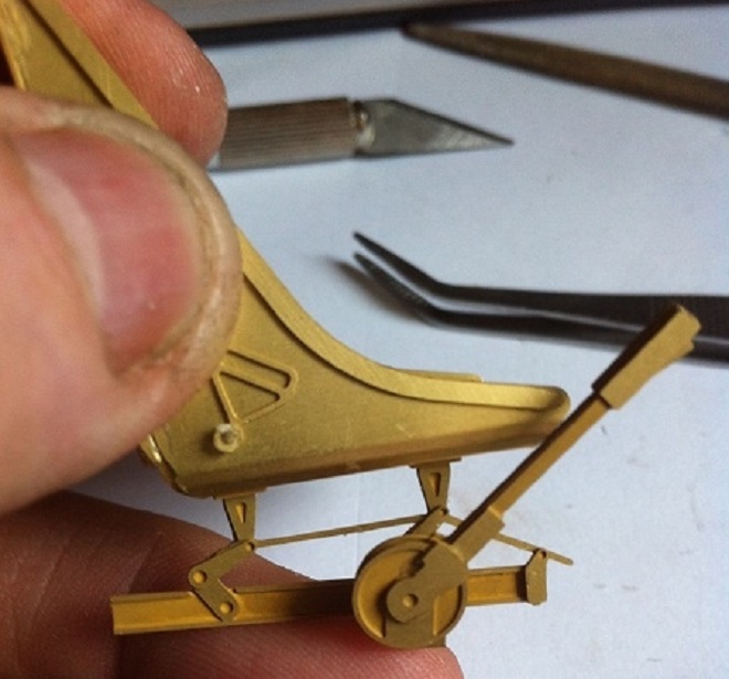

Now I think that this part looks pretty well detailed at this point, but, this kit now layers up the detail even more.

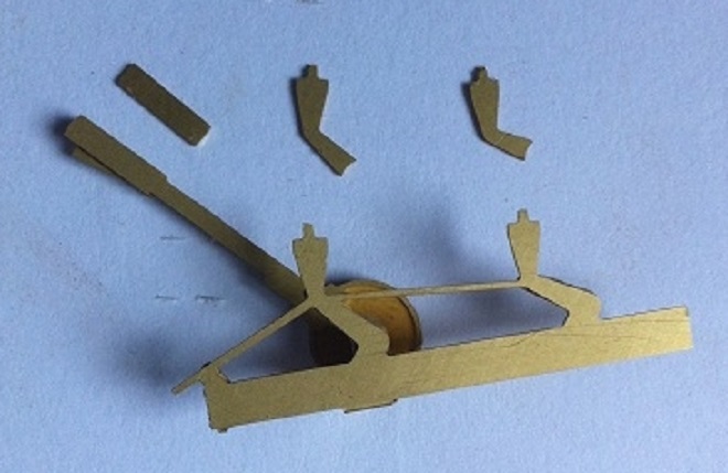

A detailed centre plate is added to the lever. Pic 5

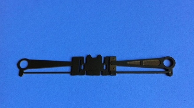

Then the following pics show the finishing touches. Pic 6+7
The next pic just shows three brass parts that are used to thicken certain areas, in this case the two seat mounting point and the lever handle. Pic 8
The last pic for now shows how the seat will fit on the right hand rail.
(There is a rail to make still for the left hand side, but not so complex)Pic 9

The first task was to make up the left hand seat rail. (6 parts)
The main frame. Pic 1
Now as with the right hand side there`s detail to be added.
Three parts on the outer side. Pic 2
Here`s the result of them fitted.Pic 3

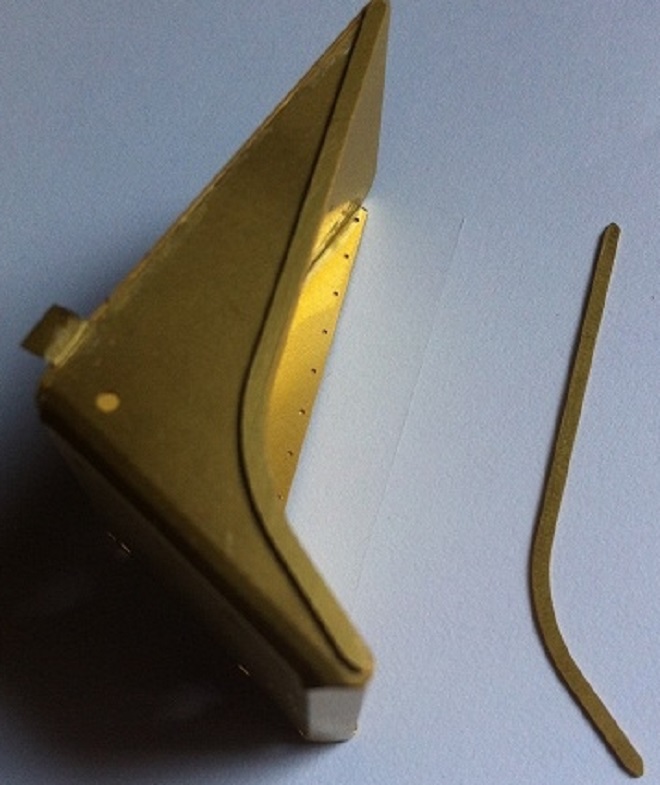

The frame then has to be turned over and some parts added to thicken the seat supports. Pic 4
The result. Pic 5

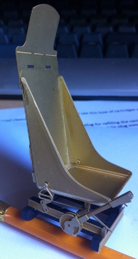

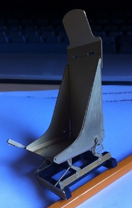

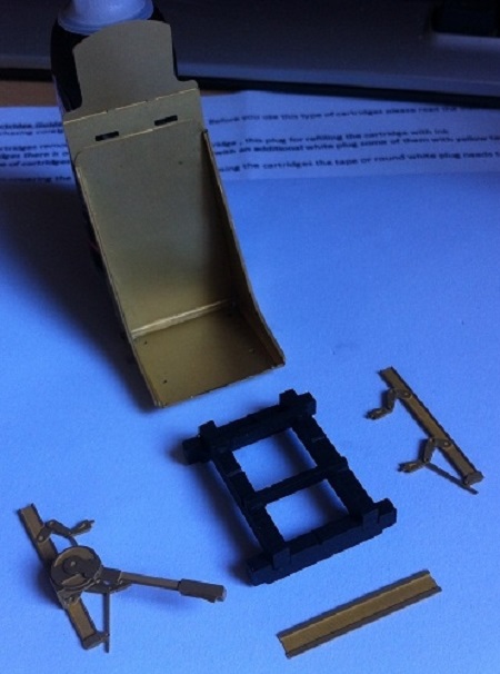

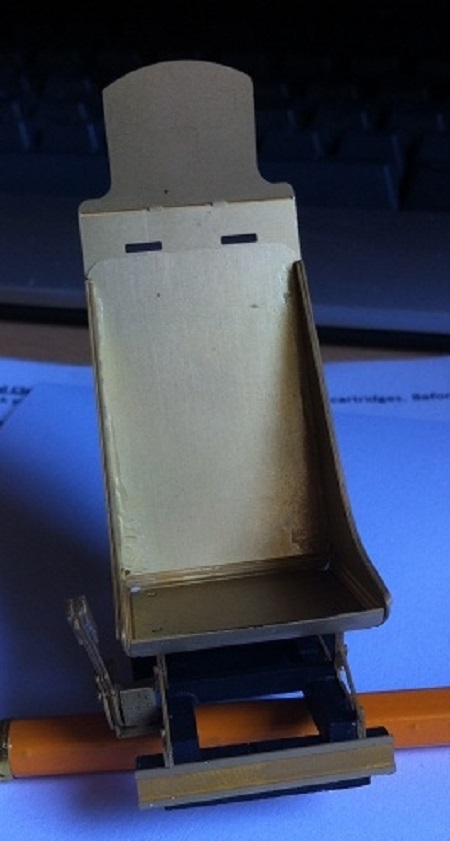

So, we now have the seat, right/left hand rails, the seat base and a front base plate. Pic 6
This is where you find out how good your previous work has been, as it`s now it all gets fitted together.
The two side rails are stuck to the wooden base, you then fit the seat onto the four locating pins.
It was at this point I thought "hold on".
If you try and stick the rails on and then the seat does not fit on the pins, you have an issue. Crying
I therefore stuck the right hand rail to the frame and let it set.
Then held the left hand rail to the frame and tried fitting the seat.
My hunch was right, pins to holes, out by about 0.5 to 1mm.
Very carefully tweaked in the left hand bracket until the fit was spot on.
Glued the left rail in place and then quickly fitted the seat, so that everything fitted nice and snug.
When everything was in place, there is a front plate to fit to the seat base.
The final pics for this update show the seat at the end of issue 10. That`s Pics 7 - 10
That`s the end of issue ten, but nowhere near the end of the work on the seat.
Issue 11, incorporates the start of the pilot`s harness and the seat back and head pads.
Happy building
Will update soon. BigGrin
