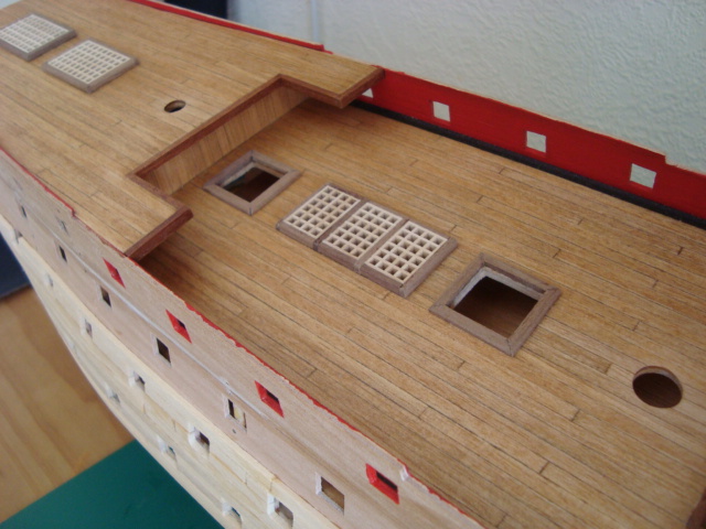

At long last all the gunport template layers are in placeBigGrin

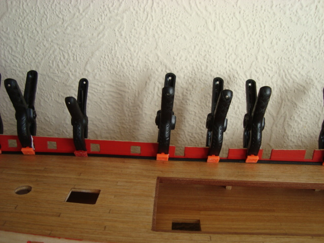

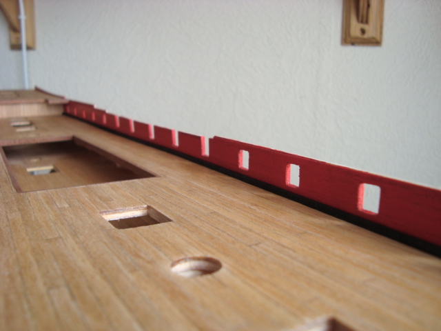

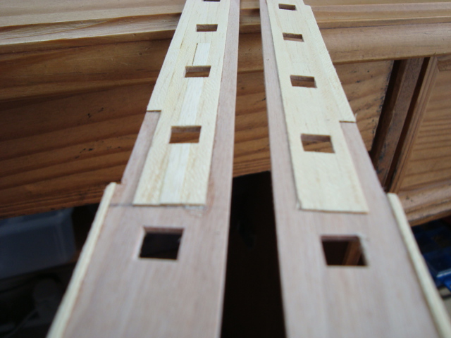

Before the bulwarks were installed I thought Id take Andy's advice and use planking on the inside, to make it a little easier though I wanted to get this done and painted first before it went near the deck.
I pinned the bulwarks in place and marked the decklines on both, then removed them to plank the exposed areas.

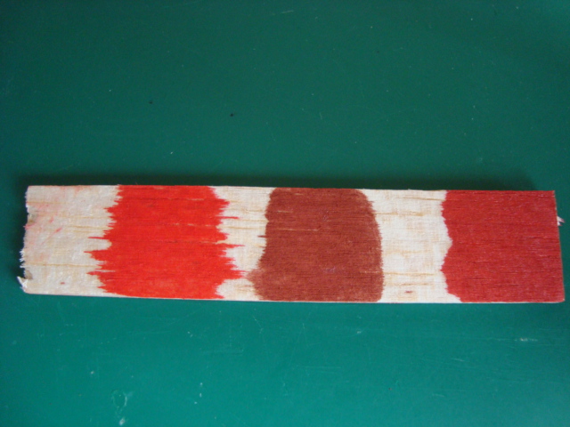

I have looked at dozens of paintings and drawings of this ship and even reports and diaries of the time of Trafalgar but there is no mention of a definitive colour for the red paint.
It's clearly not the same red ochre that is used on the inside of the Victory gunport lids as this is a very "Browny" red. The paintings seem to show a brighter red used and the reports speak of a "fiery red" so I had a mess around with some paints and tried to match them to the colour of the paintings etc.
The colour tester shows the 2 basic colours used and the final colour after mixing - the left colour is humbrol signal red, the center is Admiraly red ochre and the right is my final "Bright red Ochre" this was obtained by adding drops of red ochre to the signal red a couple at a time until I was happy - I now have the ratio noted for future useBigGrin I also gave the bulwarks a very light wash of Vallejo burnt umber.

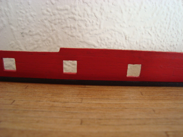

I decided also to fit the step all along the bulwark, this appears in most of my paintings and drawings of the ship and is also included in the X-section build of this kit.I checked first that it wasnt included in later stages of this kit but no sign of it in the final pics either.
The step has appeared in various colours too, white, black, natural and red but I went for an ebony stain for mine. I will also probably have the capping rails in ebony but all other deck furniture and fittings are to be left walnut wherever possible.
OK, here are some pics so far

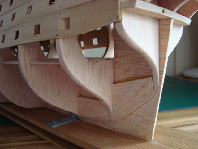

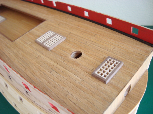

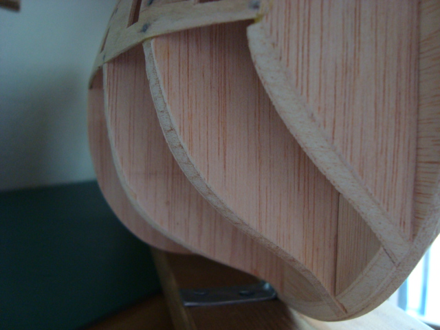

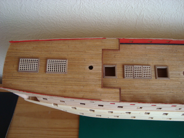

OK, frames fared and planking has begunBigGrin

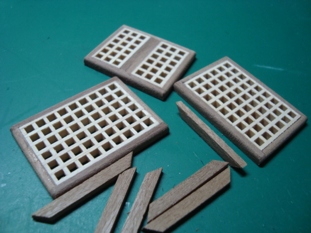

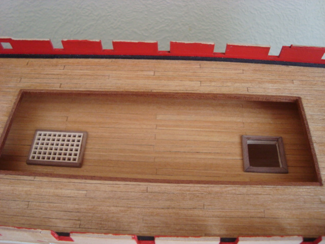

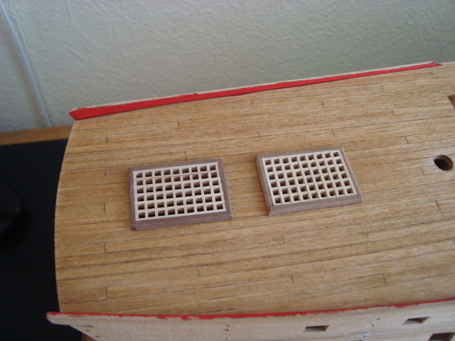

The instructions called for all the gratings and stairwell surrounds to be done before the first plank was fitted so I went along with this to get them out the way.
I then began planking up from the lower deck toward the bulwarks. After 9 rows on both sides were done the instructions then says to build and fit all the stairs and ladders.
Although I can see this is designed to break up the boredom of planking a bit I skipped this as I really want to get the planks up to the bulwarks asap, they are very vulnerable to breaking and the extra thickness of the planking will make them much stronger.
The planking on this kit is way easier than the Vic - there are no tight bends at all and I'm really enjoying it at the momentLaugh

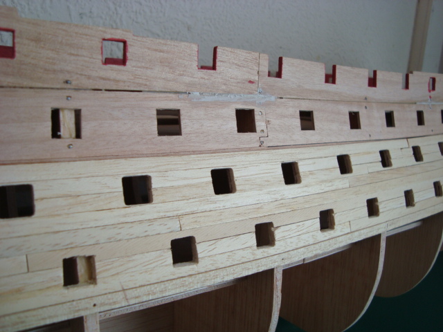

What glue are you using on the wood, in pictures 1 & 2 it looks yellow rather than a white PVA glue.
#53 Posted : 08 September 2014 20:04:00
Thanks for looking as always Alan, appreciate itBigGrin
@Dave thanks for looking in, the glue is Aliphatic wood glue from CMB, very fast grab and says "dries clear with a hint of yellow" Laugh more than a hint id say. I only use it for the frames and false keel and first layer of planks for its grab time and very good strength. I generally use thin CA for the veneer layer of planks where no strength is required.
About the plank curves, you dont plank the bow or stern transom area on this kit, they are added as blocks after the 1st plank layer is done and you then only plank these areas with the thin veneer planks. Whereas the VIc had some horrendous plank bending especially the near 90 degree ones at the transomCrying

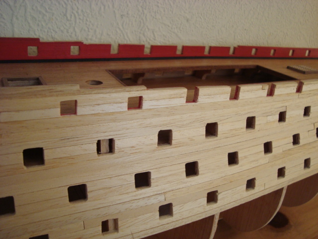

#57 Posted : 10 September 2014 19:32:50
Thanks guysBigGrin

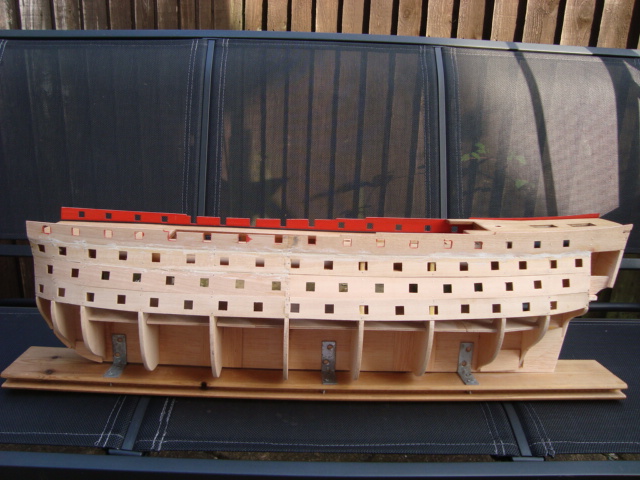

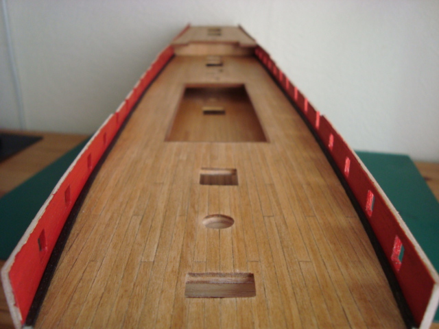

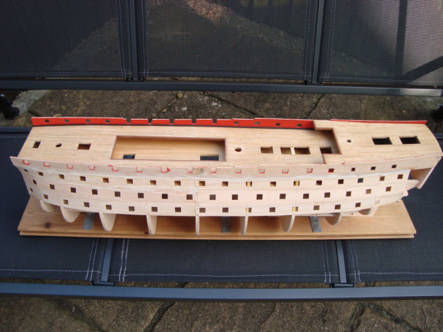

Just a single pic update, theres not going to be a lot to report whilst Im on the 1st layer of planking, I have managed to reach the bulwarks now and an much happier to have added the extra strength up there, bulwarks are now 4mm thick and very solid.
I think I will have a break from planking now and go back and finish all the ladders / steps that I have skipped.
