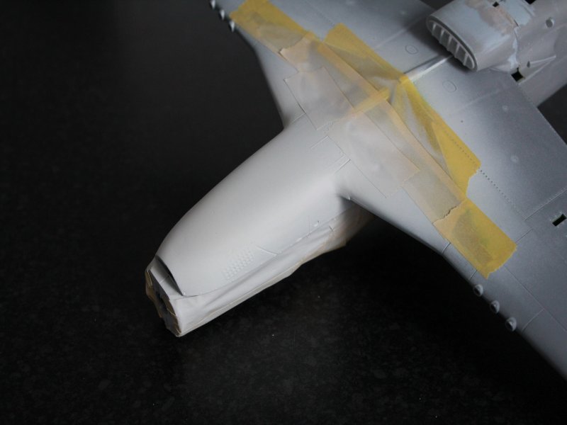

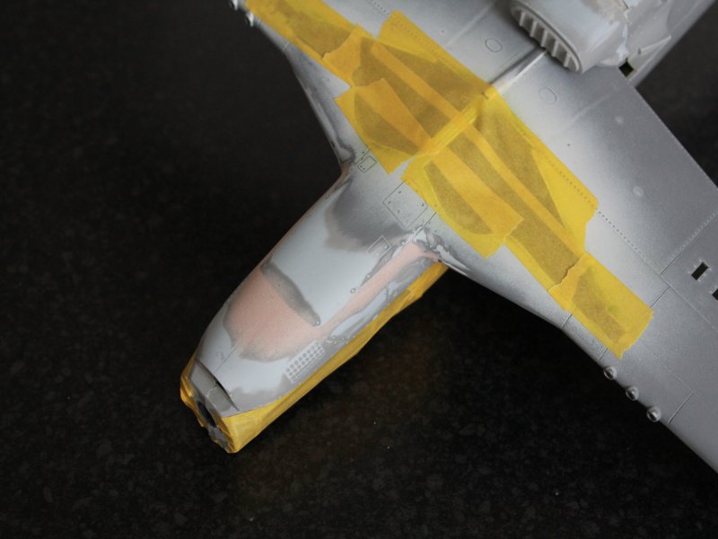

Well the horrible gaps have been filled with P38 (no not the aircraft, the filler! although you could have got one in there.) Sanded and formed. A light coat of primer and then ready for the panel lines to be re-scribed and some of the other details that got sanded away to be remade with plasticard later..

Steve.. You can get it from Halfords.. It's Isopon P38 easy sand for car panel dents and Scratches. Comes in very handy and been using it on the Senna tribute build also.

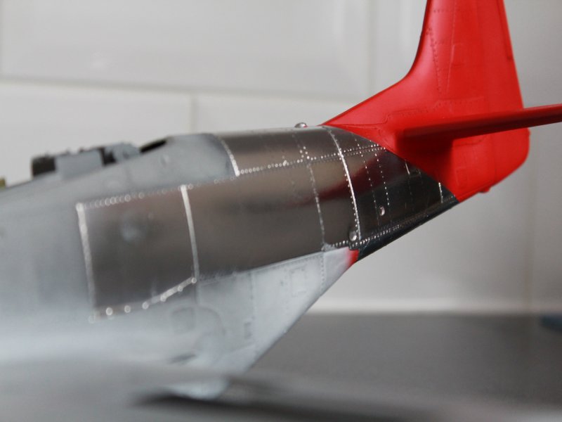

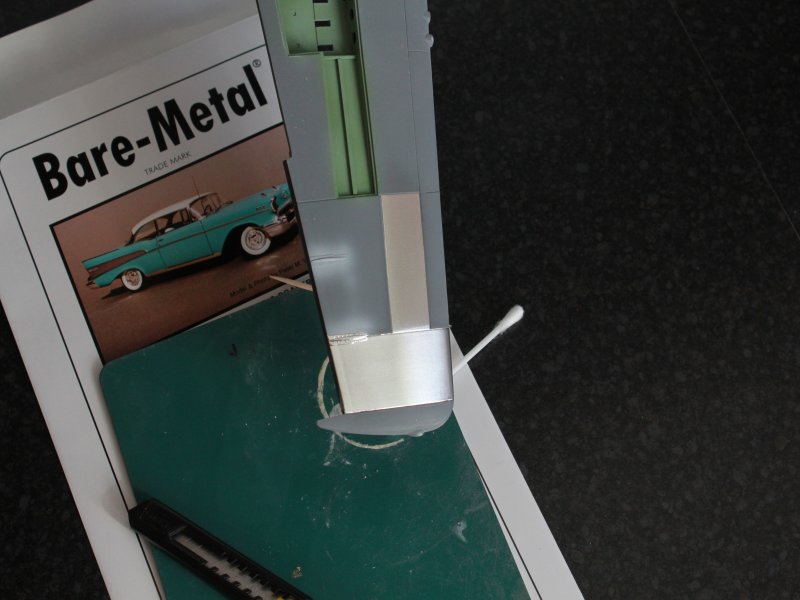

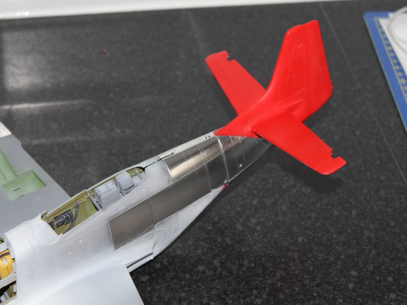

#52 Posted : 03 July 2014 22:41:51

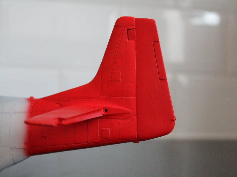

Another small update and some red added to the tail section with a little panel line deffinition using pastels. The tail section was intentionaly over spayed as when I lay down the Metal Foil, I dont have to worry about leaving it too short, so plenty of room to get it right. The other pictures show a couple of panels done in the Bare metal foil and where layed down in different directions so the grain of the foil changes per panel. This will then be polished up once most of the foil is down all over the Mustang..
Thanks for looking in BigGrin

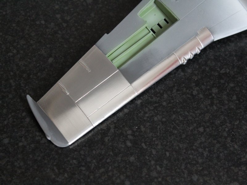

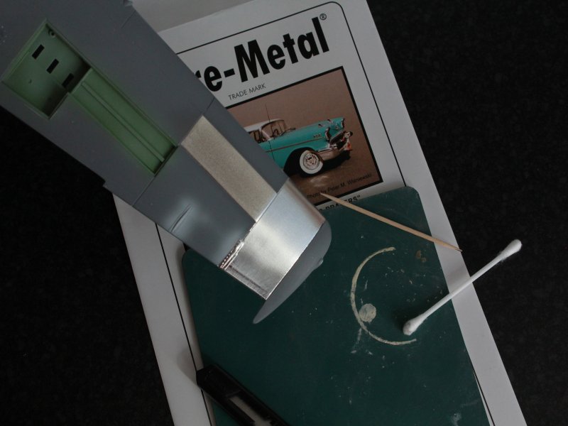

#53 Posted : 09 July 2014 23:59:28
not a lot to update on today apart from some more Bare metal foil added to the rear tail section and one of the wings. Once all the panels have been done the airframe will get a light going over with 8000 micromesh finished off with a polishing of T-Cut to bring out the polished finish but a long way to go yet...
