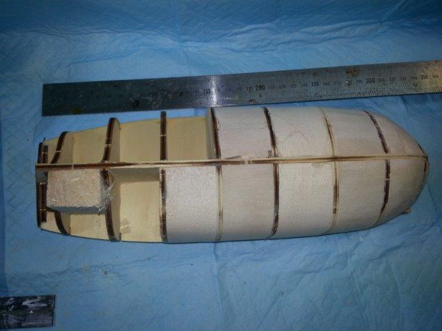

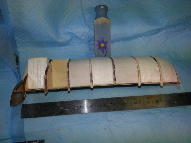

I forgot to add the other build which explains the sawdust in the background of my last pic. Yes I noticed your stocks of balsa..probably explains why Bunnings is sold out over hereBigGrin Between the pair of us that is!

Your balsa infills look really good so you'll have no problems with the SOTS. Cool

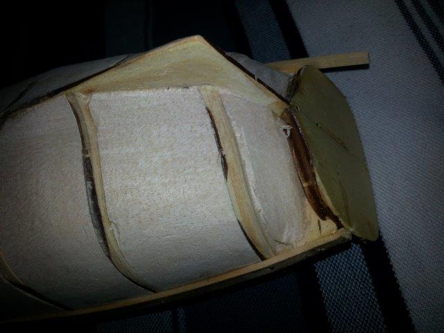

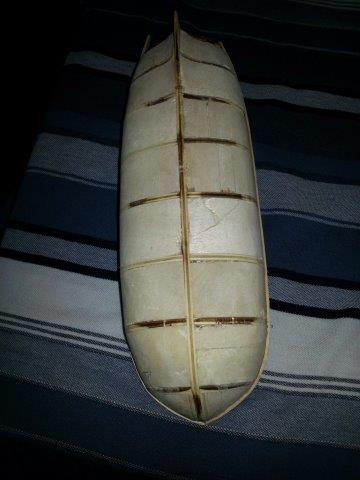

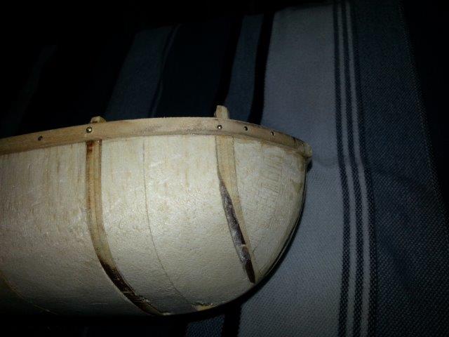

Hi George and others. I thought I would give an update as the in between work in progress for the Sovereign. This is my other current project showing the completion of the infills and starting the planking. This 350 mm length two mast schooner will be double planked. The first plank is full width all the way and moulded via soaking in water and using a steam iron to work the plank around the bends. I am not very good with plank benders and prefer the steam method. I need to lay 15 planks more either side, and have worked out the proportions from the keel to deck along each 'bulkhead'. I think this will be a good practice run for what I see coming next issue of the Sovereign.

Your infill on model looks really good. Cool Cool
I don't think anyone would worry about a different model than SOTS being shown as it is the balsa infill we are interested in besides the model itself. You've shown how it is done and smoothed to shape and a very good job too. All very helpful to us Newbies who plan to infill SOTS with balsa. BigGrin

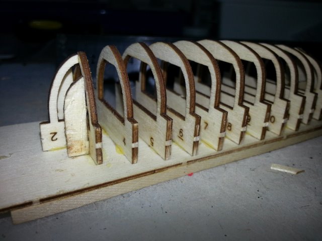

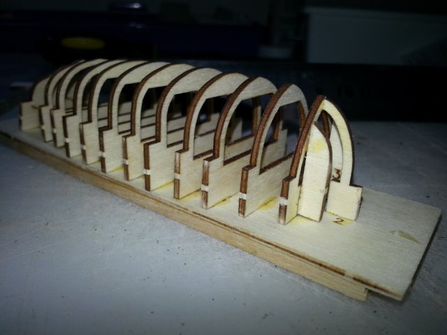

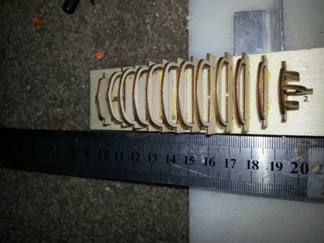

Found some time to start the skiff with the following results. I am thinking about putting the planks on and using balsa infills for the bow over the coming week but only after a bit of research using the build diary in this forum.
Progress so far follows

Been to the build diary and found the skiff occurs regularly for quite a few issues. I saw in one of the later issues that the skiff has a tiny fore deck / spray deck and nothing to suggest I could use balsa infills unless I was prepared to grind them out after the planking was complete.
Does any one have suggestions on this. i.e. should I use infills and take them out at later date of just forget it. Or simply do outer side of the stem / cutwiter See pic for visual explanation.

Hi BB, you do not need balsa infills for any part of the launch, using them will likely cause you problems further down the line... I covered the launch quite extensively in my build diary, link below.. Take a look, you may find it helpful.... Cool

Many thanks Grandale. I agree there would be issues for me down the way. I will go to your build as suggested and go from there. All the best.

Hi Grandale, Me again and just reviewed your build from page 8 plus. I can see what you mean about the bow. Thanks for that. I liked the way you finished the skiff off. Very impressed indeed. I will start planking tomorrow (I hope) and report progress.

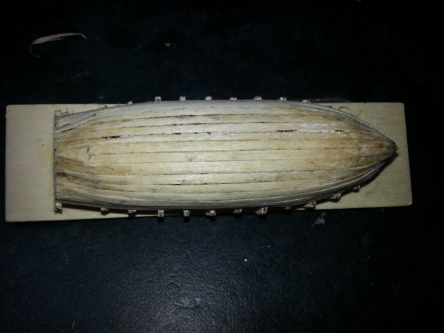

Found time to do the skiff but looking at this photo...well lets just say it isn't seaworthy Looks like a bit of filler is needed. Huh

Your Row Boat looks very good. Cool Cool
Previous experience planking shows. BigGrin
Re filler I had to fill a few places mainly tiny spaces but yours looks like it won't need much. BigGrin

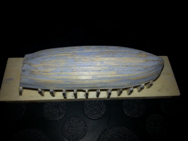

Thanks George, My main problem was the bow and getting the planking in line without creating a hump took a bit of work mainly because I hadn't done the forming of the bow supports properly.
My planking was done a little differently to what the instructions will tell me and I had bit of problem on the port side (which is where the planks didn't butt up) due to having to replace one of the planks which then in the reflected in the gaps.
Also the centre planks were slightly off line. I have applied some gap filler and here is the result. I am not worried about the finish as this will be airbrushed

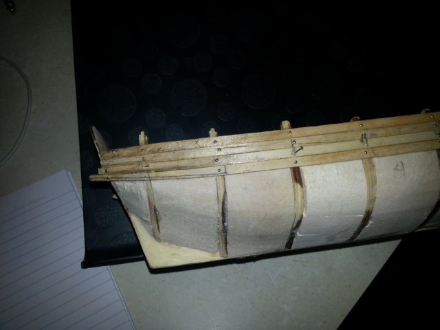

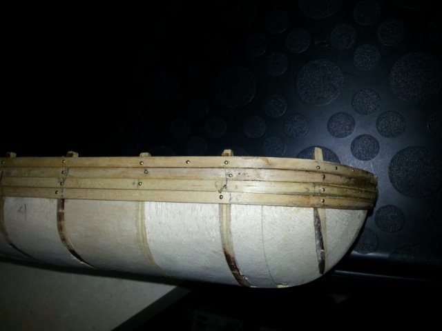

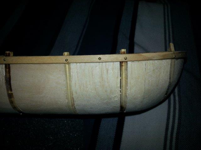

Also done a little more planking on the other project. Don't worry about the pins etc as this is to be double planked. But need to get the alignment right on both bow and stern. Aim is to fit 16 planks being 5mm wide but must shape each end of the plank so all fit equally. I am soaking each plank over night and using a steam iron to shape the bow and stern, holding the plank amid ships and then pinning either side as I bend the plank around to the desired shape. This is a lot easier to do then the skiff!.
