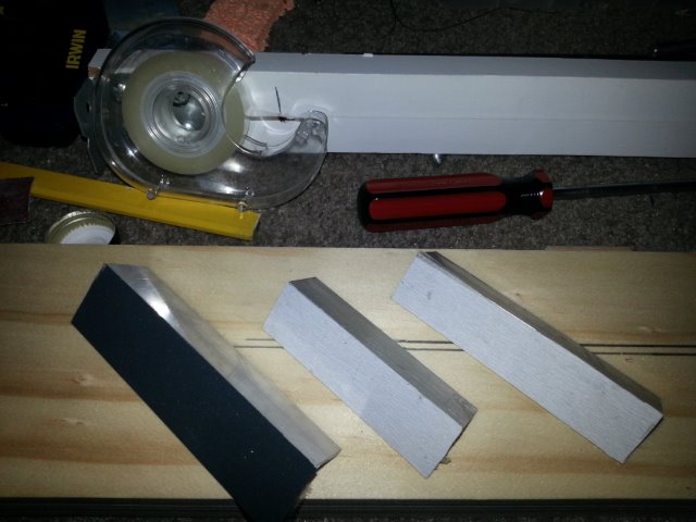

I thought you might like to also see the 'smoothing" tools I use for some of the detailed working, including planking (which will come later) I make these from strips of right angle aluminium (about 75 mm long)using double sided tape on one of the outside faces and attach finer grades of glass paper / wet and dry. I find these very useful and effective. I can also use them to get a reasonably square edge on strips strips, placing the strip on a slightly raised board and then running the 'sanding strip' along the face to give a 'squarish edge'.
Hope photos help (including the one of Buzz)BigGrin

Understand now your mentor. Saw pic behind you but couldn't make out details. BigGrin
Great idea re aluminium angle for sanding purposes as you've described. I just happen to have some pieces of aluminium angle as cut-offs when I used previously for roof top finish and sides of entry recess for a dog kennel so will look at making up a sander with them.Cool
Any ideas are always welcome. BigGrin
I'm certainly gonna' need all the help possible once we get to planking stage. BigGrin

George I see in one of your more recent photos you have "trial fitted" part 16 which is the bulkhead from issue 5. Did you have an issue in getting it right angle to the false keel. I trial fitted mine and found it was out by at least 2mm and if I forced it square that tended to warp the false keel. My remedy is to take the edge off the side blocks of timber used to strengthen the join at that point but leave the central hole alone which is slowly bringing back the alignment. Issue 6 tomorrow BigGrin
