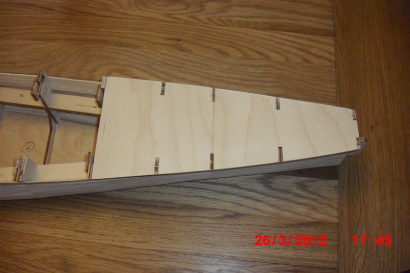

ISSUE 28 AND 29
At this point I revisited the Bow and trimmed the edges of the deck back to the ribs.
I was then able to fit properley the bow side panels we received in ISSUE 28
I will be using screws wit adehsive to fix the decks down.
questions and comments welcomeBigGrin Regards Mike

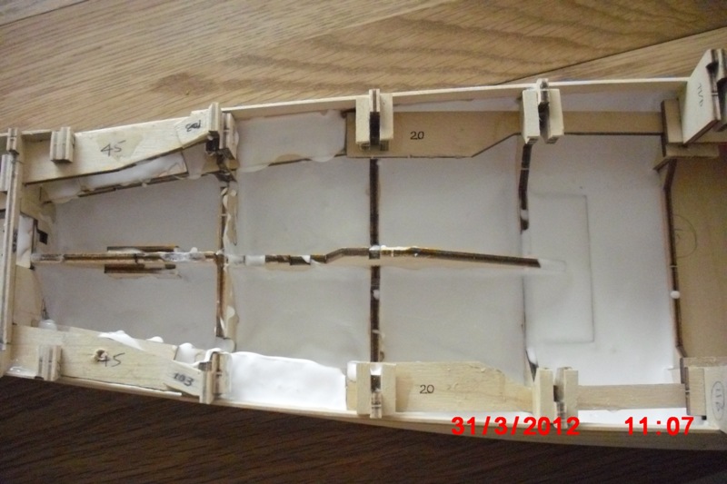

Hi Team before I continue with Issue 30 I wanted to make sure the Hull and Deck were married together properly.
The first thing I did was cover the inside of the Hull with PVA adhesive, as I am building a static model epoxy adhesive is not needed here is a photo:-

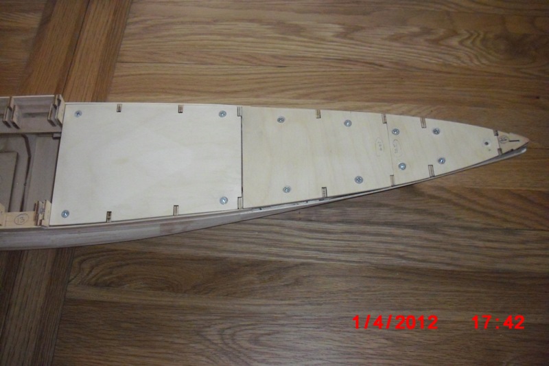

#567 Posted : 01 April 2012 22:47:15
ISSUE 28 and 29

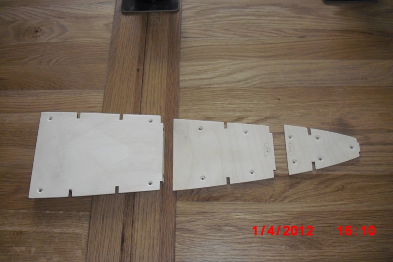

Next job was to fit the three stern decks, I said before I was going to screw down the Decks, I prepared the decks for this:-

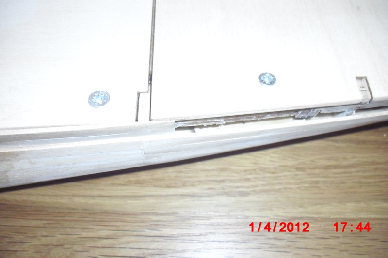

#568 Posted : 01 April 2012 22:50:22
ISSUE 28 and 29
The decks had been sanded to the ribs and when I screwed them in place they had alighned perfectlyBigGrin :-

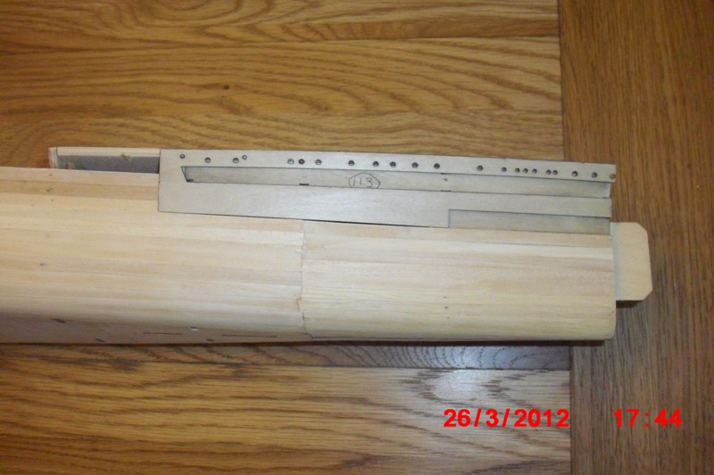

#569 Posted : 01 April 2012 22:55:51
ISSUES 28 And 29

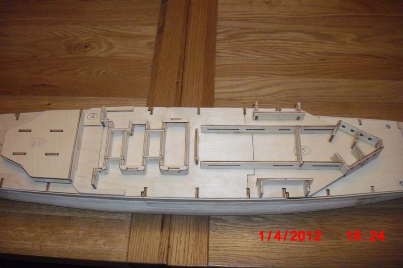

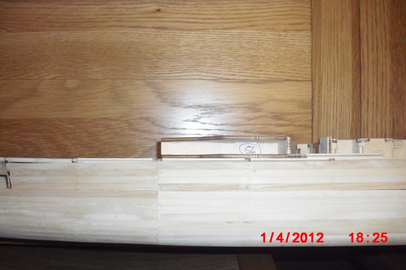

And the final part was to fit the Central Deck area Isanded the sides untill it fitted between the planking:-
I will fit the Stern embelishments next.
Comments and Questions welcomeBigGrin Regards Mike
S2ksean
#570 Posted : 01 April 2012 23:09:09
Joined: 11/05/2011
Posts: 766
Points: 2,128
Location: Dagenham
Looking great mate. If u was doing the rc version wouldn't the PVA inside the hull be enough?
CURRENT BUILDS
Mclaren MP4-23
HMS Pandora
#571 Posted : 02 April 2012 00:57:52
Hi Sean,
If you were doing the R/C version you would need to use the Epoxy adhesive because it would need to be waterproof, PVA would not be enoughBigGrin I hope that answers your question okBigGrin and thank you for your nice commentsBigGrin Regards Mike

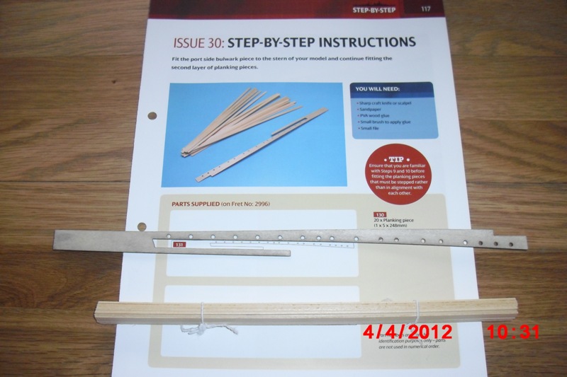

#573 Posted : 07 April 2012 14:53:22
ISSUES 29 AND 30
I should have mentioned issue 29 is the start of the second planking.
In Issue 30 we received,the second Bulwork piece no 130 the two pieces (129 and 130 )will be fitted to the stern.
We also received 20x planks for the second plankingBigGrin Regards Mike

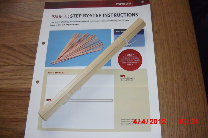

ISSUE 31
This week we recieved 40x planks for the second planking.
Before next week I will fit the two bulwarks and start the second plankingBigGrin Questions and comments welcomeBigGrin Regards Mike

Hi Mike, When you screw down the decks on your model what are you screwing into? Did you make and glue wooden blocks or screw into the frames. Reason I ask is I have just received my issues 28-31 and am building a static model so want to fix these deck down but not sure whether to do as you have done or just glue them down.
Cheers.
Gareth
Completed models,Hachette Titanic.Deags. Hms Victory. Hachette Hems Hood.Ongoing builds. Deags Akagi,Deags Sovereign of the Seas,Deags Spitfire,On my wish list.Yamato.Royal Navy world war 2 aircraft carrier.
#580 Posted : 14 April 2012 20:23:28
Hi Gaz I am screwing into the frames, plus I am using Adhesive I can plank over the countersunk screws, I hope that answers your questionBigGrin Regards mike
