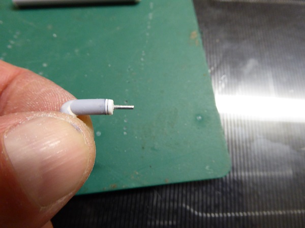

A photo of the smaller, shorter pipe.

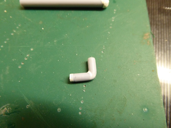

#562 Posted : 27 April 2017 08:29:49
This photo shows the one end of the shorter pipe drilled out and an aluminium pin glued to the end. This pin will locate in a pre-drilled hole on the blanking plate. I had already marked out the pipe locations and drilled the holes when marking out the holes for the M1 bolts. The pins help strengthen the pipework when fitted, aid location and ensure they align.

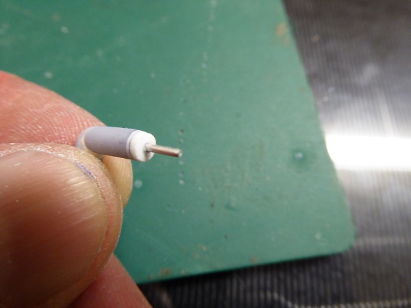

#563 Posted : 27 April 2017 08:30:32
The other pipe drilled and pin fitted.

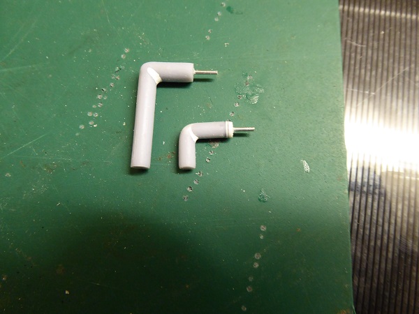

#564 Posted : 27 April 2017 08:31:07
The two completed pipes.

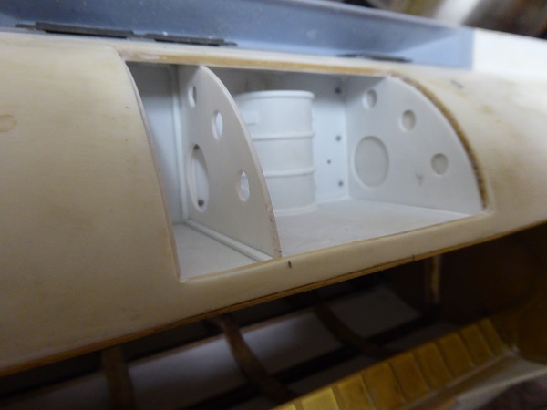

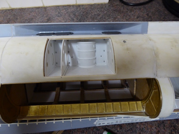

#565 Posted : 27 April 2017 08:32:03
Central support fitted.
#566 Posted : 27 April 2017 08:32:45
Another photo of the central support.
#567 Posted : 27 April 2017 08:33:35
The central support from another angle.

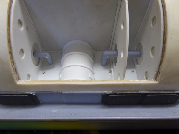

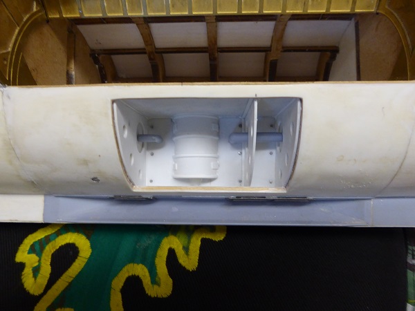

#568 Posted : 27 April 2017 08:34:32
Pipework fitted.
#569 Posted : 27 April 2017 08:35:50
No3.MBT completed showing the mast well, supports, bolts and pipework.
