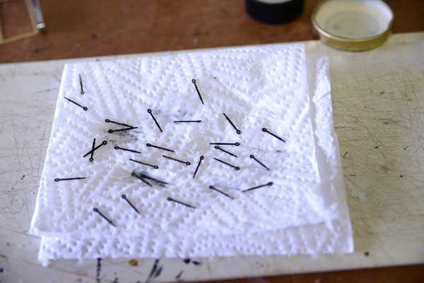

I had some time over the festive season to try and get the brass blackened properly. I’m getting better results, but still not what I hoped for.
Anyway, here is a breakdown of my endeavour’s thus far.

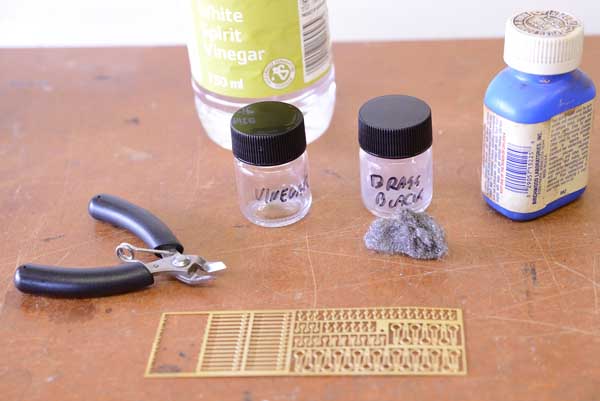

There are excellent articles on Modelshipworld.com and Modelboatyard.com

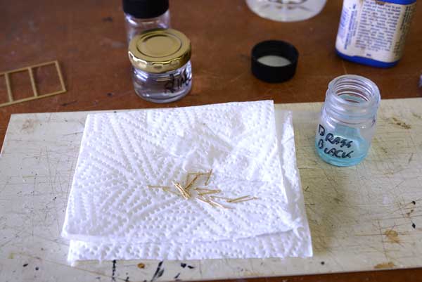

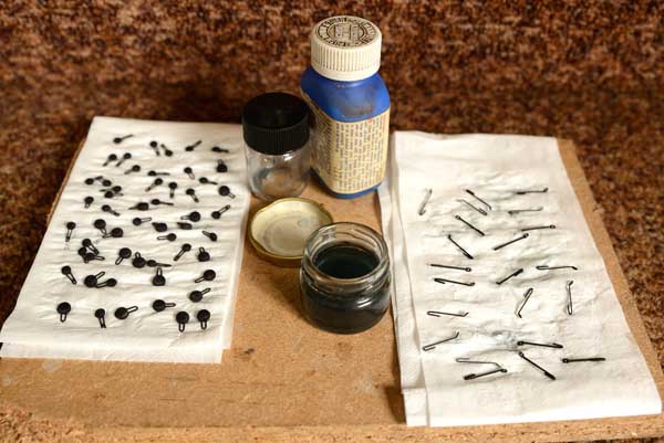

First soaked the parts in Acetone to degrease them followed by a scrub with steel wool. Then into the vinegar for 15min or so. I rinsed with water & allowed to dry. Then into the Brass Black for about 1 minute. Another rinse and allowed to dry. Unfortunately, only fair results.Cursing Cursing Cursing
My latest attempt has improved sum what, but still not great.
Once again, a scrub with steel wool and straight into the Brass Black for a minute or two. Rinse and allow to dry.
Here are my conclusions:
1. The Brass Black is more than a decade old – perhaps a new one is in order.Blushing
2. Try not to handle the parts too mush after they have been through the process.
3. Make up sub-assemblies and blacken as a unit. The solution does not affect wood!
4. Do touch-ups once fitted using some Brass Black on an ear bud.
I’m actually quiet happy with my results, as I said earlier they are not excellent, but I think the mottled, blotchy finish actually compliments the weathered look that I am trying to achieve on my model.

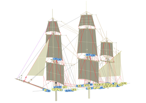

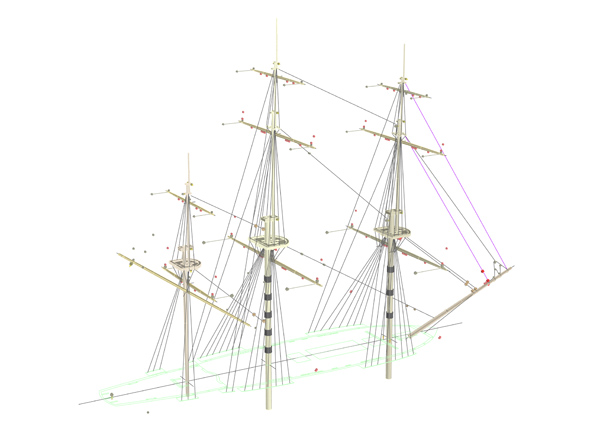

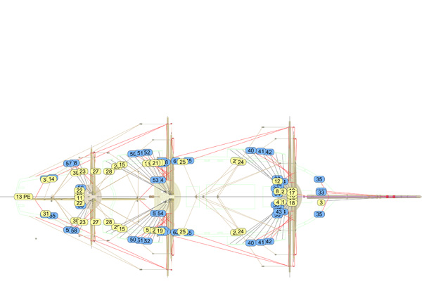

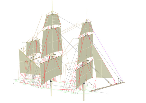

Having recovered from my earlier whines about issue 119, its time to get down to business. I have always wanted to make a full set of bellowing sails for my Pearl. It’s unlikely that anyone has these commercially available, so I will have had to make up my own.
My goal is to make a set of sails with plausible accompanying running rigging. For this exercise, I needed to know in advance where all the lines were to be run and belayed. I needed to know where the yards attach to the masts in order to make the sails, and how many extra blocks will be needed and where they will have to be attached to the ship.
The next couple of months were taken up by gathering as much info that I could about rigging and sails. My gaol being to make as much as I can ‘on the bench’, rather than attaching fiddly bits onto the ship in-between masses of rigging.
So, for this, I needed a proper set of working drawings. First off, I drew the masts, bow sprit and yards to the dimensions on the drawings provided. I then drew a top view and made note of where the original lines are to be attached. Put it all together to make a 3D model. From there I drew the sails and I was able to figure out the running rigging placement and the respective belaying points. All the parts were then dis-assembled and laid flat ready for printing.
Notes on my drawings.
I am by no means a nautical engineer, as I mentioned earlier, my goal is to provide a set of sails for my model with a plausible set of running rigging. I cannot vouch for the accuracy or the correctness of my drawings. I started with the most basic lines and stopped when my drawing looked busy enough. My motto has been ‘… if it looks right, then it is right!’ Remembering that the Black Pearl is a ‘ghost ship crewed by the dammed’ and Disney have certainly used their own creative licence – they have the capstan rotating around the main mast!!!
The drawings that I will be providing are my own design and may not be correct. I intend to share them as I make progress. I will upload the small image with a larger one to download printing. They will be on A3 and A4. The print instructions are on each drawing.
Anybody may freely download and share them as they wish. Please credit me if you do. And, if you somehow use them commercially, any £, €, $, ¥, coming my way is really needed and much appreciated!
